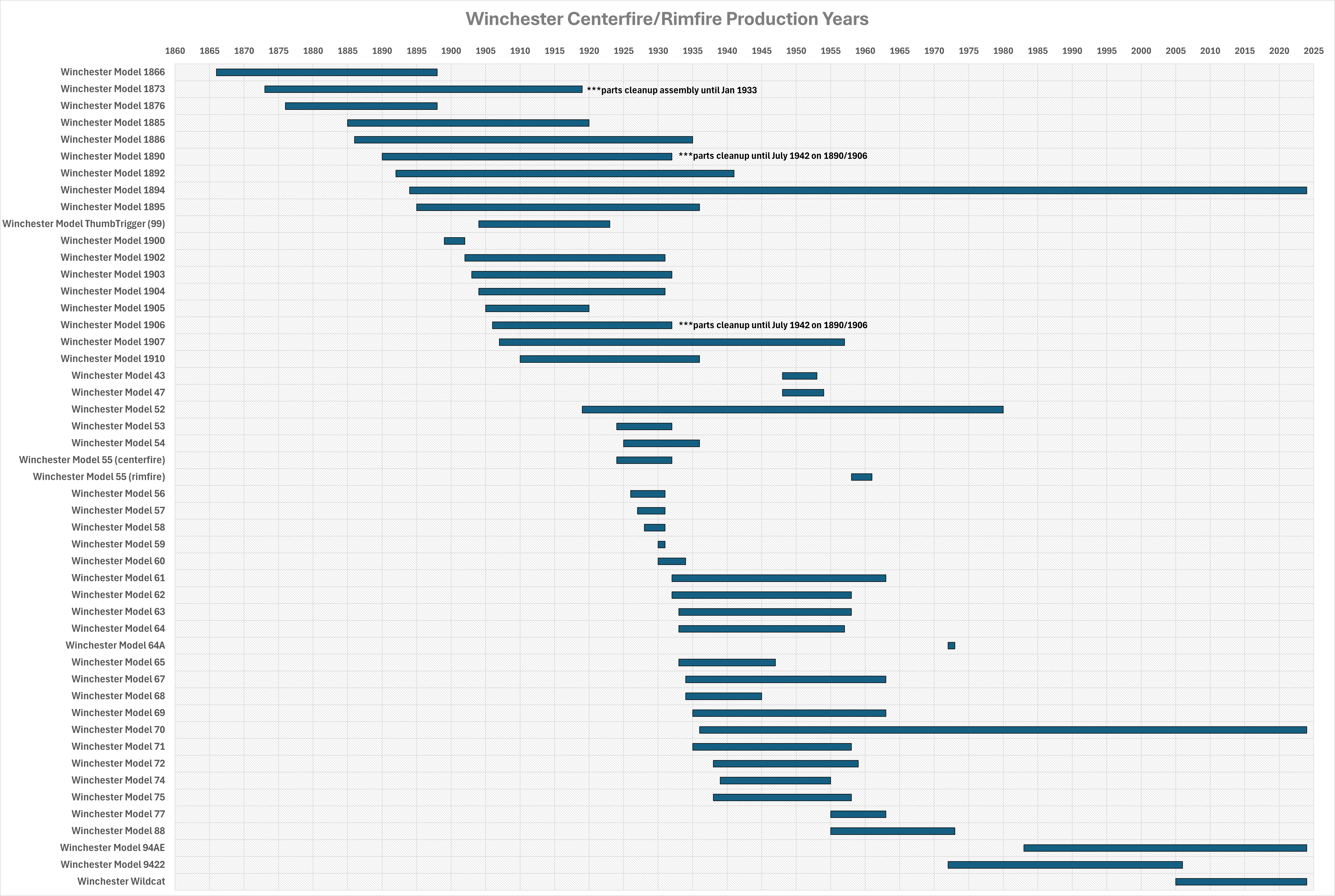

Made a graphical representation of production years...sharing

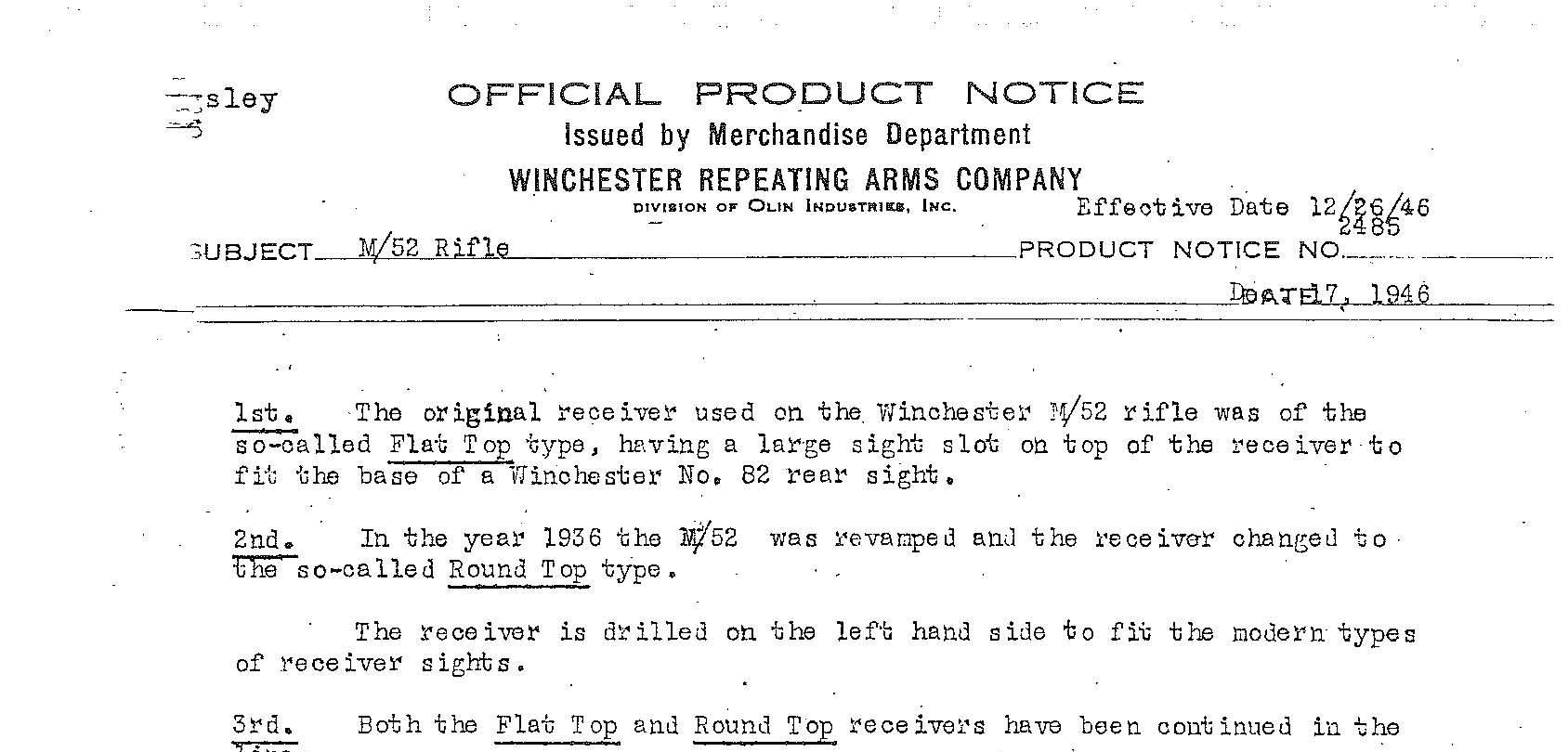

On charts I have done I also include the official Product Notice or C/M notice date for the discontinuation of a model, they are not always correct but close.
I was about to ask, What makes an model discontinuation “Official”?
Is it a notice in a catalog? Something being dropped from the catalog? Is it a CIM (Change In Manufacture Notice)?
Then my next question would be, What makes these not correct and why?
Of course, that might be a bit much to put in a graphic.
Hi Maverick,
All good questions.  I should have put “official” in Caps since the word is part of the title of the Winchester notice (see the image below).
It is not a Change in Manufacture notice as those were a different form from a different department.
Over the years the notices changed titles slightly and some were issued by the Engineering department and some were issued by Marketing.  Here is a sample of some of the notices from which information can be gleaned:
Change in Product Notice (C/P)
Change in Manufacture Notification (C/M)
Official Product Notice (OPN)
Product Notice (PN)
Product Change Announcement (PCA)
Product Change Authorization (also PCA)
There are also notices that Winchester referred to as (CR) and (GEC) and I don’t know what those acronyms mean.
To answer your question on what makes some of these “not correct” is that production did not always follow exactly what the marketing notices indicated.  Some examples of that are the Model 67 finger groove stock.  Marketing wanted to eliminate the finger grooves in 1936 and issued a product notice stating they were discontinued.  Houze used that notice date for the end date of the actual finger grooves however there were at least 35,000+ finger groove blanks already in stock so they were issued up until 1938 with a finger groove stock and the remaining finger groove stocks used on the dual sight models until 1941, 5 years after the Product Notice was dated.
Another example is the “official” discontinuation of the Model 75 which was published in Product Change Authorization G322 in 1958 which stated the Model 75 had been “discontinued and dropped from the line” however the production department kept manufacturing receivers and assembling rifles for 3 more years, up to November of 1961 (the month the last receiver was serialized in the polishing room)
I have been collecting and logging all of the notices mentioned above related to pre-64 firearm production and have over 700 entered into the spreadsheet so far so I can search by Model, Topic, Component, Notice Type, etc.  It is a VERY useful tool for me when doing research but you have to be aware of the fallacies of some of the information.

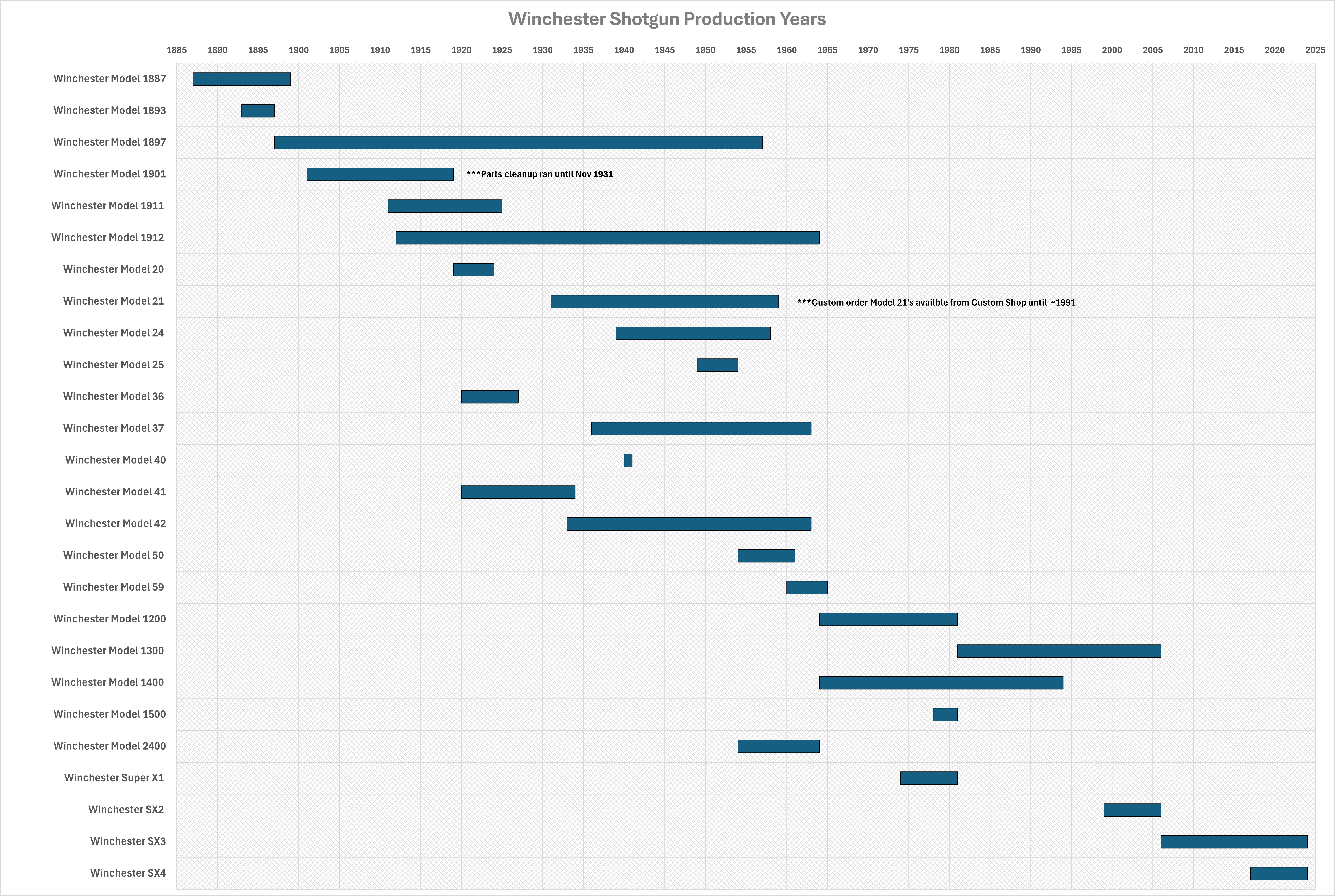

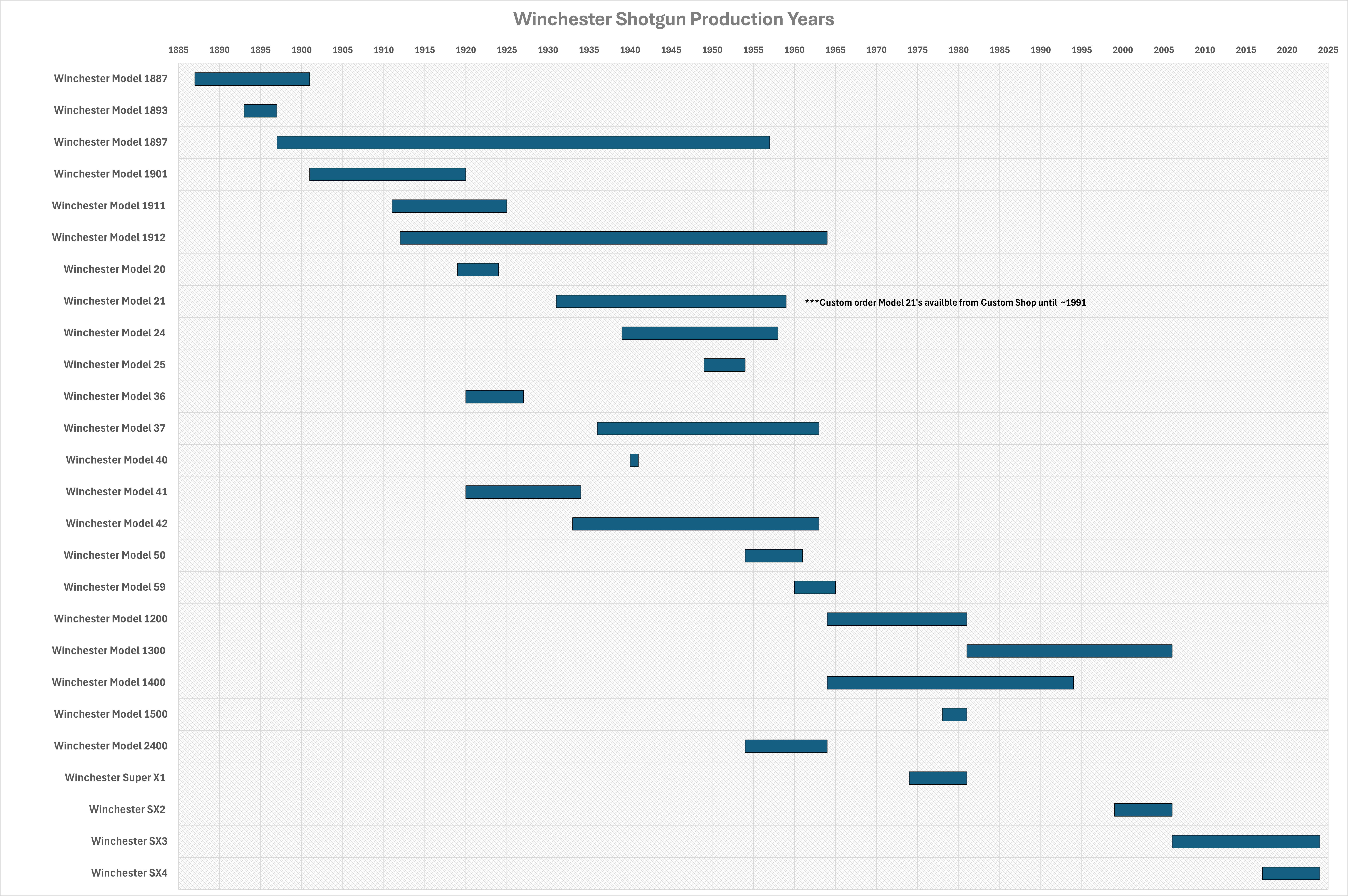

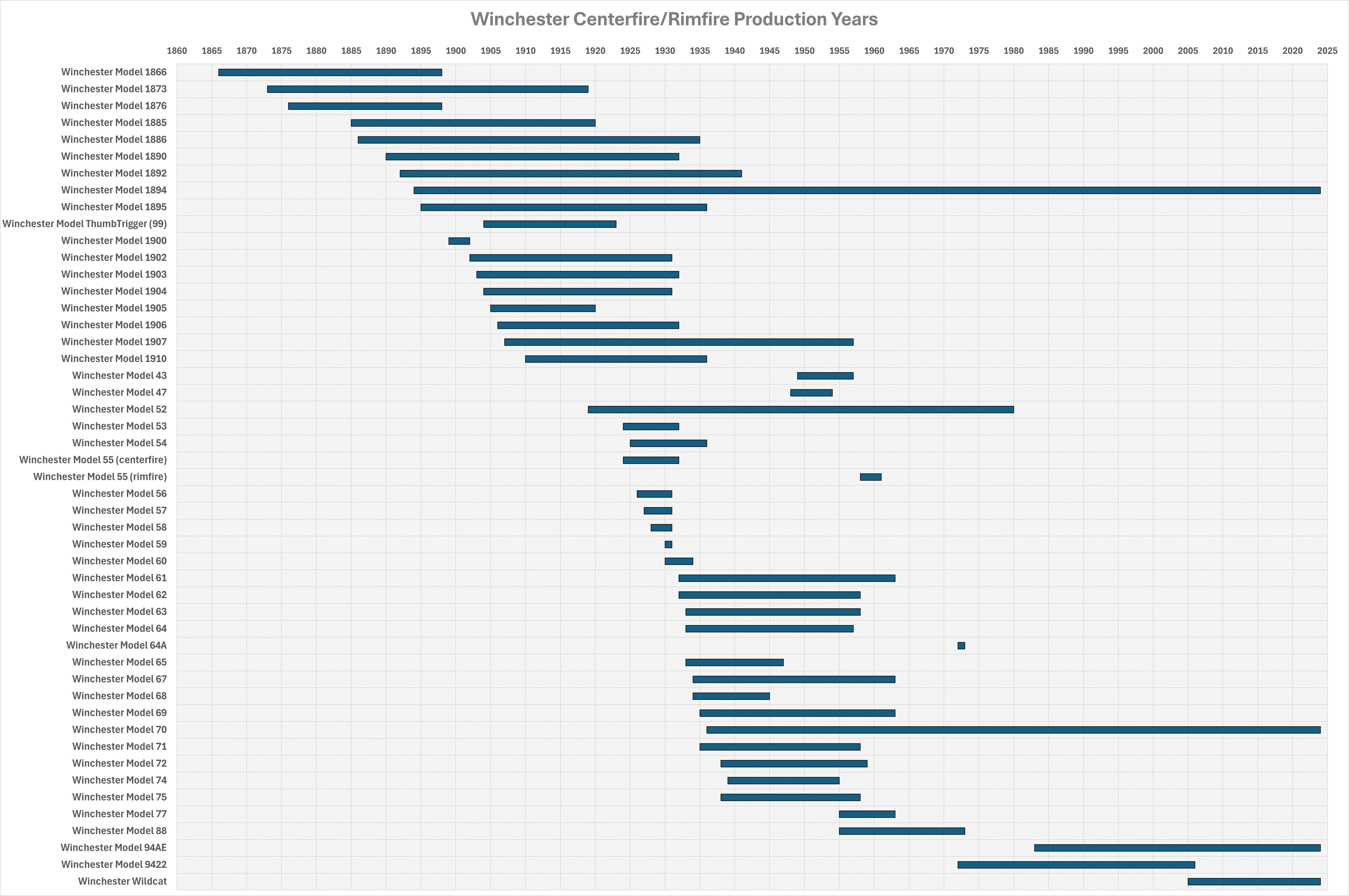

Here’s a breakout of SHOTGUN only and CENTERFIRE/RIMFIRE only, with additional sizing changes for old eyes!
Shotgun:
CF/RF:
Forum Posts: 14841
October 28, 2024 - 10:27 pm
Jeremy,
Production of the Model 1887 ended on March 7th, 1899… not in the year 1901 as shown in your chart.  Production of the Model 1901 began in June 1901, and ended in July 1919 (parts clean up ran until November 1931).
Forum Posts: 14841
October 29, 2024 - 2:10 am
Jeremy P said
Thank you Bert….updated!
CF/RF:PNG-of-rf-cf-prod-year-chart-as-of-10-28-24-2.png
The Model 90 and the Model 06 parts clean-up continued through July 1941 1942, with more than 8,700 rifles assembled in that time period.
The Model 43 production was May 1948 – December 1953.

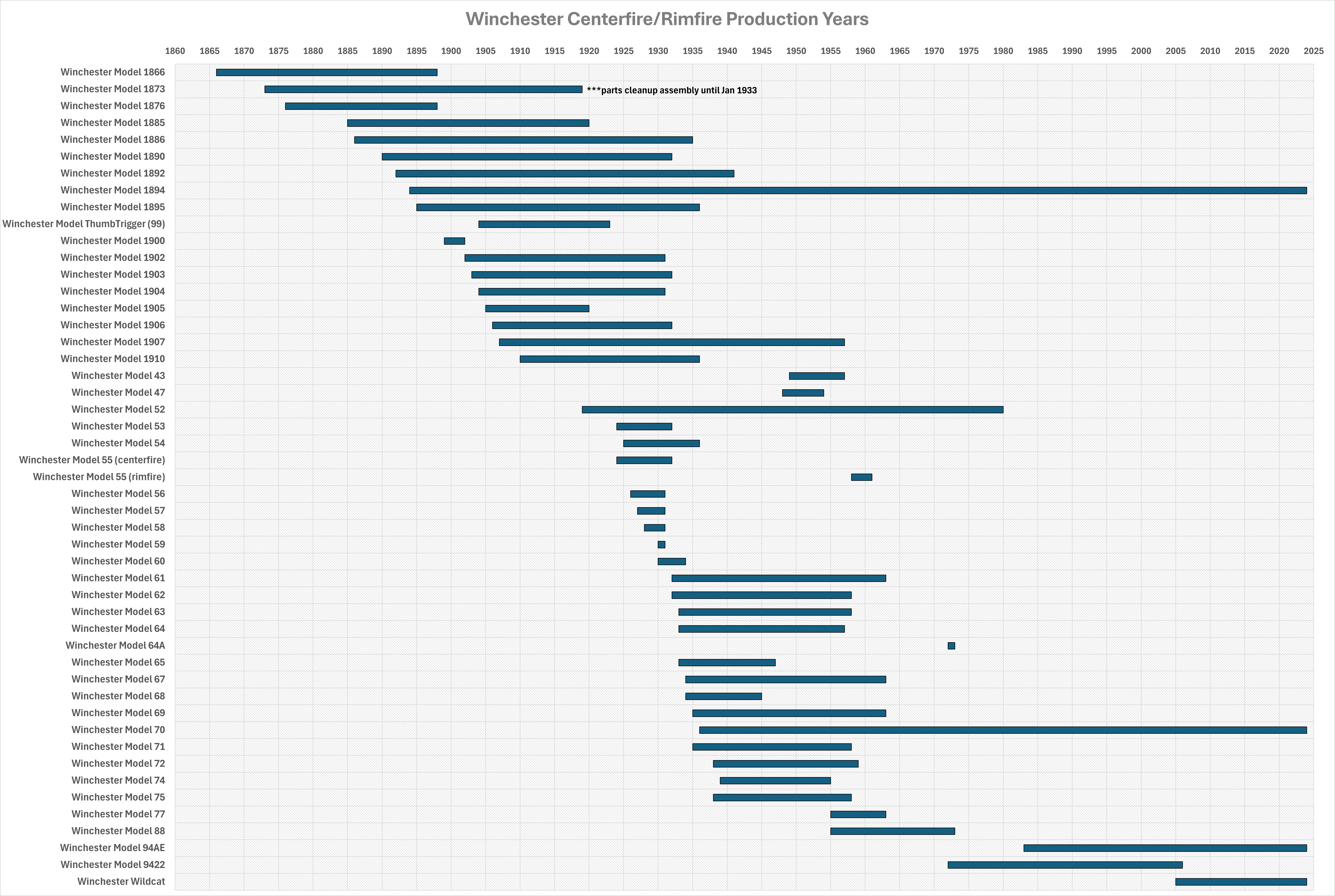

Forum Posts: 14841
October 29, 2024 - 9:15 pm
Jeremy P said
UPDATED:
RF/CF:
SG:
I gave you the wrong date for the Model 90 & 06 (I apparently fat fingered it again)… it should be 1942 versus 1941.
