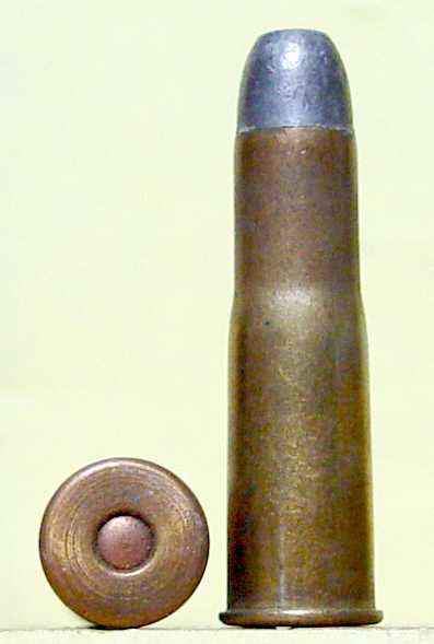

Another interesting piece of info I ran across when re-reading some books and searching the web is that cartridges produced prior to 1885 are un-headstamped and merely the cartridge box was the only reference of caliber of the cartridge.
Look here a little down the page on a topic of the early 45-75 box.
http://www.oldammo.com/january11.htm
Its interesting to note because prior to 1885 Winchester produced 7 or more of there own calibers and a slew of there competitors calibers.
