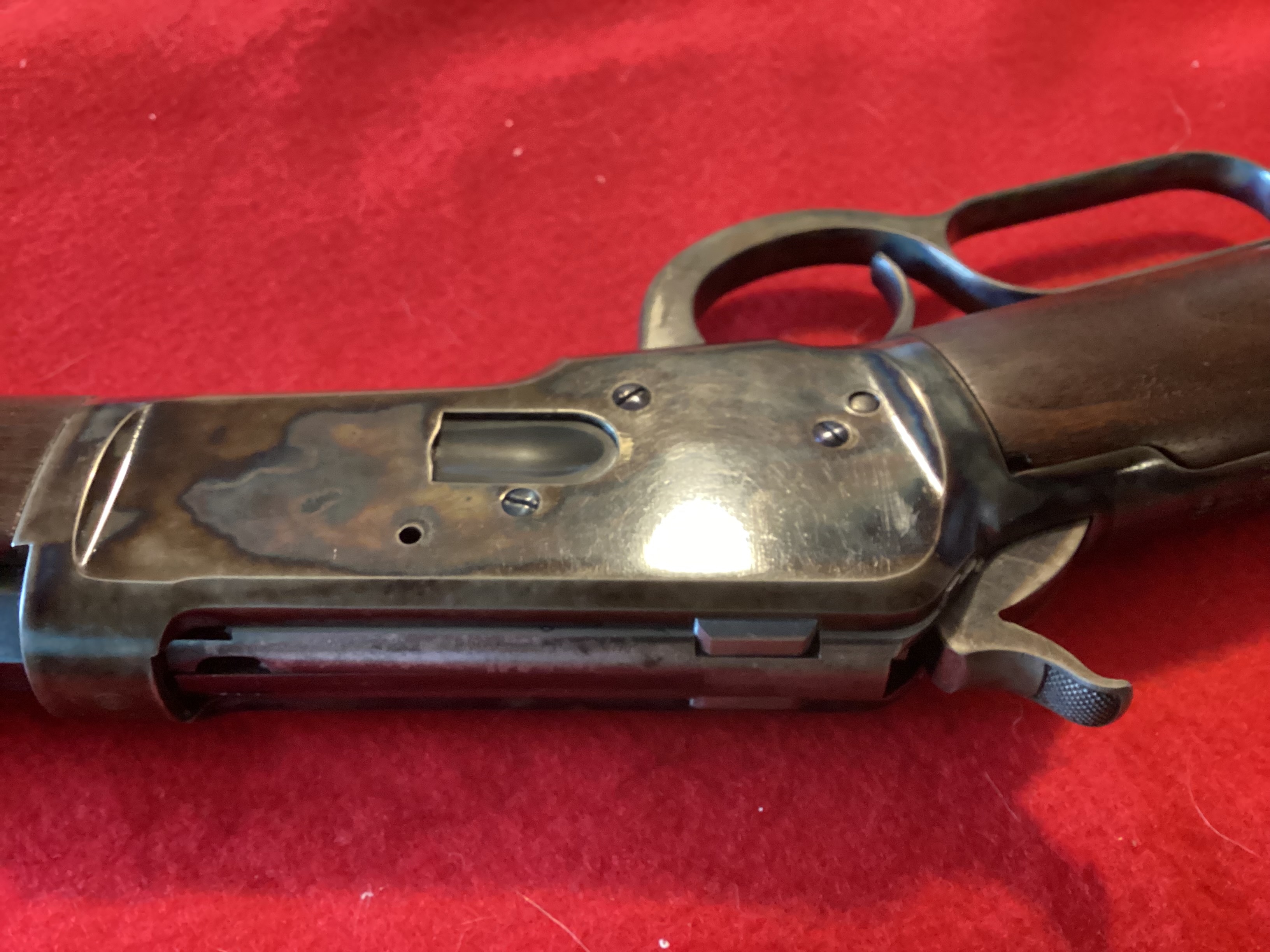

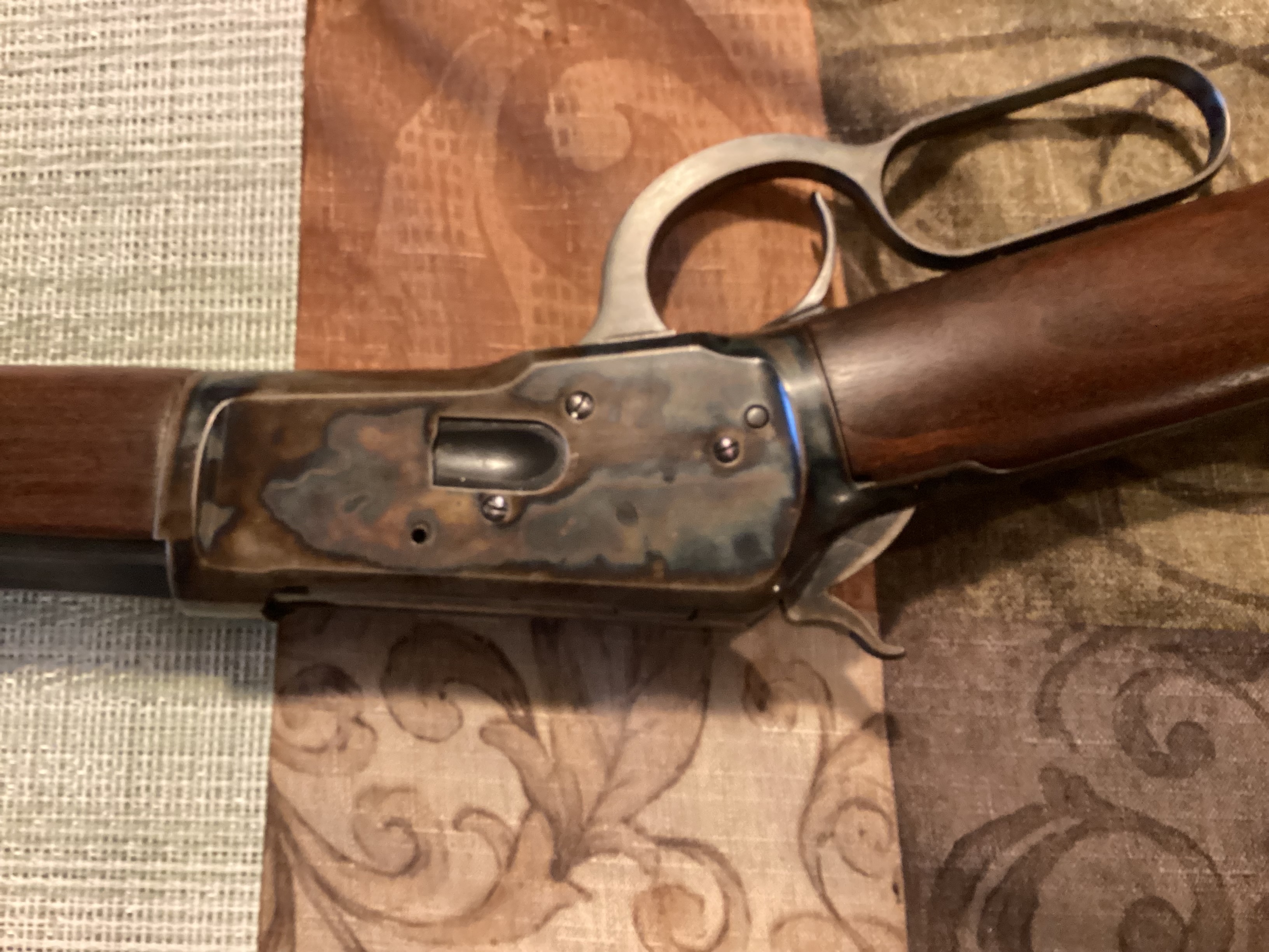

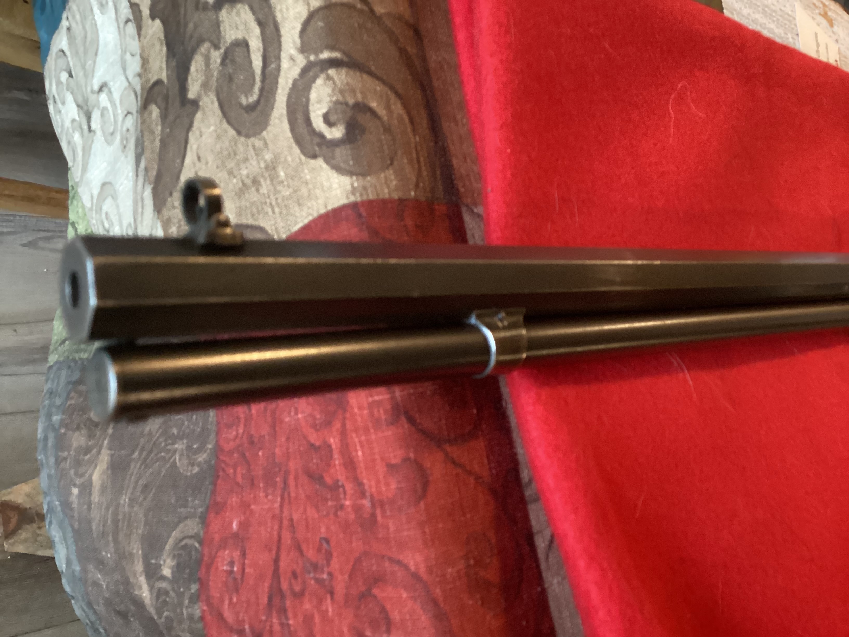

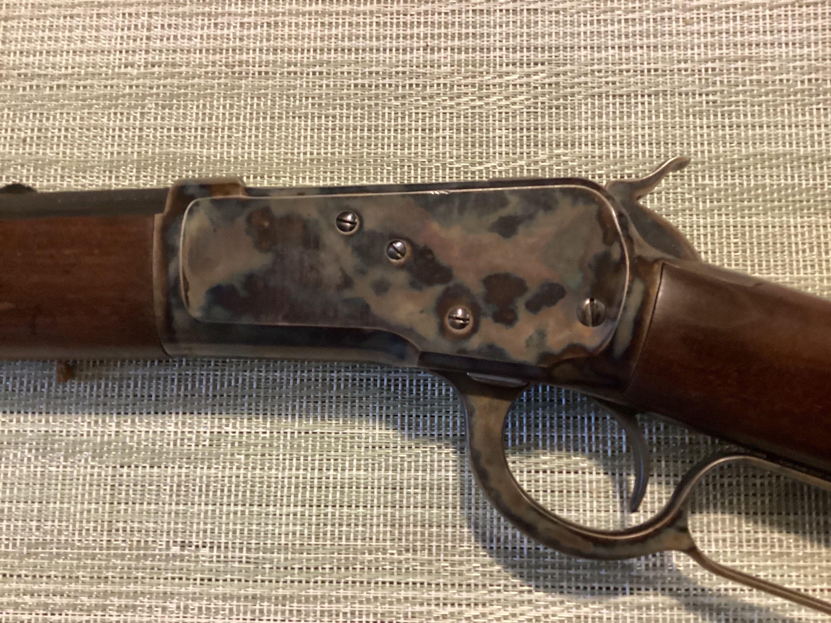

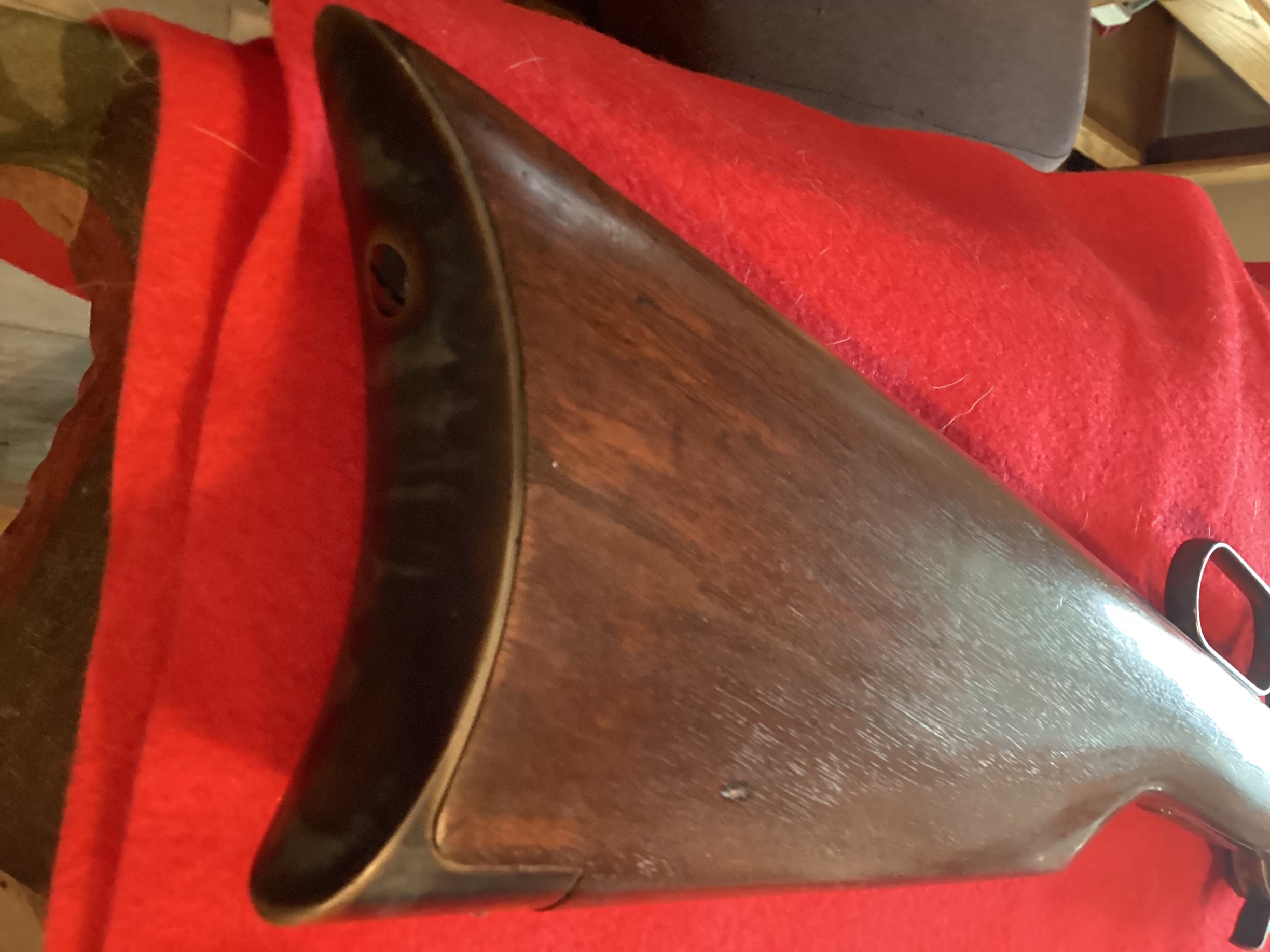

Folks: I have a Winchester 1892 Case Colored, 25/20 caliber, 24” Octagon barrel, Made in 1910 with factory letter. Barrel retains 90% + or – original factory bluing. Stock is in excellent shape. Barrel is bright and shiny, great rifling,. Case colored by experts. You have to hold it to really appreciate it. I’ll sell it to one of our members for $4200.00. I just listed it on GI for $5200.00. Call me at 541-726-0187. Bill

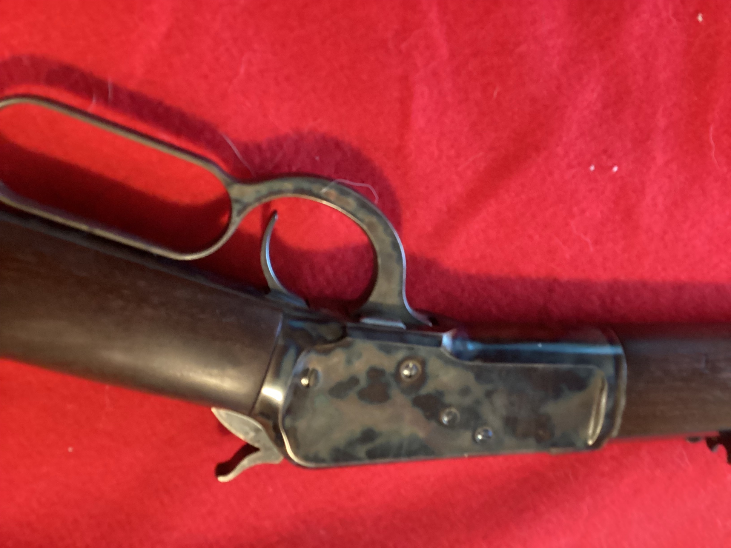

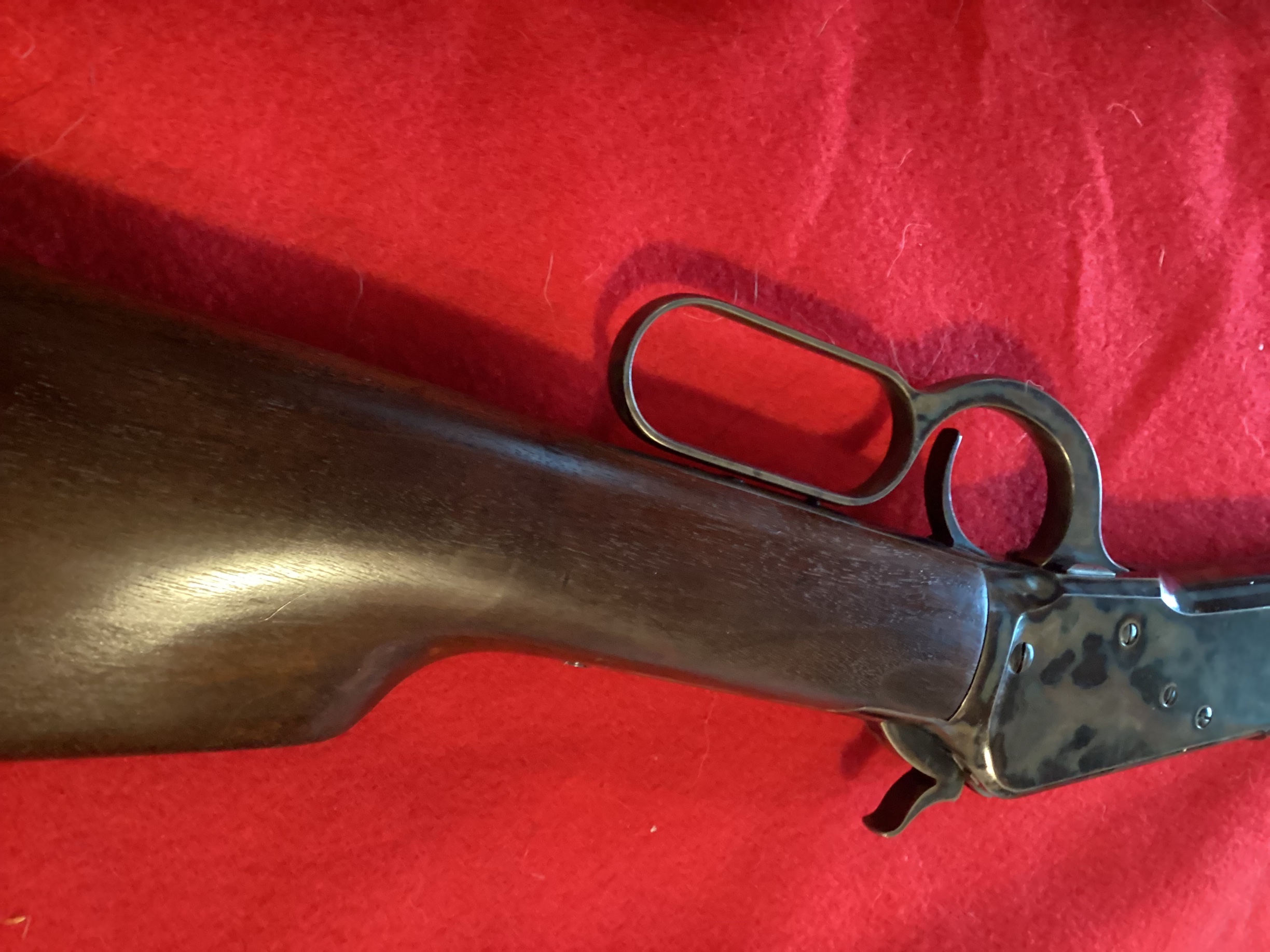

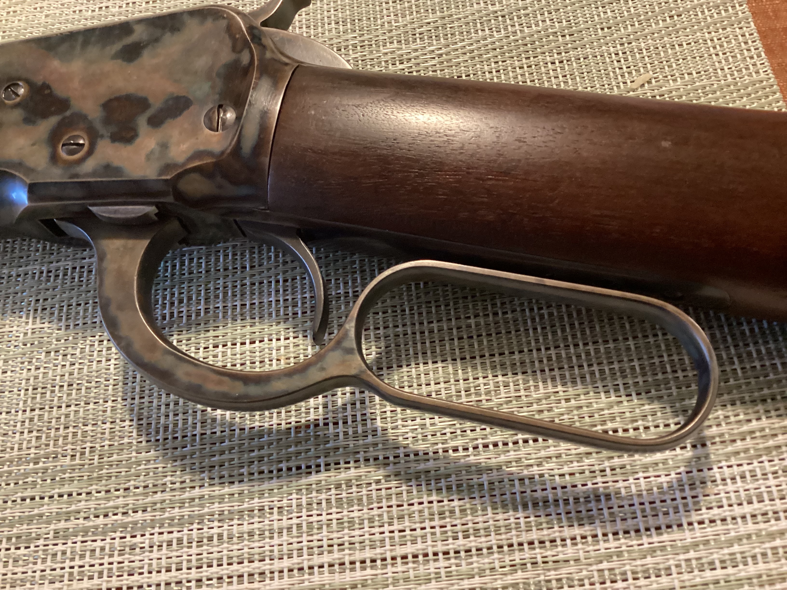

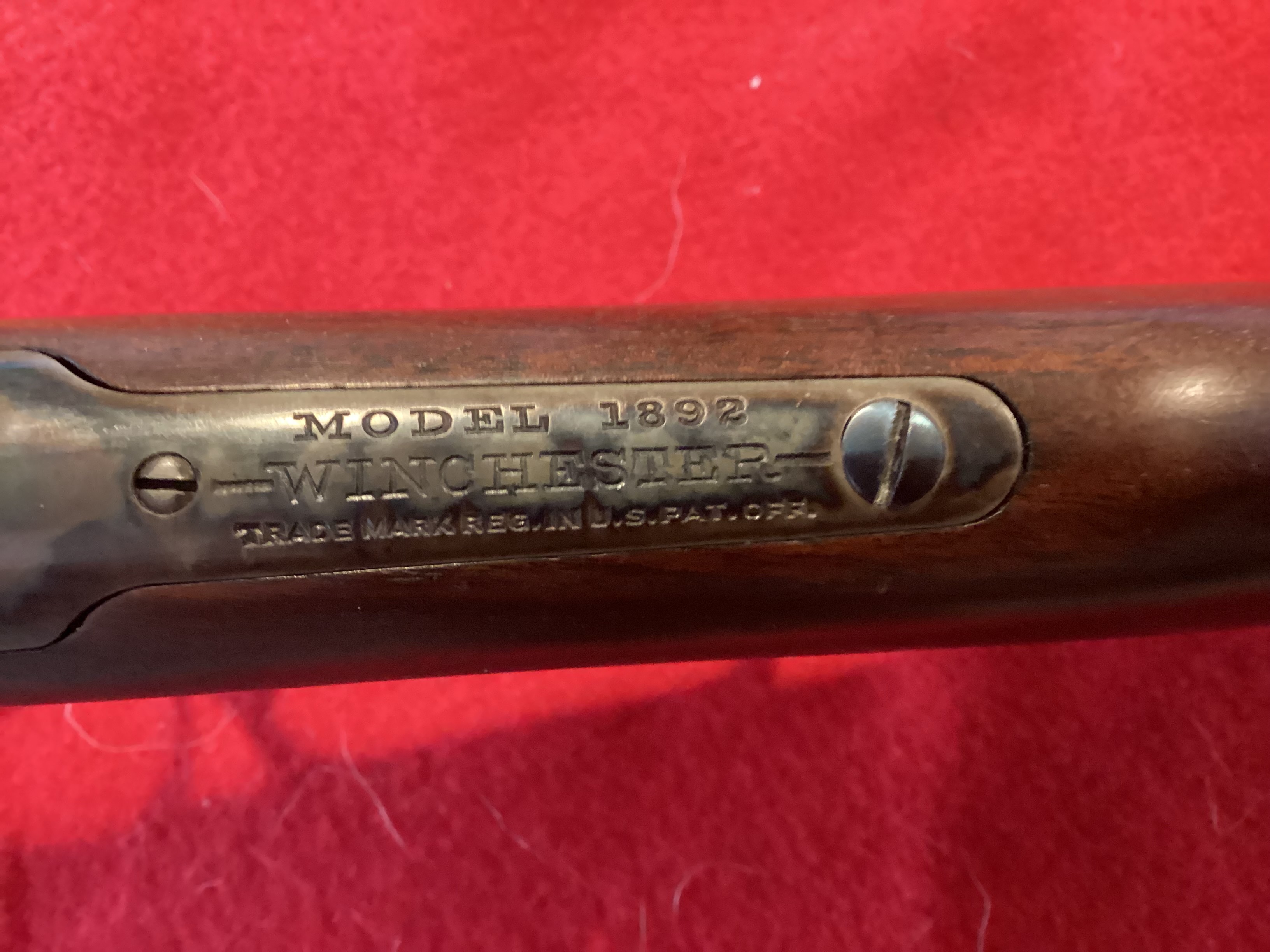

Bill,
Just an observation for you to consider… your Model 1892 rifle most definitely does not retain “90% + or – original factory bluing“.  The refinished (case colored) receiver frame retains 0% of its original factory bluing.  While it is highly likely that the hammer, lever, and the butt plate were originally case color finished, they also now retain 0% of their factory original finish due to being refinished.  What you have is an incorrectly refinished/restored rifle.

I amended the add to clarify the bluing aspect. The rest of the add speakers for itself. I hope this sets you somewhat at ease? I have a lot of money into this gun, I am not giving it away. It has a good home.

Bill,
Just an observation for you to consider… your Model 1892 rifle most definitely does not retain “90% + or – original factory bluing”.  The refinished (case colored) receiver frame retains 0% of its original factory bluing.  While it is highly likely that the hammer, lever, and the butt plate were originally case color finished, they also now retain 0% of their factory original finish due to being refinished.  What you have is an incorrectly refinished/restored rifle.
Bert for my own education do you mean it simply should not have been refinished/ restored at all or what was done was done incorrectly? Just trying to learn as it looks very pleasing to the eye. Thanks

I agree with Bert.  This rifle has been restored and not by an expert.  The case colors aren’t right and the wood no longer fits the metal.  This is an example of a rifle that most likely will sell for less than the restoration costs.  But if you like it buy it.

I’m not afraid to step over the line on this one and be extremely Honest!
That is not only not original as other well known members have stated but it’s UGLY!!! IMHO!

That is a $1500 92 at best.

What was done was done incorrectly… it should not be case color finished.

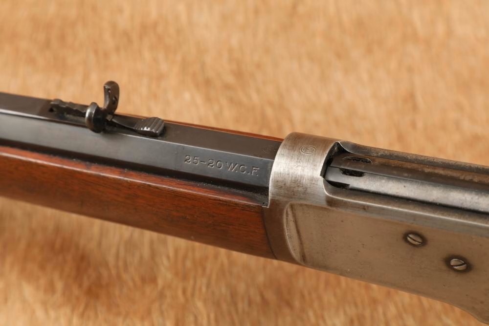

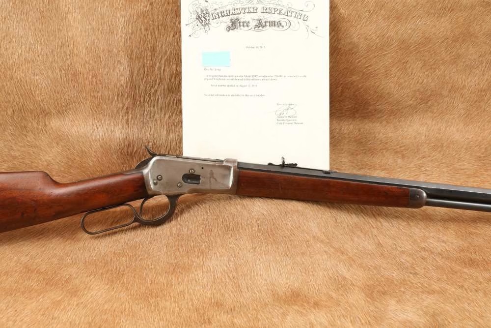

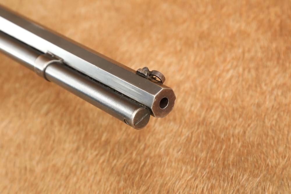

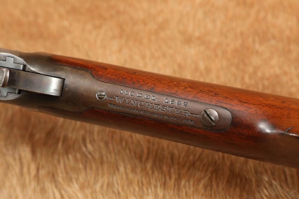

Here is the rifle when it was sold on Gunbroker during August of 2025 by LS&G in Cody, WY for $1100.

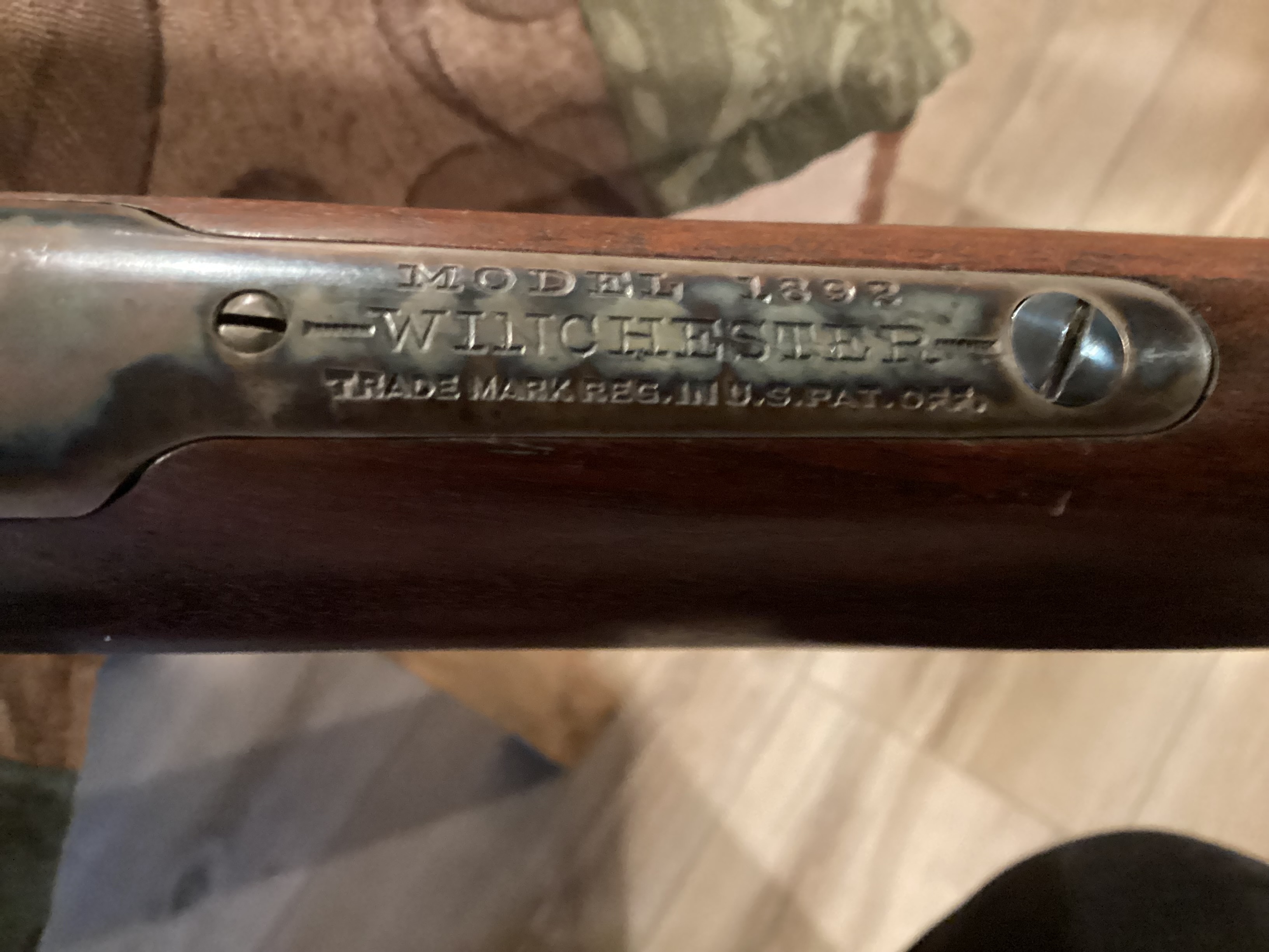

Thanks Michael! I know it could be the light in the 2 different listing pics but is the wood even the same? Seems like a darker stain in the new pics and when I look at the new pics of the tang vs the originals it goes from a very tight fit to a loose fit with gaps? This post has been very educational and am appreciative of the knowledge being shared! Just my opinion but I think the original poster (Commissioners) motives here were pure. It wasn’t that long ago, Bert and some of you were kind enough to share with me “Why” restoring a Winchester is a bad idea and should only be considered in a couple unique circumstances. Prior to that, I honestly thought restoring a Winchester would be a cool thing to do. I now know that is beyond stupid but most importantly I know “why” because you guys took your time to educate me! Appreciate everyone and apologize for my annoying questions.
Forum Posts: 2756
April 8, 2026 - 11:31 am
 I wouldn’t be surprised at all if the wood has not been cleaned up a bit after the sale at Cody.  A rifle should have the same amount of wear on all of its surfaces if it is original.   Just think of how weird it would look for an old rusted and beat up old rifle would look if it had pristine and un scratched wood on it.  So in this case the opposite would be true also.  The original barrel was in pretty good shape so when the receiver was refinished the wood had to “catch up” to the now overall unmarked condition of the metal.  Hence the need to be sanded and refinished so that it did not look obviously out of place.

Michael,
You really brought this rifle to it’s true demise, and by that I mean you brought it out into the light, of what was truly done to it, making it easier to tell, that the top tang shows the wood to metal fit, was interrupted, by being sanded and the fit was ruined. Amongst the other things that were pointed out and brought to our attention by the members.
The case colors having a muted look to them that is clearly not right. Makes me wonder if the 92 receiver works properly, as it’s an Art form to Block it properly to stop the heat from expanding and preventing the action to work smoothly as designed. Hence, a lot of grinding and filing is needed to fit it properly, but they never seem to operate as smooth as original again. IMHO!
This is another good example of not checking here first, and buying online before verifying.
To me, I liked the rifle the way it was, as being used and all correct!
Now the rifle is listed on G.I. and nothing is said about being refinished or the receiver being Case Colored, when it should be a Blued receiver!
