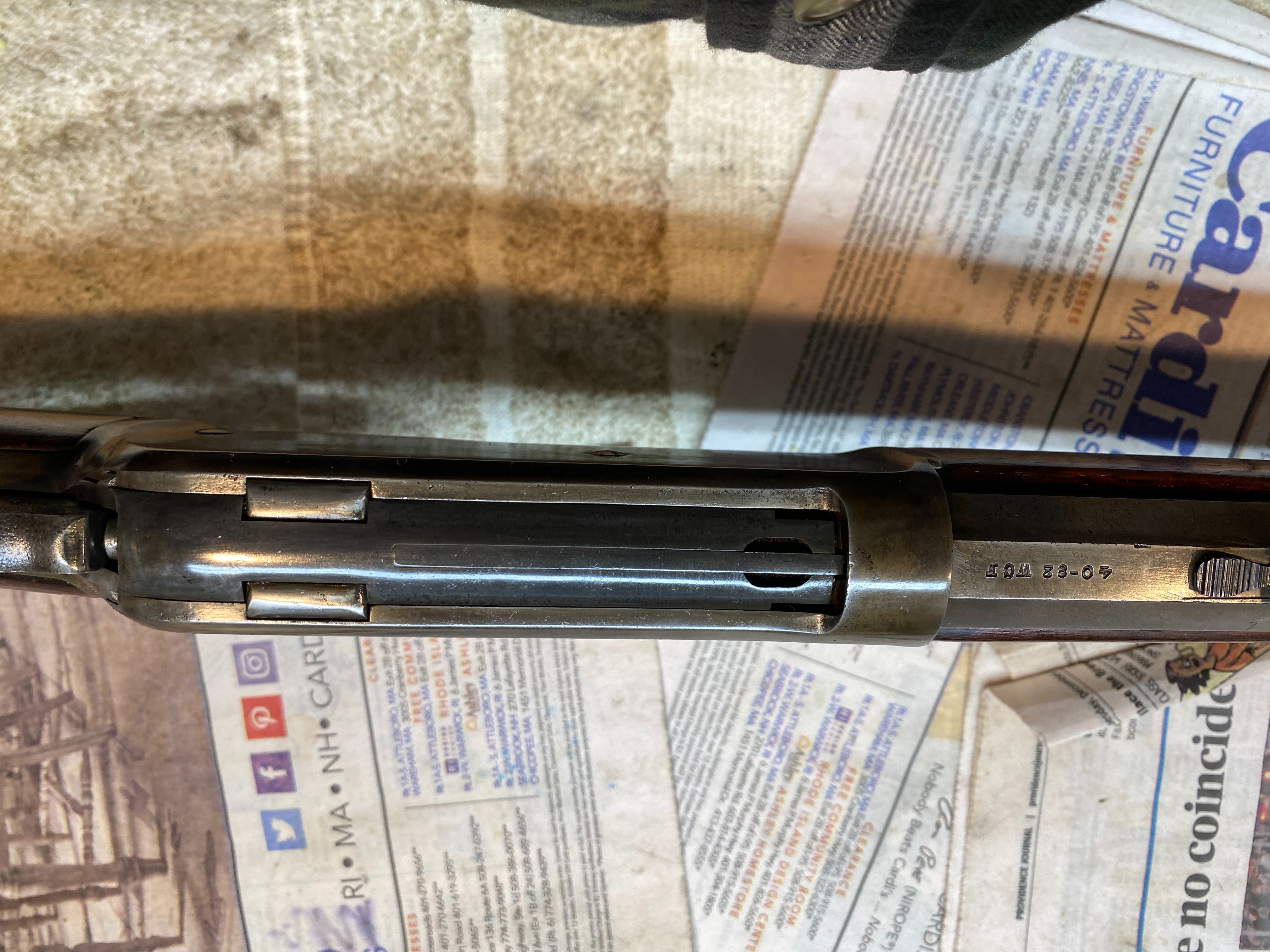

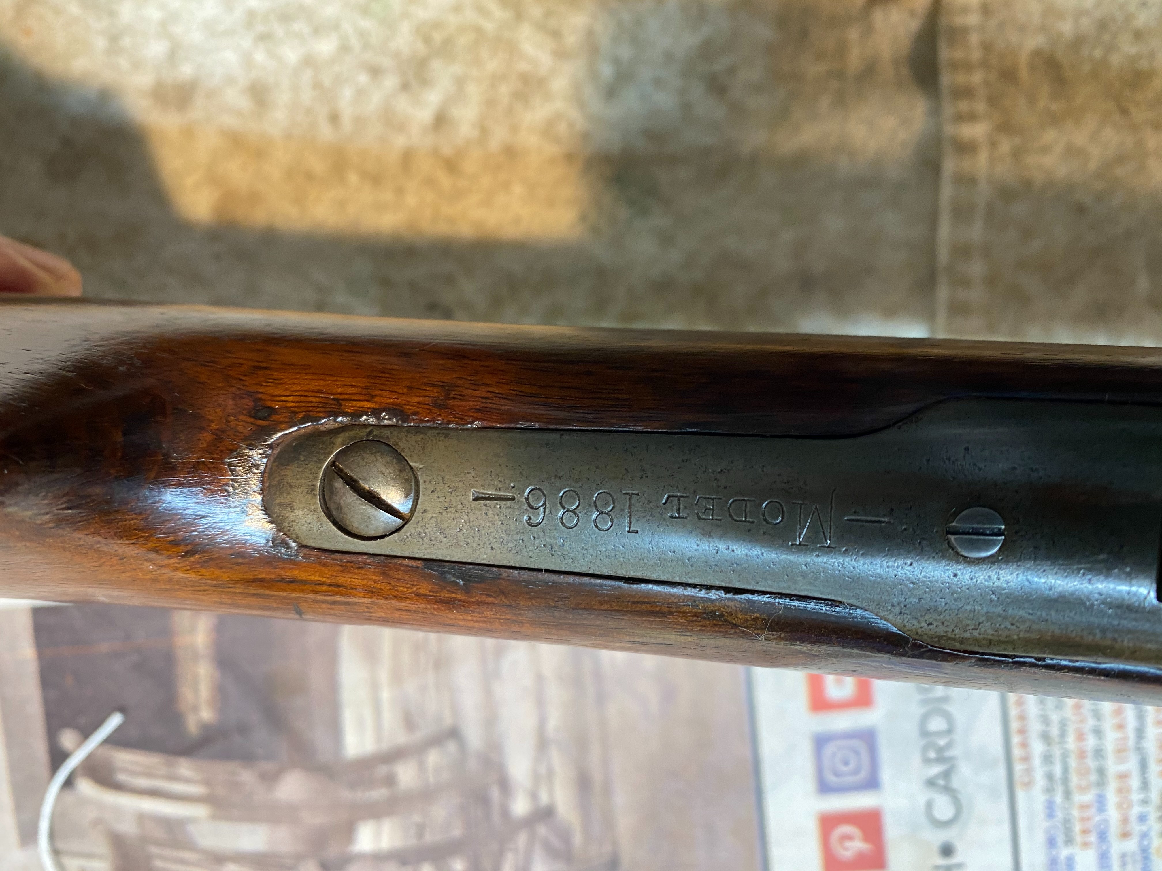

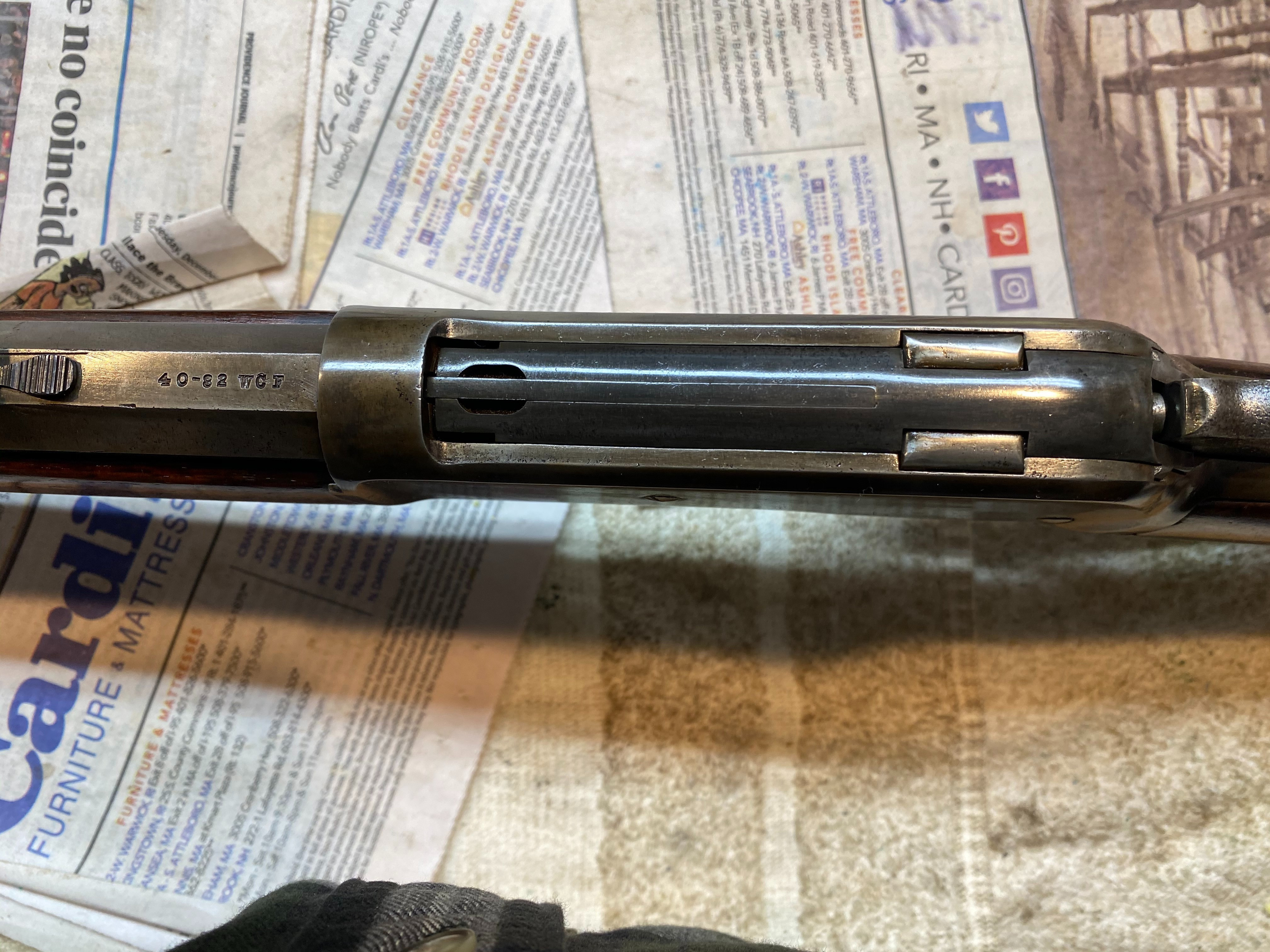

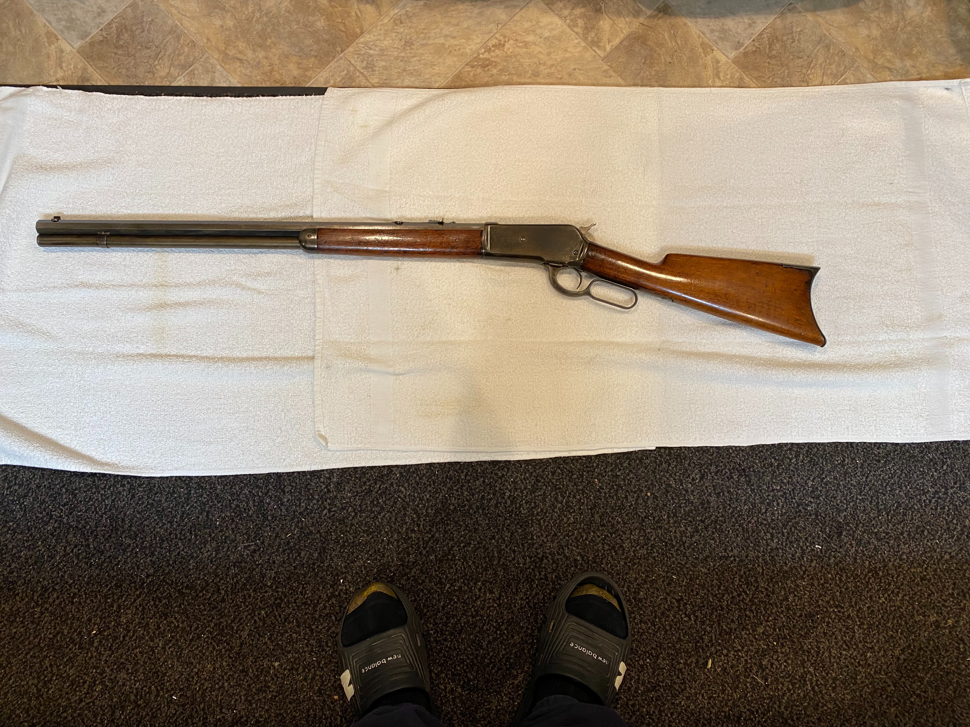

Here are some pictures of this 1886 serial #27504 which makes it an antique. All of the pre-1898 86’s had case harden receivers. Other than the bore, I believe it is in good condition for a rifle over 130 years old. The screws are in good condition, The wood is in good shape. I thioght I made a good deal until I saw the circle in the bore.
A few have remarked that I should shoot it to see if the accuracy has been hurt. However, finding 40-82 ammo is not easy. The collectible stuff that $8-$10 a round is too expensive to shoot.

The barrel has been worked on but to what extent you would have to post more picture. The caliber stamp is not original.
Forum Posts: 2008
February 12, 2021 - 2:49 am
 Richard, I don’t think that gun is worth spending any more money on. The wood is under size, metal is cold blue and smooze, wrong sights, and the barrel markings look small. It’s worth half what you paid. Like I said before, I’ve made bigger mistakes than that. Learn from it and get help before you buy. Have the members on the Forum critique the gun before you buy. T/R
Yeah I noticed that as well. If you look closely you can see were each number/letter was individually stamped. The ‘W’ and ‘C’ even bounced and made a slight double stamp. The original caliber markings were applied all together at the same time and not individually stamped.
If the replacement barrel is a shooter, it would be fine to have some plinking fun and/or you don’t have to worry about taking it hunting.

I figure you have a bulge in the barrel and the outside has been worked down and removed the obvious signs.
I didn’t look at the magnified image until just now, but the crude hand stamping is so obvious that even the auction house crooks can make no excuse for missing it.
This fraud would almost make me mad enough to hire a lawyer, except that I know it would be sink me even deeper into the hole.
