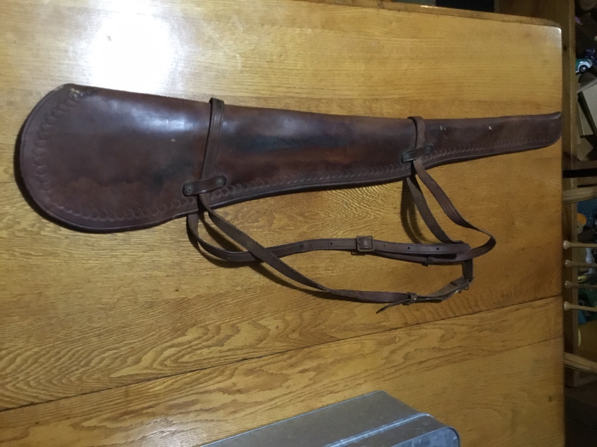

July 7, 2024 - 2:36 pm
Note the condition of the leather in the auction listing as compared to this scabbard and shotgun case.  In the attic of a house in Connecticut built in 1910, virtually undisturbed since the original owner’s death in 1949 until removal in 2021.  Not evident is the DRY ROT of the stitching.  No firearms contained within, as they would be in a dismal state.  This is how leather would be when exposed to between 72 and 111 years of oppressively hot summers and brutally cold winters, and a wild swing in temperatures over a short period of time fairly regularly.
