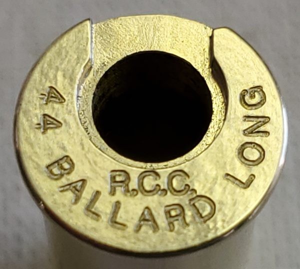

I don’t think you were following what exactly I was saying. Using this guy’s brass you can make a reload using a 22 R.F. blanks as the primer, and make a reloaded cartridge for firing in the rifle “As Is”. No reforming and using different brass, No changing to a center fire block, No changing to firing pin, No lining the barrel!
Here is an example of his brass in 44 Ballard Long.
The only drawback I see is that you have make sure to align the cartridge case up with where the rim-fire firing pin is going to hit the head of the cartridge. But for a Single Shot, that is not that big of a deal in my opinion, especially for target shooting.
