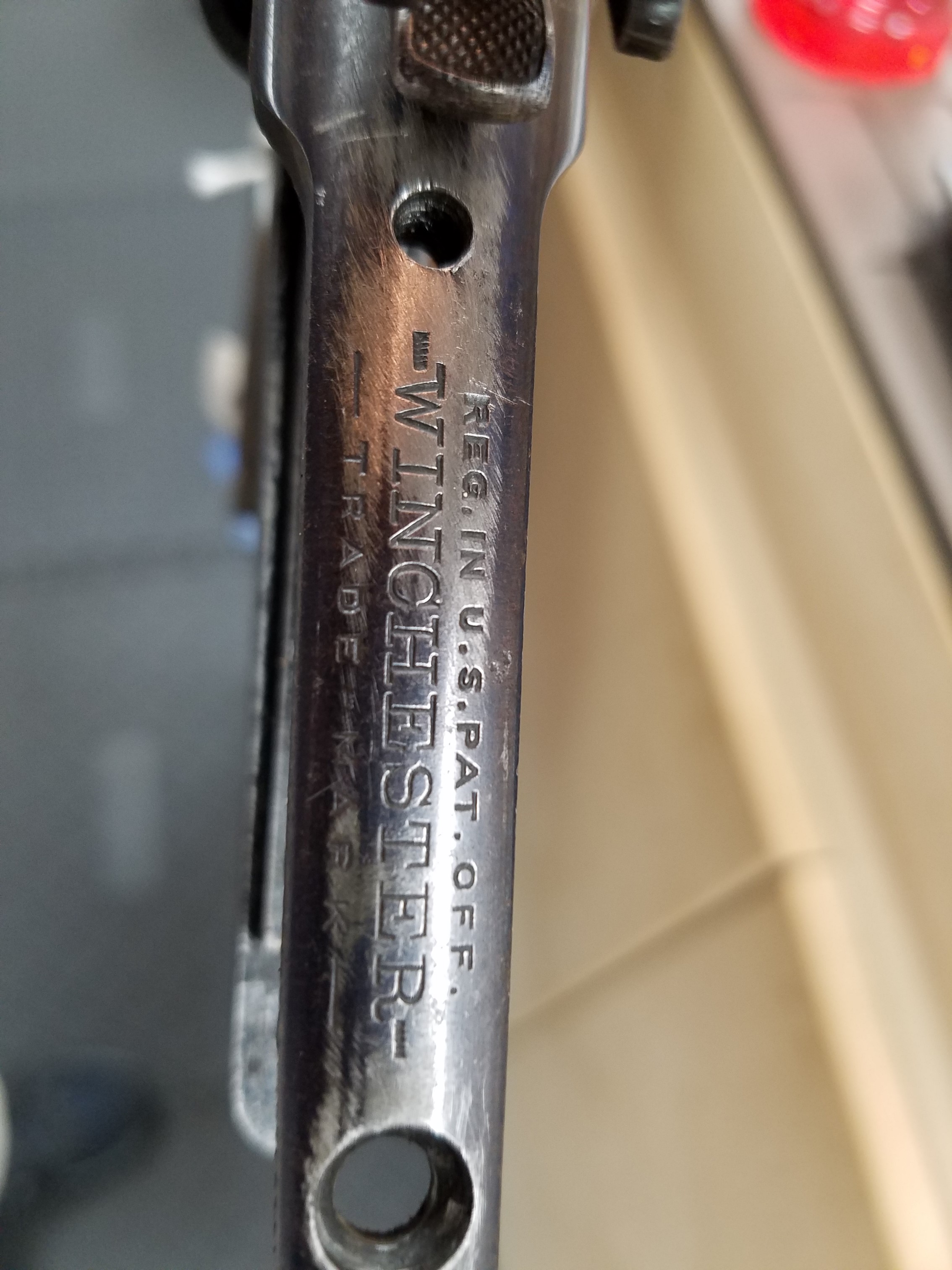

All, a rookie here again.
I have purchased a nice 1892, 25-20, with a Lyman 1A DA, 1909 vintage.
As I was cleaning it up, removed the tang sight and noticed that there was no model number.  Checked it everywhere and found none.  Not sure what this means, but it is puzzling.  Has anyone seen this before?  thanks, Elliot

This is a TYPE 7 upper tang marking and was intended for rifles made for export to Great Britain and colonies to meet their legal requirements.

There should be a model year stamped behind the hammer slot (or rarely, on the barrel) if it was shipped to Great Britain.  If not that means it was probably rejected by British customs and sold elsewhere.  As to the Lyman sight, I doubt that it was installed by Winchester and shipped that way if it was intended for the British market.  Most likely the sight was added later by a US owner.

thanks again, I don’t think it was shipped to GB, there are no English proofs anywhere.  If it were to have a Lyman, which one would be appropriate?

According to one publication the different styles of upper tang markings including the one without the model number have no effect on the “collectible value” of a specific carbine, assuming all else is factory correct.

I don’t think the absence of the model number does anything to the value. The condition is the main driver in value,any special order features, and in the model 92 the cal. The larger the better, the 44 is king! The lyman sight is worth 100-200 depending on condition.
