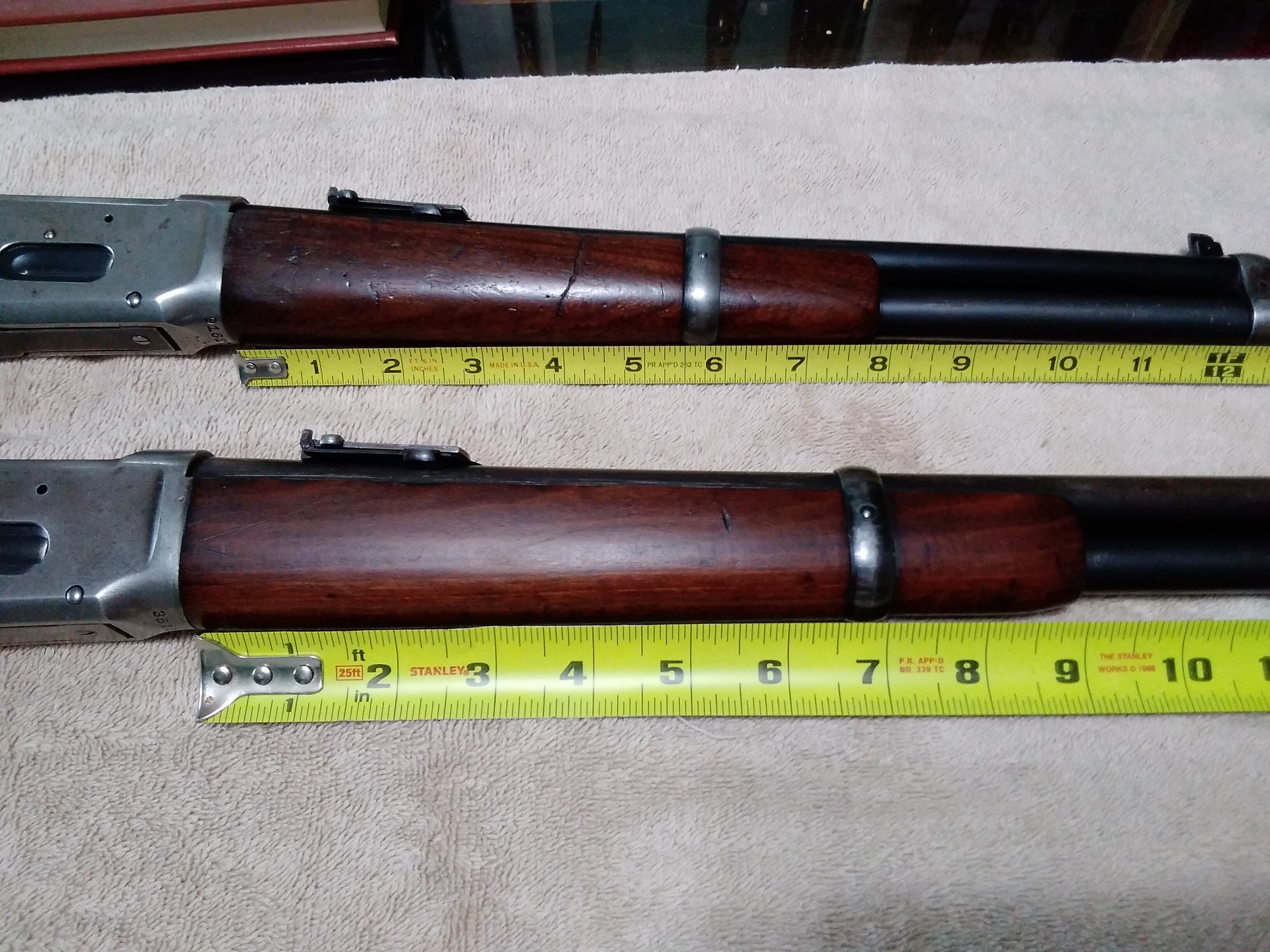

20210924_143319.jpg20210924_143339.jpg                                                                                                                                                                                       If You measure the forestock and it is 7 & 7/8″ it is probably a genuine trapper. If it was cut from  a 20 ” carbine the forestock would be 8 &7/8″. Highly unlikely the wood would be cut also. And further if You pull the forestock off the bbl. and mag are machined for the front band screw. If the bbl. was cut at the chamber, well that would be another kettle of worms. Unfortunate it’s to late to letter. Oh ya what shape is the gun in, finish etc. Being in Canada I can legally own that gun, and already have a couple
