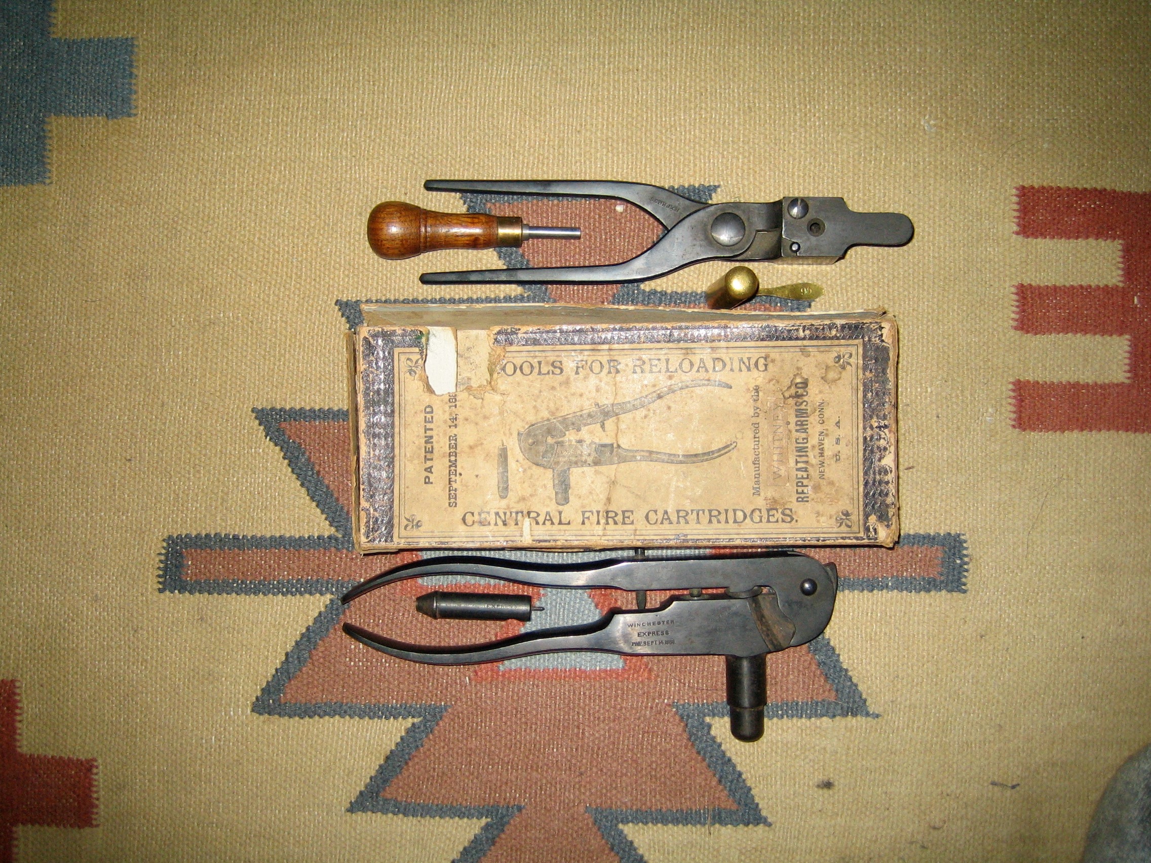

If you fellows could send me some photos of your stuff for my survey, I would very much appreciate it.

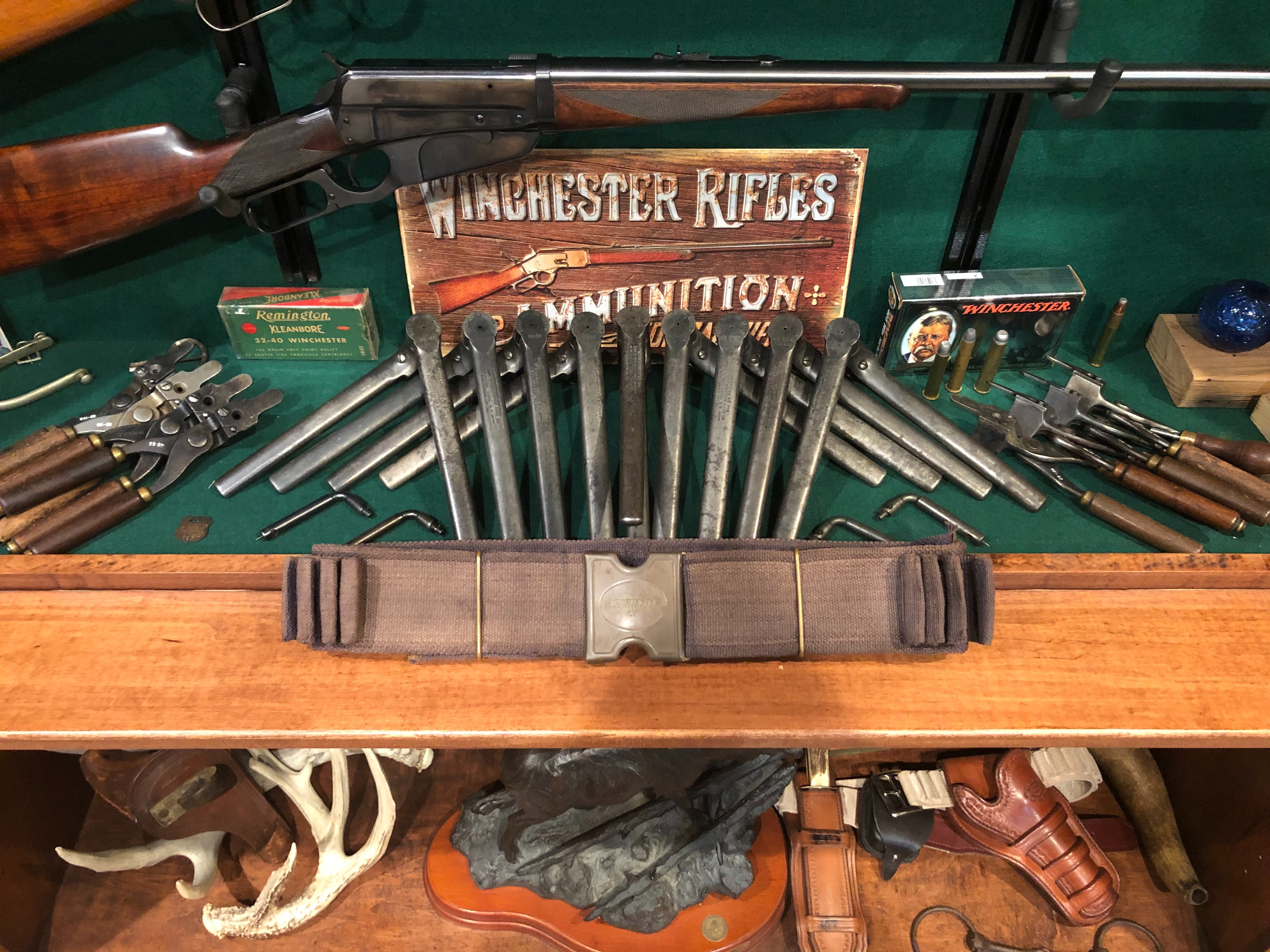

Maverick,
 I have all 9 calibers listed for the 1891 reloading tools and all bullet molds except the 45-70-500. Are you only interested in the 50-110 EX for your survey?

I like your Style! CoolThat is a very creative way to display the 1891 Tool! SmileLet me know if you find a nice way to display the 1888 Tool, as its a not very flattering to display.
Yes I’m interested in discussing all of them for my survey. You can PM me or send me an email. I have found some variations on how they were marked.
