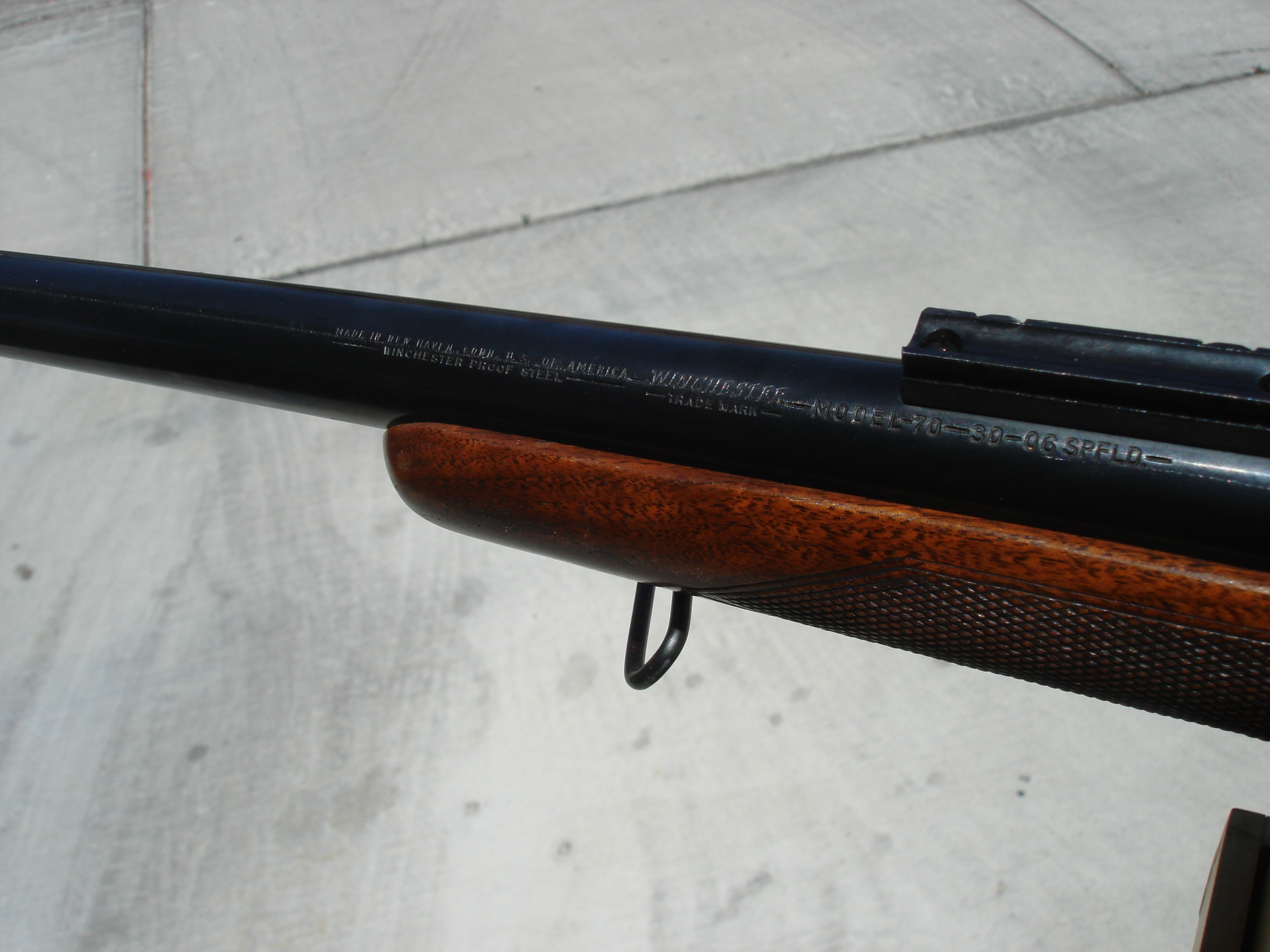

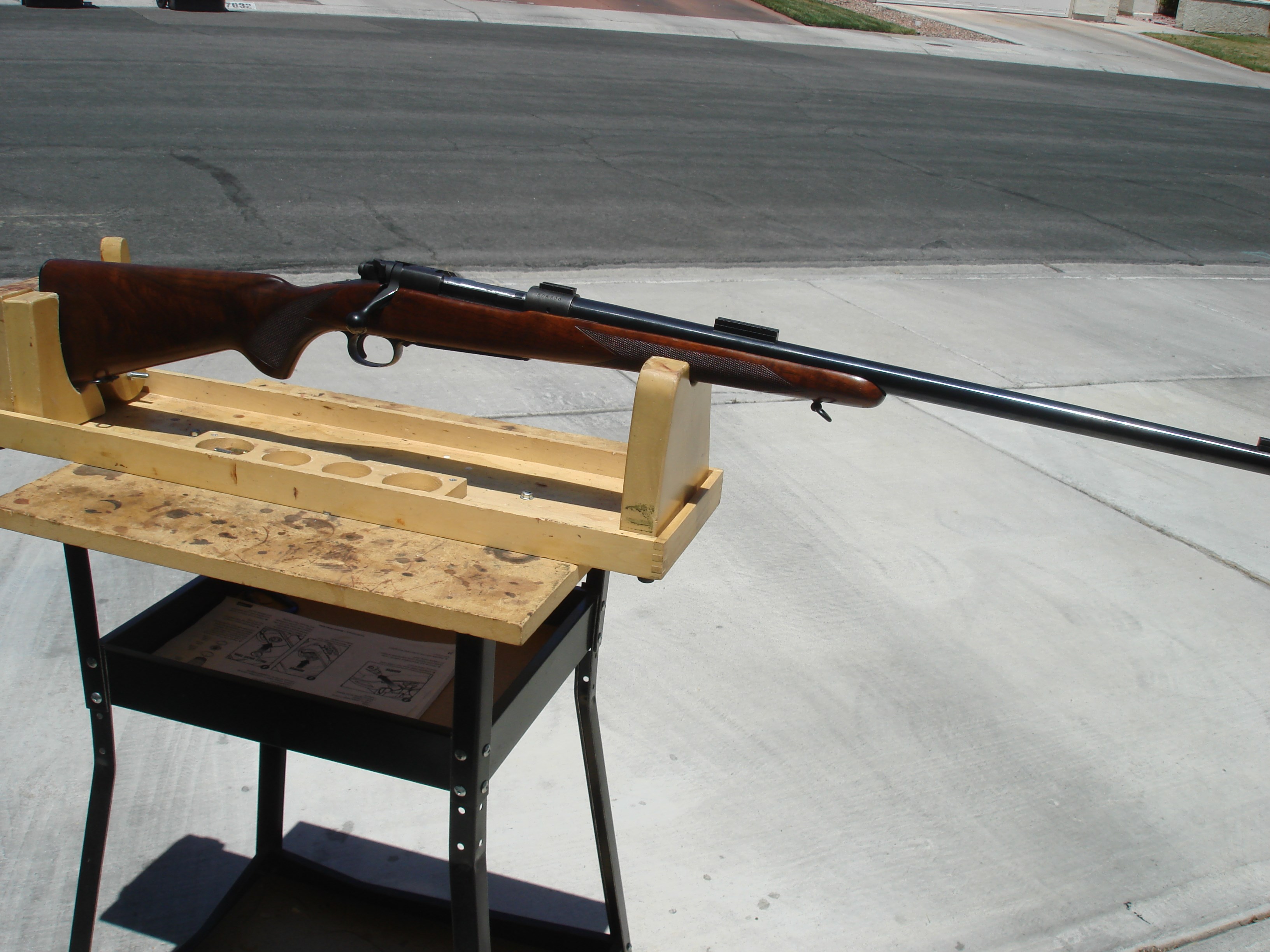

DSC00073.JPGDSC00074.JPG I just came into possession of a Pre-64 (Post War) Winchester Model 70 in an unusual configuration.   It is .30/06 and has a 24″ medium weight target barrel, block mounts for a target scope and a block mount for a front sight but no rear open sight and is in a SPORTER Stock!  The barrel has Winchester markings and the entire rifle appears to be factory original.  Rule’s book has pictures of similar rifles in the Special Order chapter, but all those pictured were Pre-War.  I also can find no reference in his book about this being a cataloged configuration.   I’d like to know from an expert if this rifle is a Special Order or not and an approximate value.

June 1, 2017 - 11:21 pm
What is the serial number, is it possibly a Van Orden?  I have a similar looking Van Orden Model 70.

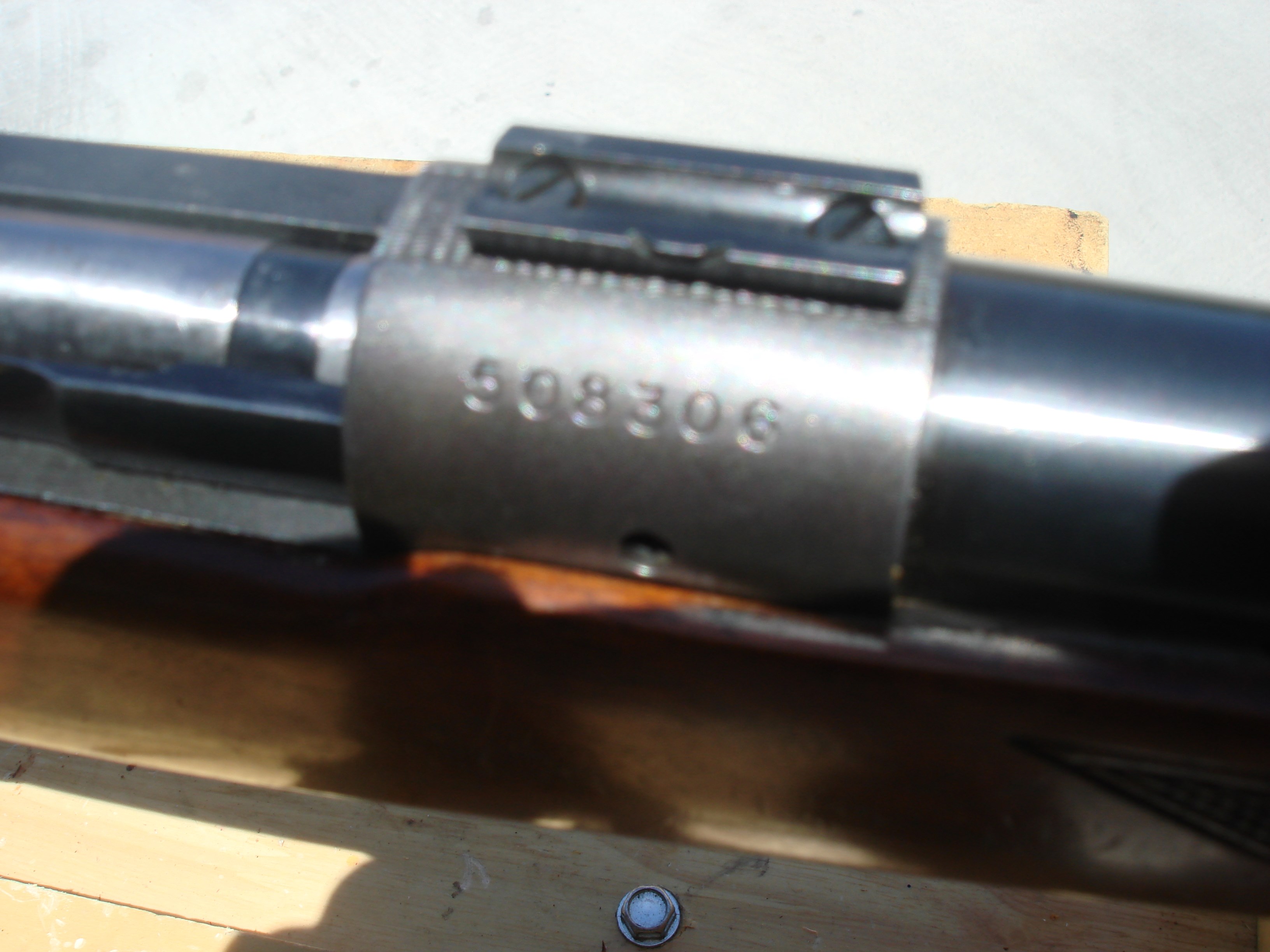

It fits the description of a Van Orden in all respects other than the stock is checkered and the serial number is out of the range listed (508XXX) in the list I found on one threads for which you provide a link.  No US Property Markings.   No appearance to have ever had a rear-open sight on her.  Serial Number dates to 1961.
I’ve had her to the range and she is impressively accurate.

My first inclination is that you have a target rifle that has been put in a standard sporter stock. Based on what little I can see in pictures, action appears to have the “clip slot”, which at that time was only available on the Target model. Some more pictures of rifle would help a lot. Does it have a steel or plastic buttplate? The steel buttplate was superceded with the plastic version in the mid to late 45XXXX range or around 1959. Also, you have the standard low comb stock which was dropped from production sometime around 1959 or 60. I would like to see a good clear picture of barrel channel to determine if it is factory inletting or has been widened from a standard configuration barrel. Does it have a screw hole in bottom of forearm where the standard barrels were fastened, and is there any residual indications in barrel channel for the enlargement for rear sight knob on barrel? Lot’s of questions to answer to make an accurate answer.

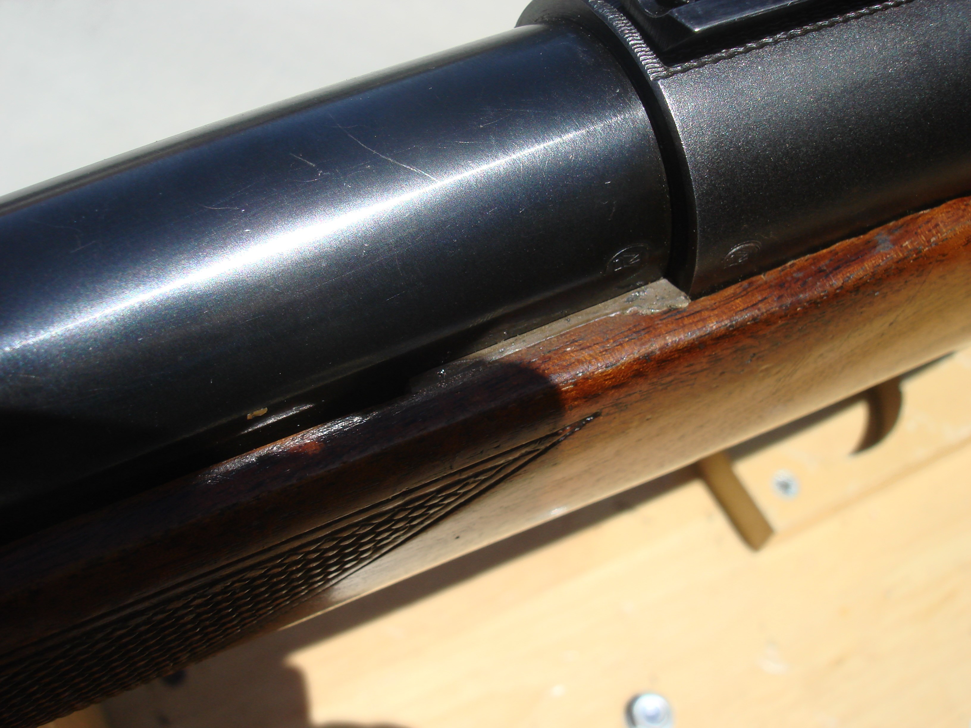

Steel Butt Plate.  I am reluctant to remove the rifle from the stock for fear of boogering up the screws or effecting the superb accuracy, but I can see that there has been glass bedding.   Yes, it has the screw hole with screw attaching the barrel to the fore arm.

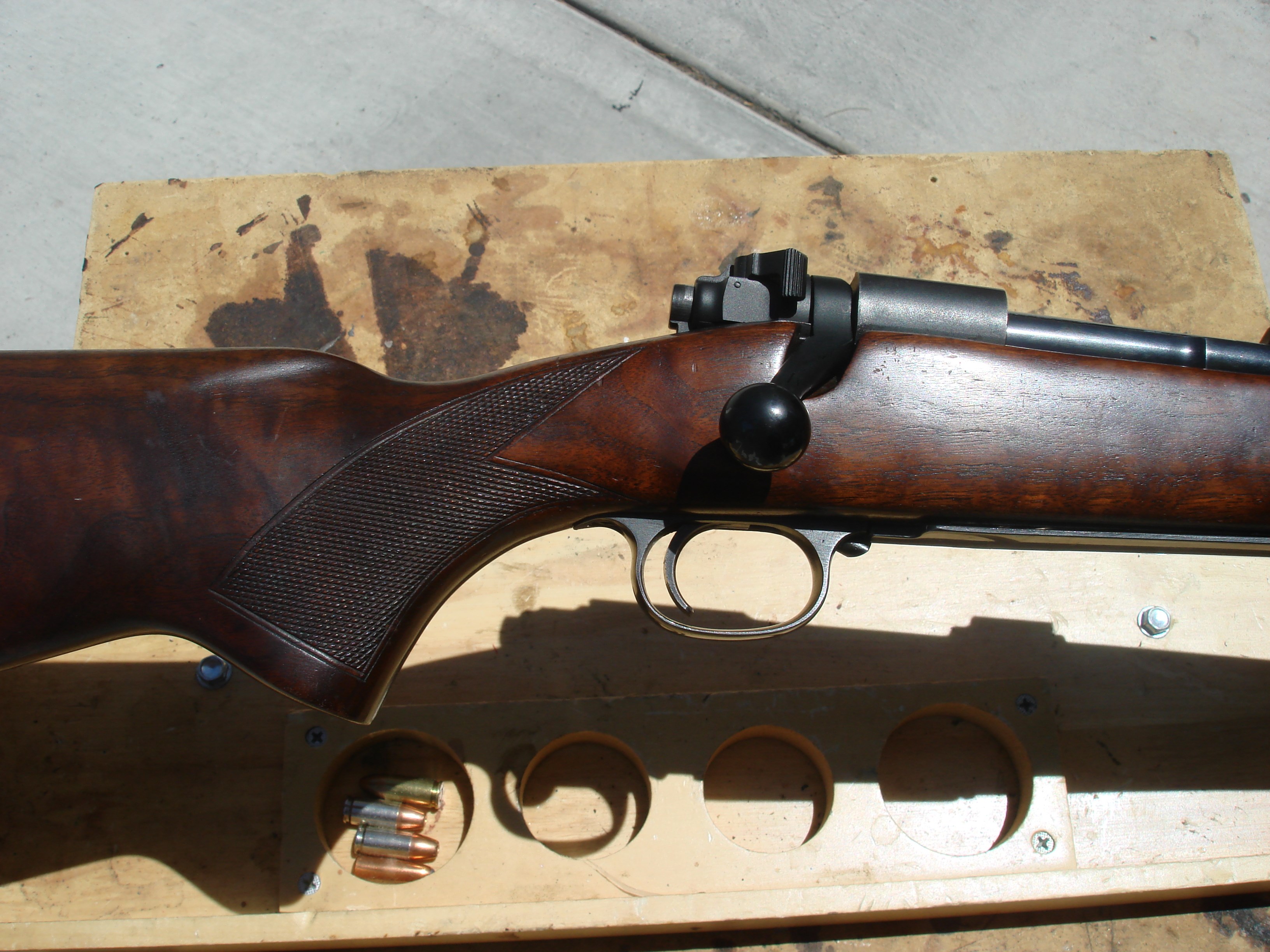

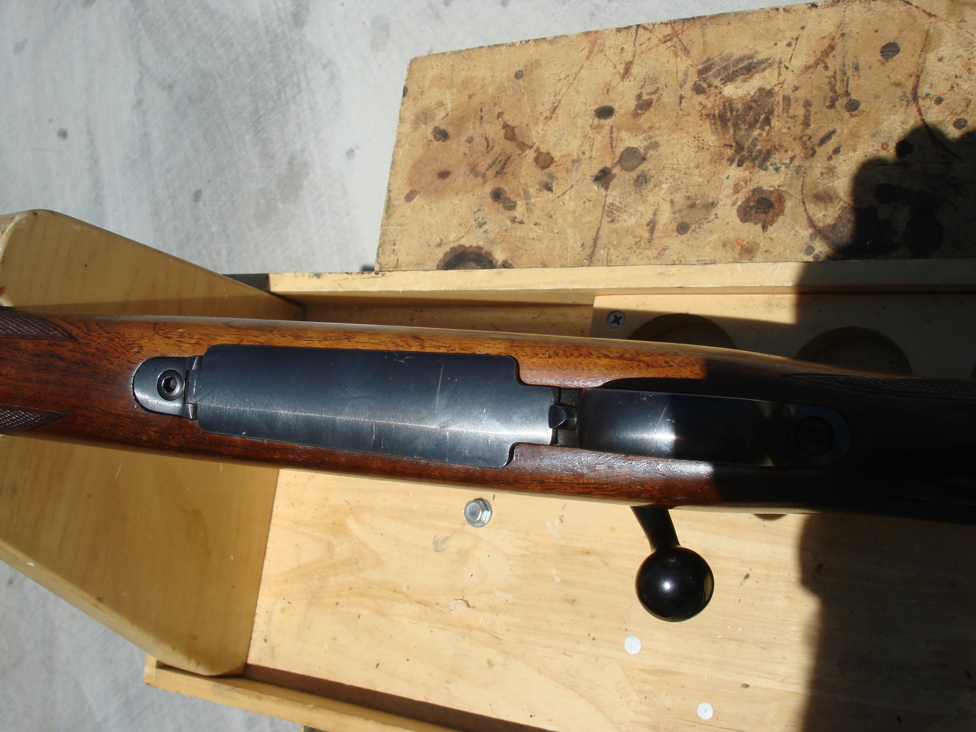

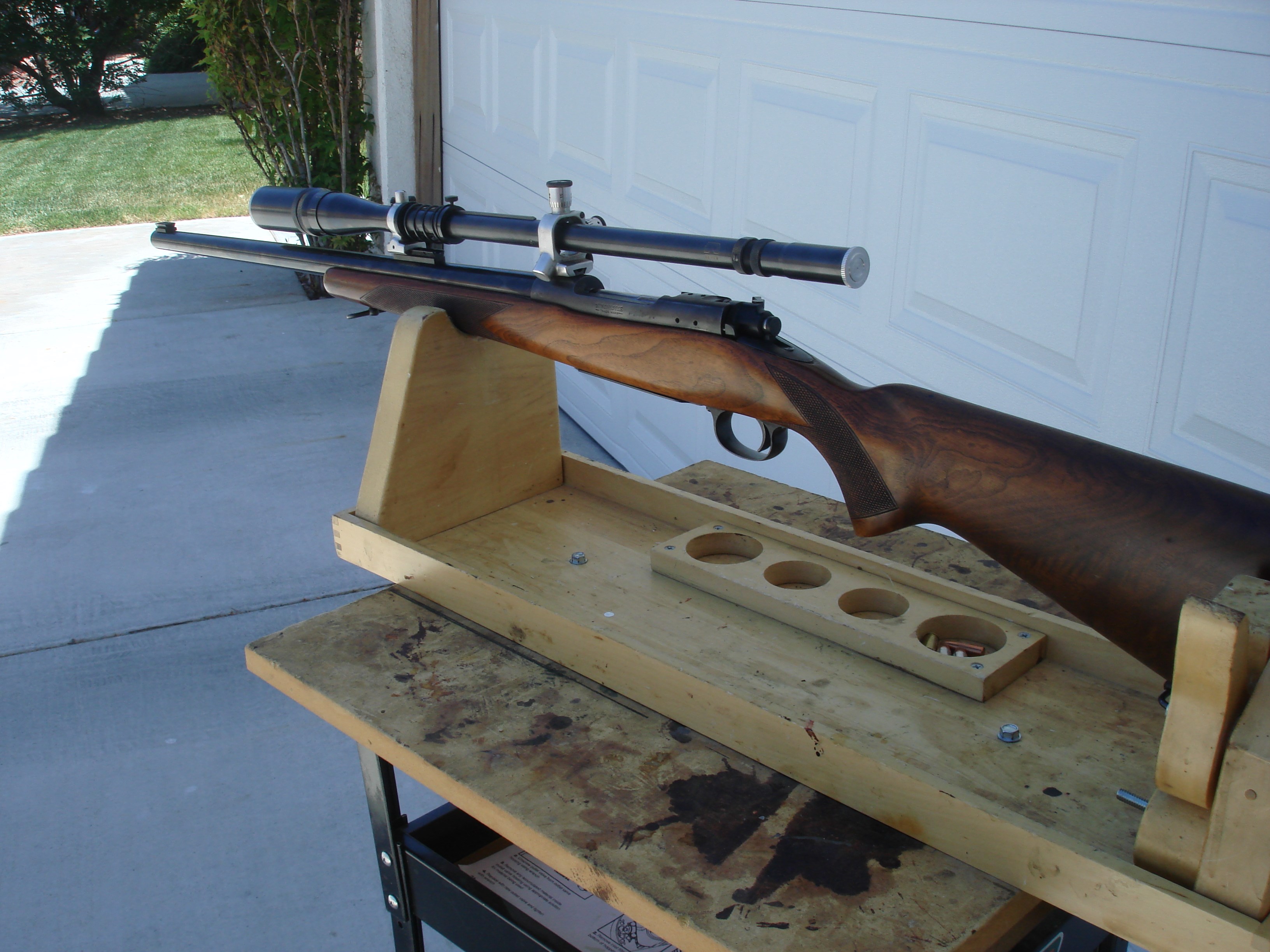

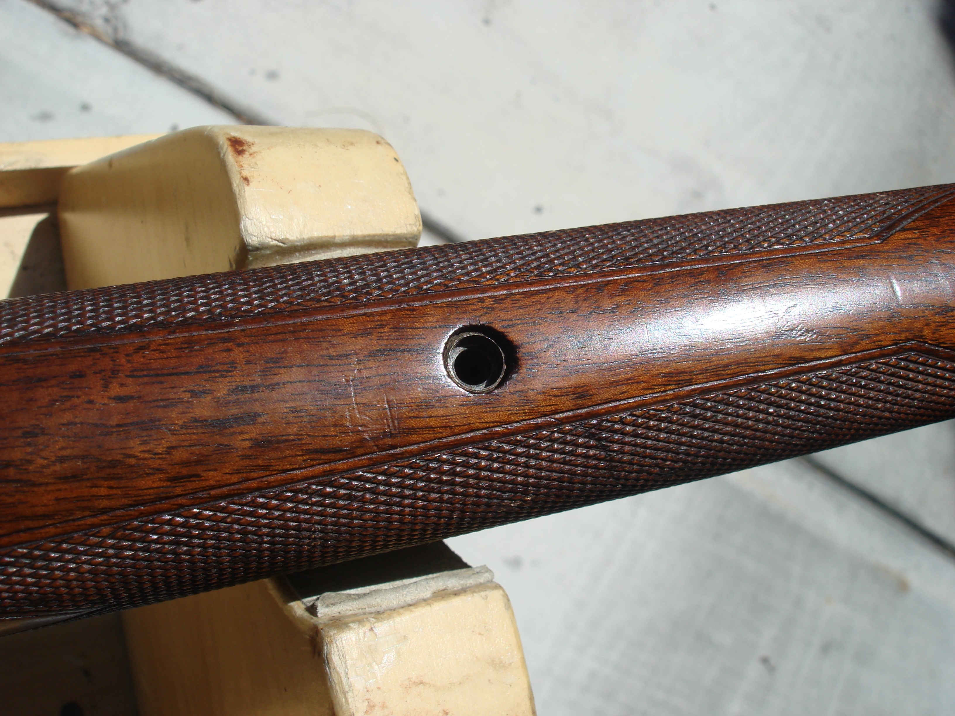

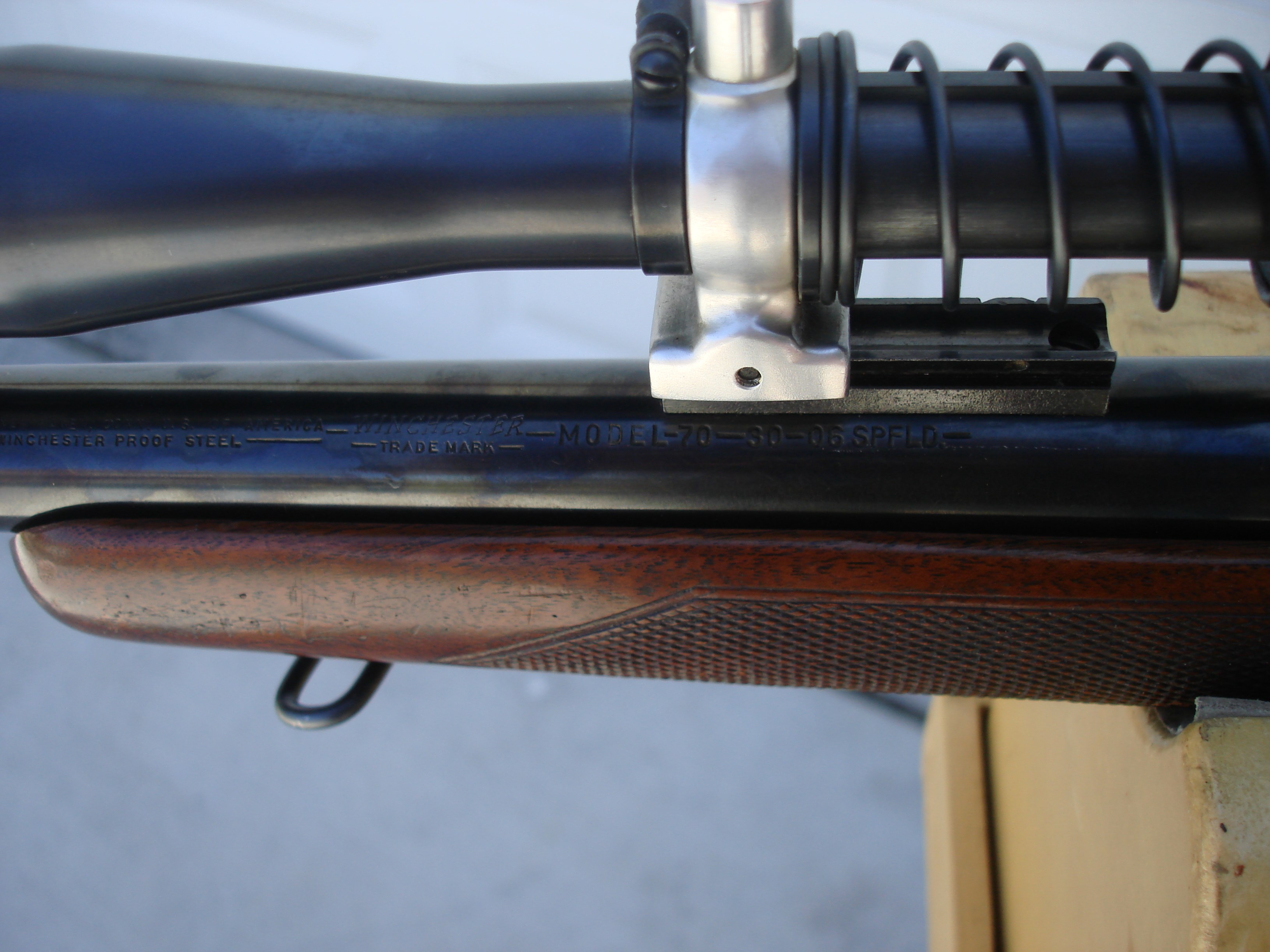

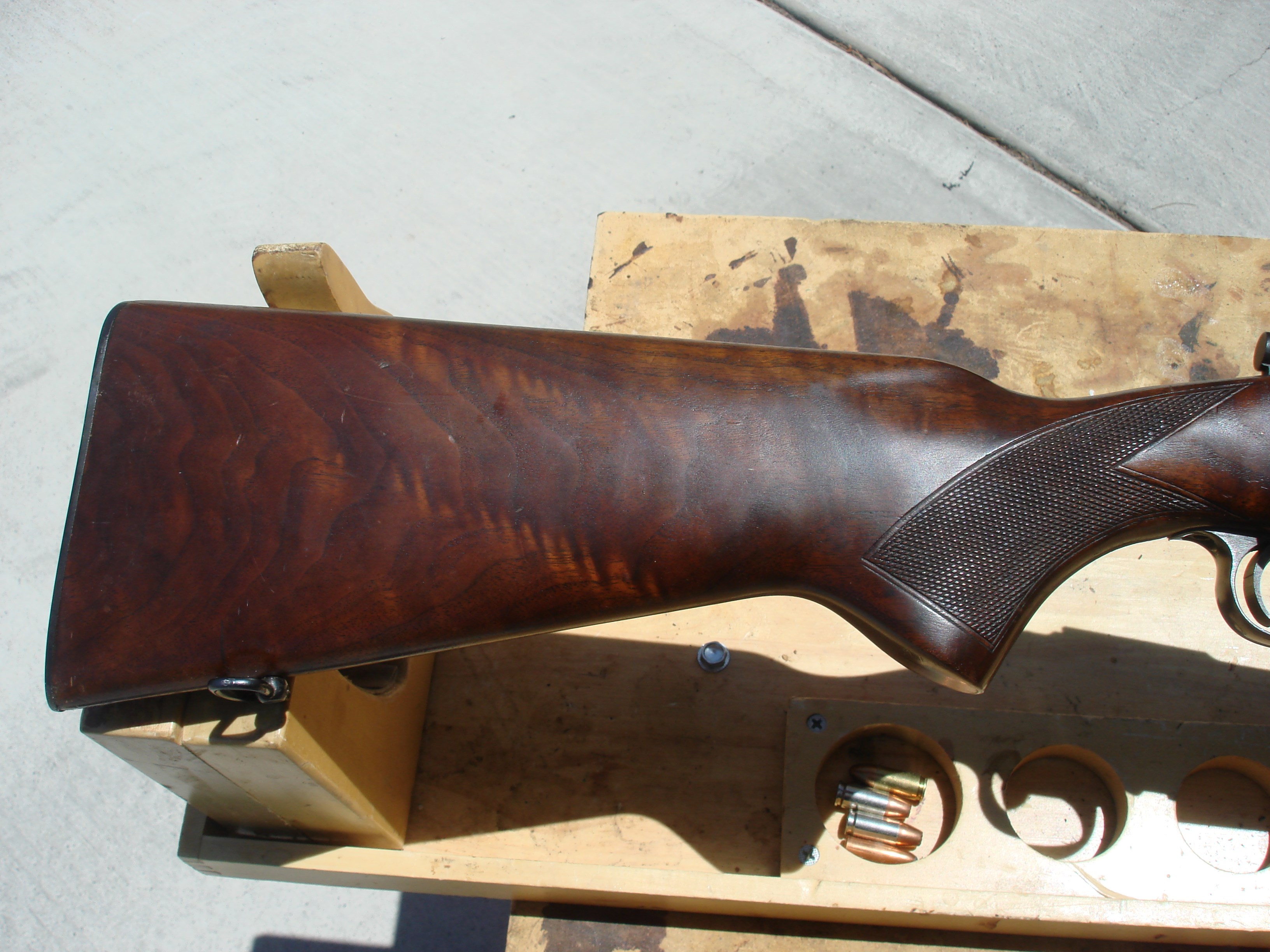

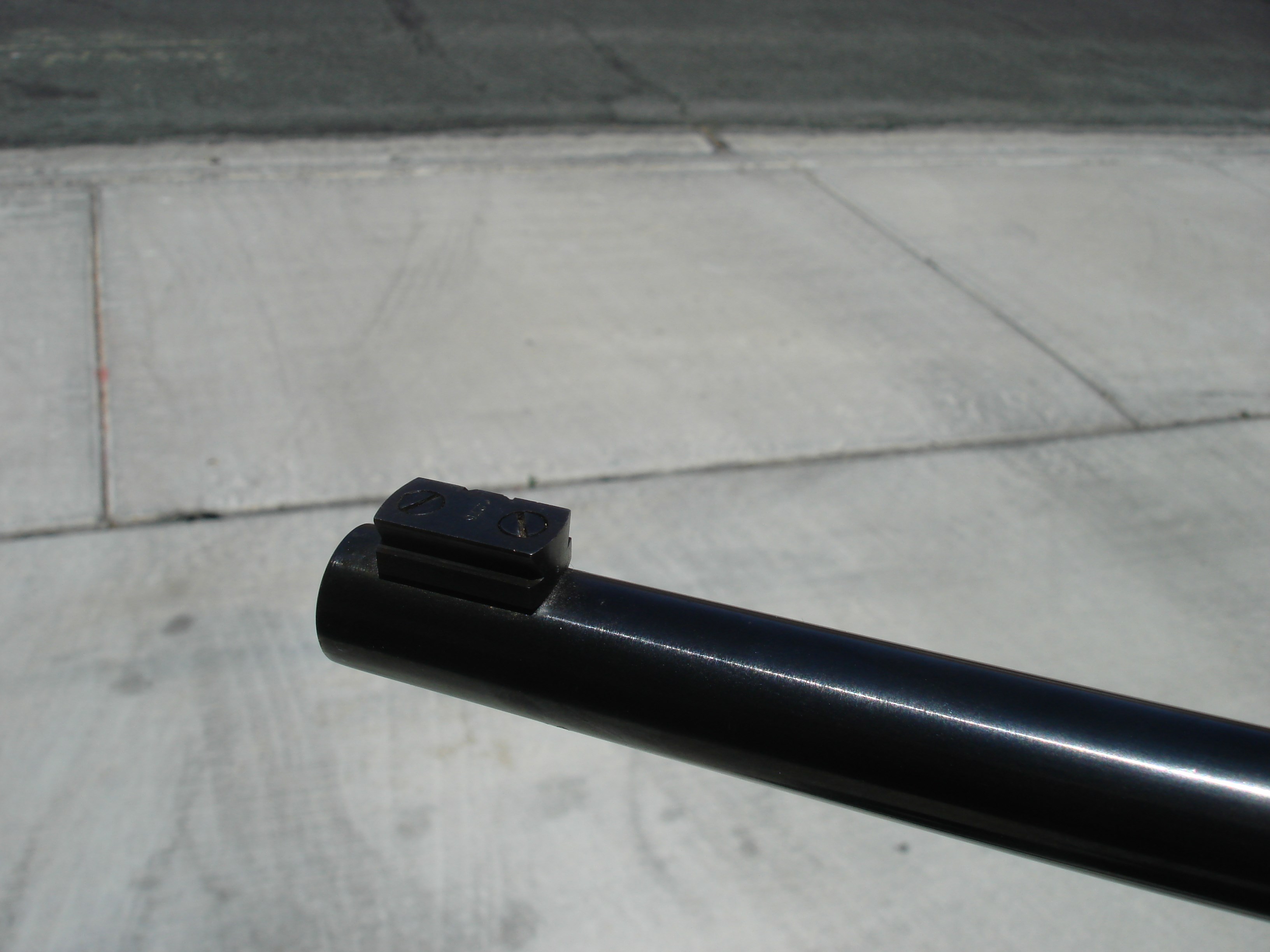

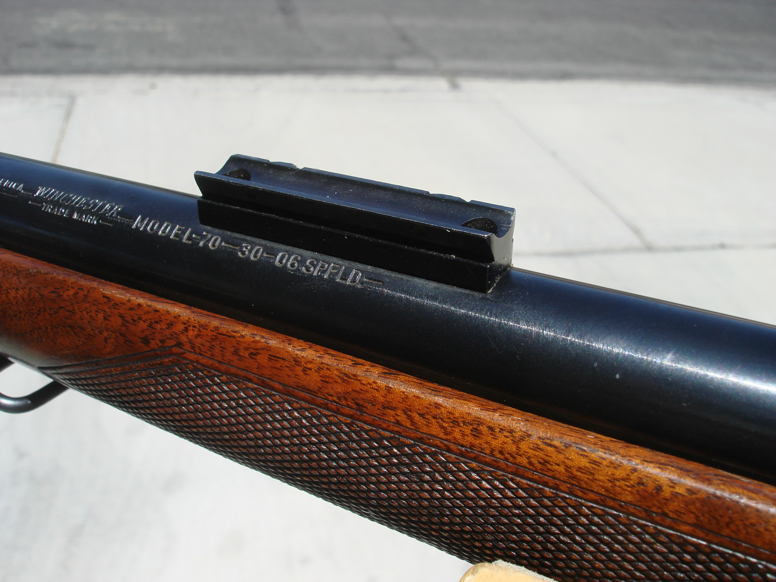

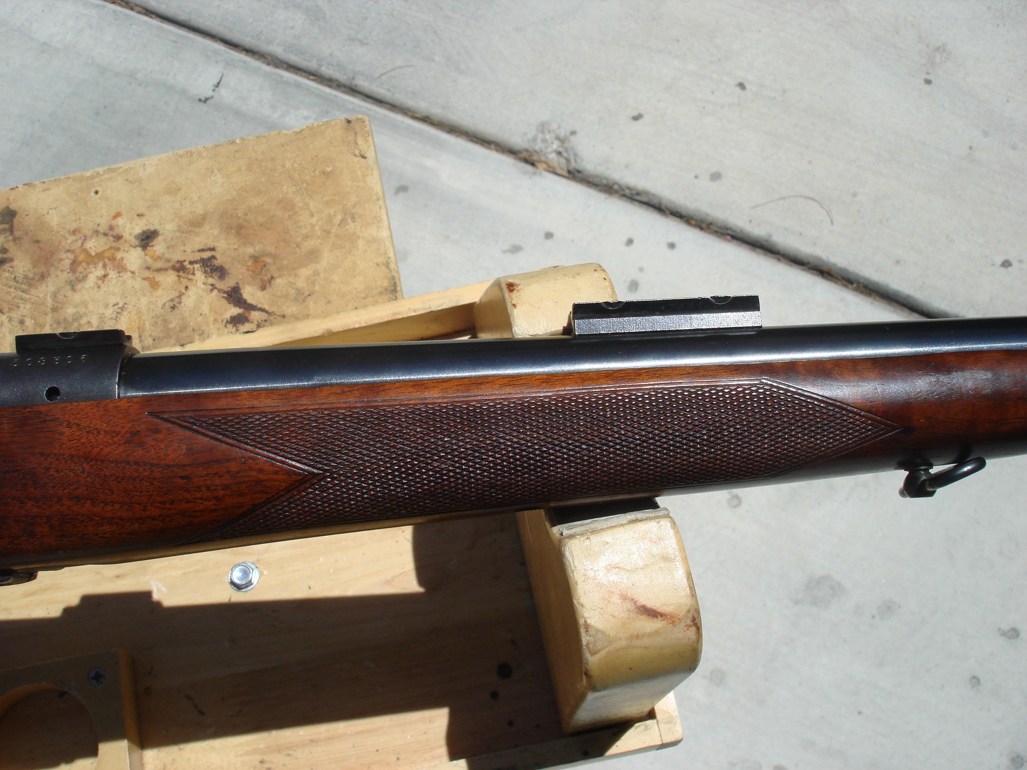

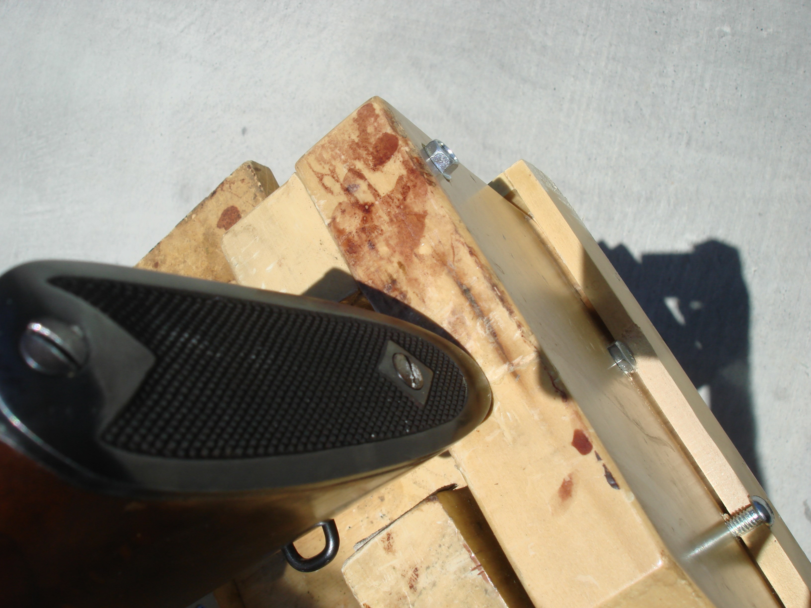

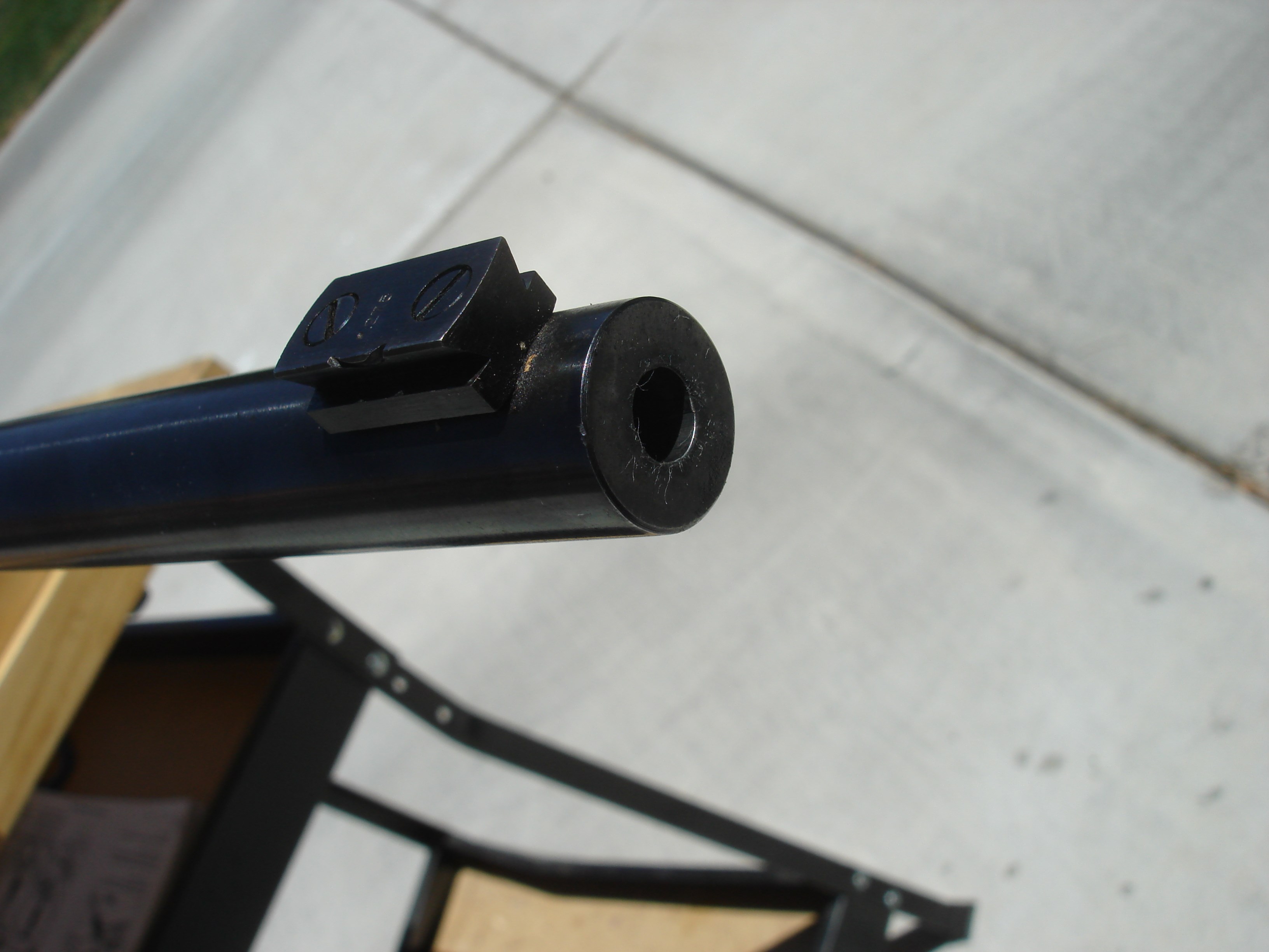

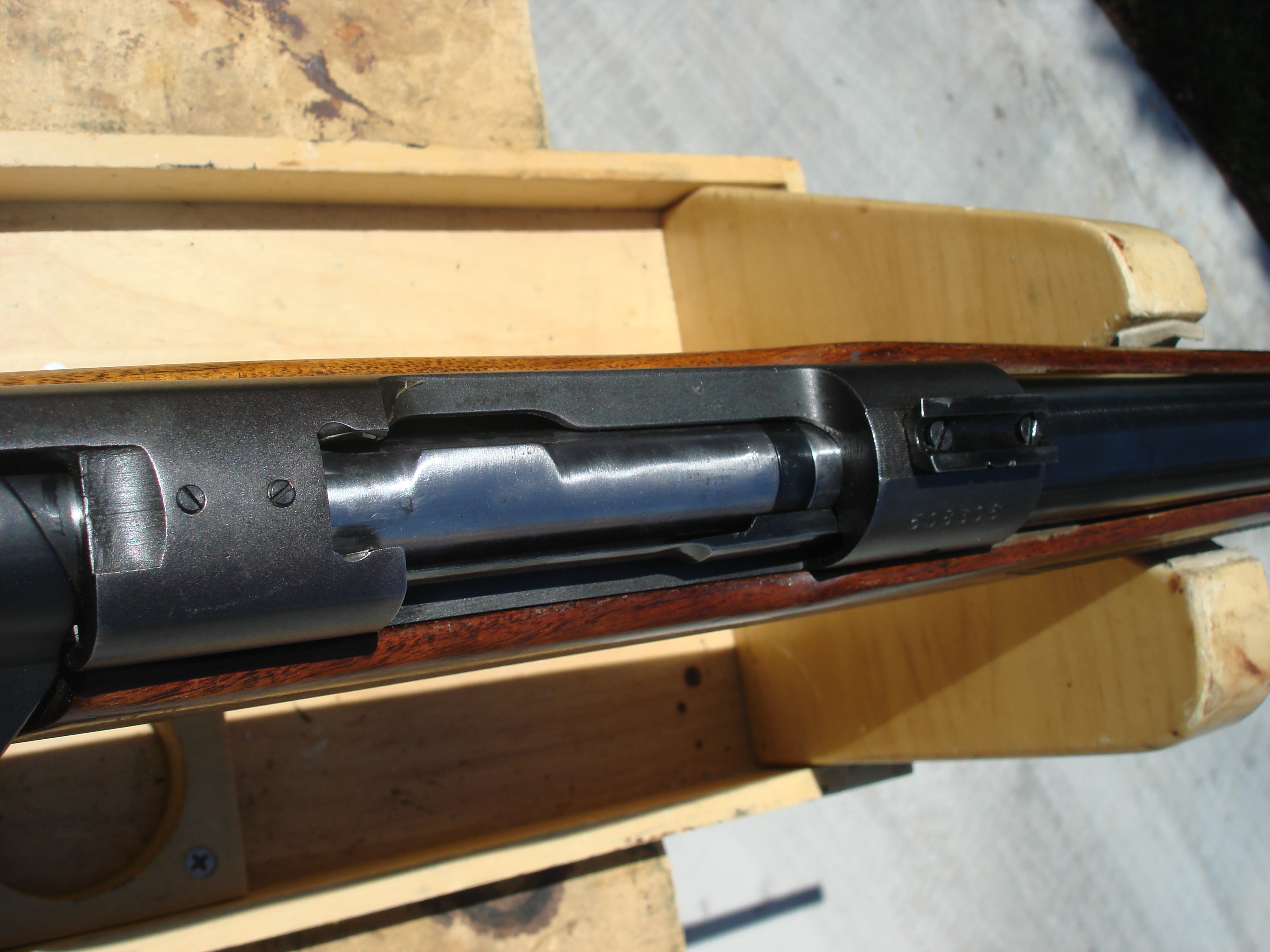

DSC00112.JPGDSC00113.JPGDSC00114.JPGDSC00115.JPGDSC00116.JPGDSC00117.JPGDSC00118.JPGDSC00119.JPGDSC00120.JPGDSC00121.JPGDSC00122.JPGDSC00123.JPGDSC00124.JPGDSC00125.JPGDSC00126.JPGShot some better photos today.  I was wrong about the bolt in the fore-end, the hole is there in the stock but no bolt is evident nor does their appear to be a female receptacle for one as best as I can see without disassembling the rifle.

June 2, 2017 - 11:47 pm
James-
That is a nice looking M70.  Thank you for posting the extra photos.
Seewin is right that this is a G7044C 30-06 SPFLD target rifle based on the clip slot, since only the competition models in 30-06 had clip slots after the pre-war period.  The barrel is original and the blocks (scope and front sight) have been replaced, which is no big deal.
My best guess, as seewin points out, is that it has been restocked using a nice looking pre-1959 standard rifle stock.  A few reasons (apart from the steel butt stock being a bit early for the action S/N) are that: 1) as far as I know, the factory did not glass bed/free float M70s in that time frame; 2) the hex head action screws are modern replacements; and, 3) the barrel bedding screw in the fore end is absent (b/c there is no corresponding dovetail/escutcheon in the bottom of the target barrel).  Most M70 target barrels (excepting some mostly pre-war ones) did not have the dovetail cut in the bottom of the barrel.
Obviously, the regular Marksman stocks did not have the hole for a bedding screw while the standard rifle stocks did.  FWIW the early .375 MAGNUM ramped straight taper barrels with the exact same barrel contour did have provision for a barrel bedding screw (were dovetailed underneath).  When the factory did fit a standard stock to a target barreled action, that hole in the barrel was often fitted with a dummy screw that did not engage the barrel (rather than leave the open hole).
Intriguing question as to why somebody would either order or build up a M70 target rifle with a standard stock?  Until Winchester introduced the Varmint rifle (243 WIN) in 1955 there was never a catalogued M70 in that configuration (except those early 375 MAGNUMs) and even then the varmint rifle was only available in 243 WIN or 220 SWIFT.  But a “heavy barreled rifle” was apparently a popular enough option that the Winchester parts catalog offered standard stocks inlet for medium heavy target barrels (even bull barrels!!!) as early as 1937.  This probably accounts for some of the pre-war rifles pictured in Rule’s book.  Also (somebody help me here) my recollection is that at one point in the 1950s, there was a weight restriction on rifles used for service rifle competitions (like Camp Perry) that made the regular M70 target rifle with heavy barrel and Marksman stock too heavy.  So to stay within weight, you either had to lighten the barrel (hence the M70 National Match rifle) or lighten the stock (hence the Evaluators Limited special order Van Orden “snipers”).
Finally, and today I think the most common reason, is that M70s of that configuration were made famous by Carlos Hathcock and colleagues as sniper rifles early in the Viet Nam war.  Of course those rifles were pre-war actions that were arsenal retrofit with 1950s Winchester or Douglas target barrels and put back into their original (checkered) standard rifle stocks.  I’ve no idea how many/if any of those original sniper rifles exist (clearly the ones that saw combat were exposed to the harshest of conditions), but the legend has led a good number of folks to want a M70 in that configuration.  Iron Brigade Armory will do up a M70 for you in that configuration on request, and given how well your rifle shoots it might even be one of theirs???  You could always contact them and ask.
Whatever it’s history, it’s really nice and would be a heck of a bean field rifle!!!
