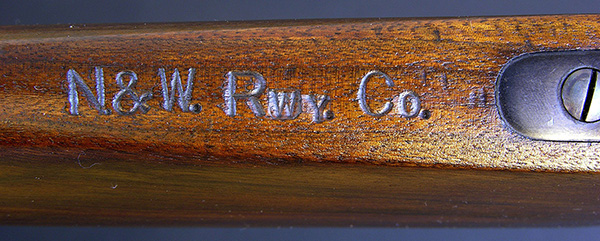

I have a Model 94 carbine that I bought from Rick Hill that once belonged to Norfolk and Western Railway Company.  N&W. RWY. Co. is branded on the top of the comb. N&W purchased a number of these from Winchester to protect the railroad during the labor strikes in 1922. The SN is 937686.
I uploaded a picture. Hope it shows up.

Finally got the picture to work, Thanks 1873man (Bob). Here’s a picture of my N&W. Rwy. Co. marked carbine.

This is more like what I would expect.  I think the markings 3 times on the barrel of the rifle which led to the creation of this thread, as seen in the original post, is bogus.  Do we all agree on this?
