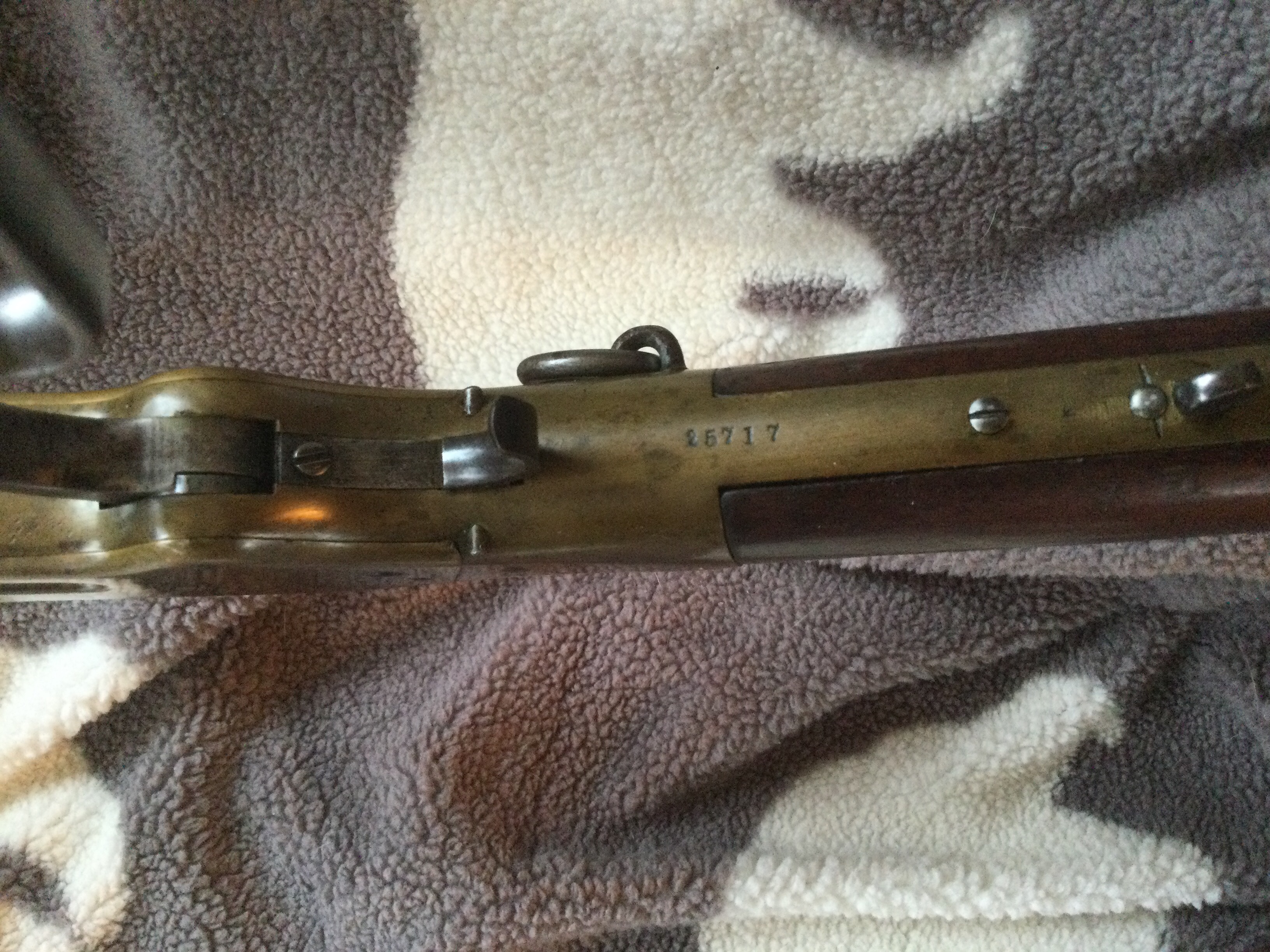

I have a 1866src s/n 25717. I trying to get Cody firearms Record letter, but the earliest they letter 1866 is s/n 35527.
Is there any recourse or no letter.

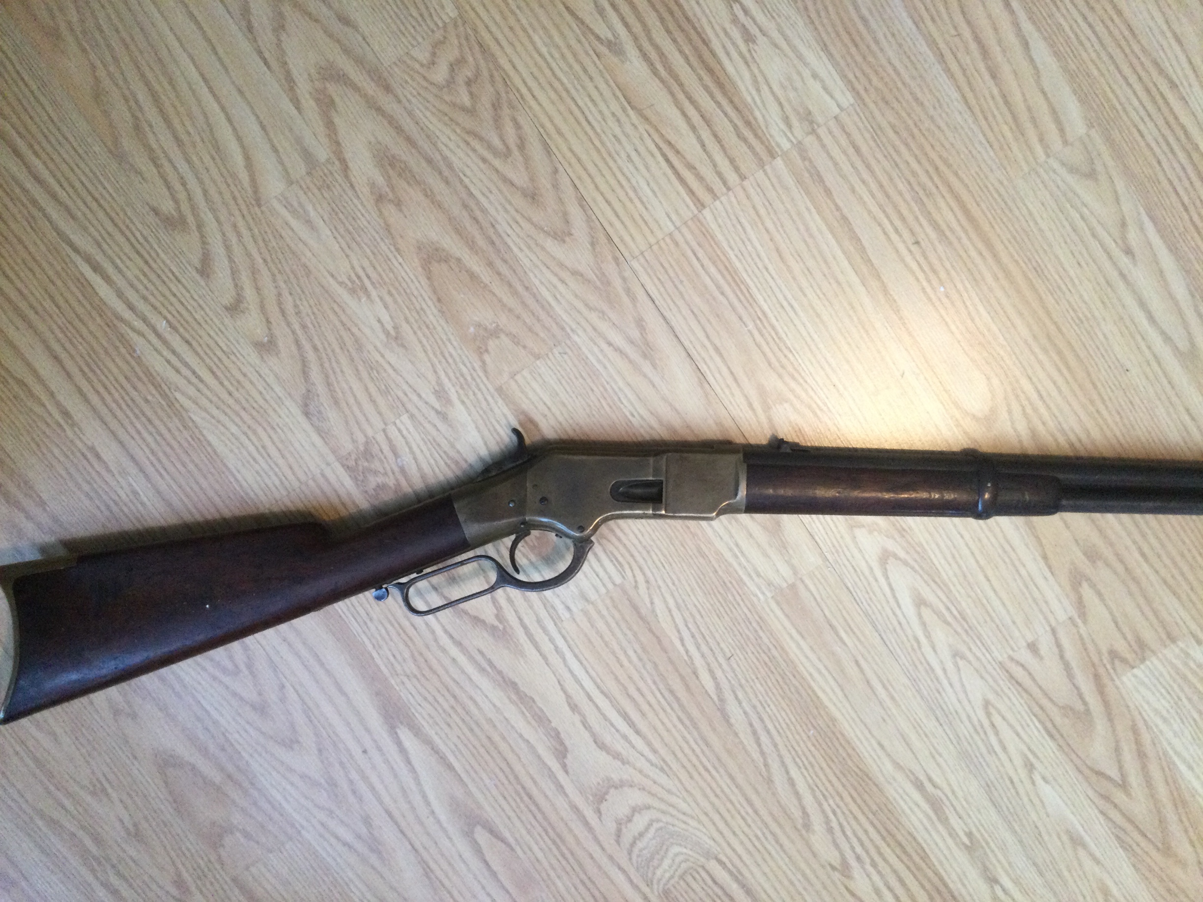

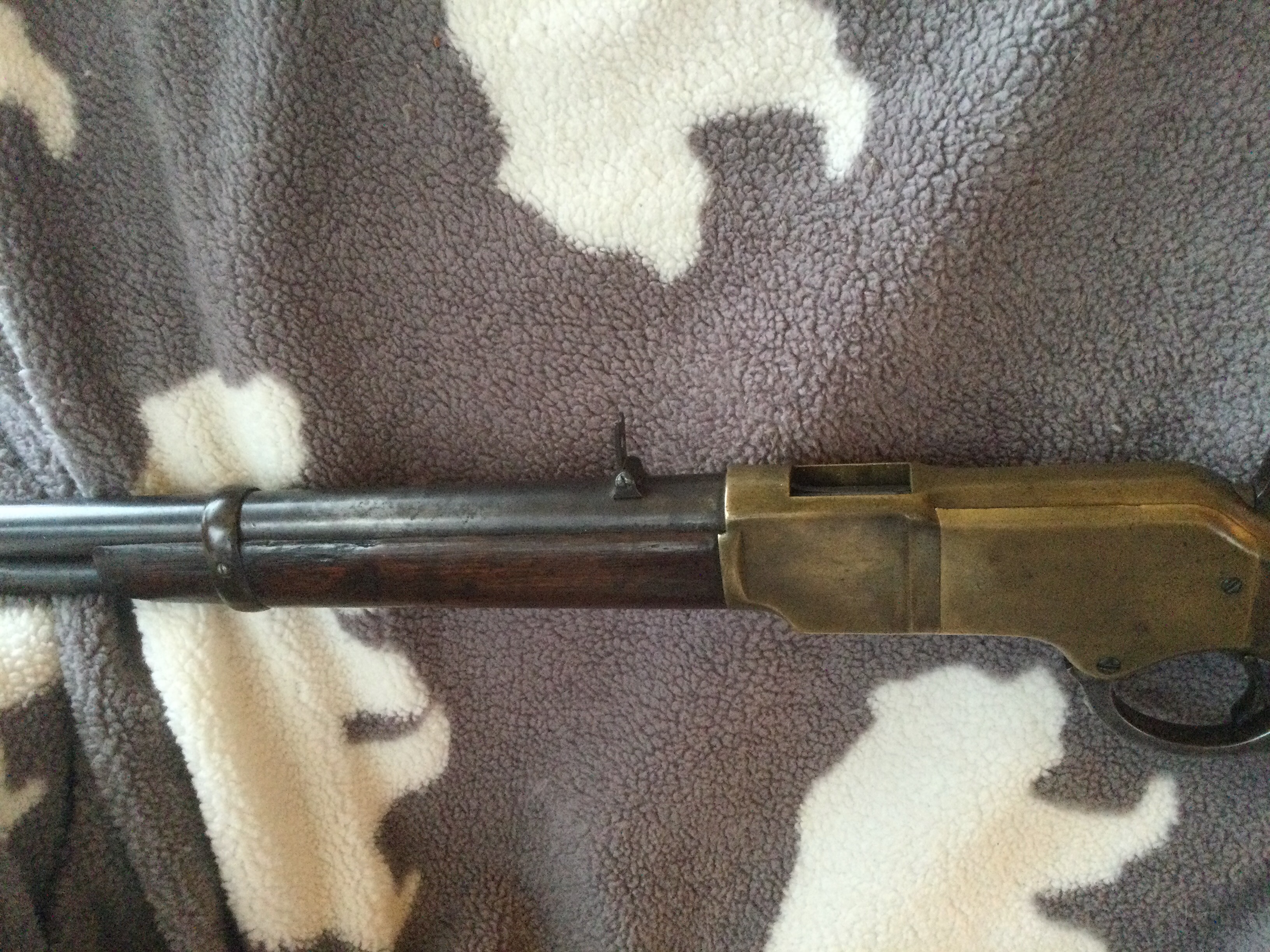

TR,here are some photos of the 66. I can not tell if it is a Indian rifle, no marks I can tell.
It was build in 1869 and is good condition and the action really good.

  Bill, Close good pictures of the stock, elevator, and sides of the receiver would be a good place to start. The Sioux and Cheyenne have a picture type language and mark ownership and battle stories on the soft parts, (wood & brass) of their guns. It’s not always tacks and rawhide! Some Indian guns are honest pieces.
 One example of neat Indian markings is on page 46 thru 49 of the summer 2017 edition of The Winchester Collector magazine. That’s a near perfect example, most Indian marking are rough and crude but have meaning.
 The 66 carbine was the weapon of choice in 1869 for any dog soldier plains Indian or white man in Indian territory. T/R

It is interesting to me that this carbine has a rifle butt.  How unusual is this?  Or not?
Forum Posts: 2012
December 23, 2020 - 10:33 pm
 Chuck, Most 66 carbines have a rifle butt up to about 100,000. T/R

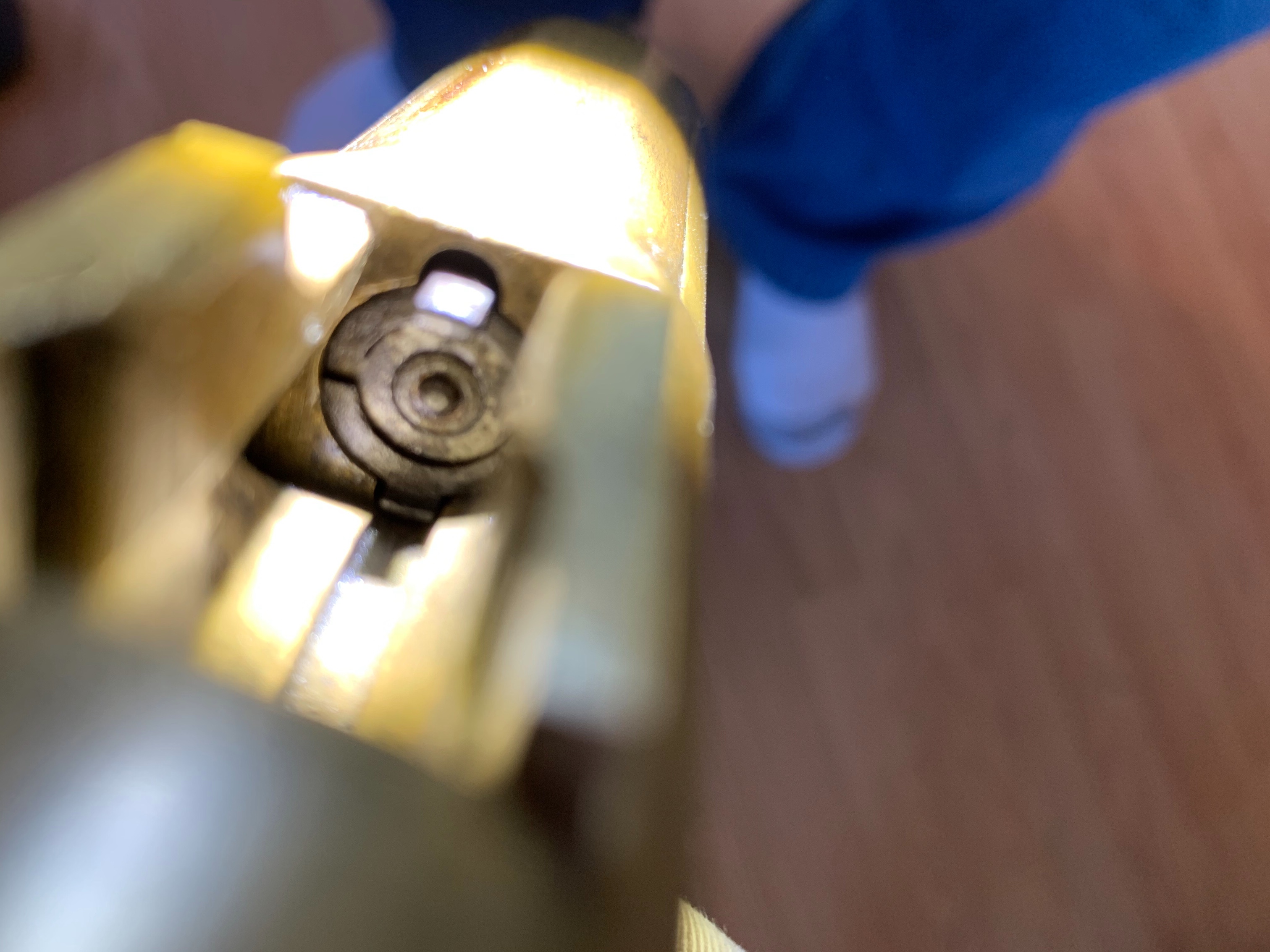

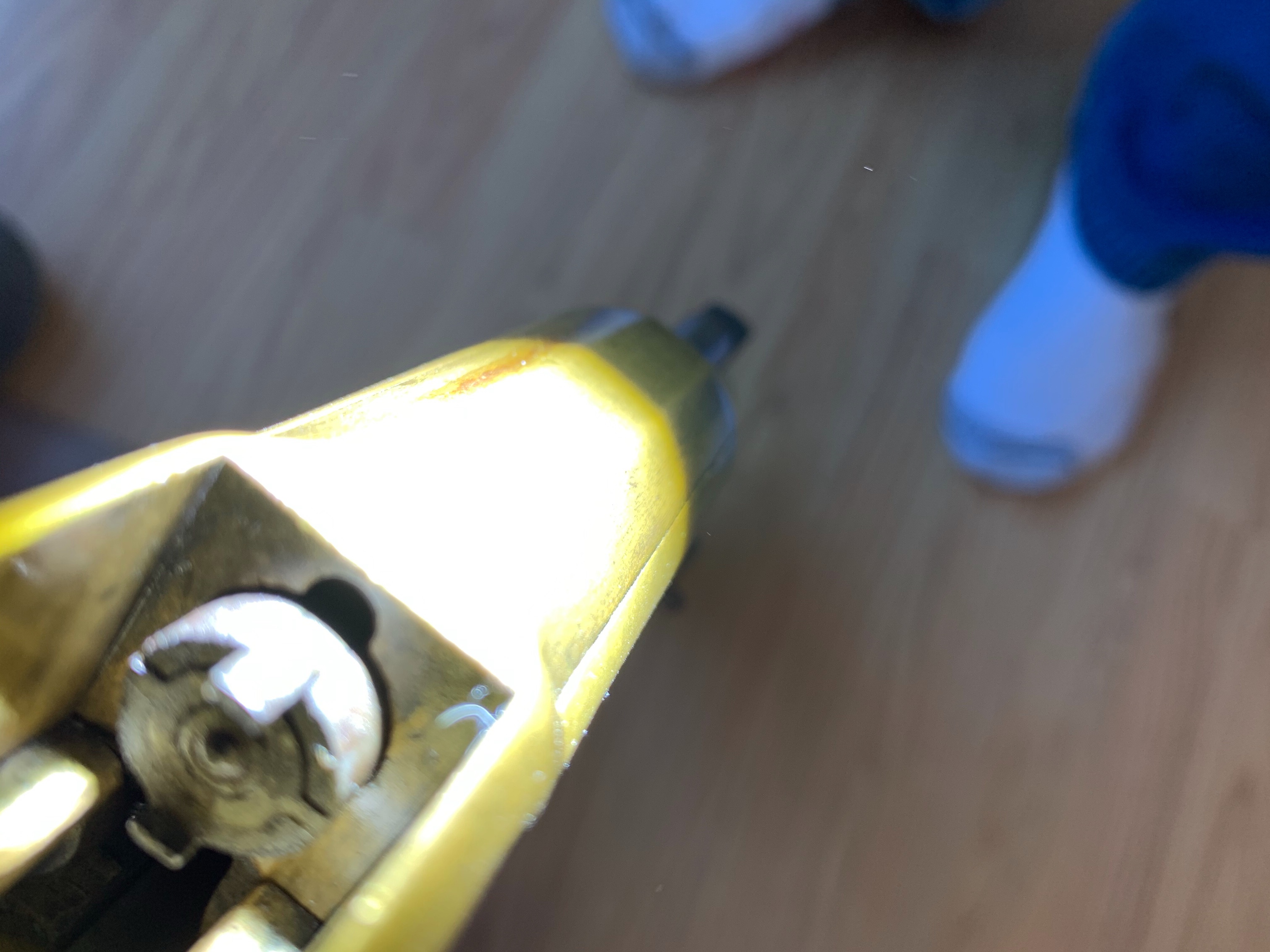

Merry Christmas to all, and question on this 1866src
It looks like it has the 2 rimfire pens but also a center fire pen in the firing pen.
This is a early 3rd model , I would not think It should have a center fire pen, I know they went to center fire in later years, it just seems strange to me there are 2 different firing pens.

Bill,
That is a center fire conversion. The rim fire tits have been filed down.

I’ve never seen a center fire set up.  What else is required to be modified?
Forum Posts: 5008
December 24, 2020 - 9:51 pm
There is a firing pin sticking out.
Forum Posts: 6920
December 24, 2020 - 9:52 pm
Sorry Bob I edited my post as you were replying.   I’ll take a better look.  After looking I don’t see anything sticking out but there definitely is something in the hole in the center.  Normally this would be threaded so the clapper could be attached and flush at the end.
Forum Posts: 2012
December 24, 2020 - 10:13 pm
  Bill, Some 66’s were converted later by owners to center fire and that’s what you have. They filed off the two points on the striker and inserted a pin in the firing pin, later they just welded a point on the firing pin. Simple conversion but not as easy to go the other way. You would have to file off the point on the pin and replace the striker. The striker is to thin to weld unless you have small welder and special skills. Winchester Bob sells strikers and bolts (firing pin) reasonable. The striker is threaded on the bolt. Removing the bolt from a 66 is tricky, ask for help if you go there.
 If you find the right brass you can shoot your 66 center fire, if you convert back you can’t. T/R
