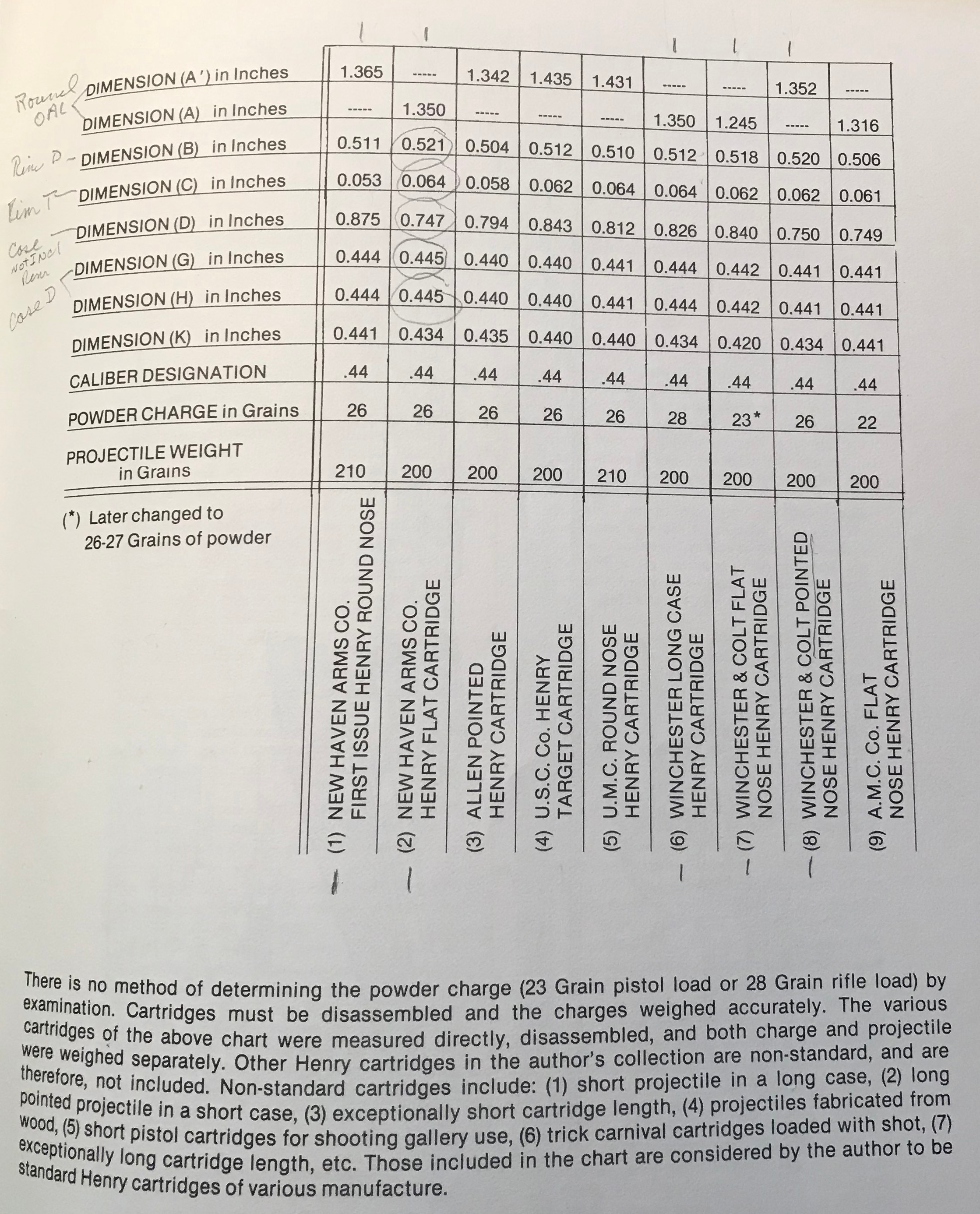

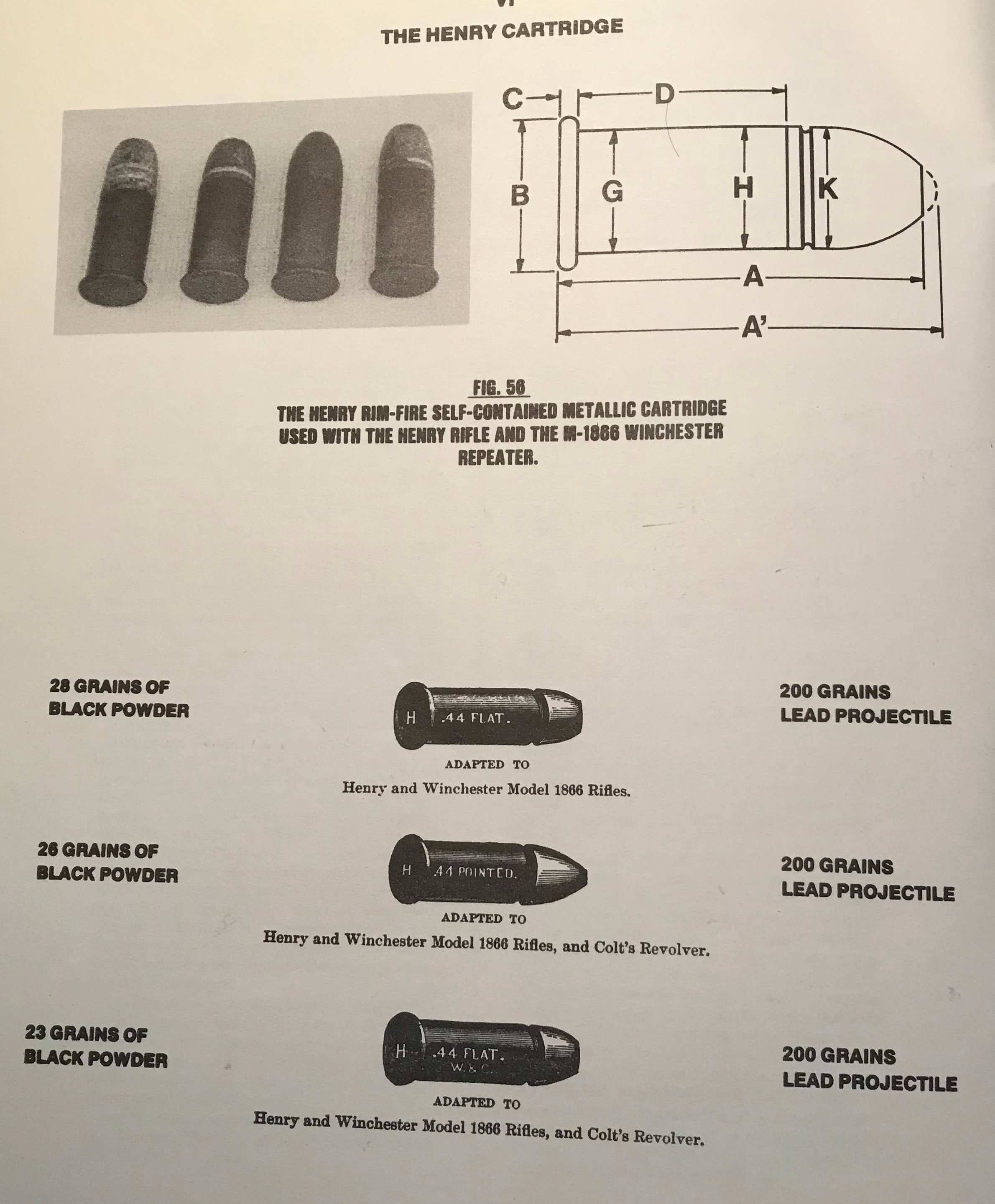

Slug your barrel.  I’m sure the .429″ 44 WCF bullets will be too small.  Here is some data from McDowell’s book.
