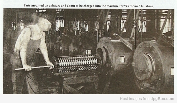

Going to try and add a picture.

https://www.jpgbox.com/jpg/72954_600x400.jpg
July 6, 2024 - 6:04 pm
Thanks for posting this, as this is the first photo of the rotating ovens I’ve seen.  In another discussion of the process, someone who appeared to know what he was talking about said that the color produced on the steel was a temper blue, the main purpose of the charcoal & oil being to exclude oxygen from the chamber by converting it to carbon dioxide.  That explanation is somewhat at odds with these statements:  “Carbonia…is a combination of heating oxidizing and carbon impregnating, not carburizing.”  “6. The work is tempered and given a carbonia finish simultaneously…”  What I’d like to hear is a metallurgist’s explanation of the chemical processes at work in the oven.
