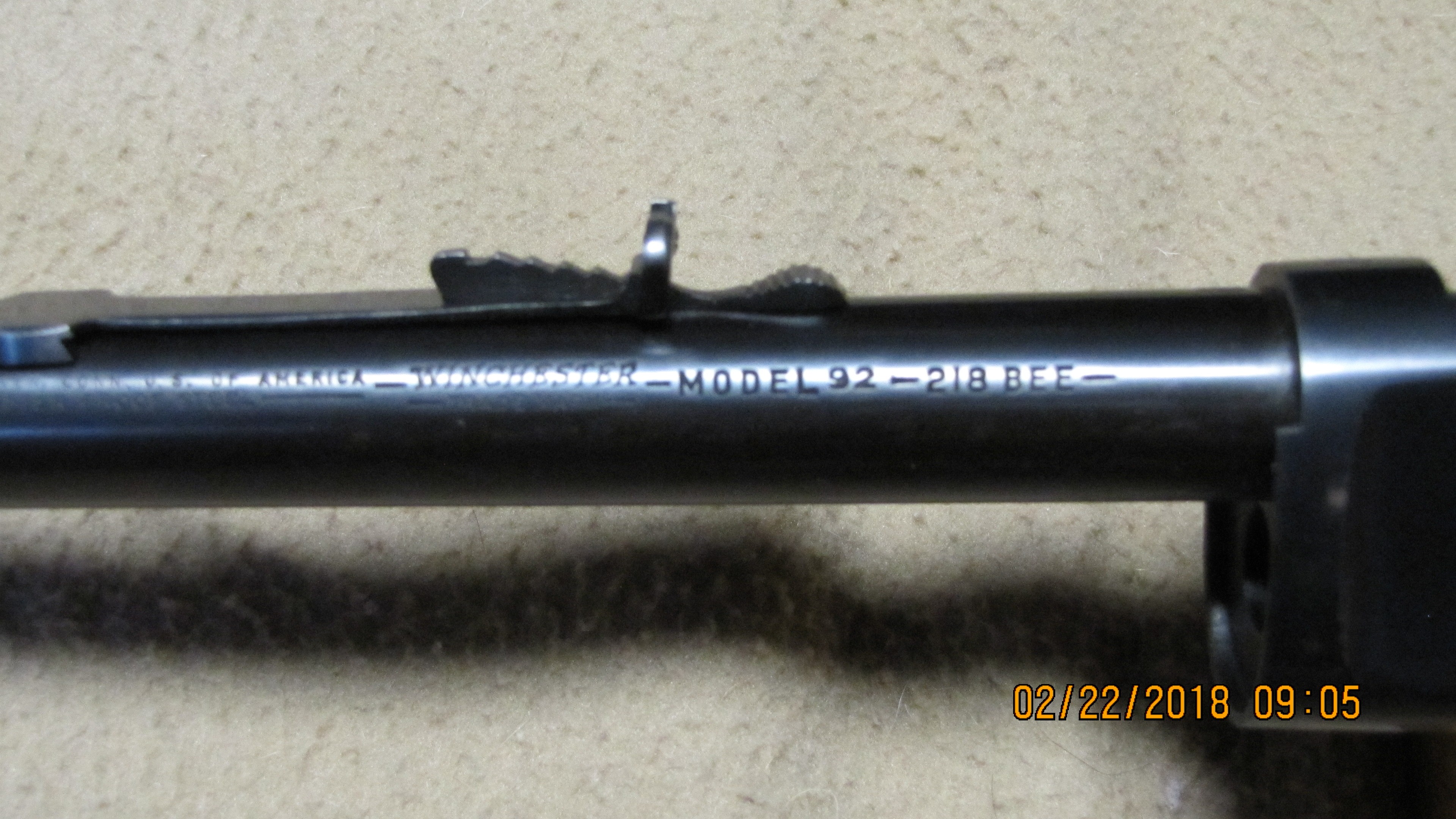

Regarding Bert’s mention of the “possible” Winchester assembly:  Here are the markings on my ’92 218 BEE.
92-218-BEE-001.JPG92-218-BEE-002.JPG I hope this sheds some light on a cloudy subject.  Roger B.
Roger – I remember your rifle now from previous discussion.  The model marking on yours looks much more professional than the recent example on gunbroker.

The barrel on Roger’s rifle is/was originally a Model 43 barrel.
