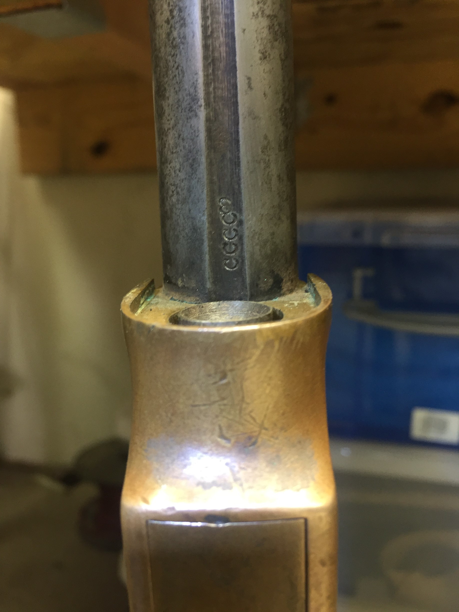

Forum Posts: 4990
September 8, 2017 - 1:15 am
Normally there will be three C”s on the bottom which are the inspector marks but for some reason this one has 4 C’s. the last mark is a “3”.

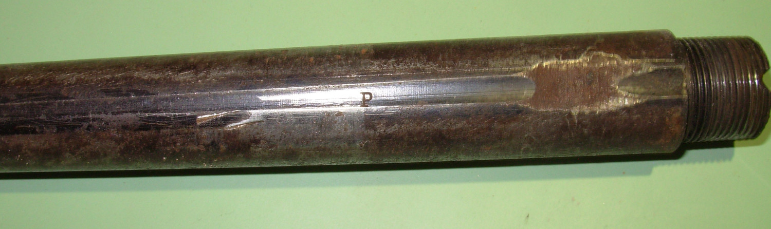

This is the marking on the bottom of an 1866 carbine barrel, made in 1876.

Usually the inspector marks were real close the the breech, probable were the grind marks are.
