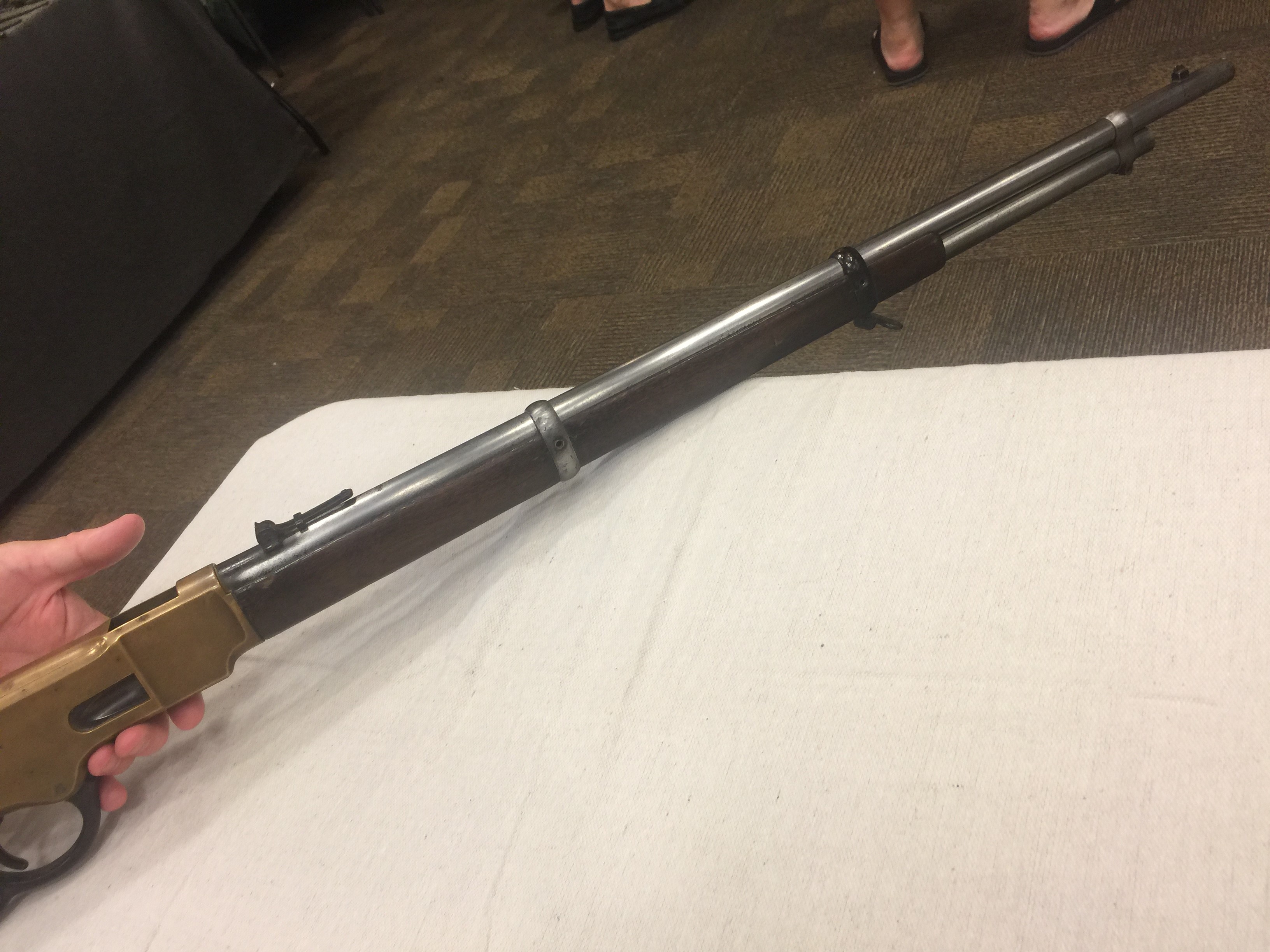

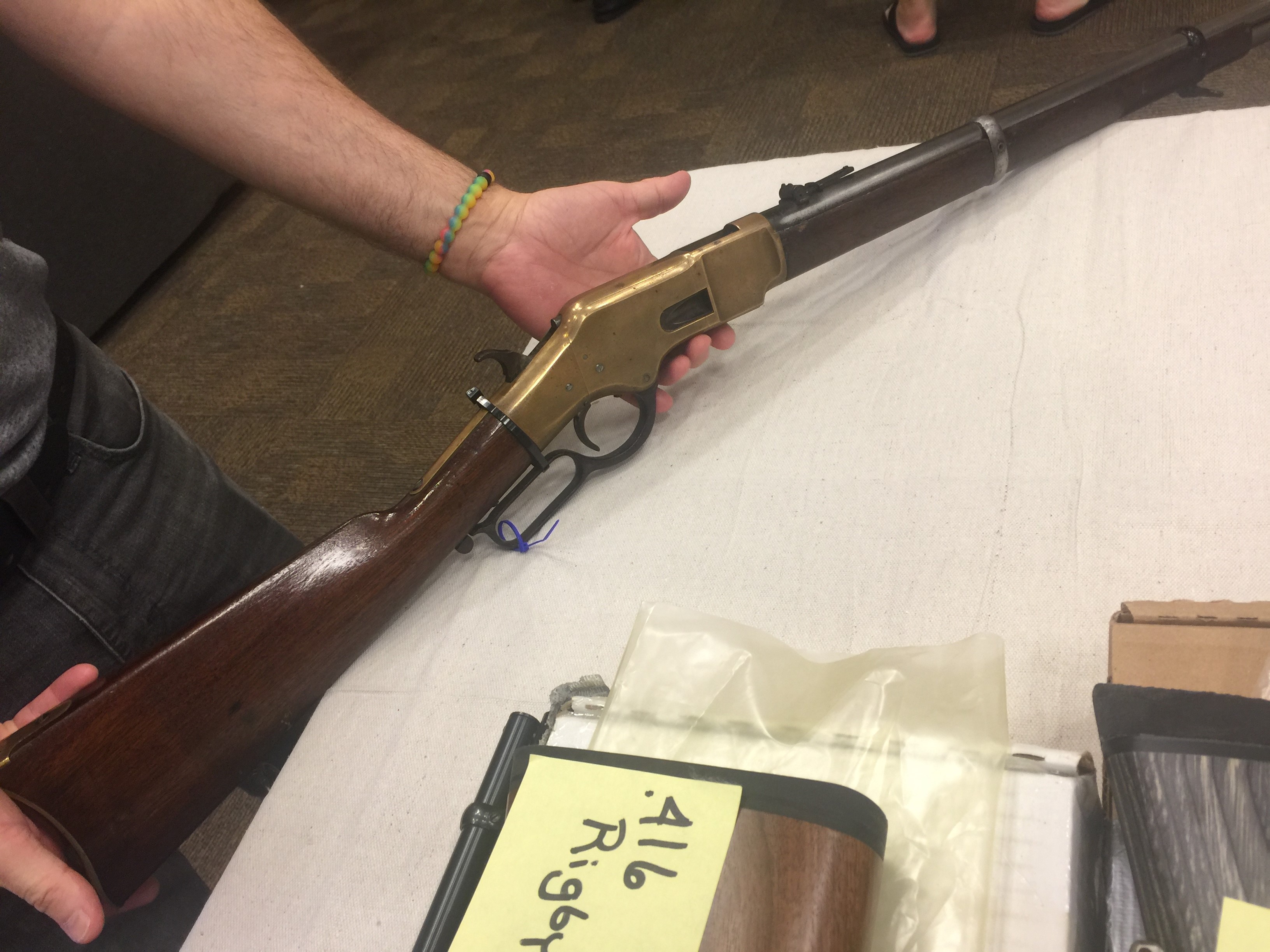

I had a 66 Musket come by my table at a gun show today. It was for sale and the owner had no idea what he wanted and was asking for advise. The gun was in poor condition with the brass being cleaned and the barrel seemed to have been polished with steel wool or such. Bands, hammer & lever had been painted black. There were 4 screws missing. Bore looked pretty good. Wood was bruised up but solid and fit well.

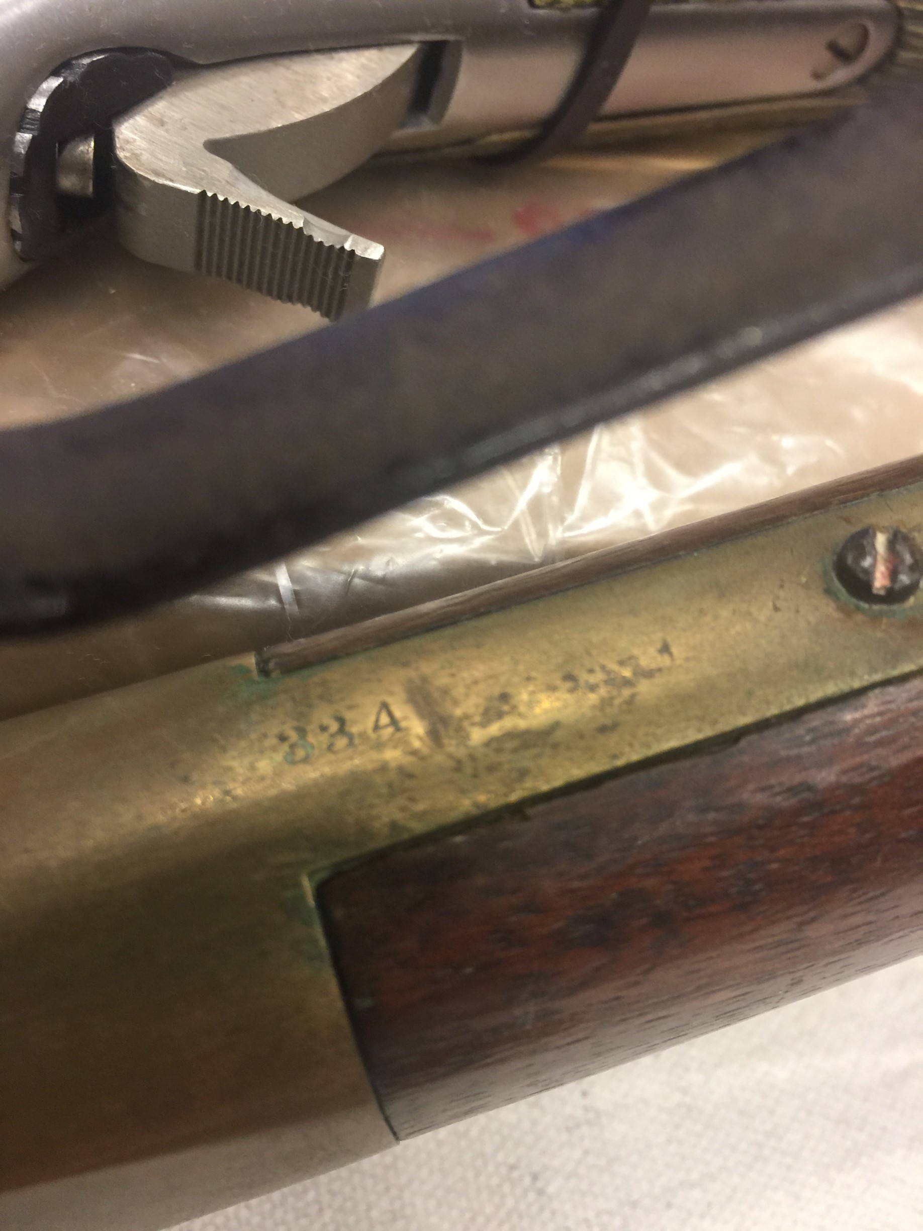

Here the question. The serial # was 3xx. Three digits in the mid 3 hundreds. I forgot to write it down. Can this be a correct serial for a musket?
What would be a number I could give for this and not get hurt and be fair with the seller. He’s going to bring it back tomorrow. Thanks

The number is bogus. Probably a couple digits worn off or removed. The 66 was numbered with the Henry’s, the 66 starts at 12,476.

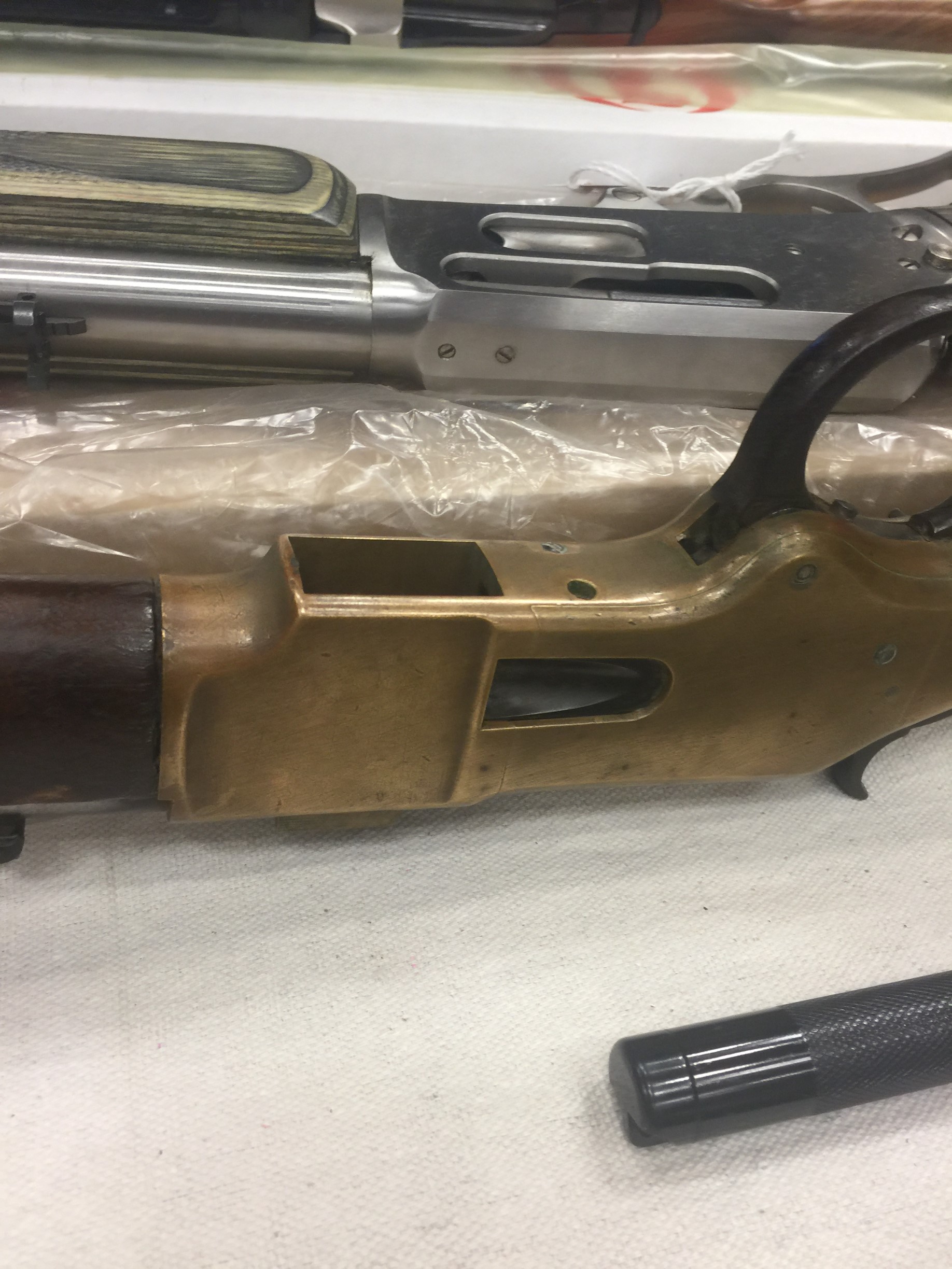

Did it have the flat style loading gate? All of the real early Model 1866s had a flat loading gate, and the serial numbers were stamped on the left edge of the lower tang (under the butt stock). According to some sources, no Muskets were made in either the First or Second variation Model 1866s, but without any records to confirm that assertion, who knows for sure.
nascar fan
Forum Posts: 108
October 8, 2012
June 25, 2017 - 8:53 am

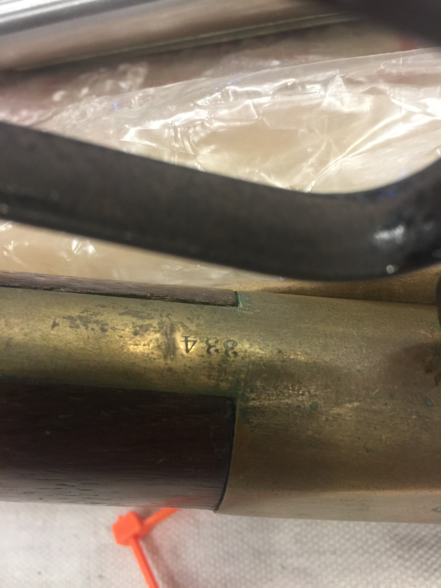

I knew I had to open the lever to see the serial clearly. I’ll get some pics today
Forum Posts: 4990
June 25, 2017 - 1:30 pm
If the serial number is behind the trigger where you had to open the lever to see it, the gun is in the 19,000 to 139,000 range

Forum Posts: 4990
June 26, 2017 - 12:03 am
It looks like the number was 334xx.
Forum Posts: 2813
June 26, 2017 - 12:12 am
It also doesn’t look like normal wear in the area of the last two “xx” digits but rather intentional removal for some reason (which is a felony).  It is also a felony to sell or deliver a firearm with an altered or removed serial number in some states (such as Florida).

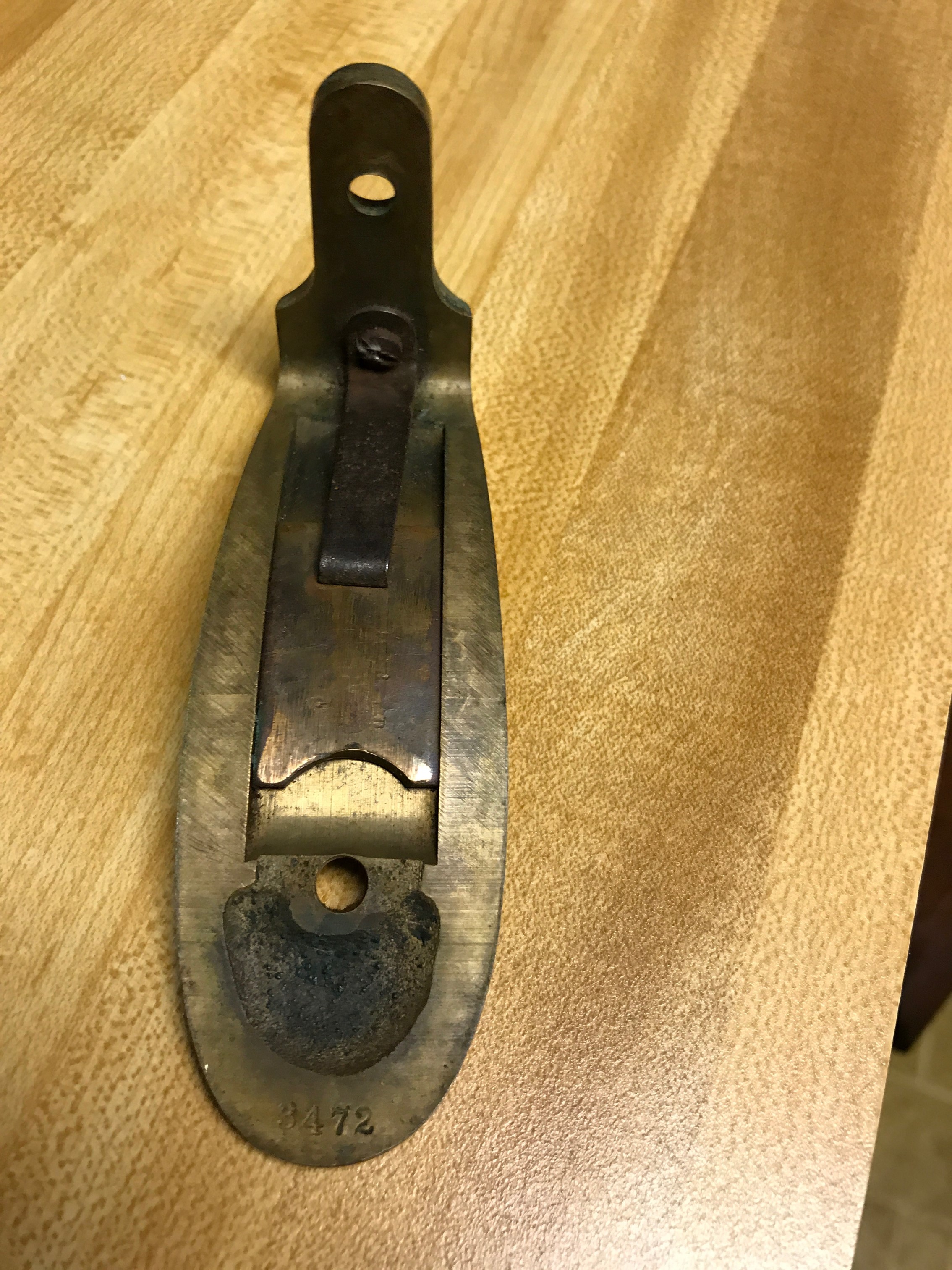

Serial number should be on the inside of the buttplate if I remember?

I think with the butt plate showing the last four of the serial that the full serial would be 33472. Any thoughts?
Forum Posts: 4990
June 29, 2017 - 12:21 am
Checked that number and the closest is 33473 in the survey. Most of them in that serial range are muskets

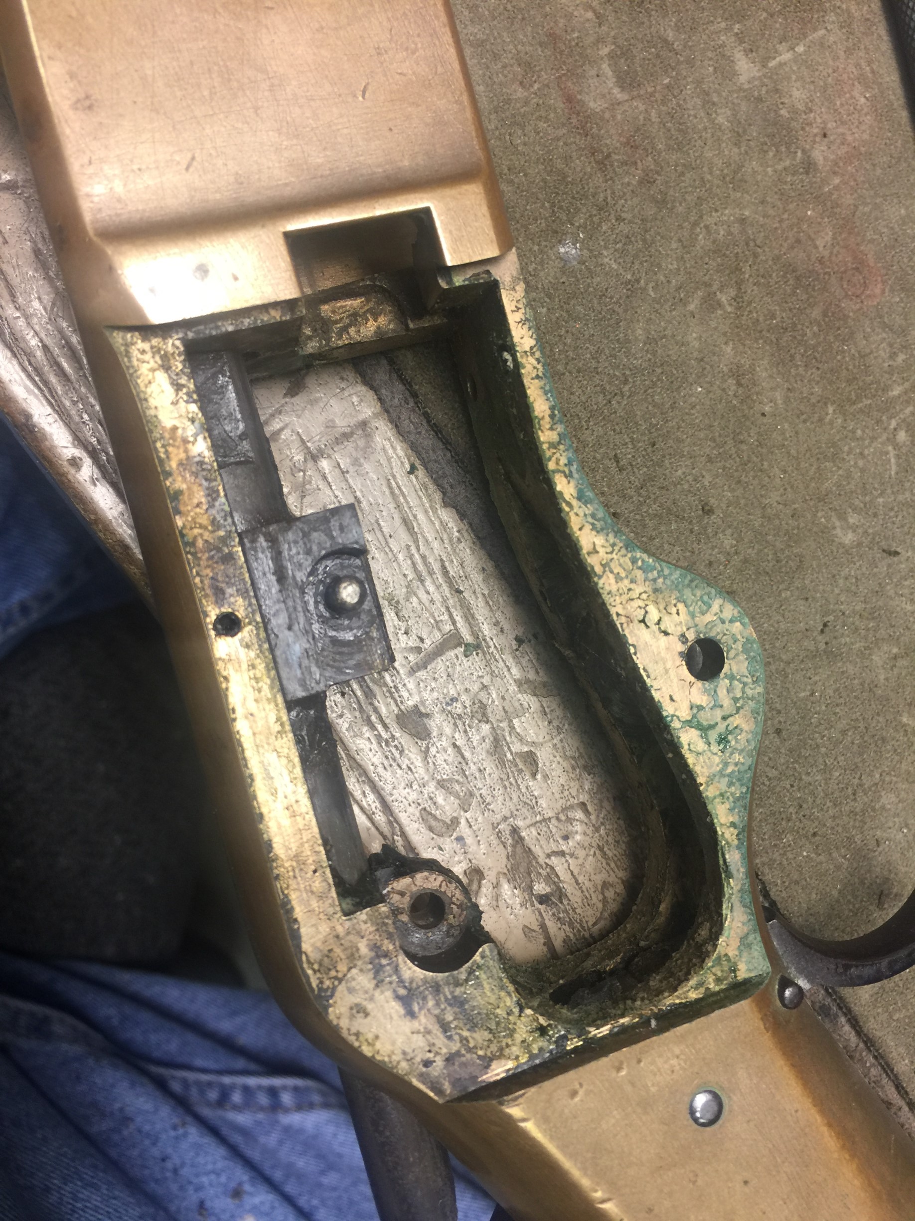

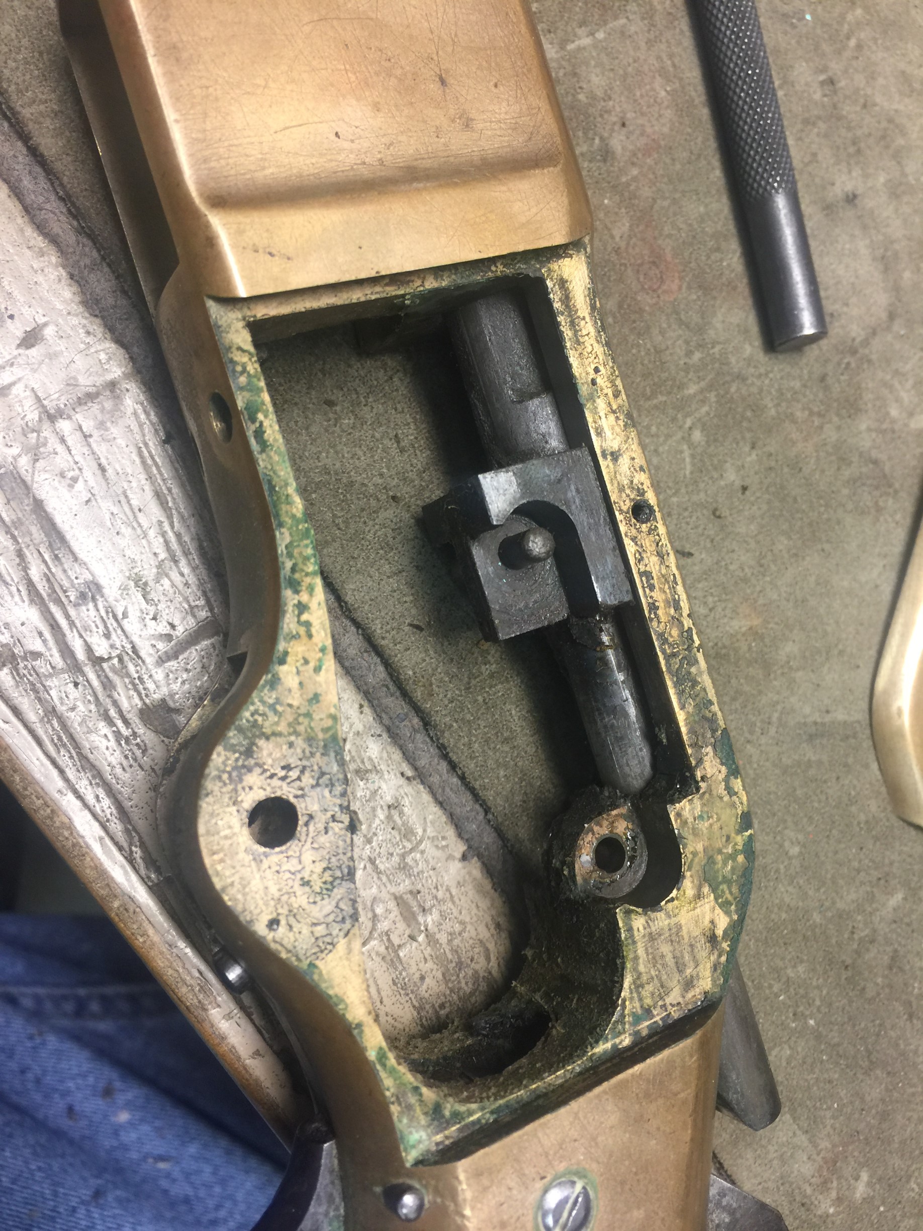

I was able to buy the 66 today. It seem like a honest well used third model musket. It has an issue with the elevator not following the lever as it should. I was eager to get inside anyway. I found one of the lever springs was missing. Don’t know how that would affect the elevator movement. Going to clean the insides good and try to replace the missing spring rod if I can find one. Not sure how to get the bolt/firing pin out. Everything else came apart pretty easy.IMG_1445.JPGIMG_1446.JPG
Forum Posts: 2000
September 5, 2017 - 10:46 pm
  The firing pin has to come out first before you can remove the bolt. I would advise you not to do that, if you have to the first step is drive the extractor pin out of the bolt thru the little hole in the top of the receiver. The shell extractor can be rusted in the bolt, the bolt can cracked or broken. Once the extractor pin is aligned with the small hole in the top of the receiver use a small punch (1/8″ or smaller) drive it out thru the small hole in the other side of the receiver. Now remove extractor from the bolt, if the firing pin is not rusted to the bolt you can slide it out the back of the receiver and remove the bolt. If the bolt is broke or rusted to the firing you need help. I do not recommend you take the firing pin/bolt out unless something is broke! T/R
