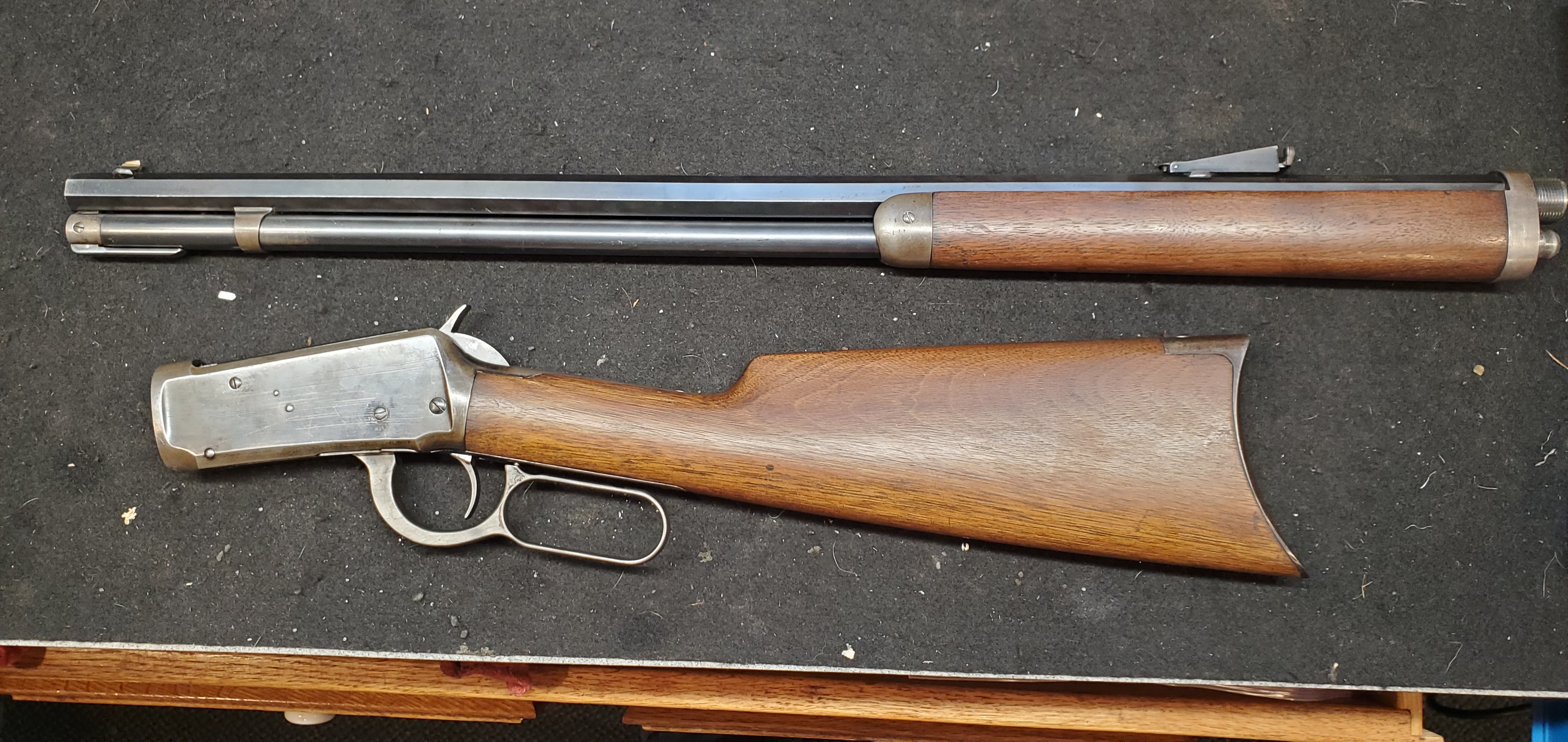

I was good with ending the thread but since it is still here I just wanted to say that I sent the gun to Wild West Guns in Anchorage, AK.  Got a call today that the smith was able to drill the finger lever pin from the left side (no hole in the receiver) through the plug screw hole, tap the pin and get it out by threading a screw into the pin.  The smith confirmed there was never a hole in the receiver.  Going to be a couple of weeks for a new firing pin.  If this post is still around I will add some more pictures when I get the gun back.  If anybody hears of a 1894 devoid of the pin hole please let me know.  Thanks again,

To finish this post I sent the gun to wild west guns in anchorage. They did a great job drilling and tapping the lever pin from the left side through the plug screw hole leaving the right side of the receiver untouched. New firing pin and good to go. Just in time for deer season!!20210807_093654.jpg20210807_093623.jpg20210807_093748.jpg
