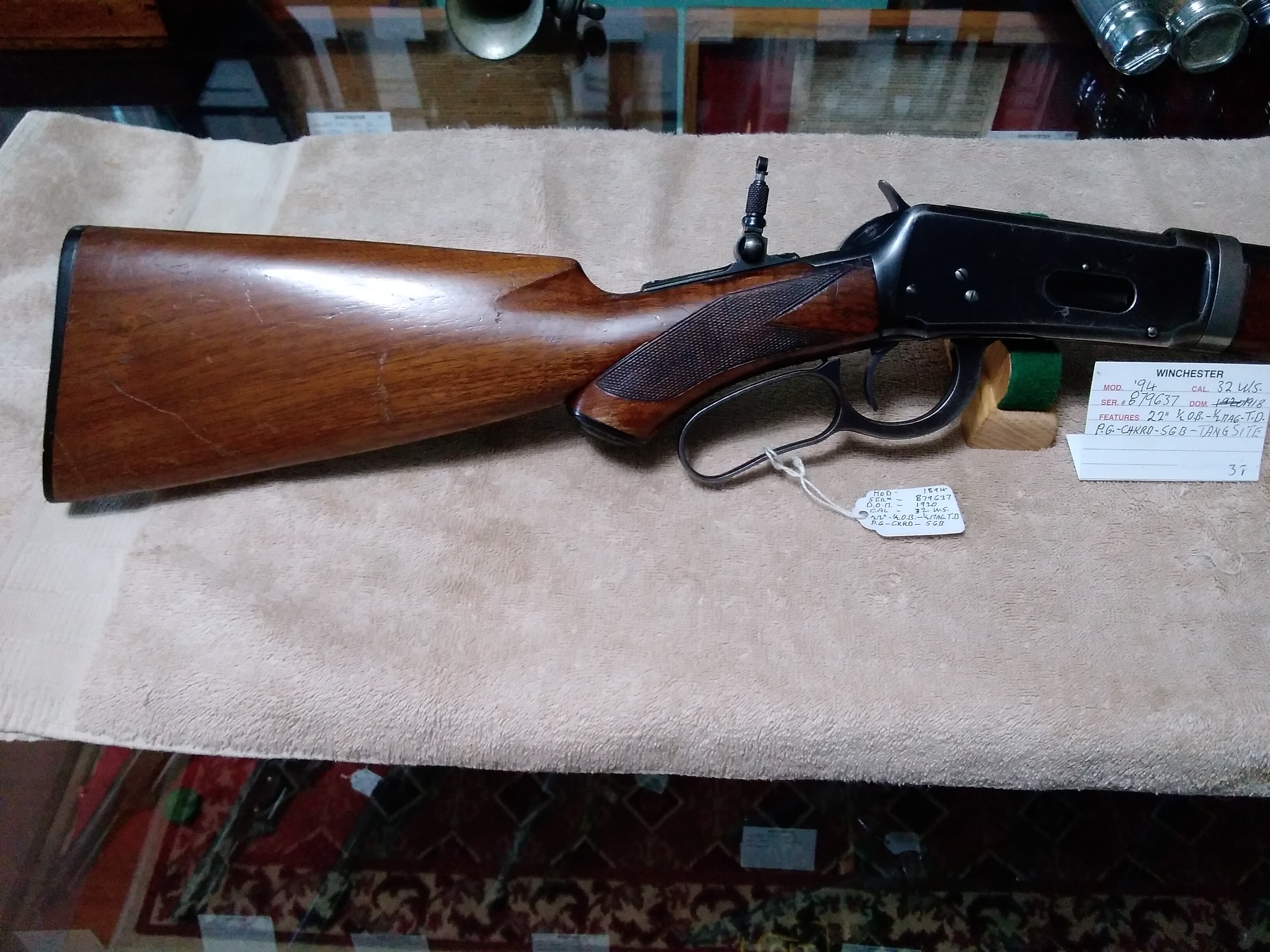

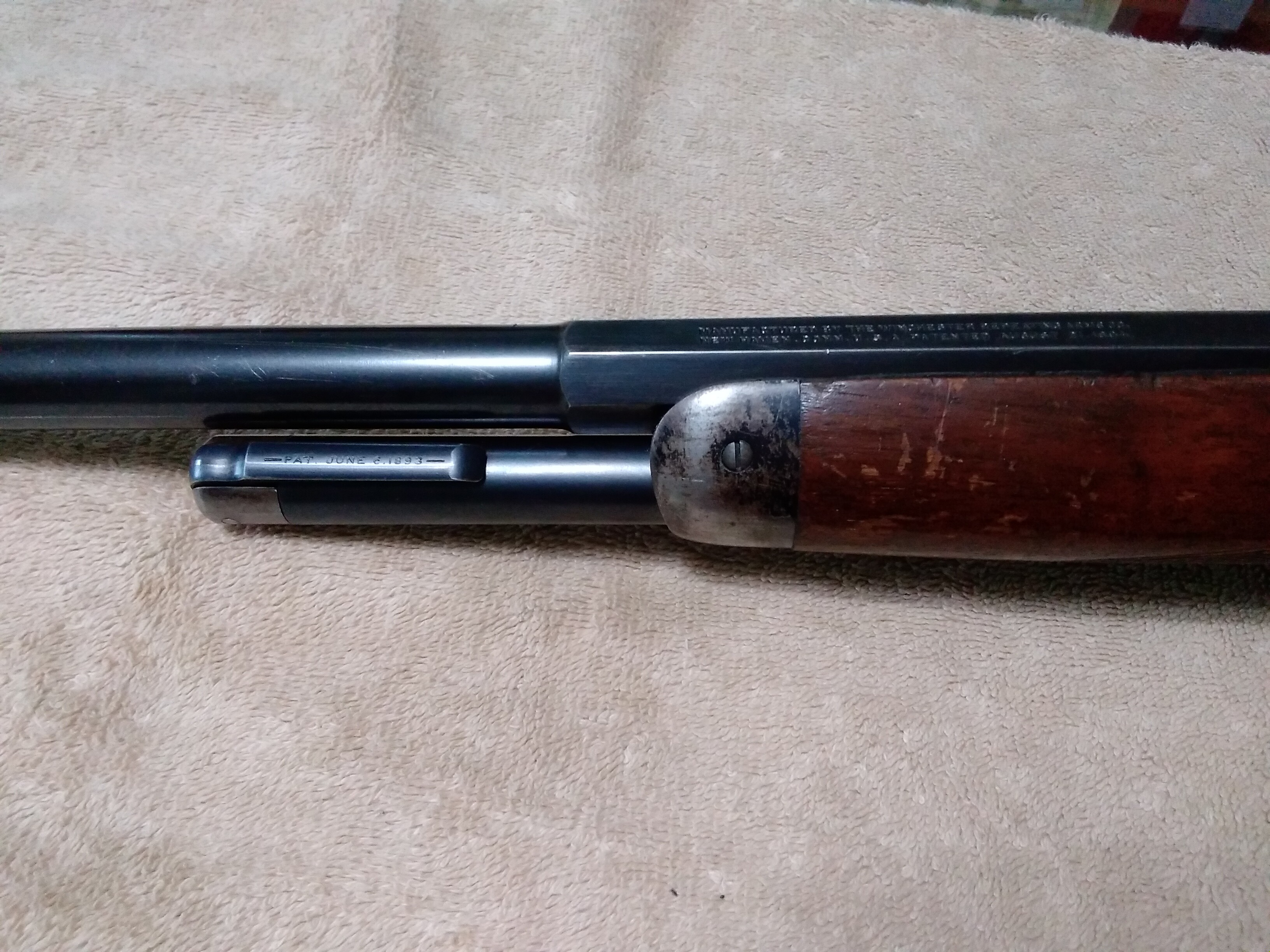

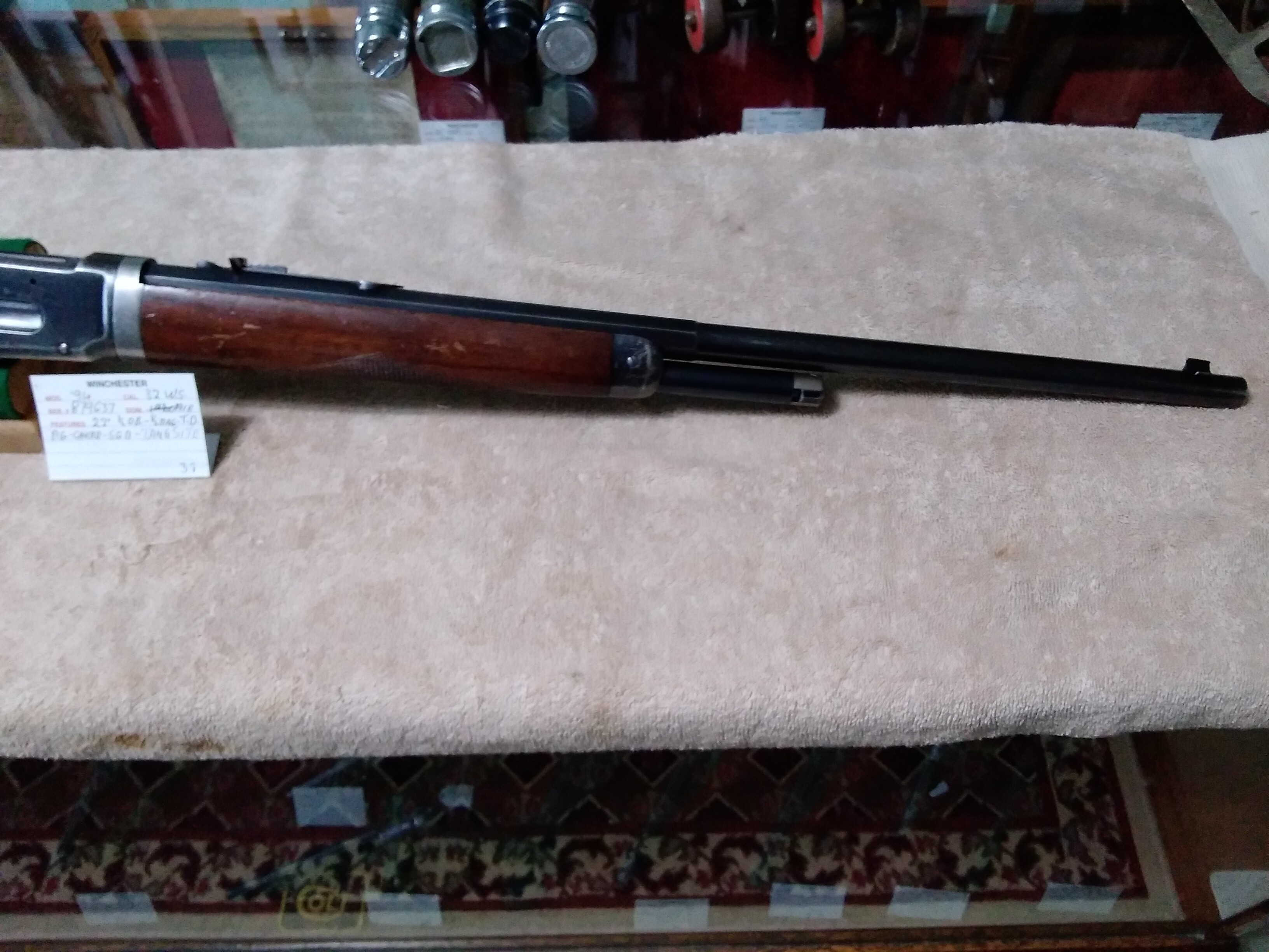

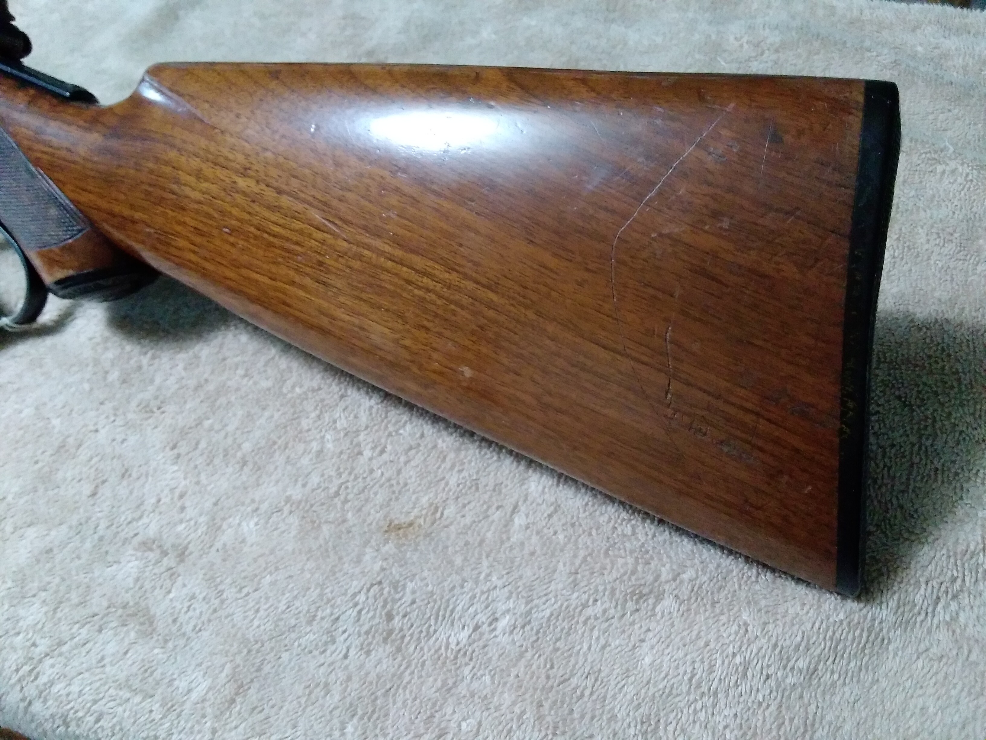

January 12, 2022 - 10:51 am
Here’s a plain PG, TD, ELW
