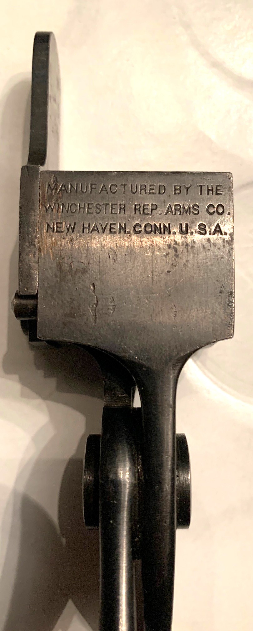

1-1.jpg2-1.jpg3-1.jpg4-1.jpgHere are Tom’s pictures.
Tom what you have is the Winchester 4th Model Bullet Mold that is marked 40-265. Your mold is a later production 4th Model Mold made towards the year 1888. Sometime between 1883-1888, Winchester added the mold block alignment pin feature, and I have yet to narrow down when. Your mold is for the 40-50 Sharps Straight or Sharps Bottle Neck cartridge and cast a 265 grain paper patched style bullet. It was not made for the 40-70 Sharps and/or 40-70WCF.

Well Maverick thanks for the help with not only my mold but the pictures as well. Cant say I’m not disappointed it is not for a 40-70, good news is my loading tool is marked exactly like yours and is as good of condition. Bad news is like most 1894 tools it is missing the decapper pin. Thank you.
