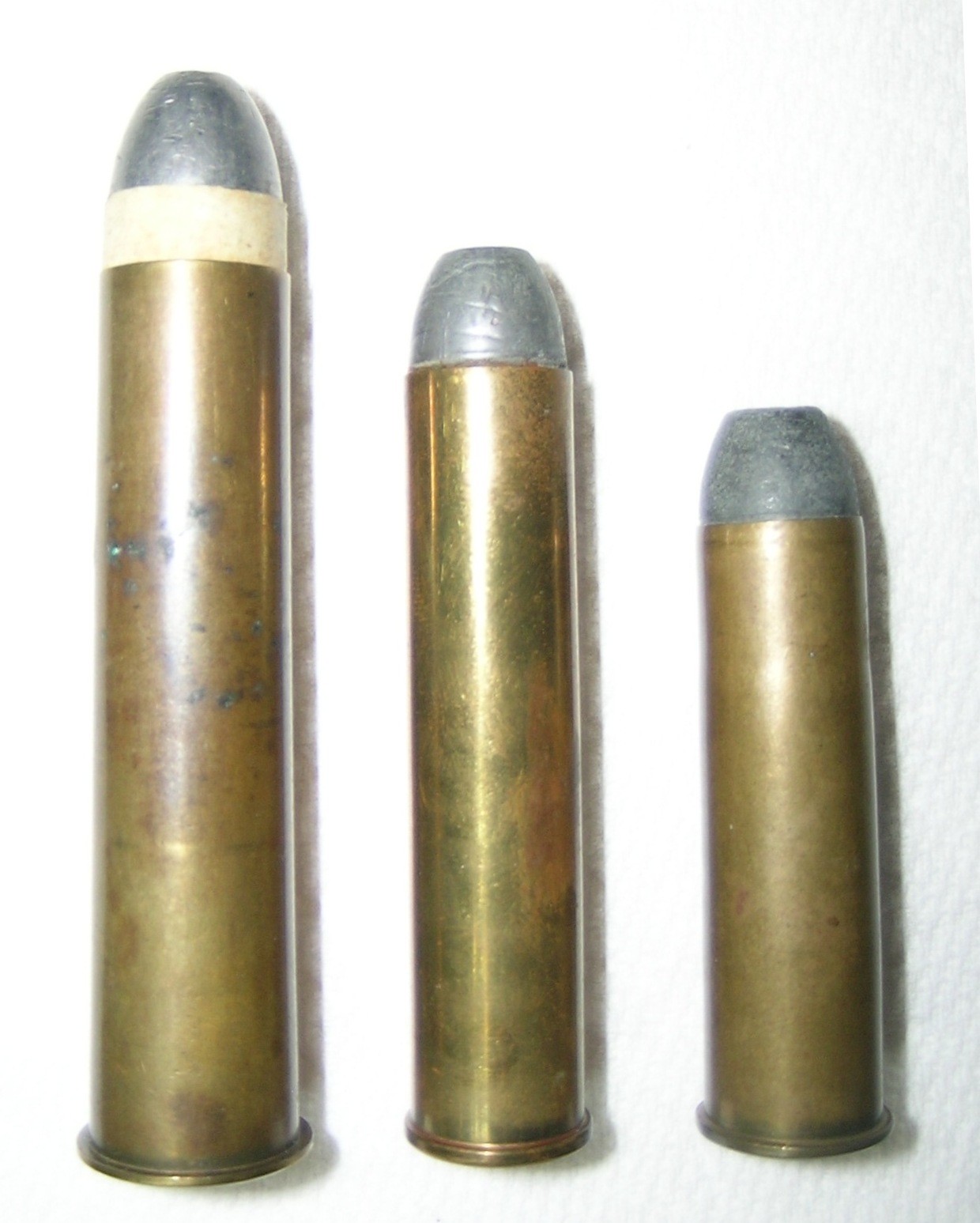

July 28, 2026 - 4:30 pm
Mark,
The Single Shot rifle was factory chambered for a larger cartridge… the 577 Eley.  In total (11) of them.  Most of them also went to India for large & dangerous critters.
To provide a visual, the attached picture shows a 577 Eley cartridge alongside a 50-110 Ex and a 50-95 WCF (from my personal cartridge collection);
