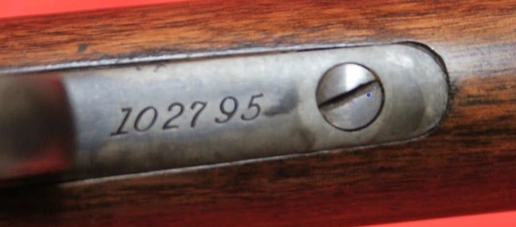

whats your guys opinion on the finishes of this rifle?
I’m by no means a player at this price point but just trying to learn.

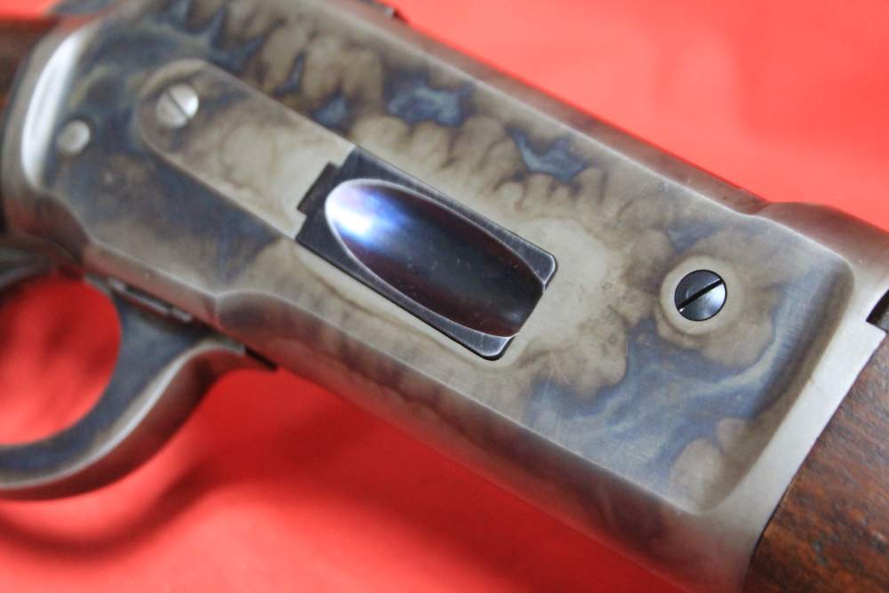

What about that screw in front of the loading port, its the only one thats blue??
July 27, 2026 - 6:52 pm
Good catch… it is an obvious clue that it has been replaced.

HOLY GRAIL WINCHESTER MODEL 1886 Chambered in .50-100-450, SERIAL # 102795-img-10
Forum Posts: 2106
July 27, 2026 - 7:31 pm
Makes me wonder if it was done on purpose in relevance to the other two screws on the same side, to show contrast and make it look more attractive!
Beauty being in the eye of the beholder!

Does any one feel the stampings’ fonts/typeface are just a little…”off”? They seem pretty sharp and new looking but the wood condition (considering I agree it’s had work done or cleaned up) doesn’t match for me. The metal is nice and I like it as “well-cared for,” but something is off for me….

3.  the receiver screw forward of the loading gate is obviously a replacement

The caibre stamping looks very off to me – it is too deep. As does the barrel stamp.

I’m in agreement with Rick and Bill.

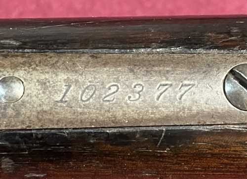

In addition to having gone through a recent mediocre restoration, retaining 0% original finish and having a new barrel installed, the serial number appears to have been hand stamped with an incorrect font and poor spacing.  The 0, 2 and especially the 7 are quite a lot different. Winchester serial numbers from this timeframe were typically much more evenly spaced and aligned.  Here’s an example of a serial number from an 1886 from the same timeframe in my collection for comparison:
It certainly raises the question of whether or not this was the original serial number applied to this tang.  Mark
Now that you point that out…
Makes me suspect the rifle was created to match the letter.
