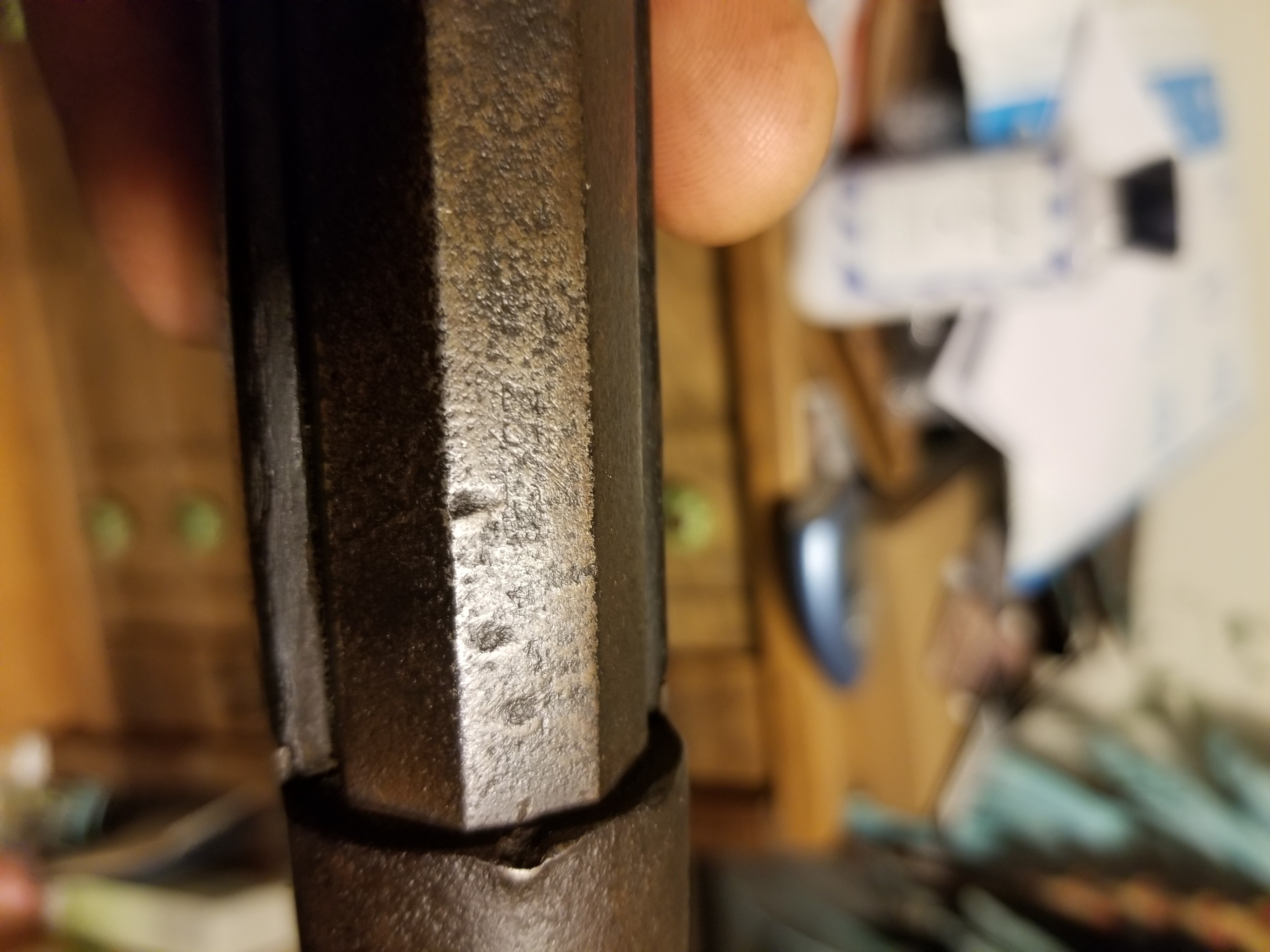

I am new to this group as of about 20 minutes ago. I just received a few of my grandpas old guns from my grandma and one is a 1885 25-20 wcf i am trying to find out as much as i can on this rifle including trying to find an ejector for it because this one is broken. My great great grandpa found this gun inside a wall that he was remodeling back in  the day and it has only been known to shoot a rat and to put down a sick calf since that point is what my grandma told me. Im also looking for ammo, brass, lead molds and anything else that i might need. My grandma gave me the gun and said that i have to pay her in venison next deer season for this gun. I am very new to this rifle and dont know much. Any information is appreciated

If you can post the serial number, I can most likely provide you with the answers to almost any question(s) you may have about the rifle. If you can post pictures, please do so.
What is the exact caliber marking on the barrel… e.g. “25 W.C.F., or “25-20 S.S.”, or “25-20 W.C.F.” ?

Serial number 82693 the barrel says 25-20 wcf it is hard to read the numbers the gun isnt in the best shape

I can barely make out the 25-20, but I can not see where that it is marked “W.C.F.”
I agree with Clarence… your low-wall is in really poor condition, and I highly suspect that the bore looks like the exterior of the barrel.
Do you have a 25-20 WCF cartridge?  If you do, will it seat in the chamber?
Roll the rifle belly up and take a clear picture showing the entire bottom of the receiver frame.

I can see that the lower portion of the extractor is still in place.  One has to wonder how the upper part of the extractor was broken off.  The extractors are generally speaking quite robust for the center fire Single Shot Rifles.
What does the bore look like?  I highly recommend finding a 25-20 WCF cartridge and see if it will chamber properly.

Ordinarily Yes, I can tell by the serial number.  However, I cannot tell if somebody reamed out the chamber on a 25-20 S.S. in an attempt to shoot the much more common 25-20 WCF.  Based on the ledger entry for this rifle’s serial number, it should be a 25-20 S.S.  Because the extractor is broken (or was intentionally altered) I suspect that somebody tried converting it from 25-20 S.S. to 25-20 WCF.  The only way to know for sure, is try seating a 25-20 WCF cartridge in it.
If the OP knows how to remove what is left of the extractor, the mystery of what it was originally chambered for can be answered by the marking on the side of the extractor base.
