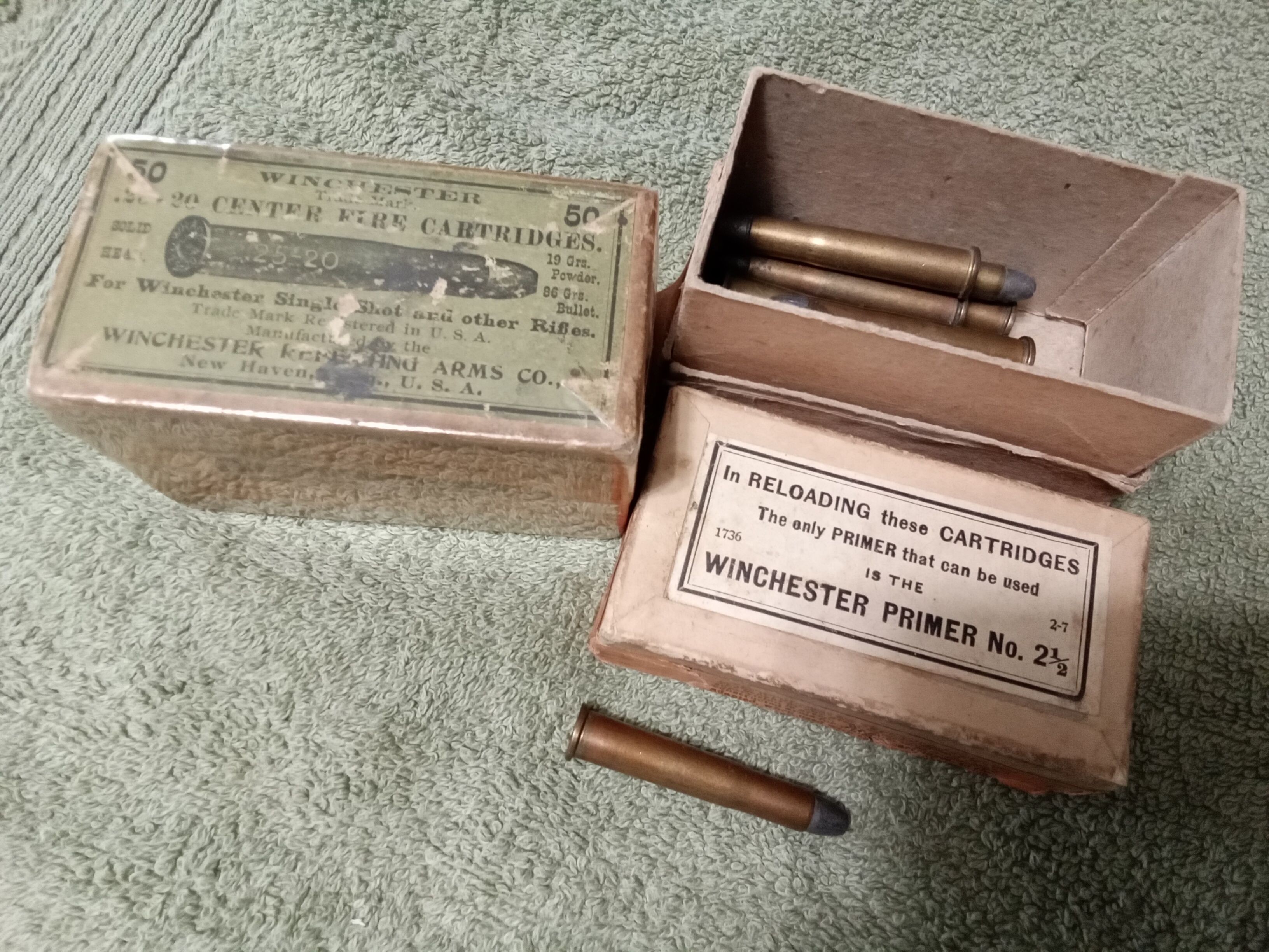

If marked that way, it was mfgd. AFTER Win introduced their .25-20 Repeater cartridge for the M 1892, because those mfgd. before then were marked .25 WCF.  Win was caught in a trap of their own making by falsely claiming as their own (which “WCF” implies) a cartridge first chambered for the M 1882 Maynard, & designed by an independent cartridge experimenter (F.J. Rabbeth), what would later be called a “wildcat cartridge,” like the .22-250.  So when the Repeater cartridge was born, the company was caught with their corporate pants down, & HAD to change markings for their SSs chambered for the original Rabbeth .25-20.

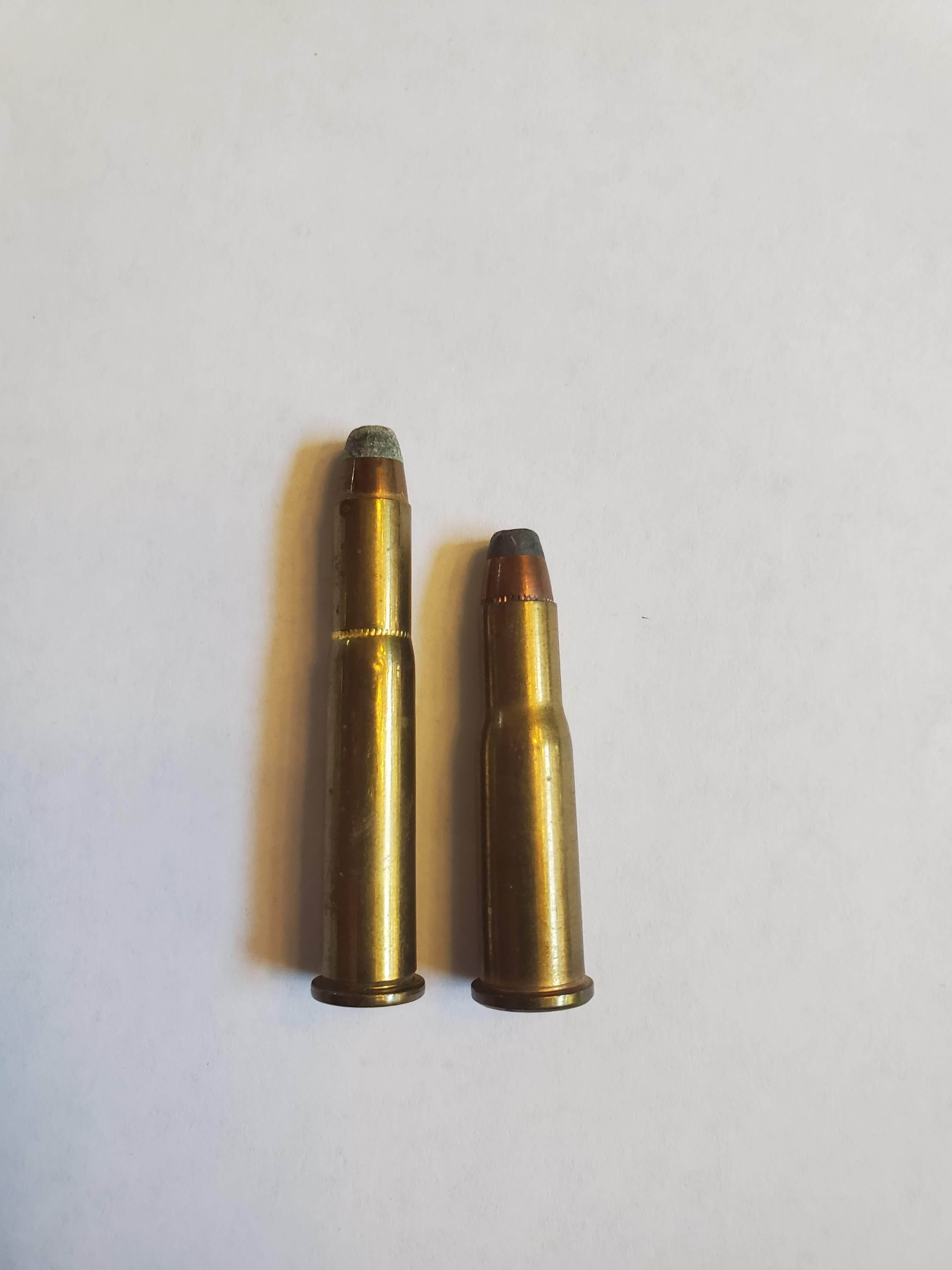

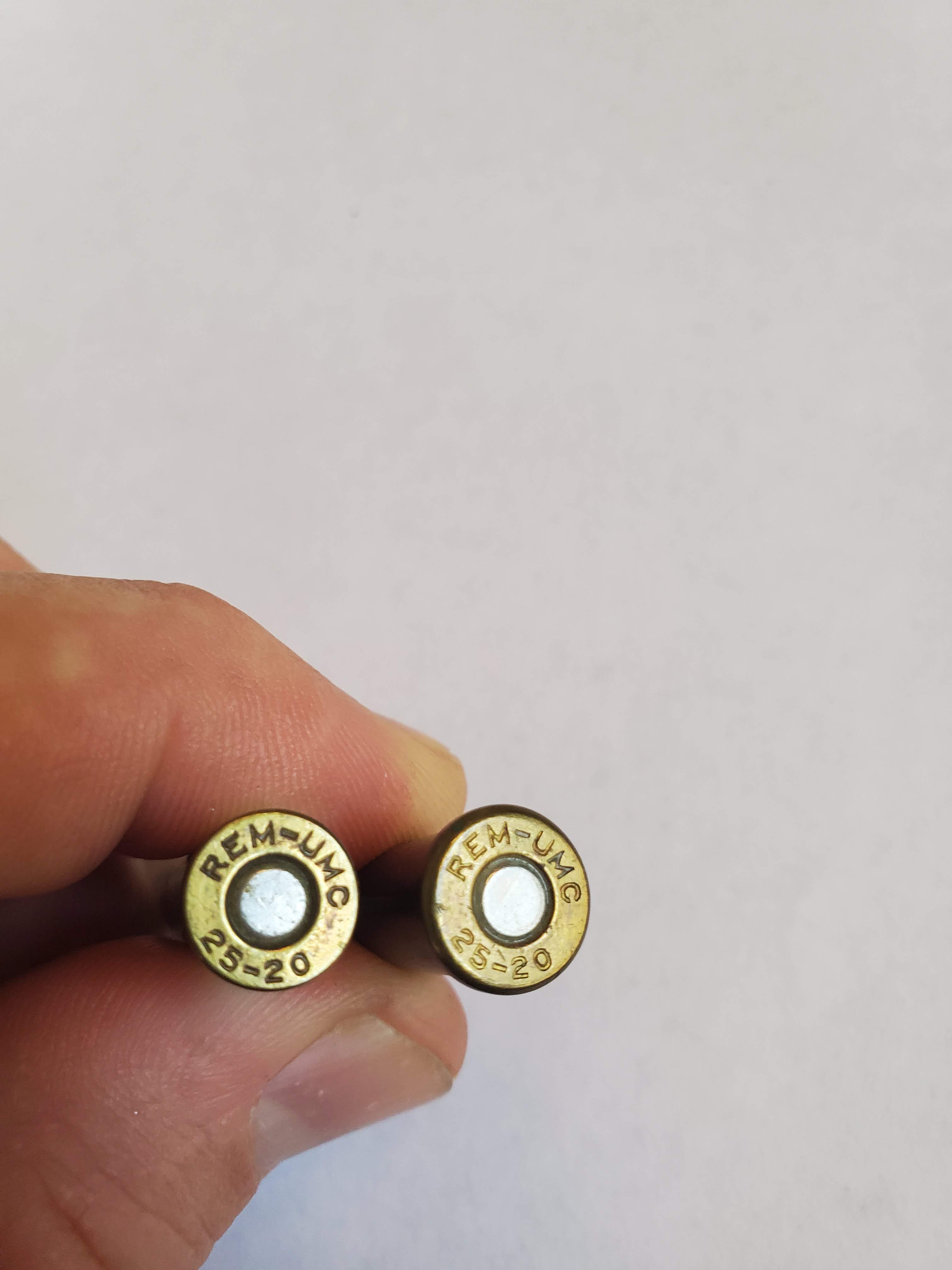

Don’t have a Marlin cartridge head stamp but found this in the cartridge forum. UMC side by side .25-20 SS(Single Shot) and .25-20 WCF, developed in 1895. Same head stamp. Not sure what year these were made but would appear smokeless looking at the primers and jacketed bullets.

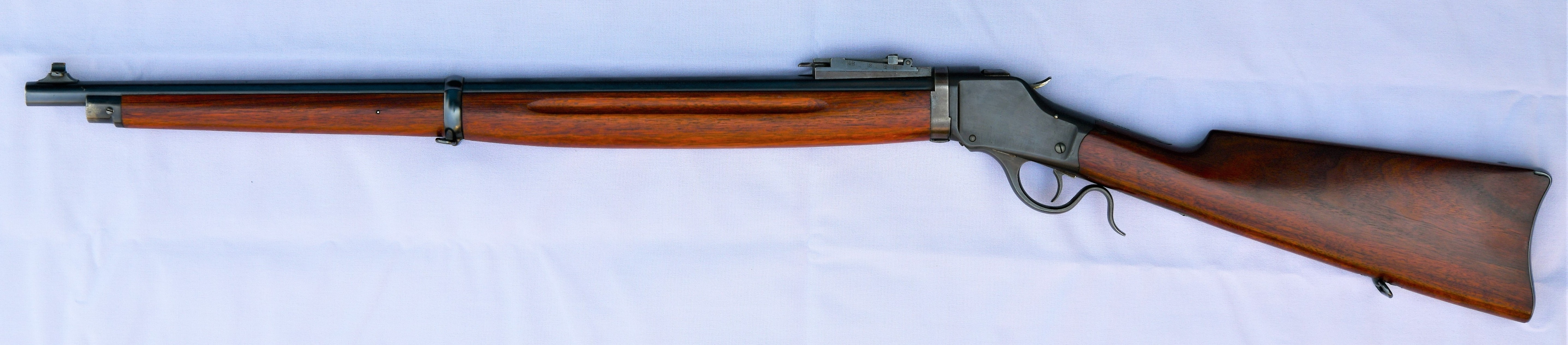

Rick C

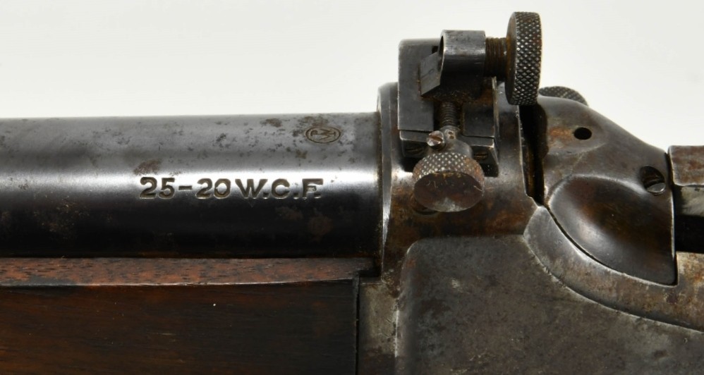

Yes, the Winchester Single Shot was factory chambered for the 25-20 WCF (repeater) cartridge, but not very many of them.  The vast majority were chambered for the 25-20 Single Shot cartridge.  The 25-20 Single Shot was introduced in 1890, and it was originally marked “25 W.C.F.” on the barrels.  When Winchester eventually introduced the 25-20 W.C.F. (repeater) cartridge for the Model 1892 (in the year 1895), Winchester changed the caliber marking for the 25-20 Single Shot to “25-20 S.S.” and added the “25-20 W.C.F.” marking for the repeater cartridge.  The “25 W.C.F.” marking was discontinued late in the year 1895.
If you encounter a Single Shot rifle with a “25 W.C.F.” caliber marking, it left the factory chambered for the 25-20 S.S. cartridge.  Due to the confusion that was created by having two cartridges with nearly identical names, a fair number of original 25-20 S.S. chambered rifles have had their chambers reamed after the fact to the larger diameter (but shorter) 25-20 WCF cartridge, and then (usually) a hack job to the extractor to make it functional with the larger rim diameter of the 25-20 WCF repeater cartridge.
In my article (published in the Winter 2021 WACA Collector magazine), I briefly discussed this same topic.  In my survey of the Single Shot, the 25-20 S.S. was the vastly more common cartridge as compared to the 25-20 W.C.F. cartridge… 7,585 versus just 58.
Bert, do you know if there were any model 1885’s still produced in 25-20 SS with barrels already manufactured in the SS caliber, after 1895 when the 25-20 WCF came out.
My Winchester 1899 catalog doesn’t even list 25-20 WCF chambering for model 1885, only 25-20 Single Shot. There is a difference in the cartridge head stamp in this catalog, but not always correct as we’ve learned.
