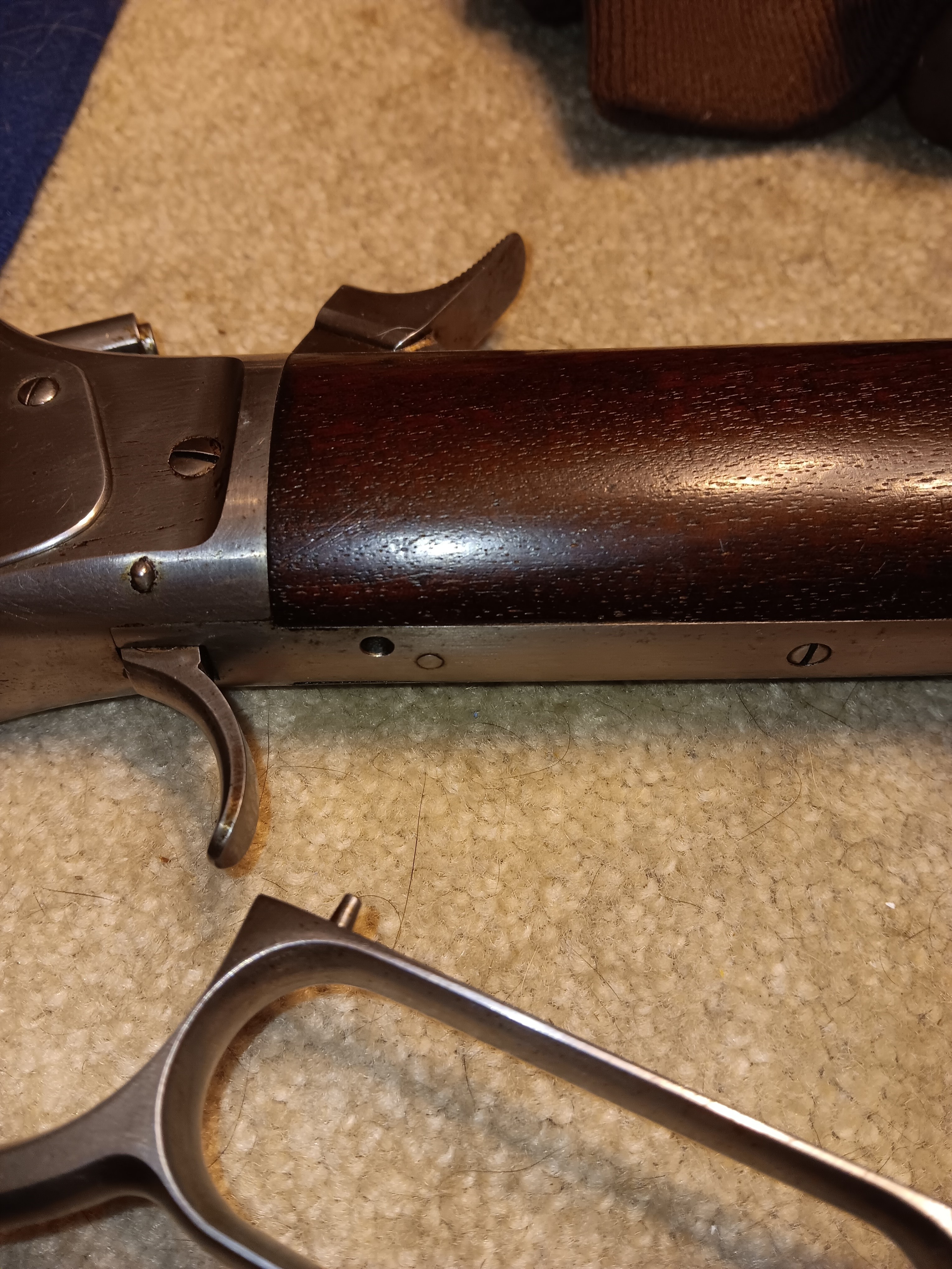

Don, I too have issues finding and including my photos.  Also an old dog.  Here, I hope, is the 1868 musket with the pin going into the lower tang.  Note the pin is tapered.  It is a Luke Wheelock design.  Tim20230314_115023.jpg

Don and others, here is the early model 1876 sn 455 system as produced to unlock the trigger block safety.  Note the pin is shorter and appears straight compared to the longer, tapered pin on the lever of the model 1868 prototype musket.  While a bit out of focus, the contact pin inside the lower tang shows in the hole and is bright from use.  Hope this helps explain the system, as used.  But does nothing to explain the key hole milled sideways through Don’s model 1873 finger lever.  Tim  Well, its coming up as too large and won’t down load.  Crap!  Also don’t know nor want to know how to change it!
