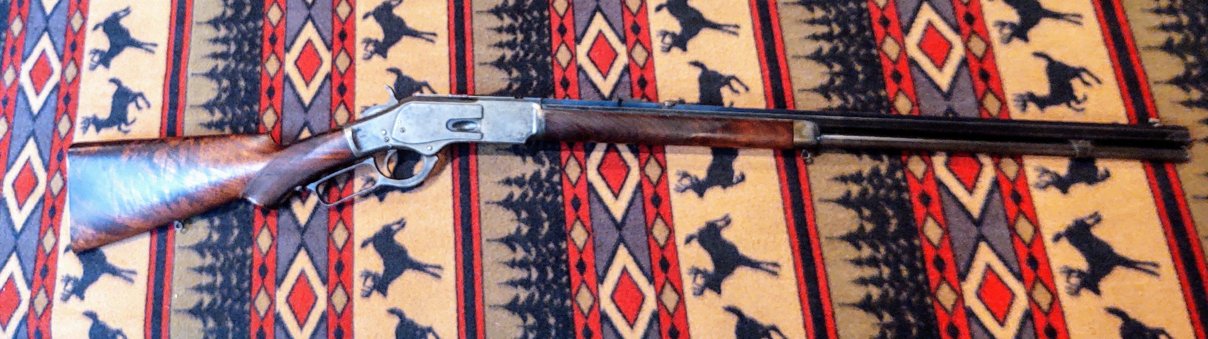

I have an 1873 2nd model deluxe rifle with 24″ octagon barrel, pistol grip with fancy checkered walnut stock, in unmarked 44-40 caliber.
The serial number is not found on the lower tang as usual but has unusual numbers between the lever lock and last stock screw.  74  16 appears but I’ve never seen markings like this on a 73.
Inside the buttstock are 3 numbers  xxS674 which match the lever tang numbers.
Any help on the serial number and dating it would be greatly appreciated.

 What you have is the lower tang was broken or swapped at the lever latch. The serial number is 74×16 were the center digit is filed off in the process of welding and is not readable.
The number on the wood and lever are assemble numbers and have nothing to do with the serial number. The S is for shotgun butt and the XX is the grade of the wood. Look on the insides of the side plates for numbers. Those can be the last digits of the serial number.

Bob, much appreciated for the information.  You were spot on correct.  I took the stock off again to inspect the tang and it has obviously been repaired as seen and felt by the weld.  The side plates have the same two last digits as on the lower tang SN but unknown what the center numbers are since they are obviously filed off during the weld.  Not sure if I will ever be able to tell what it was.

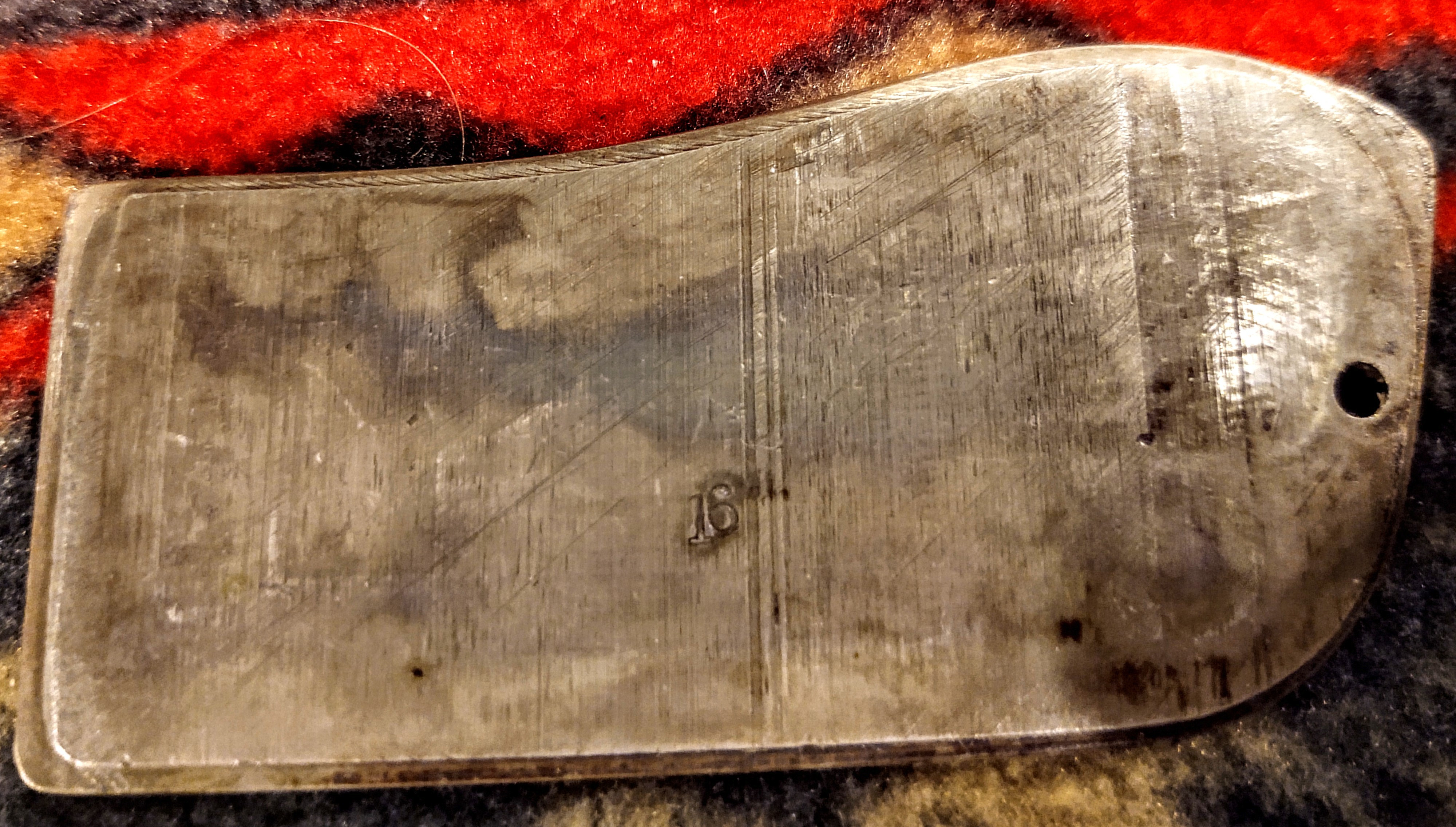

Here are the side plate photos.
Also I see the lever stamped with a assembly number which makes me think the side of the elevator might be as well.
Also another place to look is on the side of the butt plate screws. It just might be engraved guns that I have seen that one done but its worth a look and while you got those off there should be a number on the butt plate near the toe.
I did not find an assembly number on the elevator nor on the butt plate.  I also checked the screws on this one and on my Ulrich engraved 66.  Neither has numbers on the butt stock screws.  The 66 does have assembly numbers on the butt plate however.

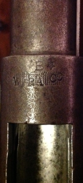

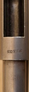

As a point of interest, the Winchester firearms that Sears & Roebuck intentionally altered have “WRACO” stamped over the top of the original serial number.  They first stamped a cross-hatch pattern, then stamped the WRACO marking.  This is found on several models, all of which were manufactured in the mid to late 1890s.
