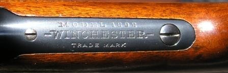

8. Compare your rifle’s upper tang stamp to the following series of photos and which one does it match exactly?
If you have a Type 1, if there is no period at the end of 1884 on bottom line it is a 1B
If there is no period at the end of either the upper or lower line it is a Type 1A
Type 1
Type 2
Type 2A If you have a Type 2A is the “MOD 1892” stamped perpendicular to the length of the tang just under the hammer? Please note which you have.
Type 2A Alt
Type 3
Type 4  Look especially close at the bottom line for the inclusion of “& FGN” for the type 4 style.
Type 5
Type 6
Type 7
