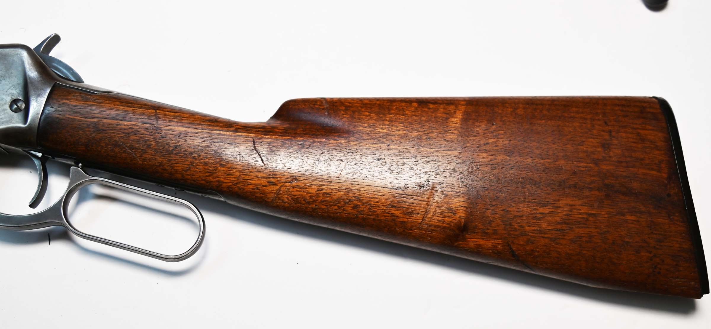

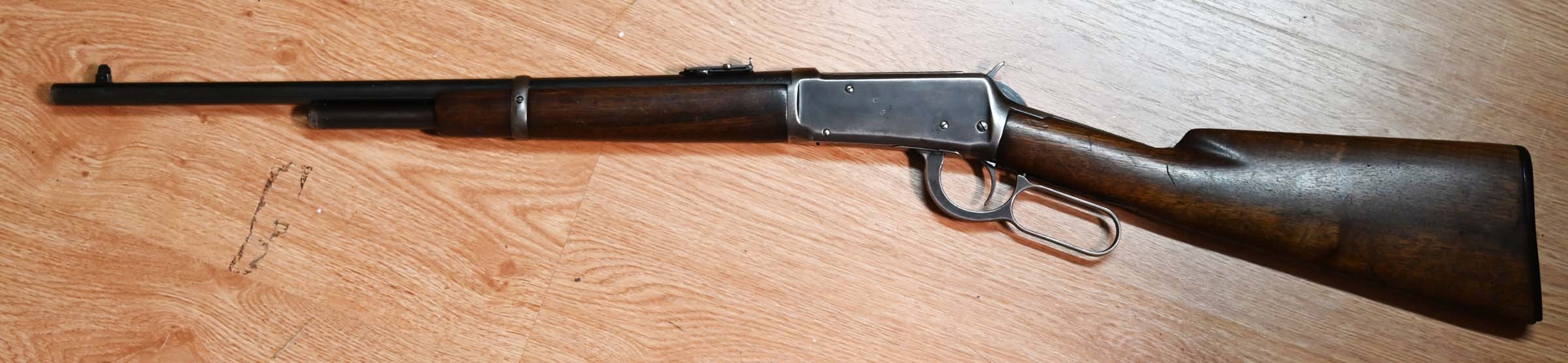

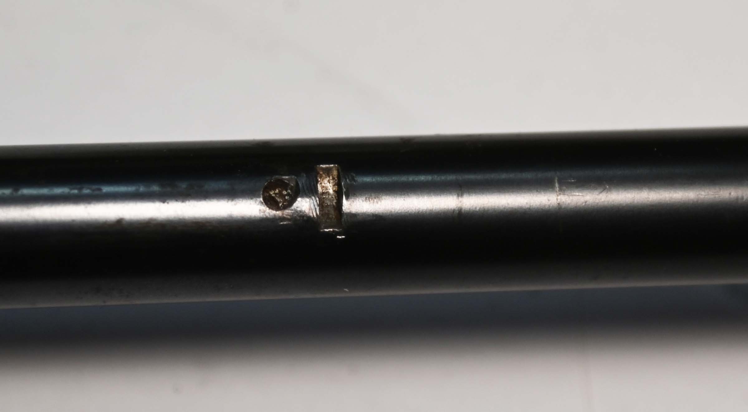

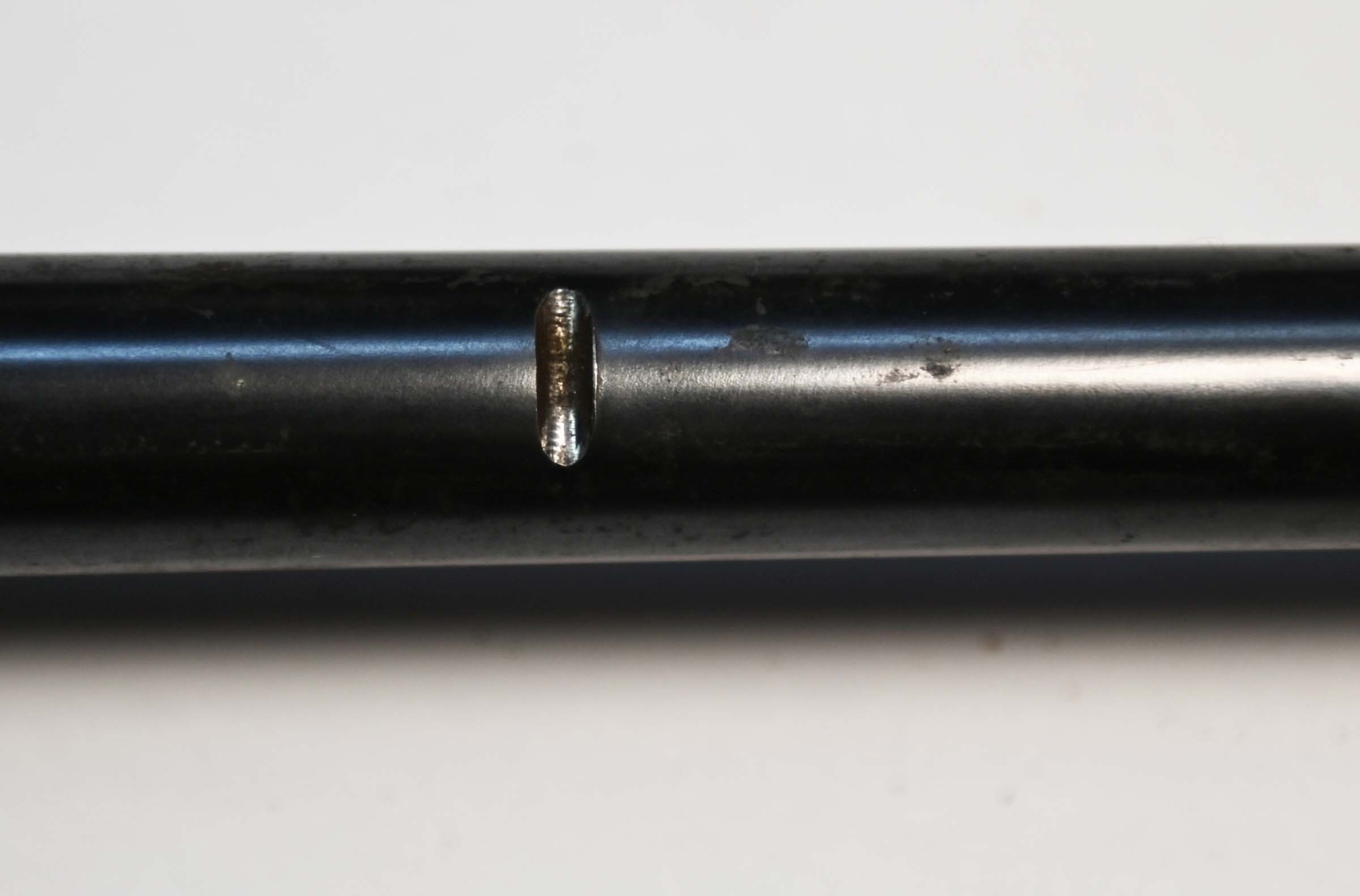

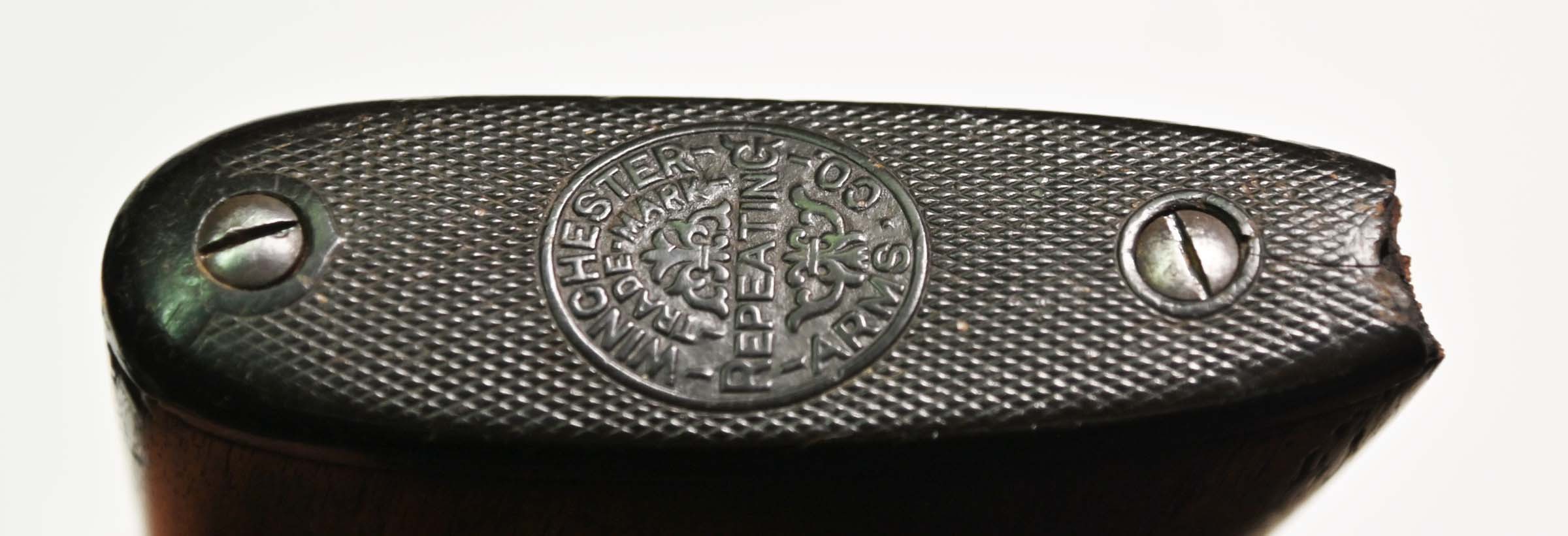

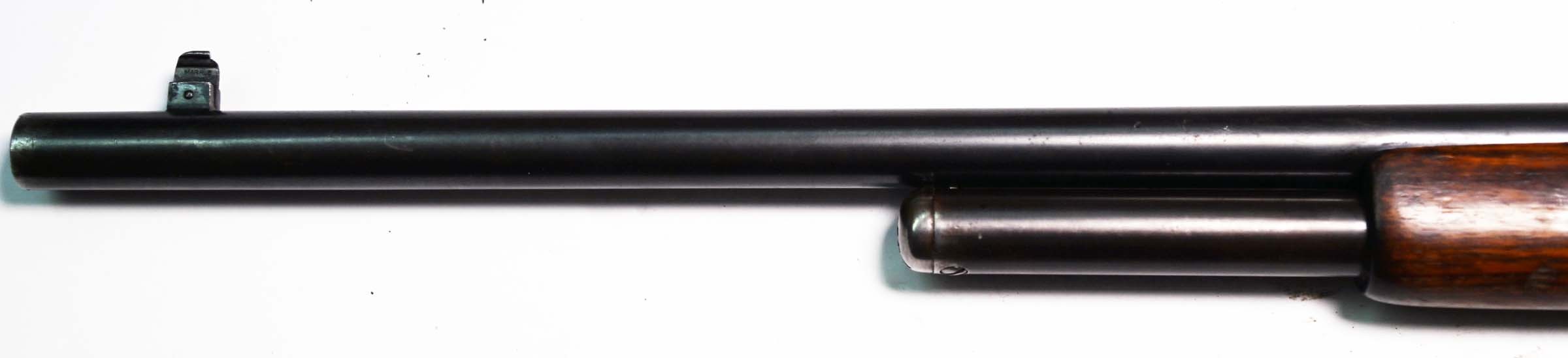

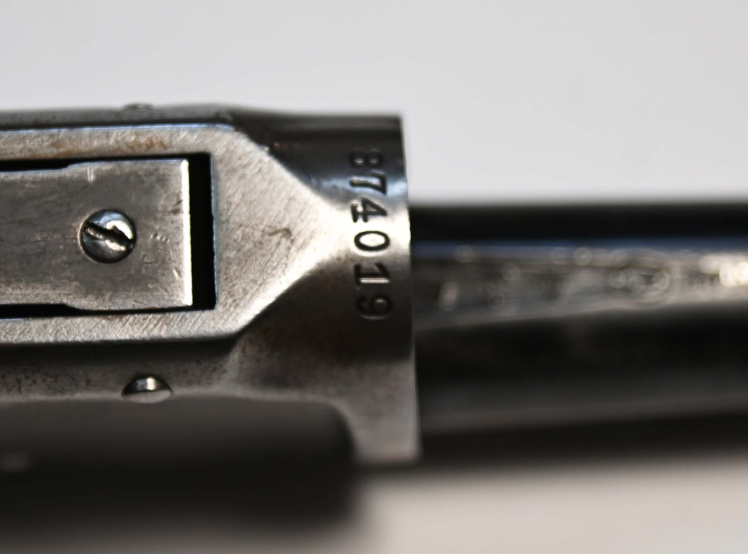

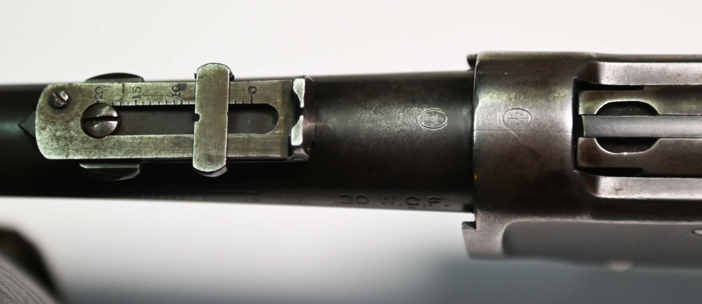

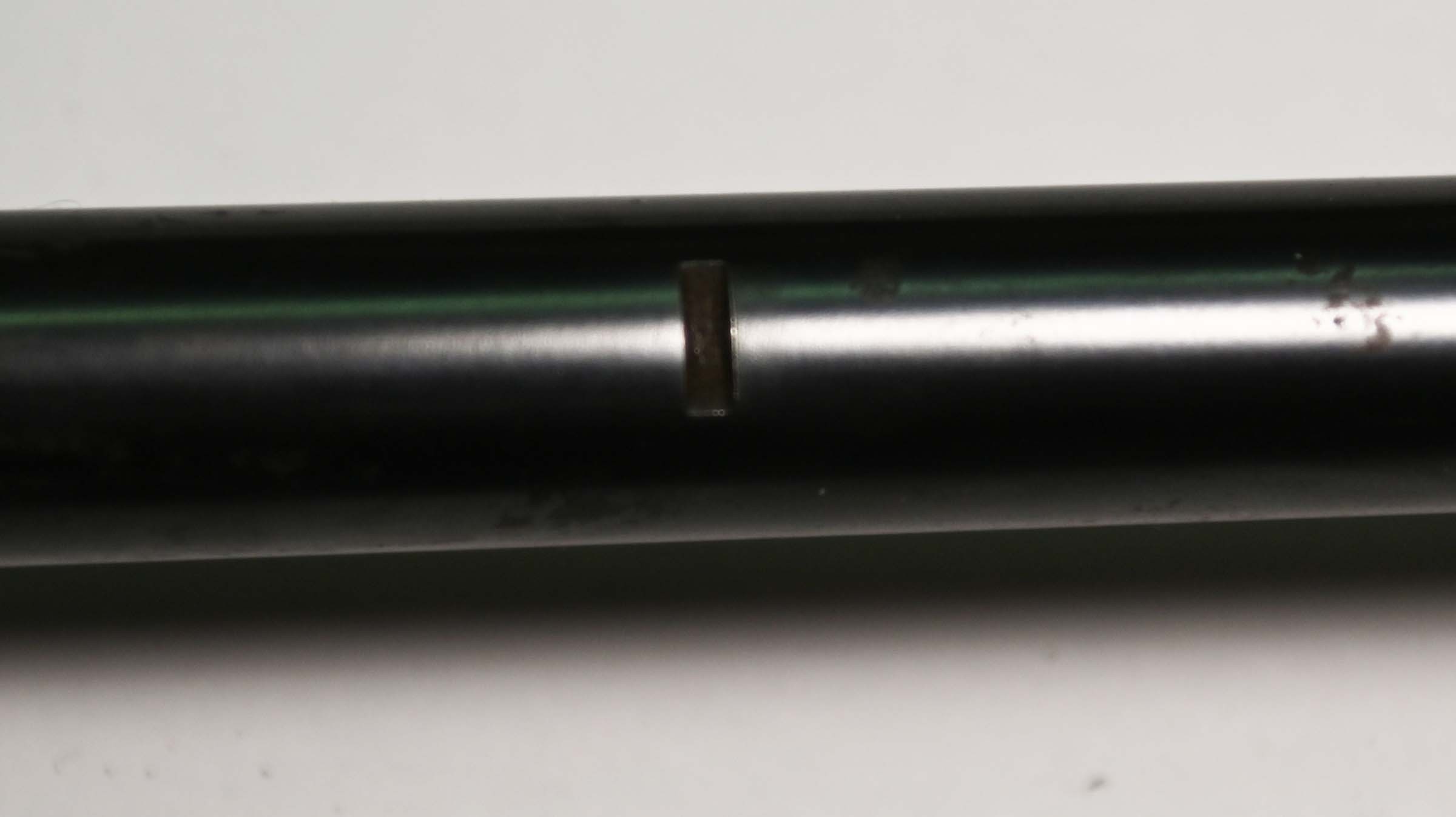

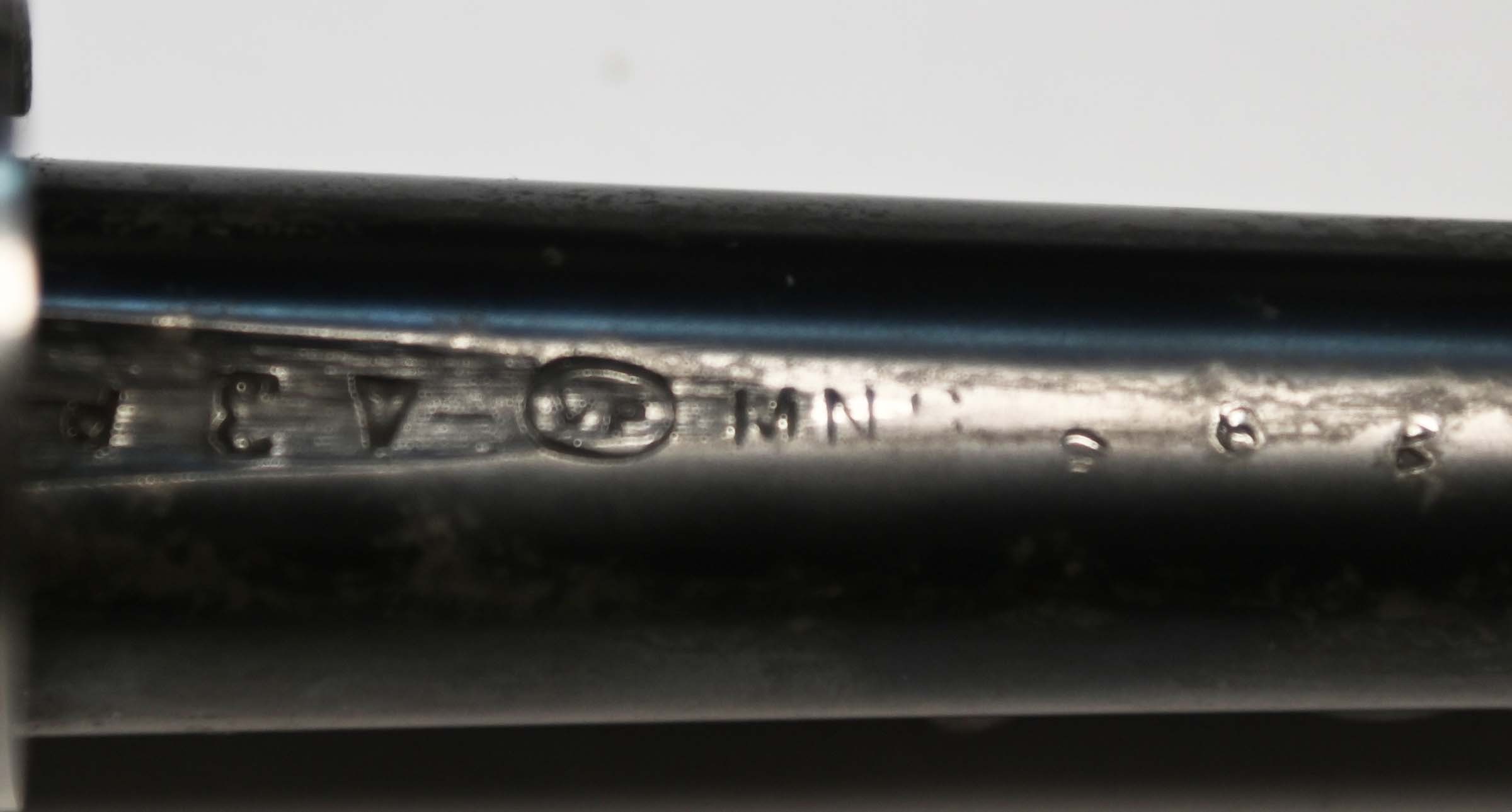

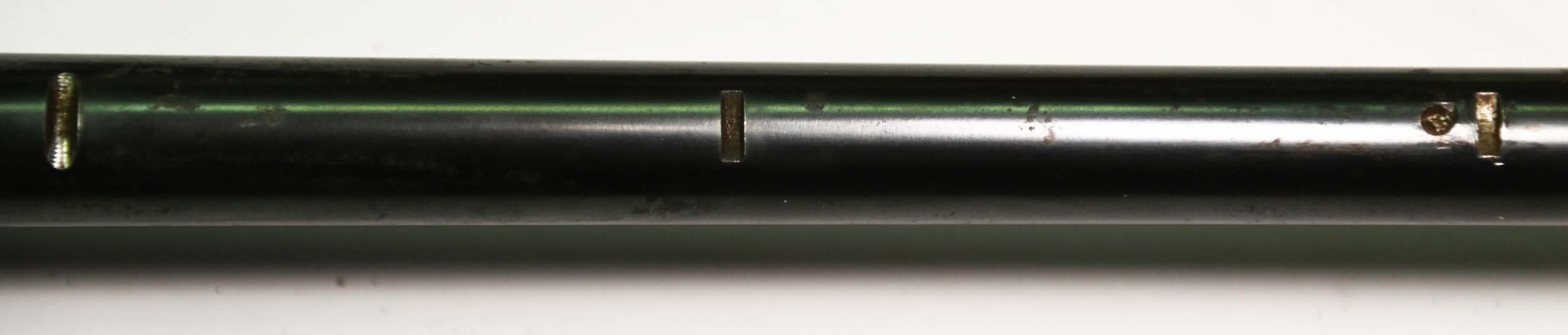

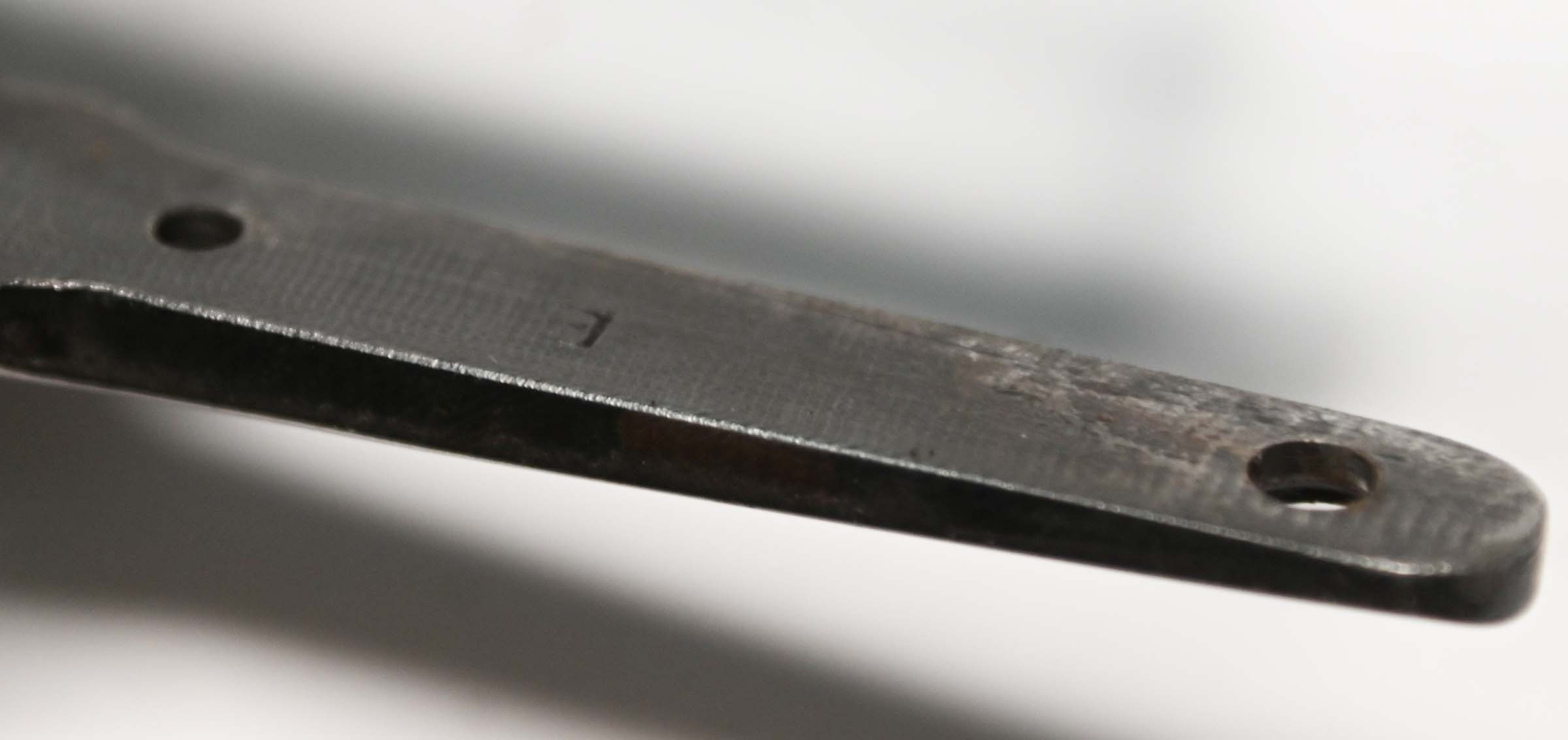

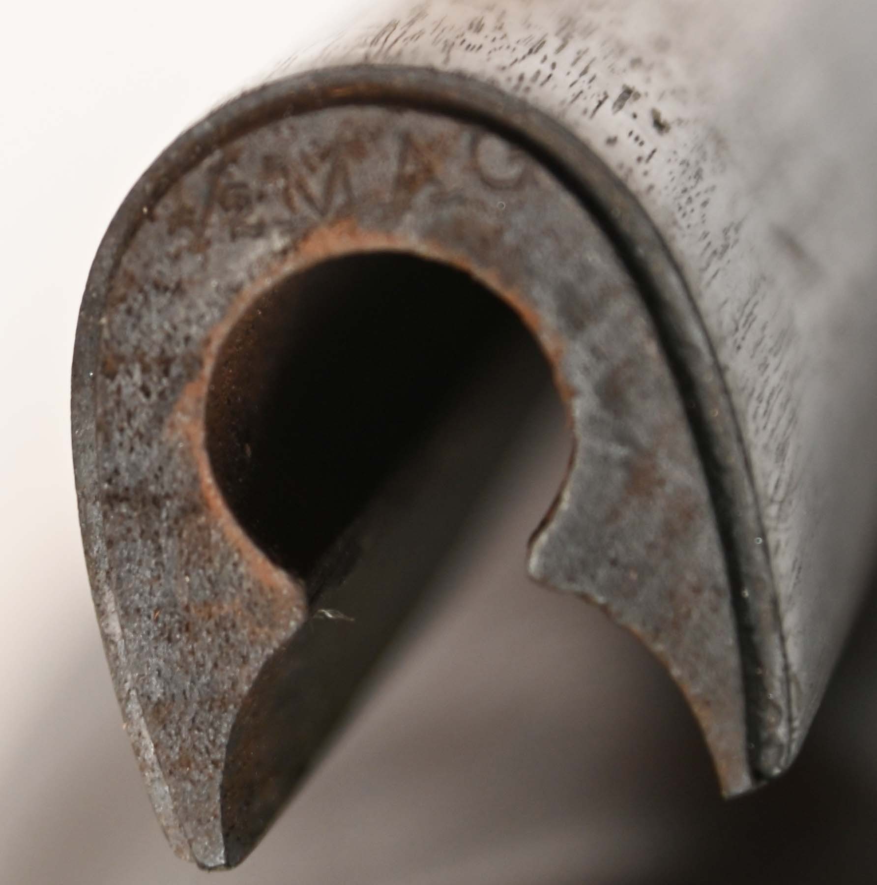

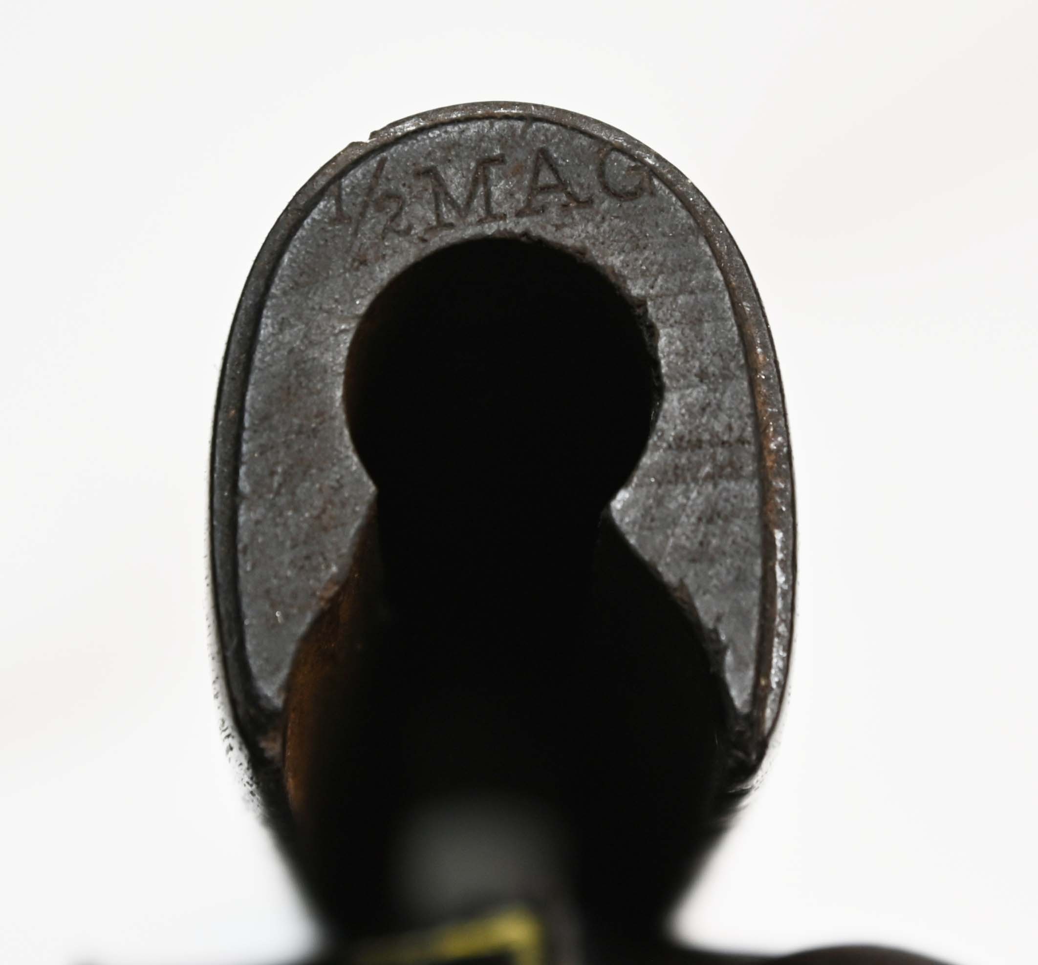

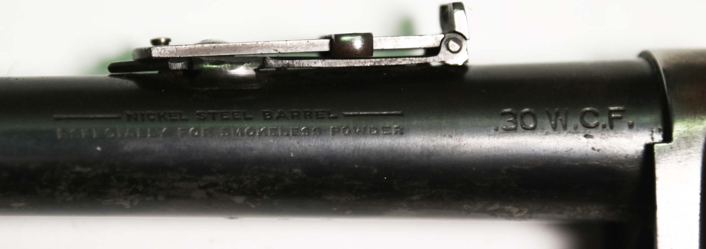

I have an Eastern carbine with the Colonel Whelen grooved comb butt stock .
Serial number 874019
Caliber 30 WCF
Barrel is 20″ round
5/8(?) mag tube 12&1/2″ long with 9&1/8″forearm.
Shotgun butt with 4&1/2″ checkered hard rubber putt plate with oval Winchester logo
No saddle ring
There is a machined groove on barrel bottom that would take the lip of the round top mag tube cap for a 1/2 mag tube. All 3 grooves on barrel bottom appear factory machined. The round top mag tube cap has screwdriver slot and the lip for fitting into the forward barrel groove. The mag cap screw extends through the cap and the mag tube nd fits in a shallow hole in the bottom of the barrel. There is a large E stamped under the upper tang.
George

Forum Posts: 14919
53
June 24, 2025 - 11:23 pm
Caliber 30 WCF
Barrel is 20″ round
No saddle ring
George
Port Alberni, BC94-SRC-874019-barrel-marks-2.jpg94-SRC-874019-butt-plate-2.jpg94-SRC-874019-forearm-receiver-end-stampleft-2.jpg94-SRC-874019-full-left-2.jpg94-SRC-874019-left-butt-stock-2.jpg94-SRC-874019-left-front-view-2.jpg94-SRC-874019-serial-number-2.jpg94-SRC-874019-top-chamber-view-2.jpg94-SRC-874019-under-barrel-forearm-screw-groove-2.jpg94-SRC-874019-under-barrel-grooves-2.jpg94-SRC-874019-under-barrel-mag-cap-machining-2.jpg94-SRC-874019-under-barrel-marks-2.jpg94-SRC-874019-under-barrel-unused-machining-2.jpg94-SRC-874019-undr-upper-tang-mark-2.jpg
Hello George,
Your Model 1894 is a special order “Eastern” Carbine with a ⅔ Magazine. It was manufactured in February 1918.
Pondoro
