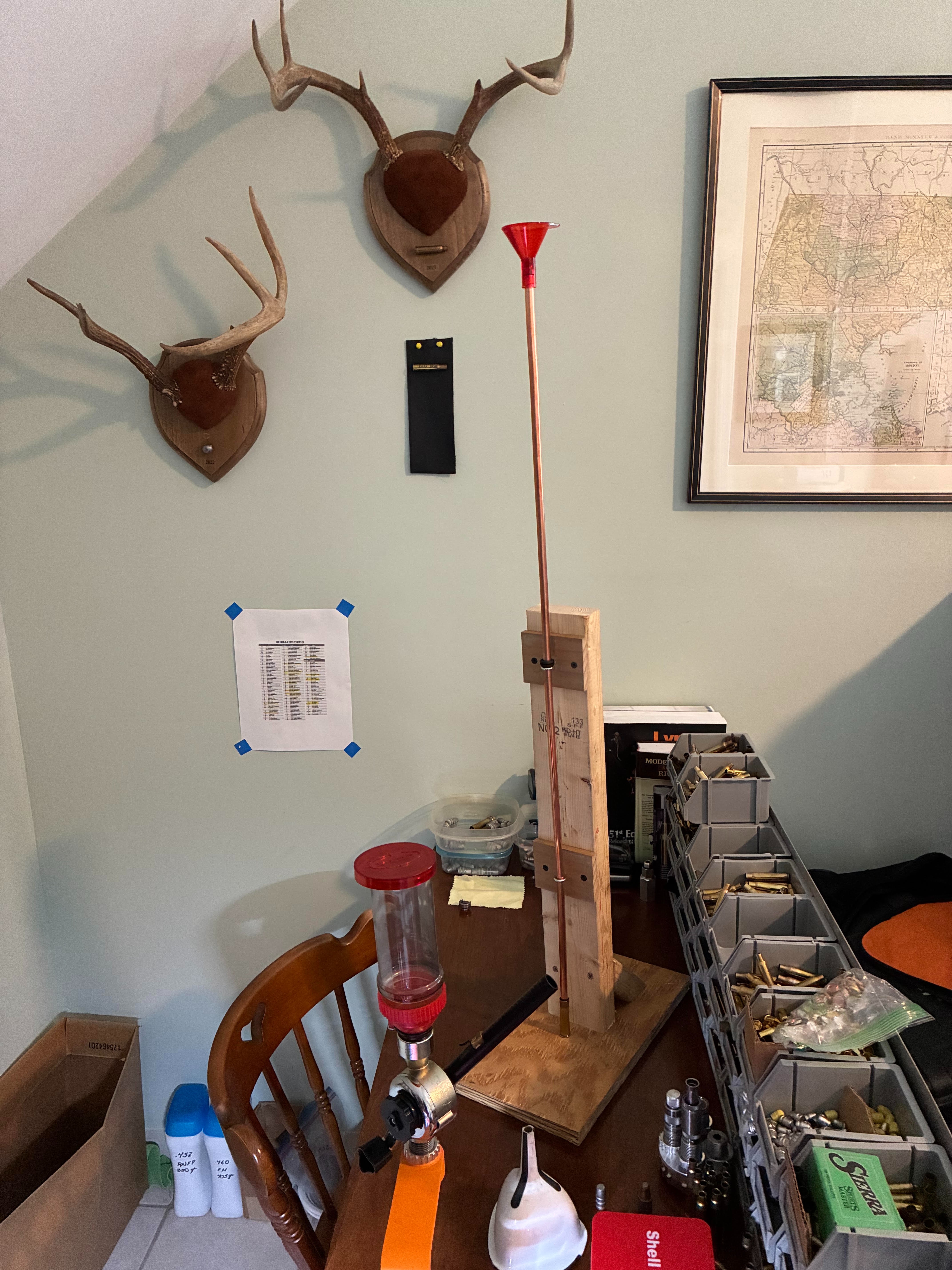

I’ve been happy with my black powder sessions with the 1885. Last weekend, I cobbled together a drop tube. It really does make a difference in being able to fill the case with more powder. Hopefully, I will be able to make it to the range tomorrow and have some fun shooting.unnamed.jpg

Good job on the drop tube! Looks somewhat sturdier (and steadier!) than my store-bought version. I understand you may gain some consistency as well as capacity but I’ve never documented it.

Thanks Mike. It’s a little ( a lot ) overkill. I just didn’t want it collapsing under the weight of 65+ grains of powder.Kiss
