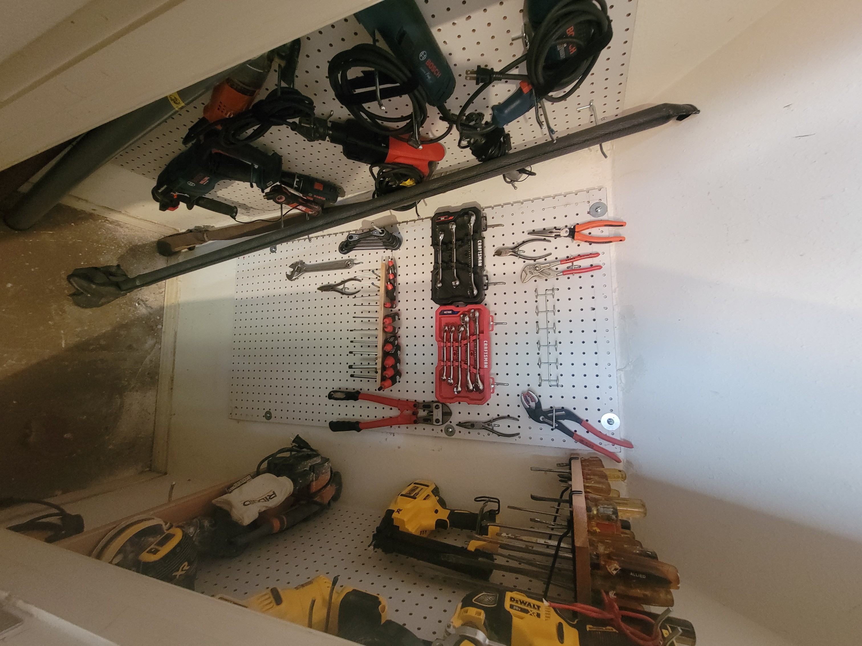

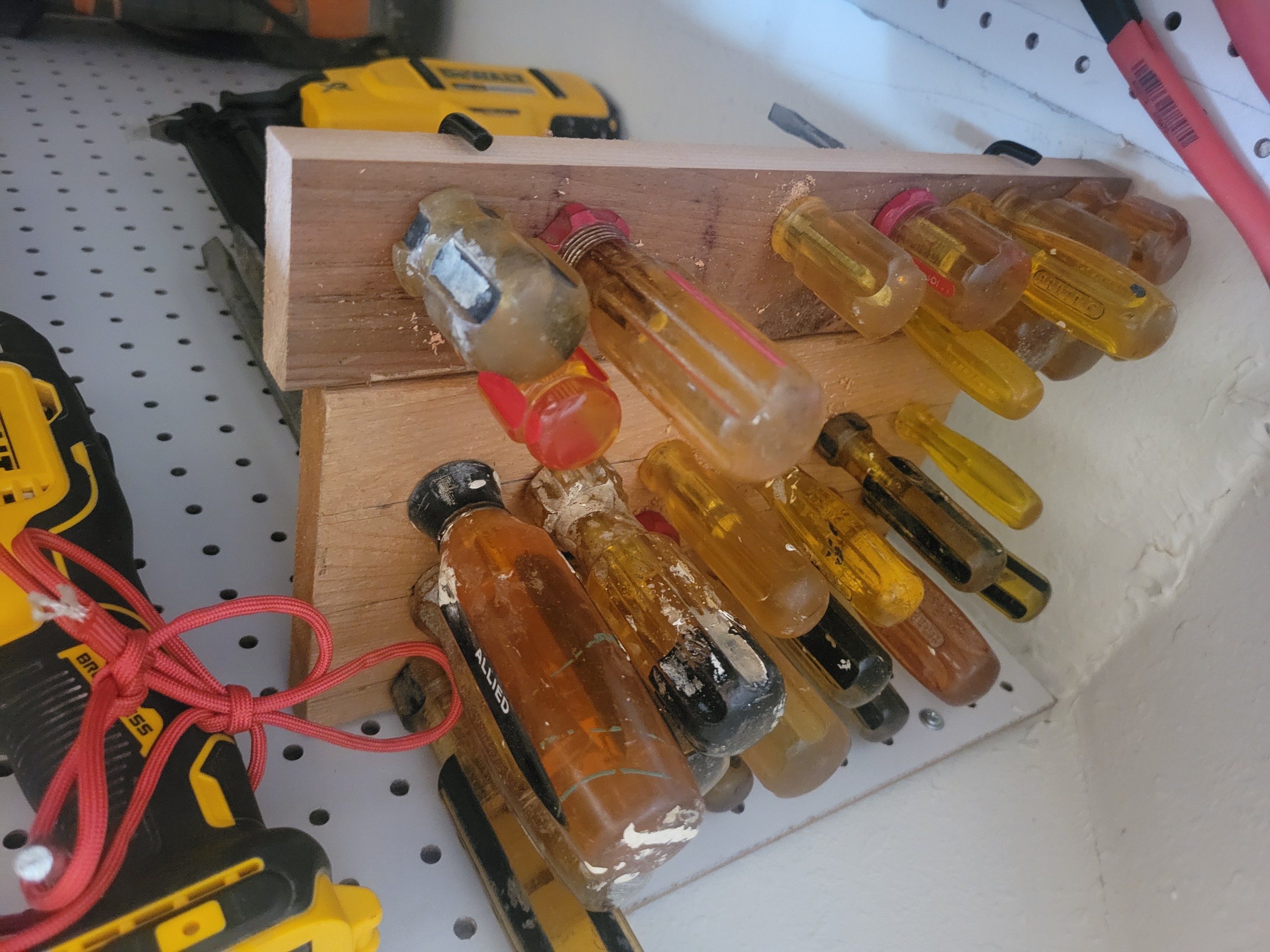

Thanks, Mike. I’ve actually got some eighth inch sheet steel left over from making a flitch plate. I may just slice a little off the ball before I roll it between those. I’ve got Dad’s  big Wilton vice if it needs more persuasion.
I’ve been struggling to get my garage shop better organized and I should soon turn up a red Hornady box or a Speer yellow box. Under one of the remaining piles. 20260502_154553.jpg20260502_154455.jpg

Nice! I’ve been thinking about a screwdriver rack for my bench. I like having a regular screwdriver handy now and then but they seem to enjoy hiding at the bottom of tool boxes or drawers.

I found the .490 balls,  some grease, but it looks like I’m out of 3/8 oak dowel. Plenty of Poplsr but my Oak dowel stock is 1/2″ and up. I’ve got a gardener coming in the morning to flatten the Asiatic Jasmine beds that cover half the front yard. As soon as he leaves, I’ll go to HD and pick up a stick.  I can either fit a flat knob to a short starter piece or just use my rawhide mallet to drive the plug flush with the crown. I dislike whacking the crowd even with rawhide, though.

May 7, 2026 - 3:43 am
I spent too much time making holes on a drill press. It stays set up for 500 rpm for metal and rearranging the belts is a pain. I added a couple of holes to the top when I found two more screwdrivers and did those with a high speed portable. Worked just as well.
My gunsmithing tools are upstairs but I use Brownell Magnatips in the little red boxes that won’t stay open. Someday…….
