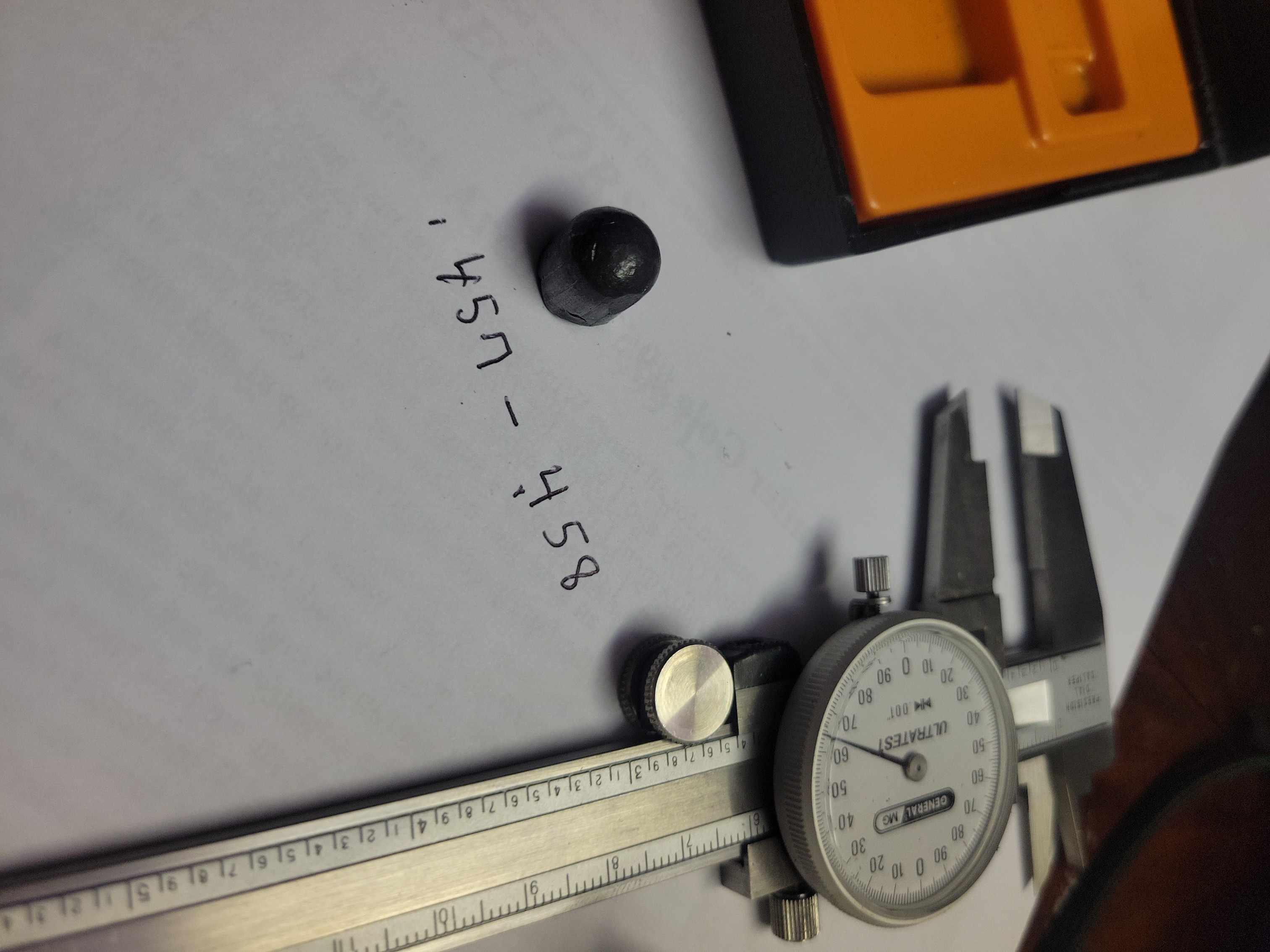

kevindpm61 said
Bill, I tried various sizings during load development. .460 was what my rifle liked best. In general, you should size your lead bullets .001 – .002 over the bore size. Have you slugged your barrel?

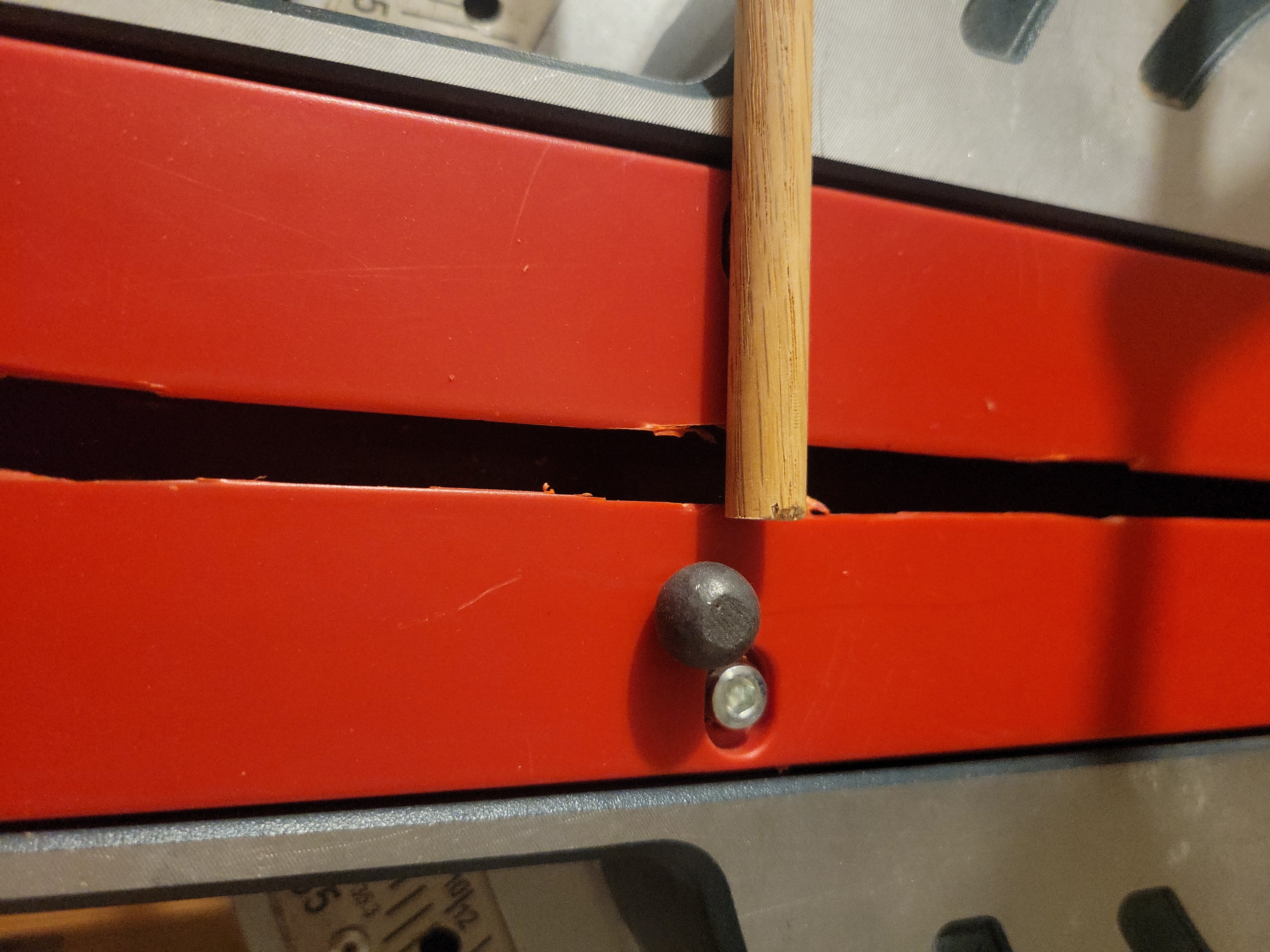

With Mike’s over-the-phone help, I upset a Speer .490 lead ball to get a flat, lubricated the bore with R.I.G., used a Brownell rawhide mallet to drive the ball flush with the crown, then tapped it through the bore with a 3/8″ oak dowel.
Across the grooves, I got .457 to .458 with a General Tool dial indicator.  I can’t read the dial any closer than that and it’s a 7 groove rifling. I had earlier spoken with Winchester Guns customer service and they advise their specification for groove diameter is .458. Interestingly they recommend .458 cast lead  projectile diameters and .456 for jacketed.
I miked Mike’s 330 grain hollow points he cast for me and the one I checked came out .458 and a blonde hair. He ran them through a .459 sizer die but doesn’t think the mold throws them that wide.

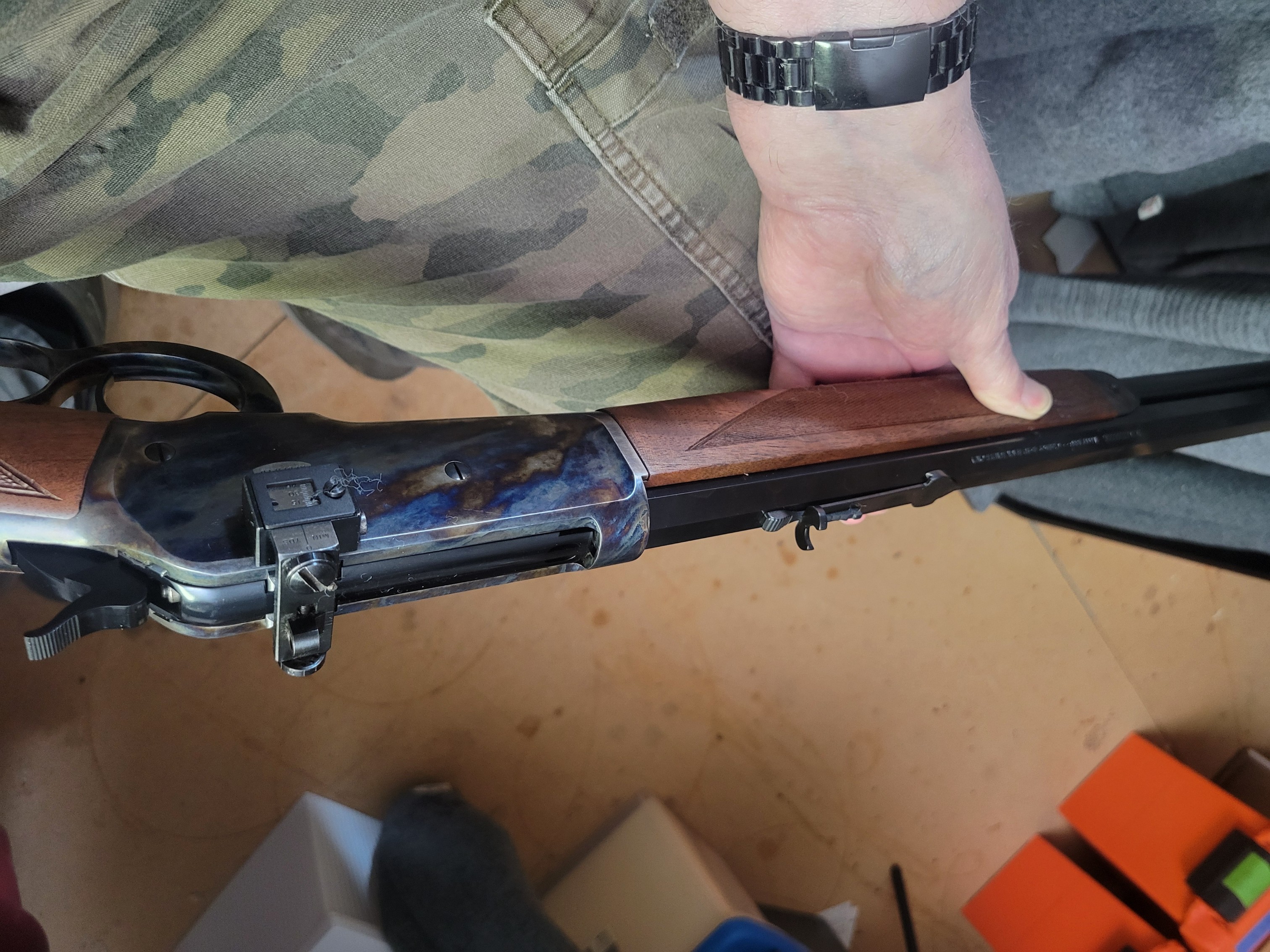

The rifle is a current production 45-90 Winchester Sporting Rifle, 24″ heavy octagon barrel with 1-in-20 twist. About 9.5 pounds unloaded. Rifle buttplate.
I’m going to load a ladder of these in new Starline brass with RL-7, starting with 38 grains and increasing a half-grain at a time, up to 44 or 45 grains. Once I get an accurate load of 1300-1400 fs, it will be Miller time.

Good job, Zeb! The horror stories of barrel slugging haven’t stopped me from slugging a few. I’ve used a 45-70 and a bit tougher bullet (at somewhat higher velocity) to cause some big piggies to transition to good piggies. A few were too big to provide decent table fare but some made the trip to my freezer. That Gould bullet should upset and transfer energy quite efficiently but I’ve always been a big meplat, hard alloy guy for the big bruisers.

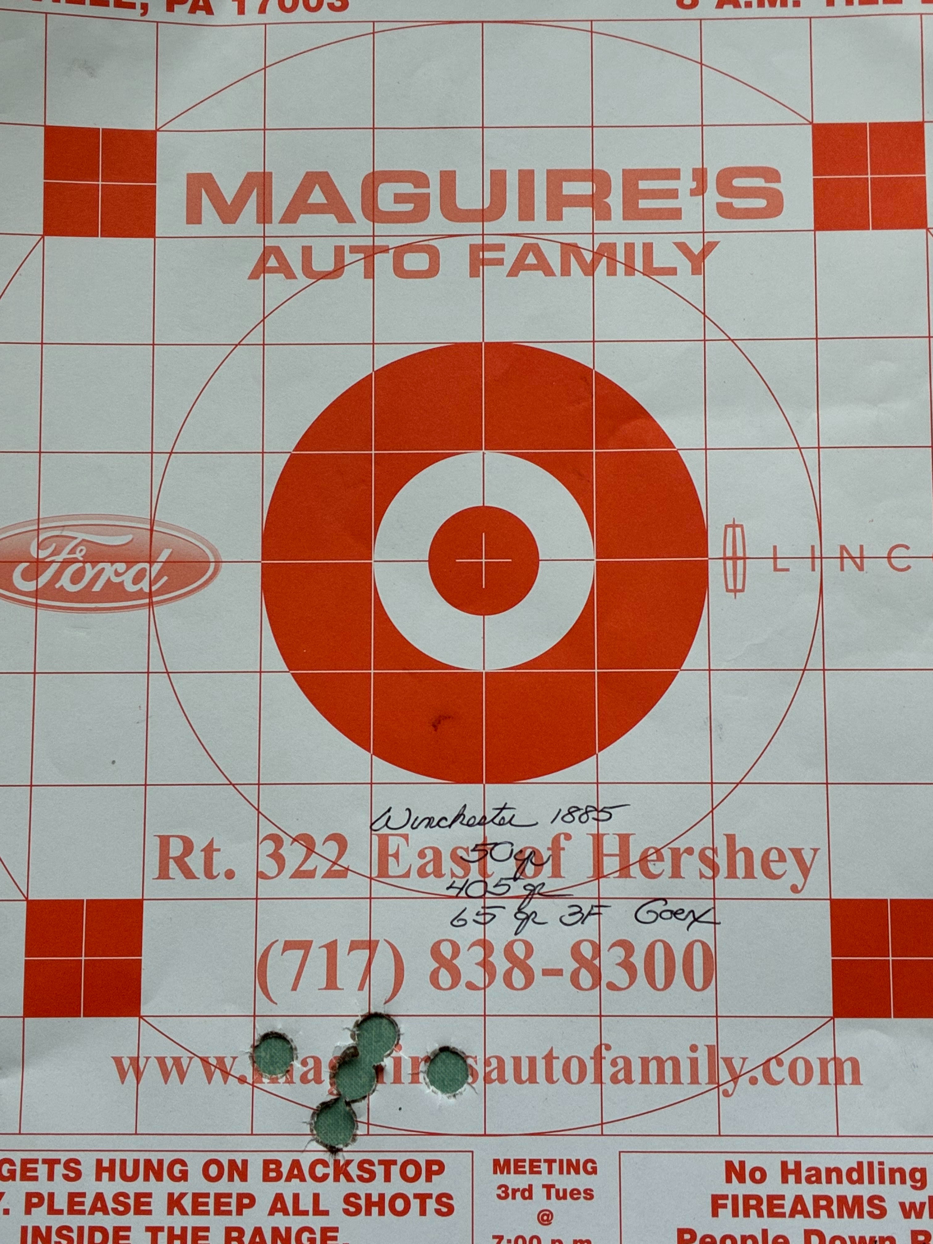

I finally made it to the range today to try out some of my BP loads for my 1885 Miroku Winchester. This load looks promising:
My cast 405 gr plain base gas-checked bullets, LBT white lube, over -power fiber card and 65 gr of Goex 3F powder. This target was from 50 yards with open sights. Obviously, I will need to adjust for elevation, but it looks promising.

Nice group.  Was this a compressed load?  Any idea of the speed?

Hi Chuck
It was a moderately compressed load. I didn’t take my chronograph with me today. This session was more about group size.
