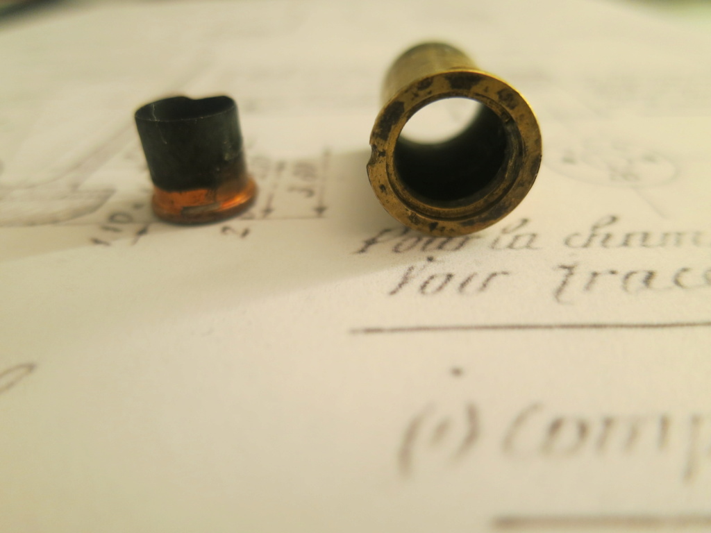

Are you using cartridges with a side mounted .22 starter cap?
How does the twin firing pin cope with hitting the rom on the opposite side?

Here is what they look like and you can see the impression on the non primer side of the fired case and it didn’t seem to be much different than the primer side.

I am using regular 22 blanks.  They look just like the pictures that 1873man, Bob shows.  The primer pocket has been brazed in then the new hole has been cut.  I’m using original Henry bullets I pulled from some old ammo that people have tried to shoot but only marked up the case.  RCC brass lists brand new ones for sale but I’ve tried for over a year to get some but no luck.

I am starting to investigate how to make the same kind of cartridges using 9mm Flobert blanks in central position (actually the round ball cartridges with the ball removed) in the hope they could be shot as a repeater (the brass would not need to be indexed in front of the firing pin)
I was wondering where the firing pins actually hit.
