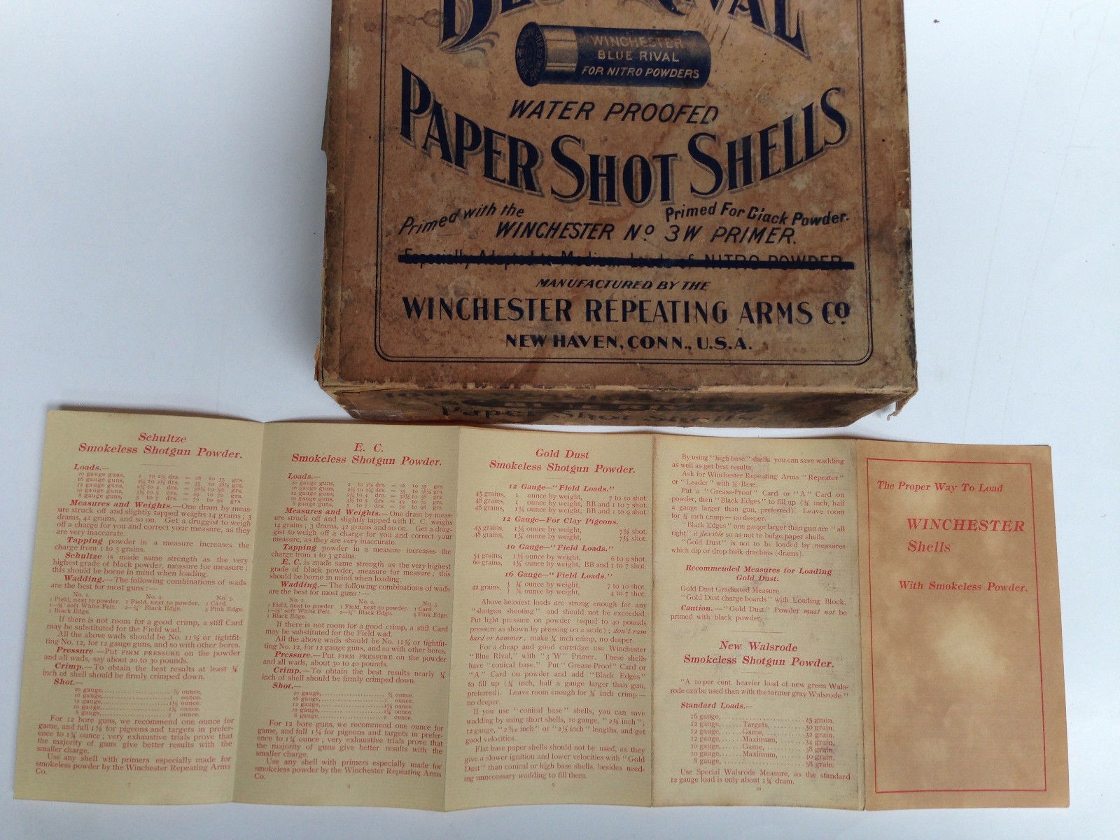

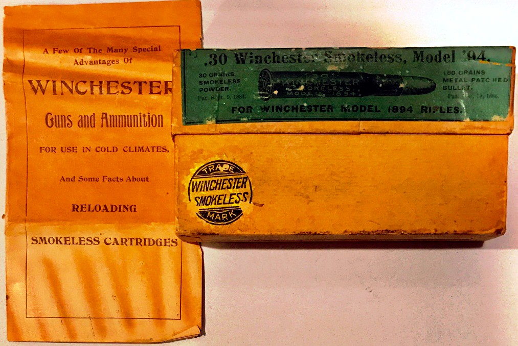

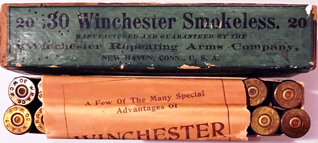

I went through my non Winchester loading catalogs and couldn’t find a thing. None of the Winchester Catalogs give an amount of smokeless powder.  They tell you almost everything else.  Including how much black powder.
For whatever reason WRACo intentionally did not include smokeless information in their catalogs. But produced pamphlets for reloading smokeless in rifle and pistol cartridges. They also had a separate pamphlet for reloading smokeless in shot shells. Both highly discourage reloading with smokeless and yet go onto and give the information for reloading with smokeless.
In addition to sometimes being included in Reloading Tool boxes the pamphlets were included in their ammunition boxes. This is an area I’m trying to do more research on and trying to figure out when this practice occurred. So far I’ve found information from 1897-1905, but have yet to find much information after 1905.
