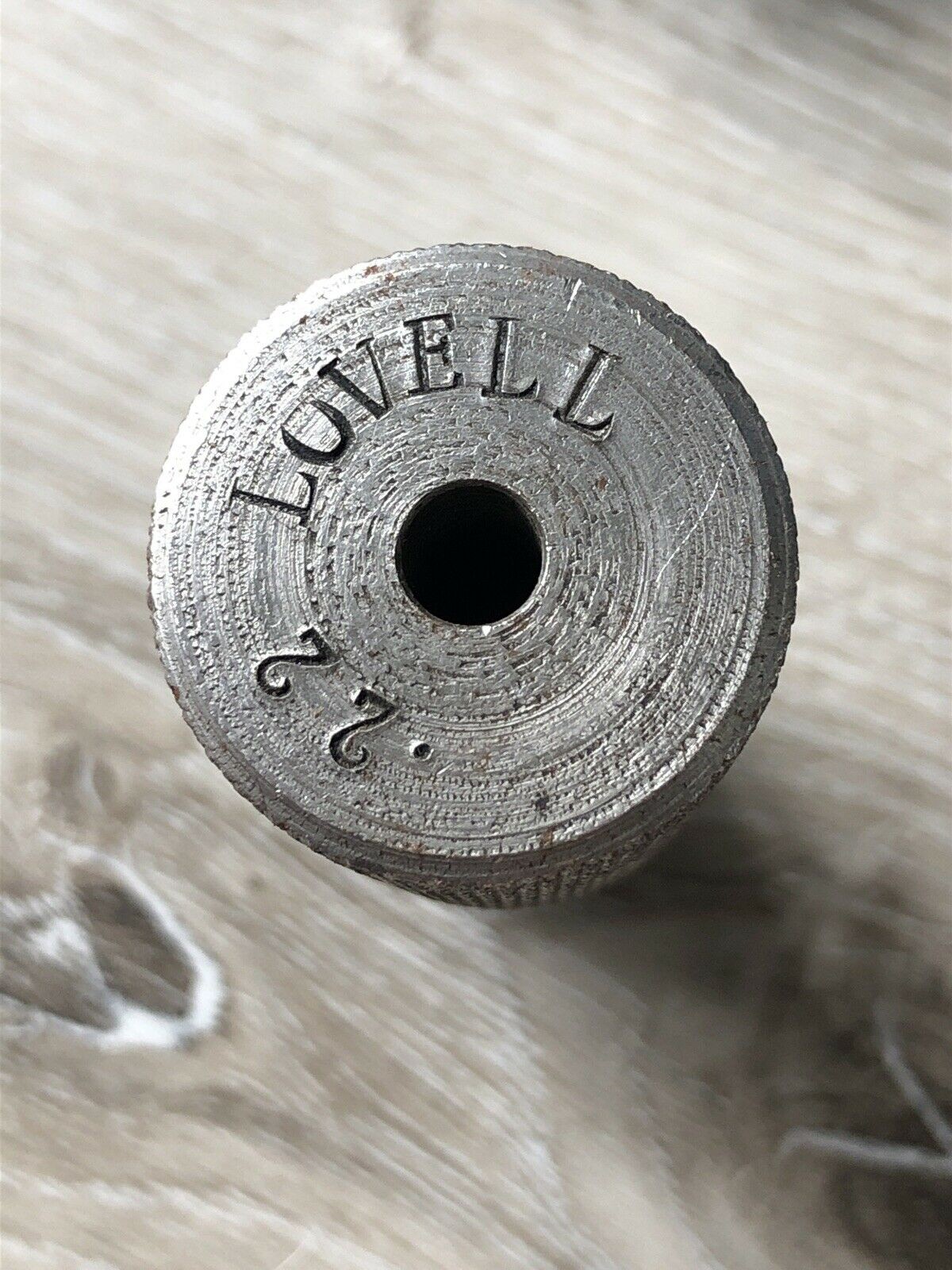

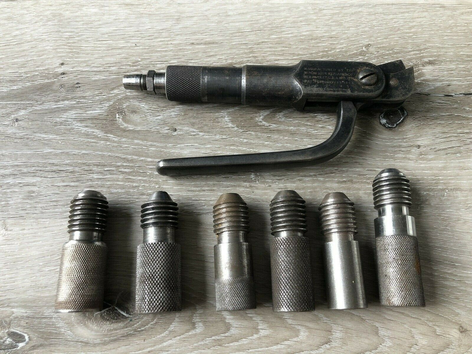

Here are some pictures of a 1894 Tool with a bunch of Faked or Homemade dies. One of which is in 405 WCF, 22 Lovell, 300 Savage and another in 219 Zipper, which Winchester never made.
Other than Winchester wanting to discourage the act of reloading with smokeless. The standard size 1894 Tool is basically too short to reload the 405 WCF. It is a rather long cartridge. The 1882 Tool with and adjustable die could have possibly worked, but Winchester never made it for any smokeless calibers.

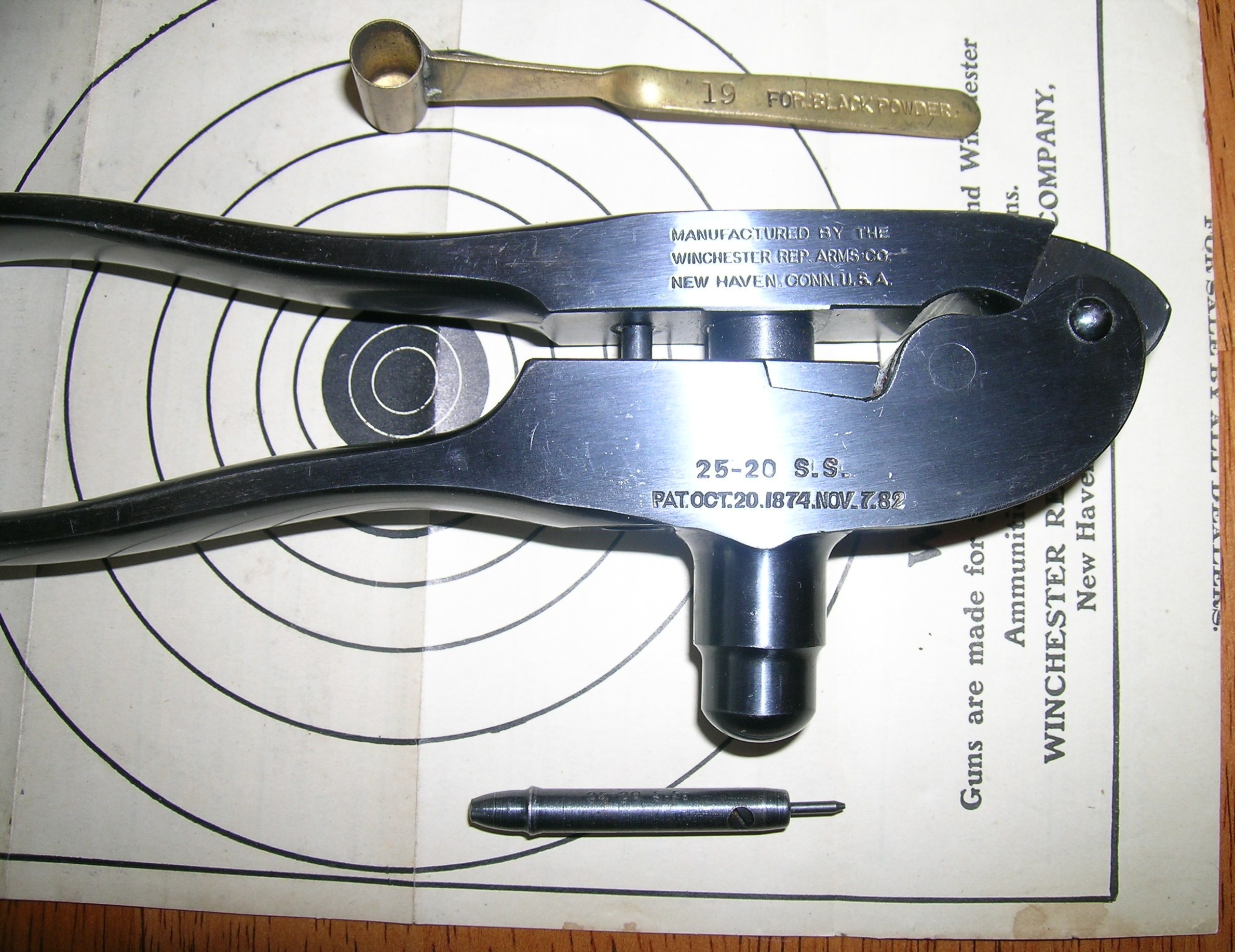

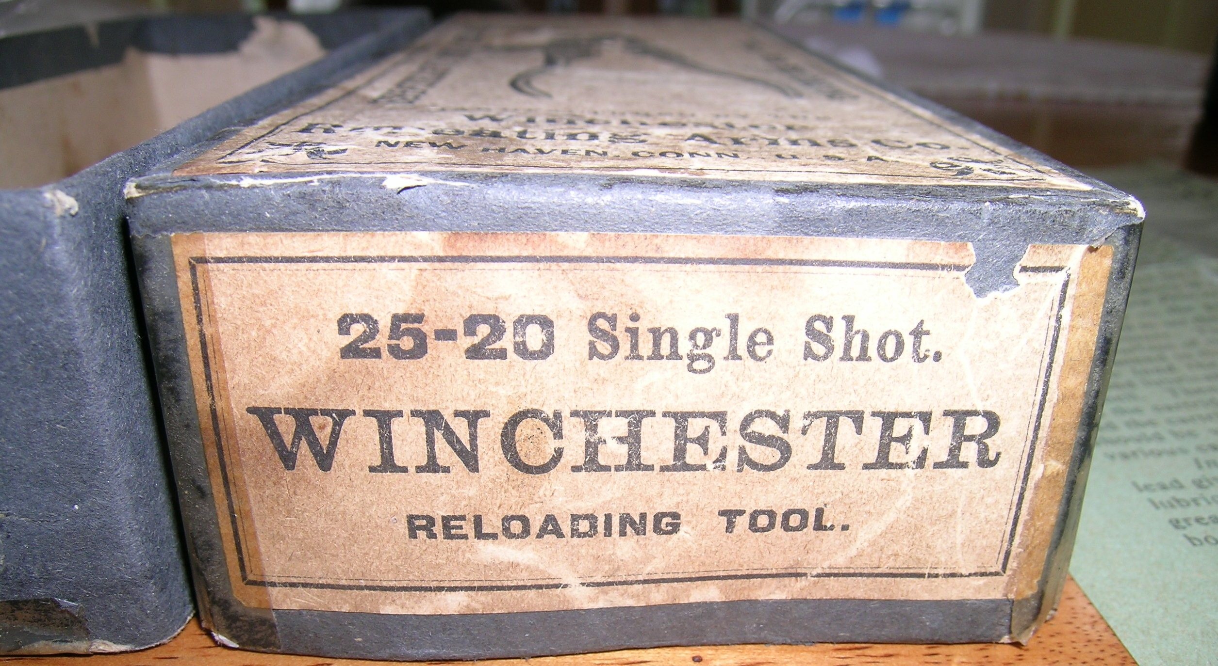

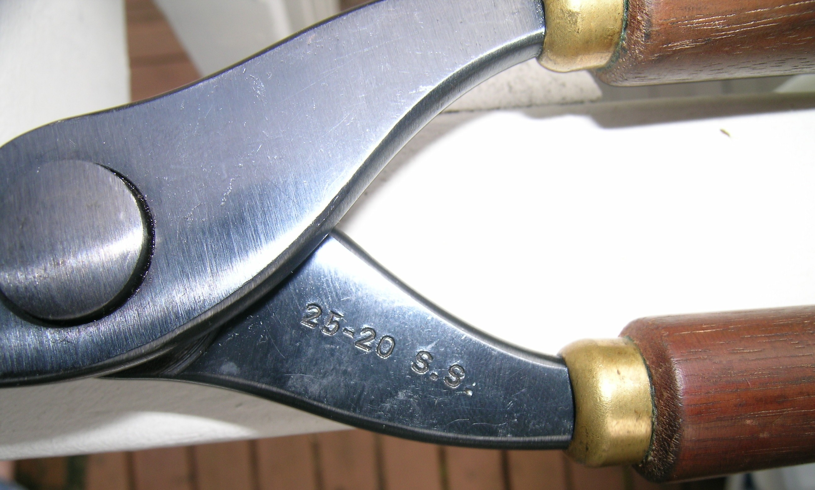

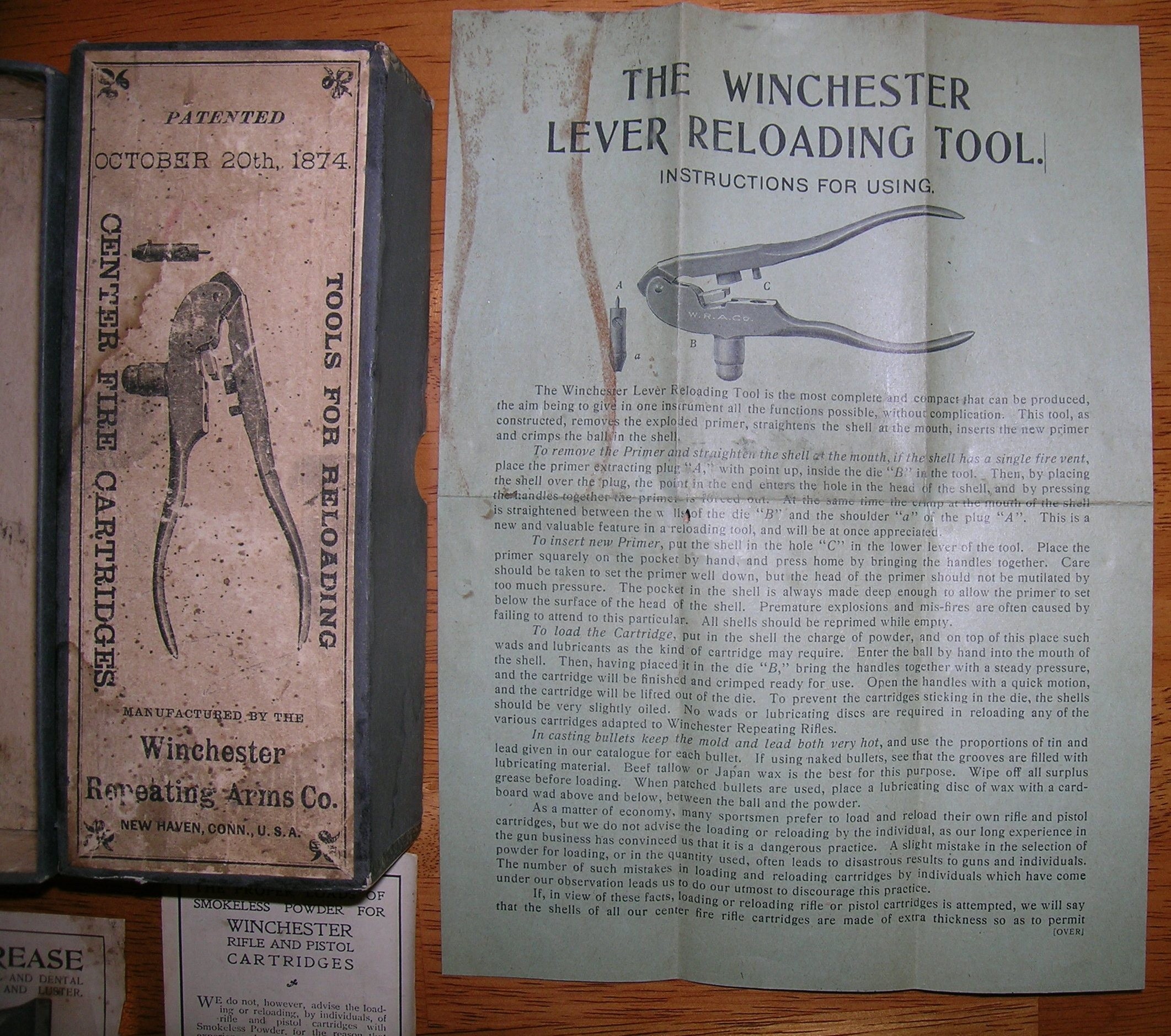

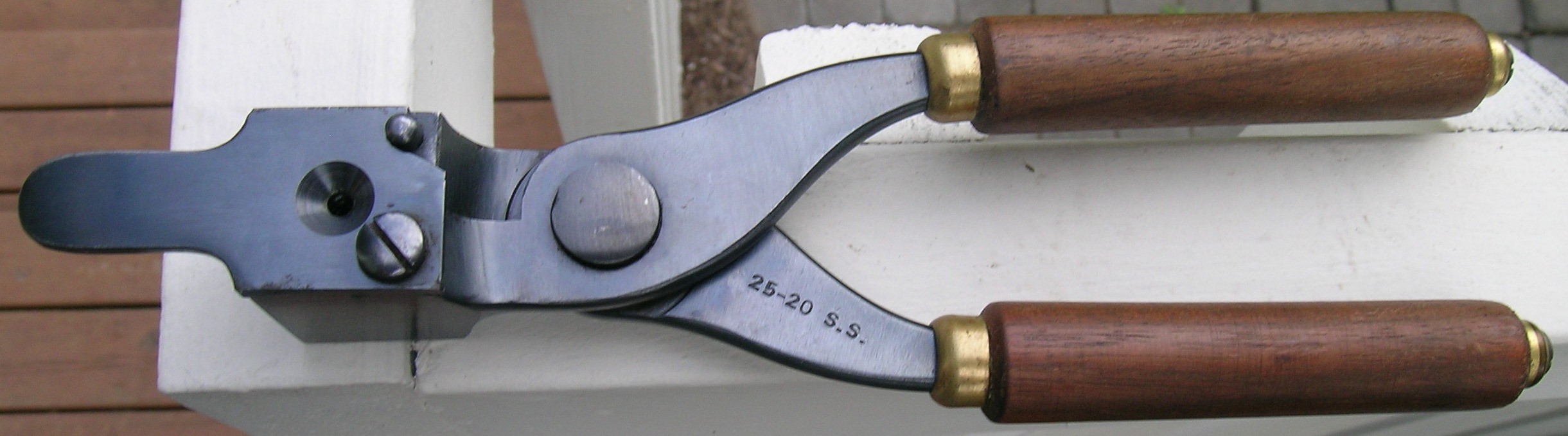

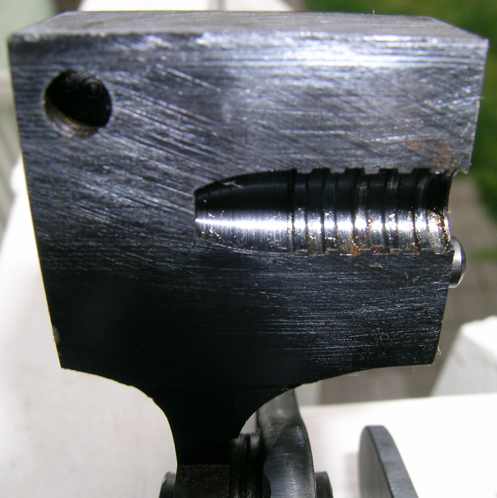

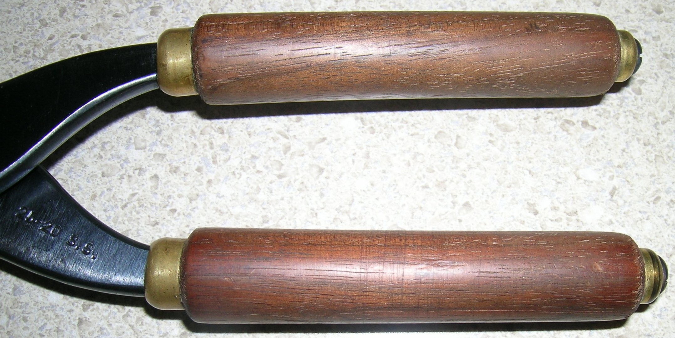

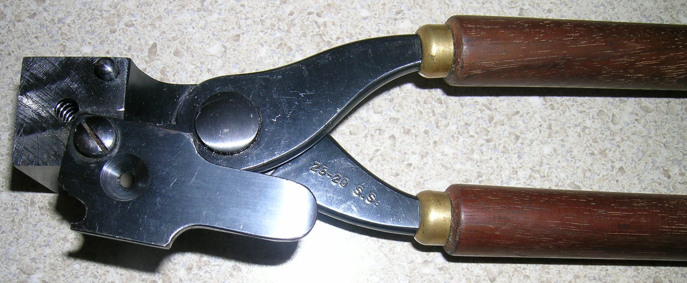

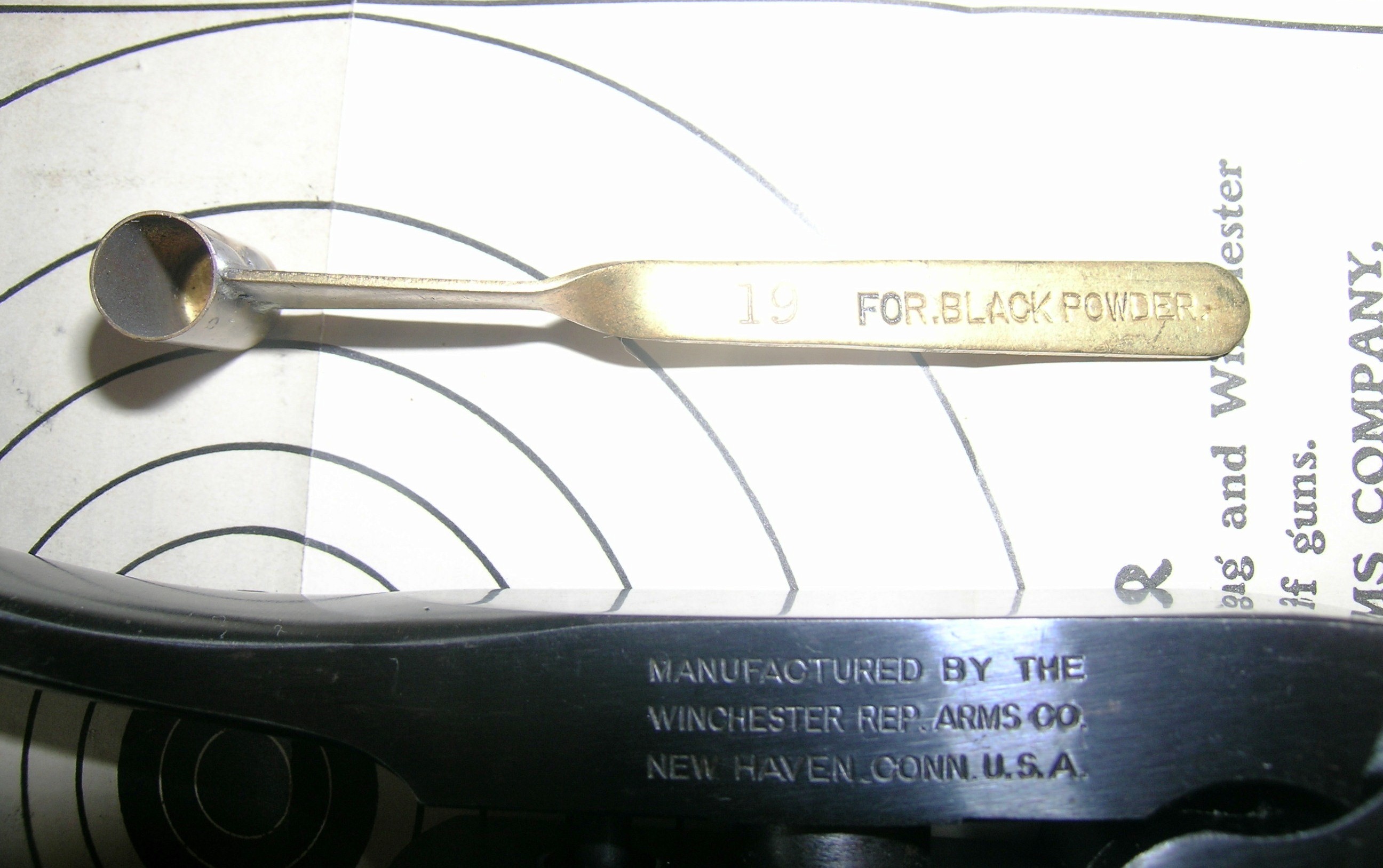

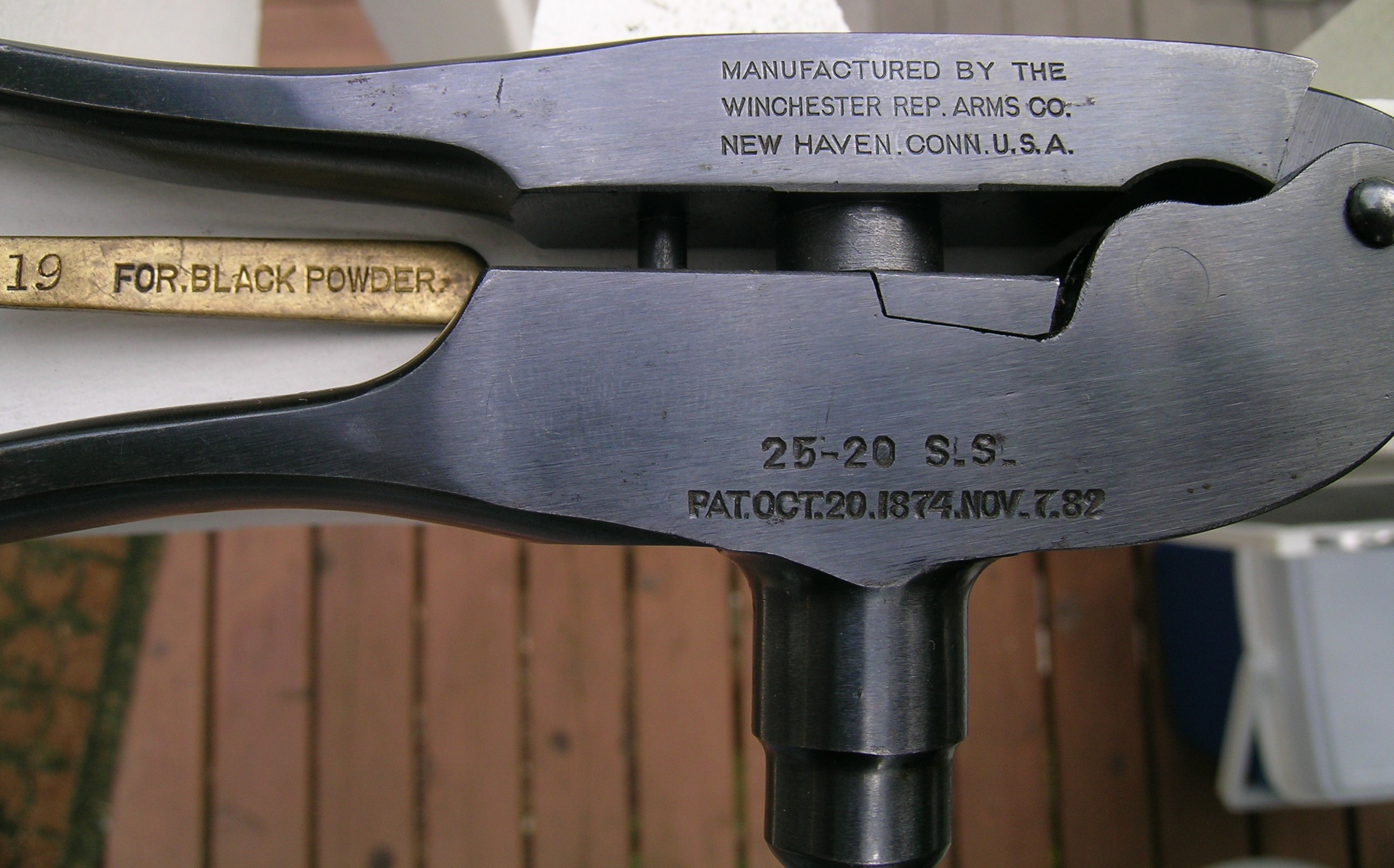

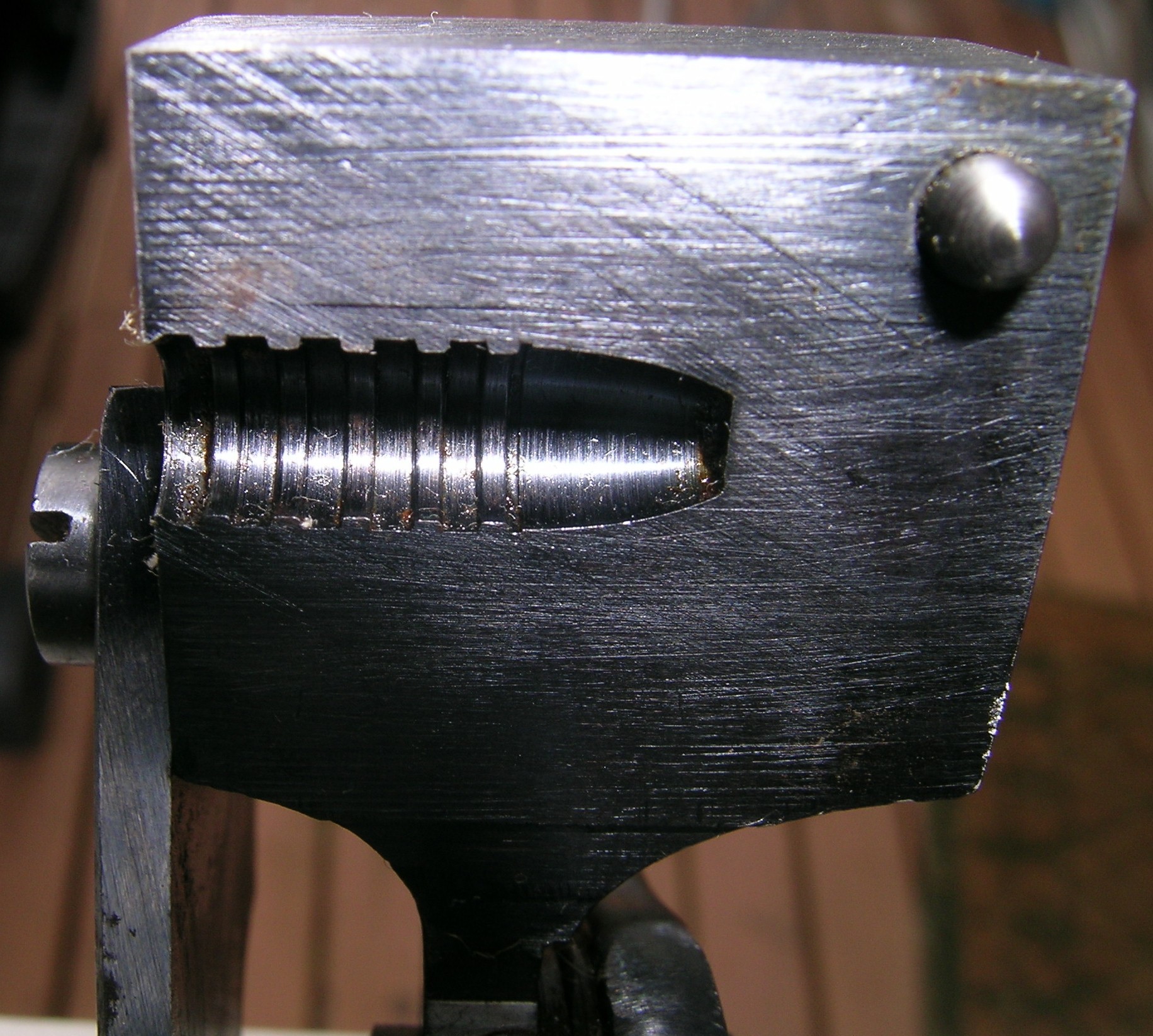

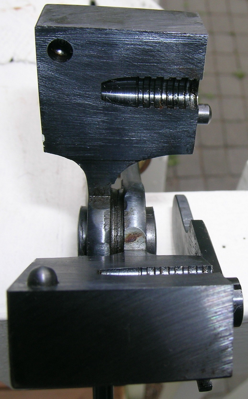

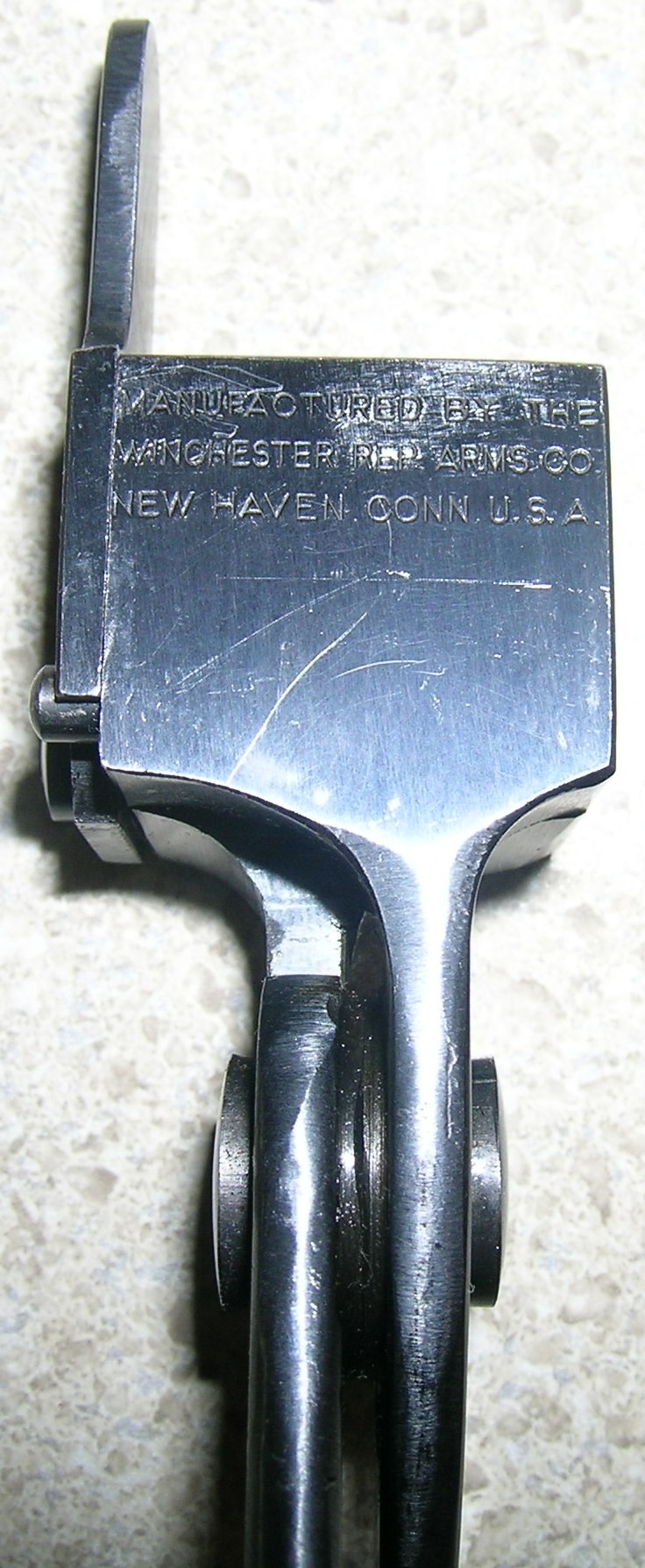

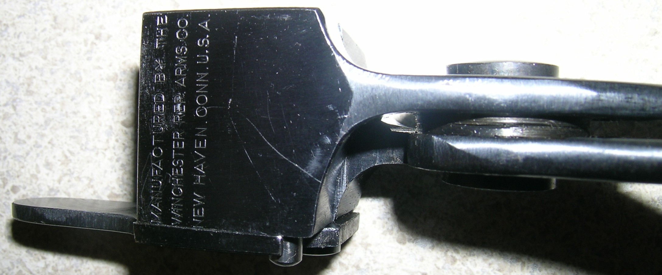

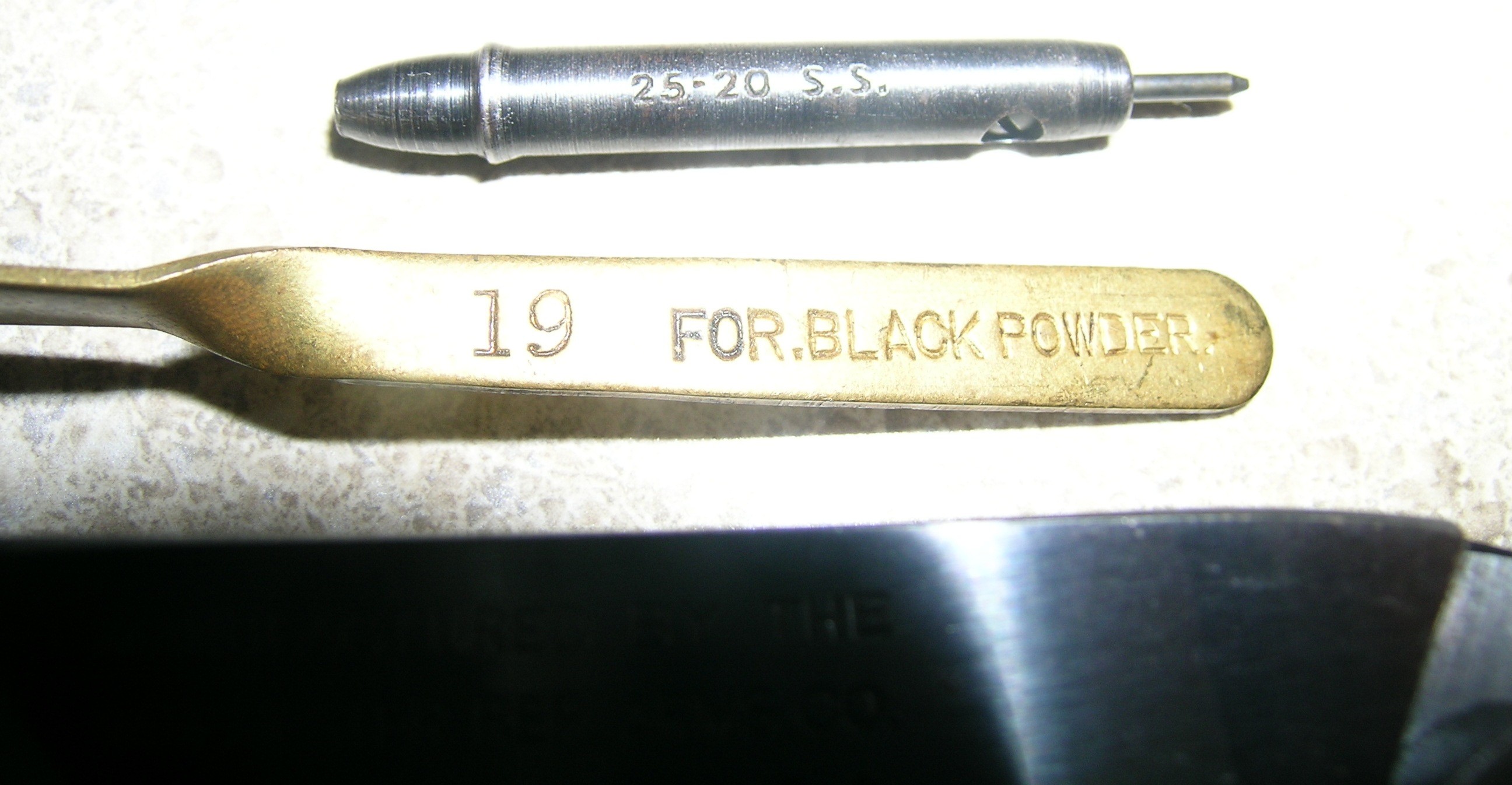

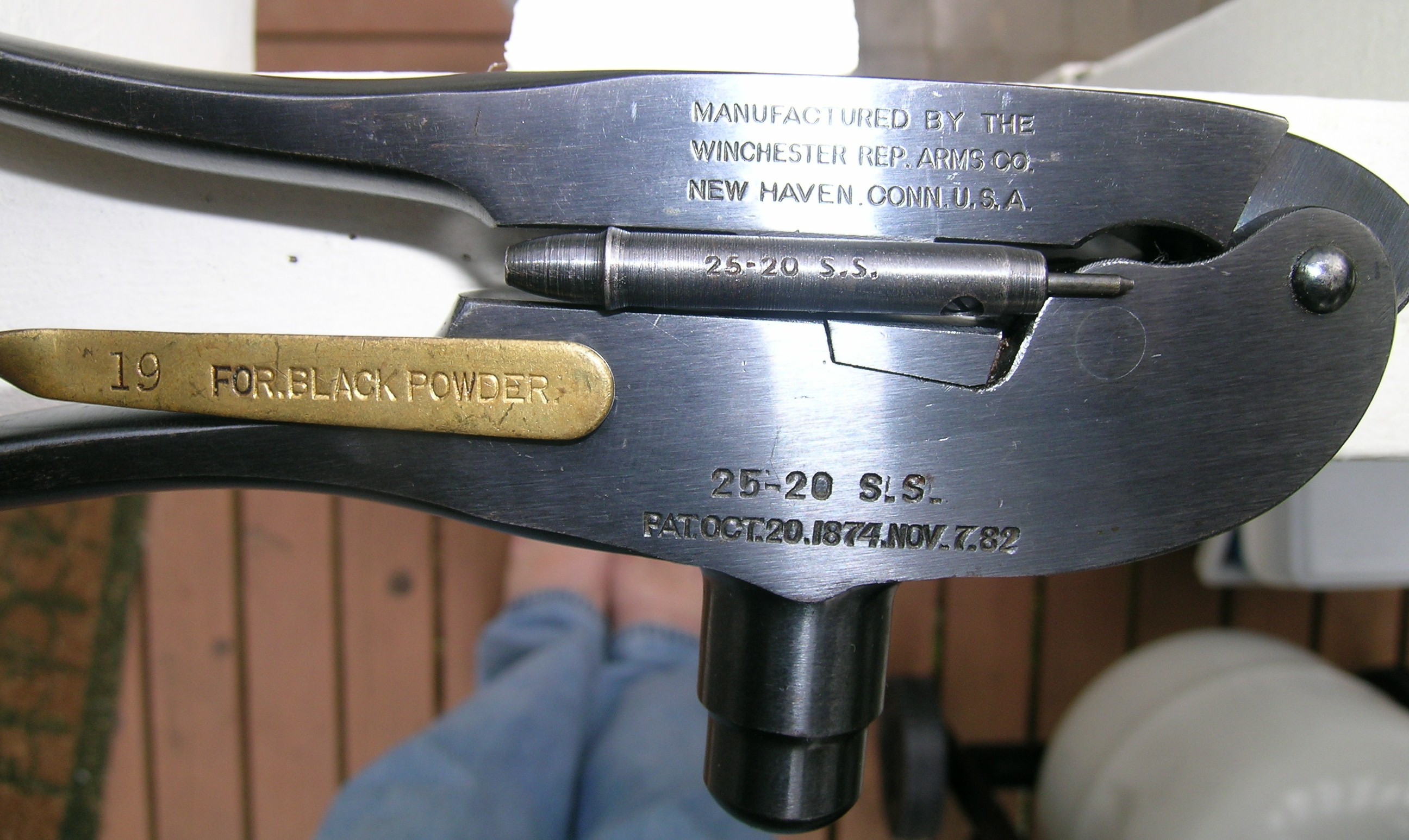

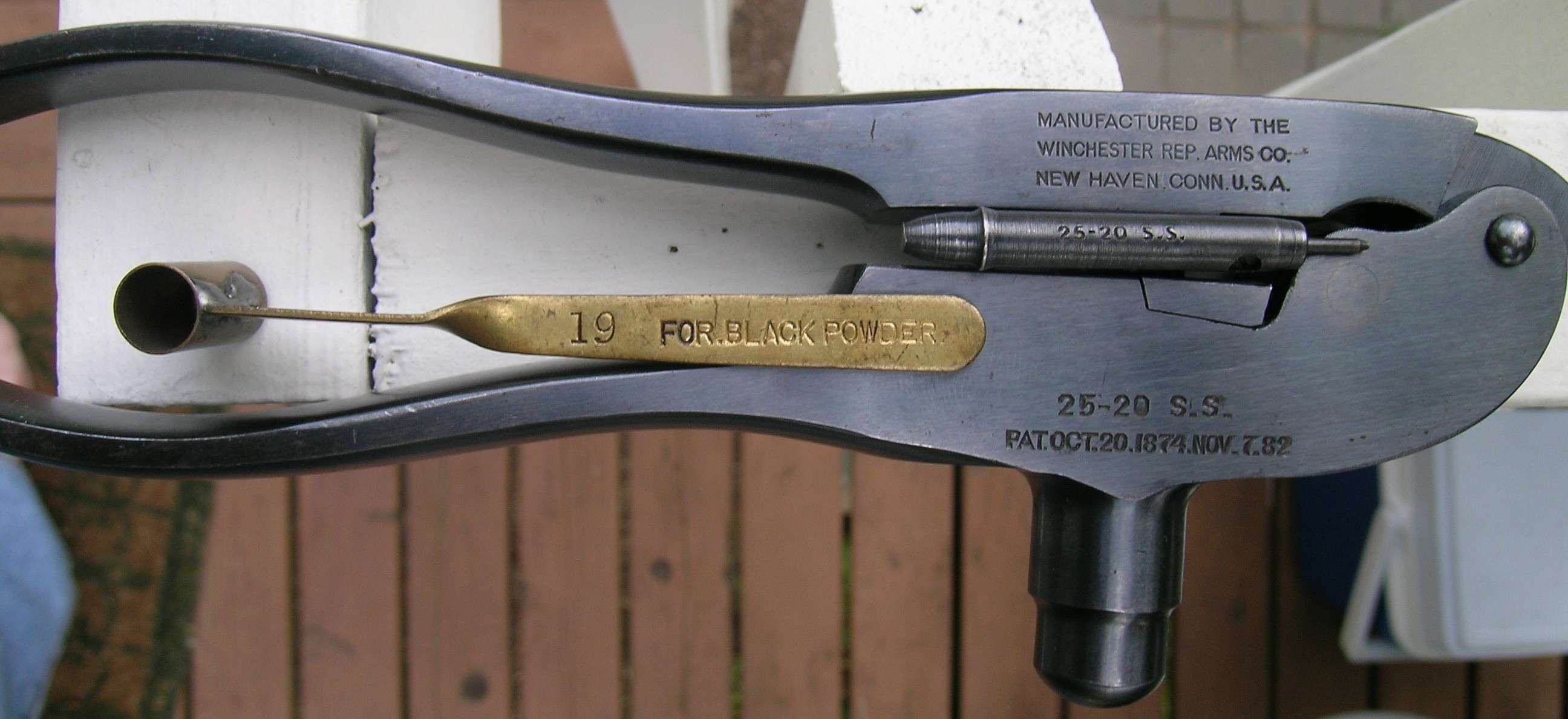

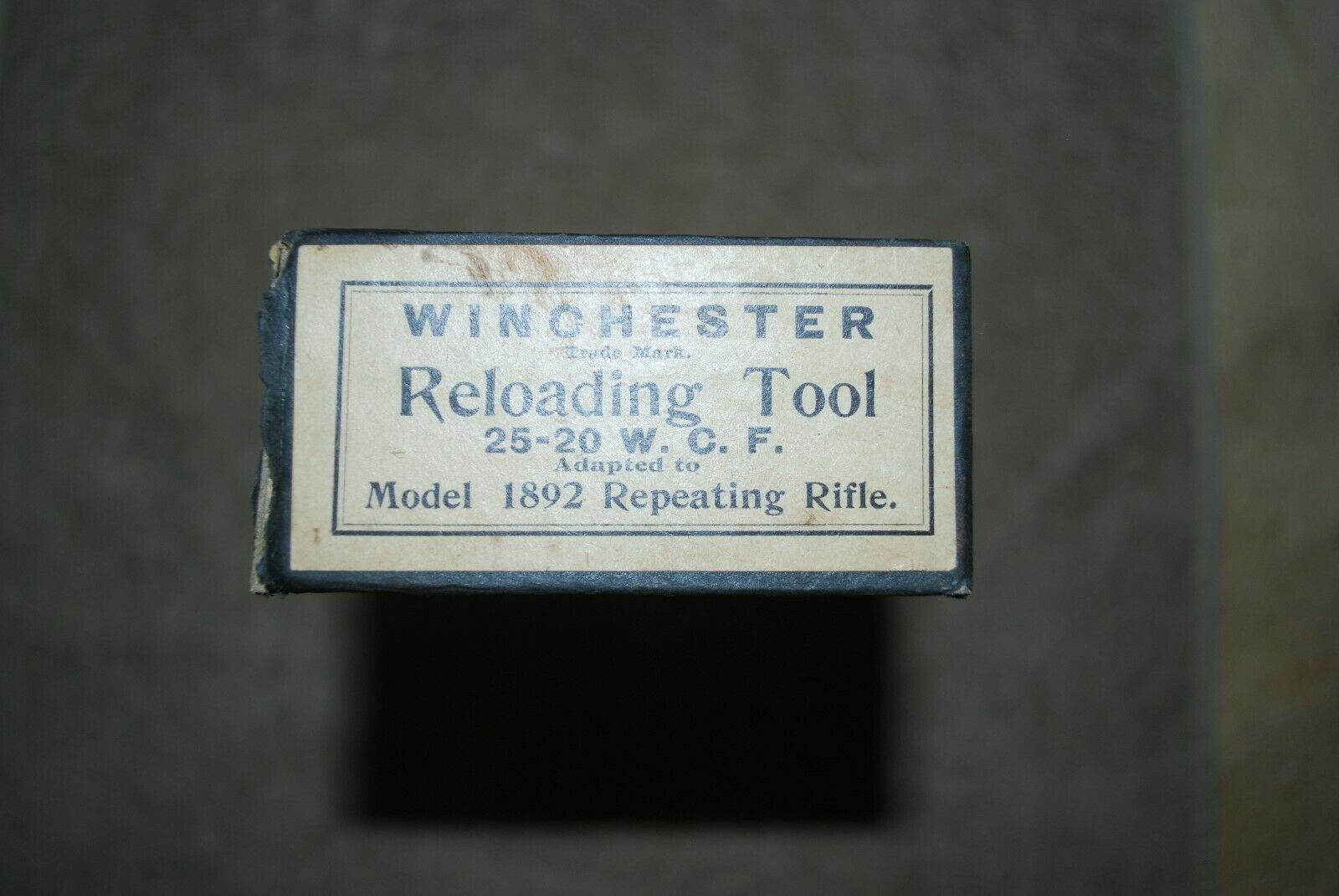

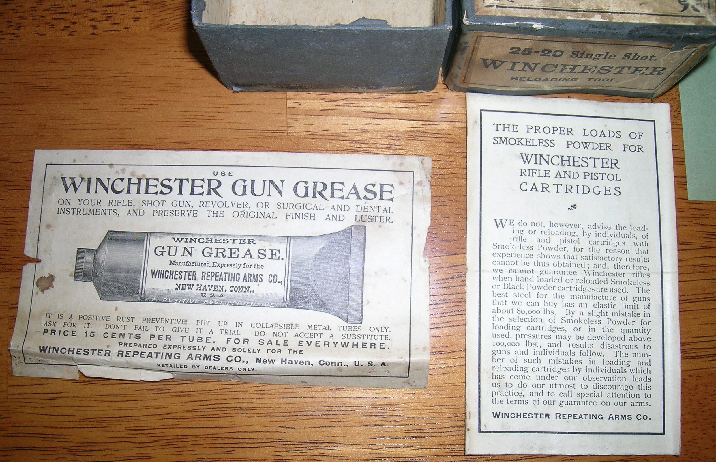

I have in my collection an almost NIB Winchester reloading tool (for the 25-20 S.S.). The box contains the reloading tool w/decapping pin, the powder measure (for black powder), the bullet mold, (3) .22 caliber targets, advertisement for Winchester grease, and the reloading information for both Black powder and Smokeless powder.
Pictures…
Box-end-view.jpgBox-top-view.jpgBullet-mold-address-stamp.jpgBullet-mold-address-stamp-3.jpgBullet-mold-caliber-stamp-1.jpgBullet-mold-cavities.jpgBullet-mold-cavity-left.jpgBullet-mold-cavity-right.jpgBullet-mold-tool-handles.jpgBullet-mold-1.jpgBullet-mold-3.jpgDecapping-pin-and-Powder-Measure-2.jpgGrease-and-Smokeless-loads.jpgInstruction-sheet-pg-1.jpgInstruction-sheet-pg-2.jpgPowder-measure.jpgReloading-tool-decap-pin-and-powder-meas-1.jpgReloading-tool-decap-pin-and-powder-meas-3-019.jpgReloading-Tool-1.jpgReloading-Tool-6.jpgSmokeless-powder-load-data-sheet-1.jpgSmokeless-powder-load-data-sheet-2.jpgTarget-front-and-back-side-.jpg

 Thank-you Chuck,Marv and Bert for your comments and pictures.
Pictures…

You’ll notice that the “Proper Loads of Smokeless Powder For Winchester Rifle and Pistol Cartridges” is its own separate pamphlet and the information was intentionally not put on the instruction sheet or in catalogs. These pamphlets were included in the boxed reloading tools and also inside ammunition boxes during certain years of production. I have found different variations of these pamphlets from 1898 to 1905. I have yet to locate one dated after 1905, they may exist but hadn’t found one yet. They also made a separate pamphlet(s) that discusses loading shot shells with smokeless powders.
Chuck said  I have no idea if smokeless problems influenced the loading tools?
Very much so, along with dealing with lawsuits from injured or killed customers that mistakenly / wrongfully reloaded ammunition with smokeless powders. Winchester slowly began discouraging reloading with smokeless and over time more so. Ultimately until getting out of the reloading business.
For their smokeless cartridges they even began not including powder measures with their tools to discourage reloading smokeless.
17.jpgThis notice is from a 1911-1913 dated era tool. Statements were put on box end labels and warnings were placed on hang tags on rifles.3.jpg2.jpg
They had developed these and other various forms of ad campaigns discouraging reloading with smokeless up until the 1916 Catalog #80 which removes all information, prices, pictures, or any data pertaining to loading tools or bullet molds. They do continue to sell primers, primed and empty cases and bullets. And the catalog goes on to state “Winchester Repeating Arms Co., cautions its patrons against loading or reloading smokeless powder rifle ammunition, and wishes to do its utmost to discourage this practice.”

The instruction sheet in my 25-20 S.S. reloading tool box is dated 9-4-15, and all of the other documents (including the Smokeless Powder load information) are original to the box.  I will dig it out to see of the Smokeless load sheet has a date on it.

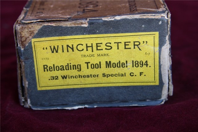

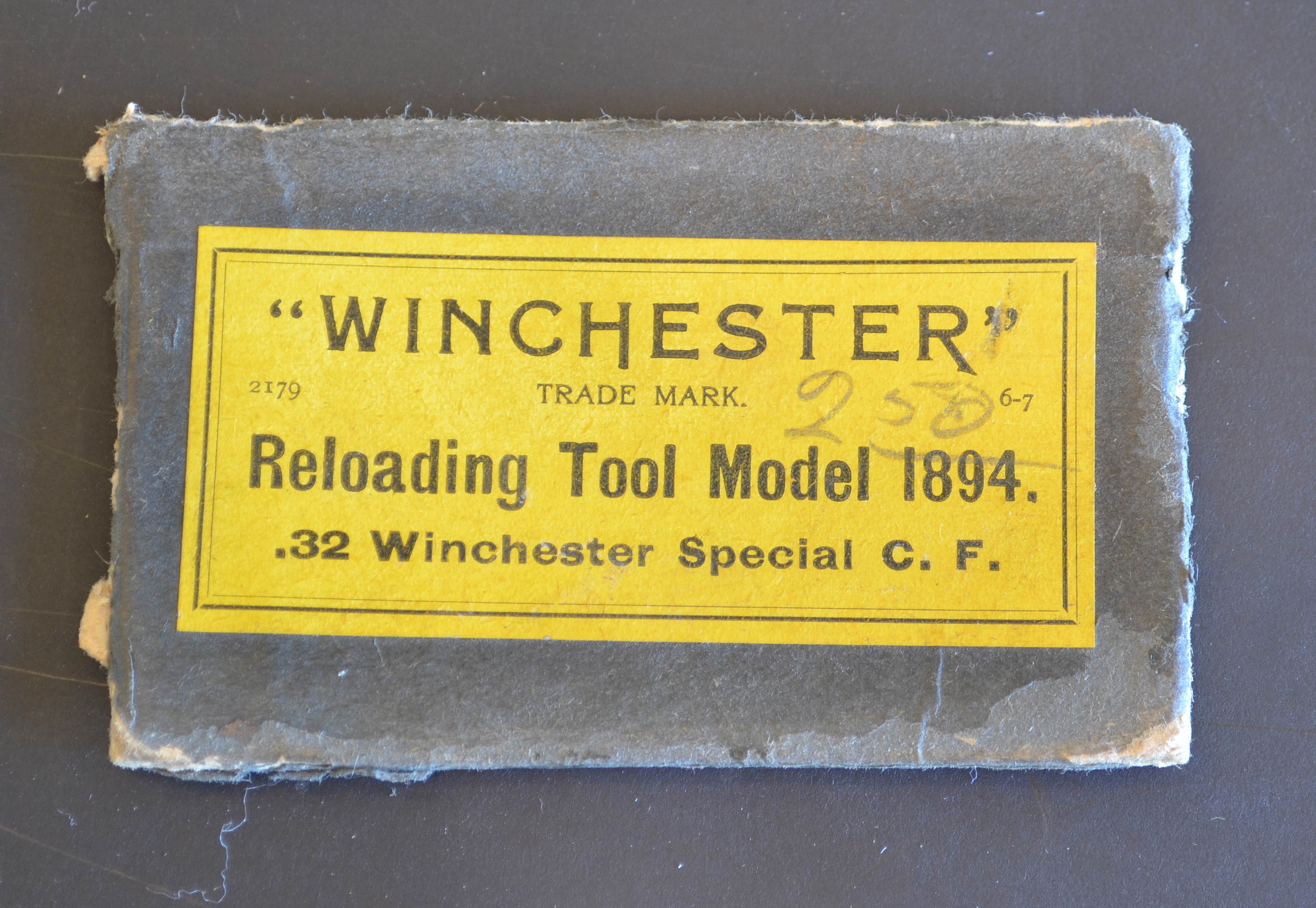

The tools in .32 S.L., 35 S.L., .401 S.L. and 33 WCF were all apparently special order. To the best of my knowledge no bullet molds were available or ever made. These non-cataloged calibers were not for “short range” cartridges, at least not the self-loaders as that would cause jamming issues. These tools would have been intended loading using primed empty cases and pre-cast factory made bullets. Not with bullets cast from your own mold.

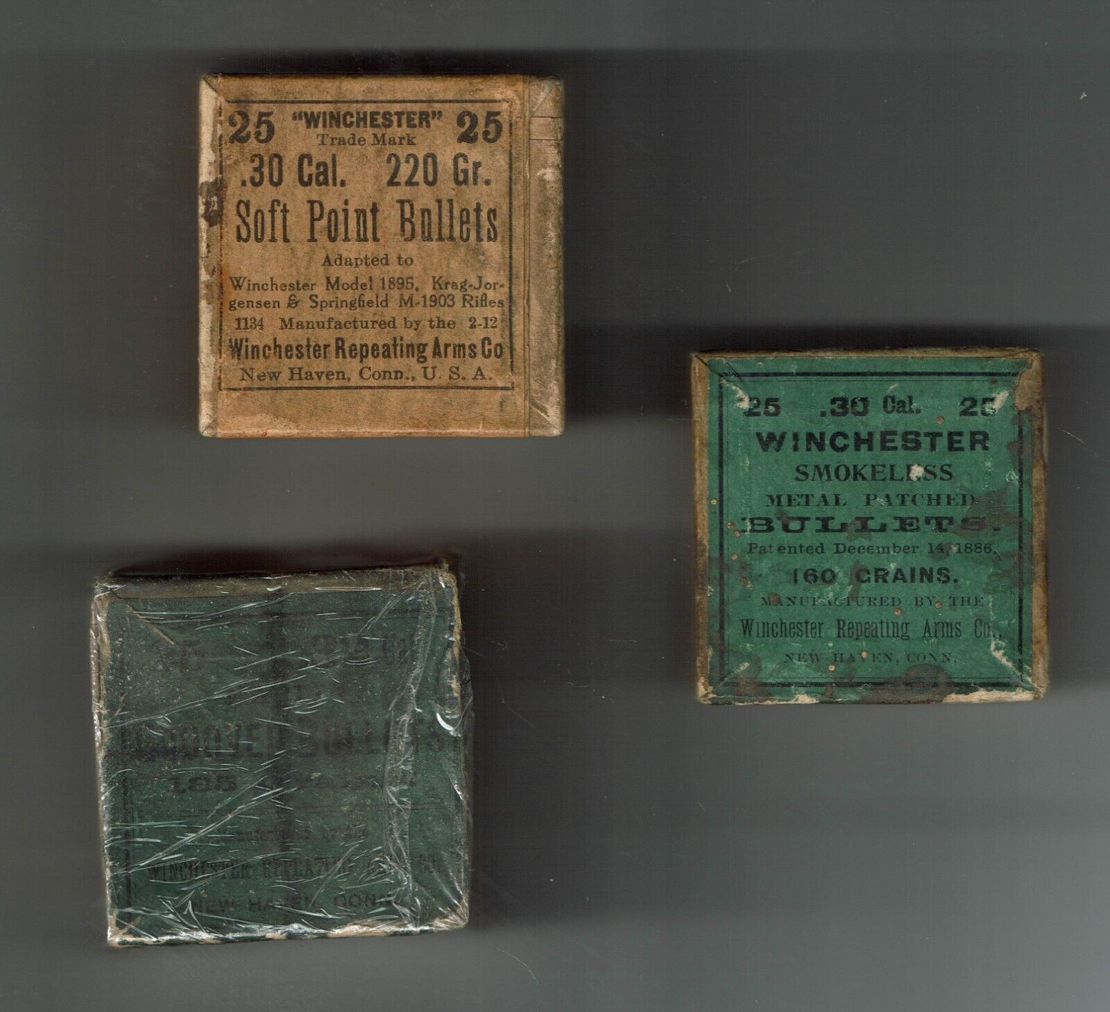

In the Bullet Mold, only Short Range molds were sold for the 25-35 WCF, 30 WCF and 30 Gov. This just has to do with just the molds. But Winchester also sold factory made grooved bullets of lead and/or jacketed bullets for loading smokeless cartridges. Often sold packaged in a box of 25 bullets per box.
1-1.jpg5.JPG32WS170grsSoftPoint.jpgWhich in my mind was certainly mixed messaging for a number of years on their part. We “Winchester” state that we discourage you from Reloading with Smokeless. But we will sell you the primers, brass, powder, and bullets along with giving you a pamphlet on how to do so. Which is why ultimately, among other reasons, why they got out of the reloading tool business.

The instruction sheet in my 25-20 S.S. reloading tool box is dated 9-4-15, and all of the other documents (including the Smokeless Powder load information) that are original to the box.  I will dig it out to see of the Smokeless load sheet has a date on it.
The instruction sheet is dated “9-4-15M”, which I believe is a printers code to mean September-1904-15,000 copies.
If I recall correctly the Smokeless pamphlet on the back side bottom corner has a printers code of “1-3”, which I believe to mean January 1903.
The Do You Want A Gun? AD Insert dates to 1902, as the last model shown at the bottom is the Model 1902 Single Shot Bolt 22.

The next version box after yours includes the words Trade Mark on it. Both on the top label and end label. In use 1902-1906.
By 1906 Winchester is in quotes, “Winchester”.
By 1910 the Big Red W was in use on box labels.
These changes in labeling are very similar to cartridge box labels.
Your box specifically dates from sometime 1904-1905, due to its contents. The box itself is an earlier box likely made before 1902, before the use of the phrase Trade Mark. Likely the box sat around a couple of years before being packaged up at the factory and sold. I’ve seen boxes with older top labels and new end labels. This same sort of thing is found with cartridge boxes.
