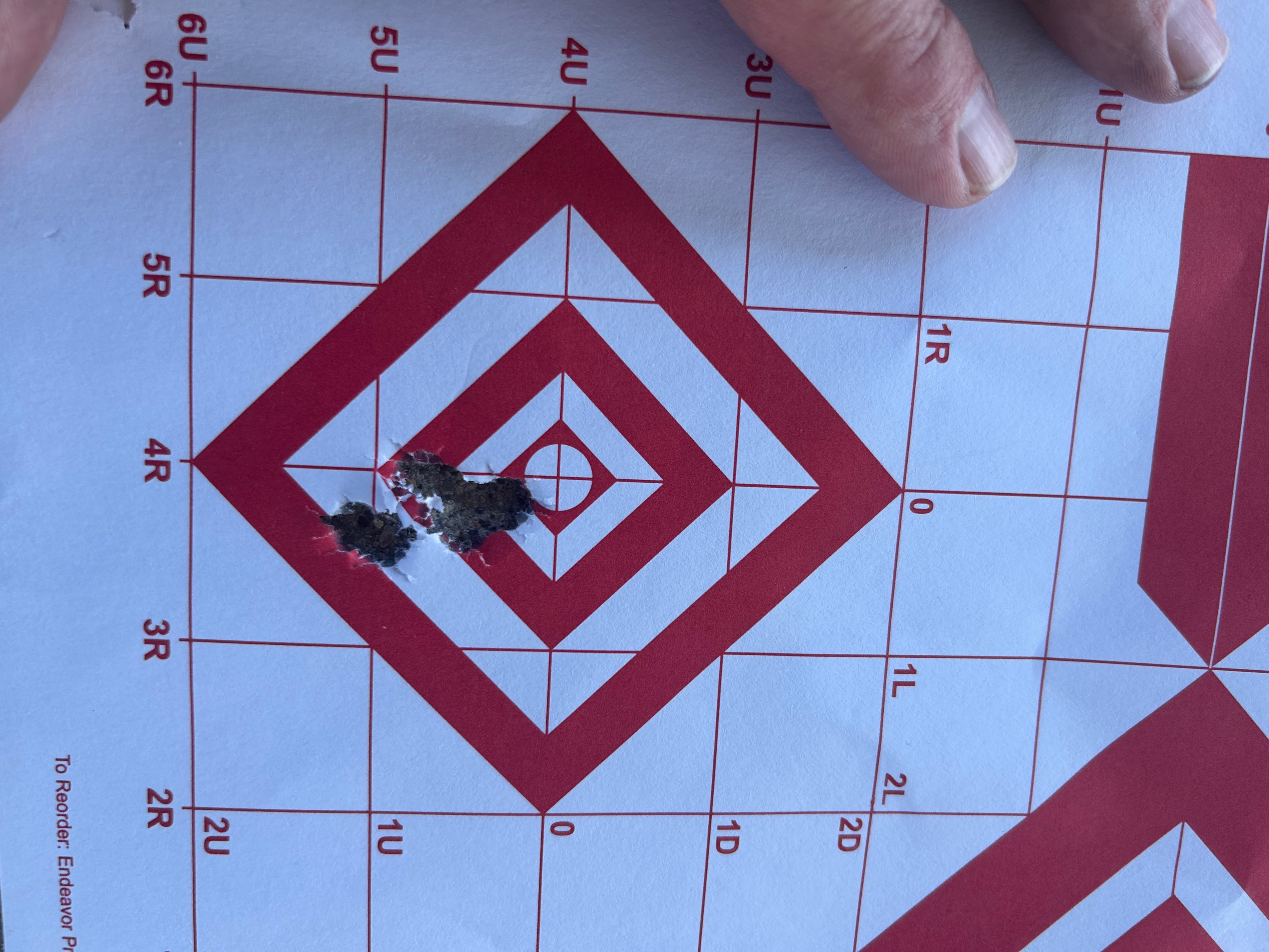

Time to put this project to bed. I’ve discovered the bore needs 5-6 fouling shots but have found a load it likes. Pretty sure it’s an old stock Hornady 165 spire point (found them in a bag in a loading bench cubbyhole) and 55grs IMR4350. Seems I took the long way around the barn, my hunting load is the new version of that bullet over the same charge of H4350. The “bargain” factory second bullets proved the factory QC folks knew what they were doing when they rejected this batch of bullets. They’ll make good foulers. Seems El Diablito Rojo is probably as good a shooter as his older sister was. I suppose that shouldn’t be a surprise either. I could maybe shave as much as another tenth of an inch off the group size with a better scope, some minor tweaking and probably a better shooter. I just wanted to see what I could do with a bargain rack Winchester hunting rifle using an inexpensive scope, cheap bullets and a powder I happened to have a surplus of. Any excuse for trigger (and loading bench) time!

Mike, that’s a very good group for that rifle. In my opinion you are done. Laugh

It also speaks very well.for the action design, itself.
If you want to see what the rifle can do in the best case, find a box of that Winchester Palma Match and fire 4 @ 5-shot groups. I don’t know if it is still loaded with mercuric primers or not but the box will surely be marked. It is said to be the most accurate 30/06 ammunition ever made.
I would bet the accuracy would be eye-popping. I’ve seen what the .308 version can do for a National Match M14.
