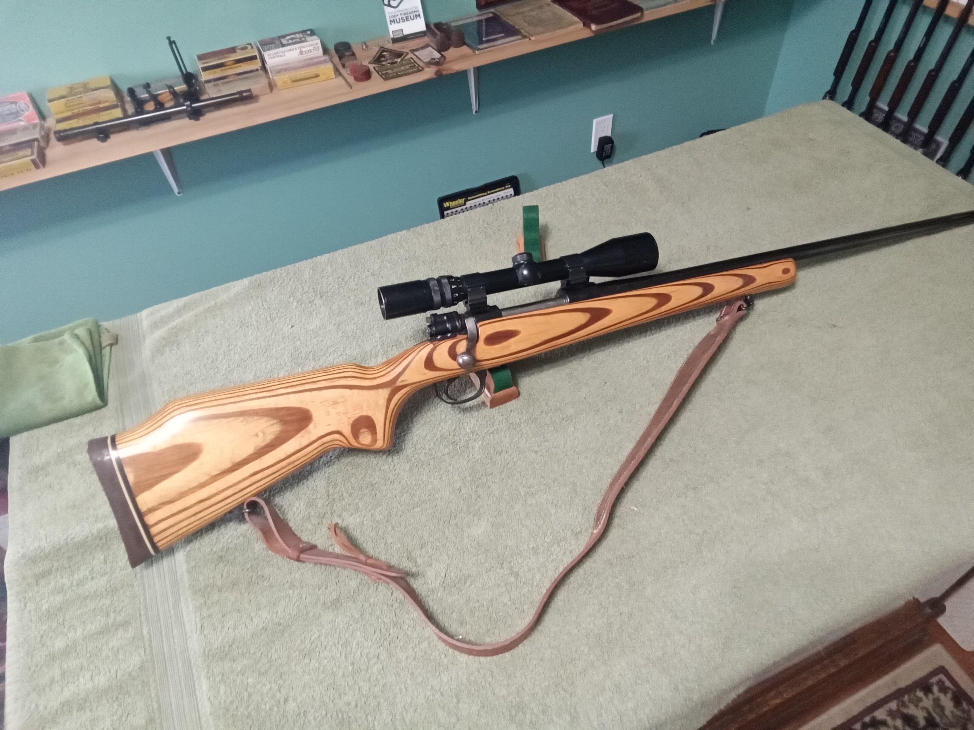

Well this is a custom I’ve had for many years. My youngest brother was in a car crash when He was 19 which left Him a parapalegic. He had got a special license to shoot varmints from the sholder of the road while remaining in the vehicle. He had this gun built for Him, in 1970, by Ellwood Epps , a well known local shop and gun smith,at the time. Sadly Vern, one of My hero’s, passed away in 1982. I kept the rifle and have used it on occasion. It is a Mauser action in 6mm Rem. and from a (car window), rest, is lethal for a ground hog at 400 yards. I hope to someday give it to one of His grand kids.  20260101_124340.jpg20260101_124431.jpg20260101_124445.jpg
Very nice, Harry. Not too many gunsmiths using laminated stocks back then, good to see an old school ‘smith making it work. I always thought laminated wood made a rifle too heavy but in your brother’s case it didn’t make much difference.

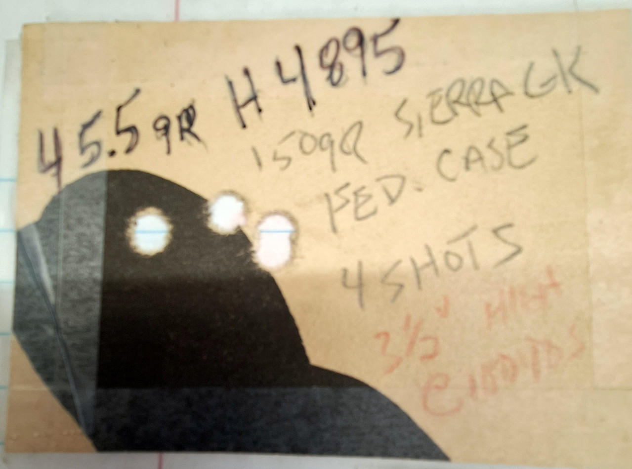

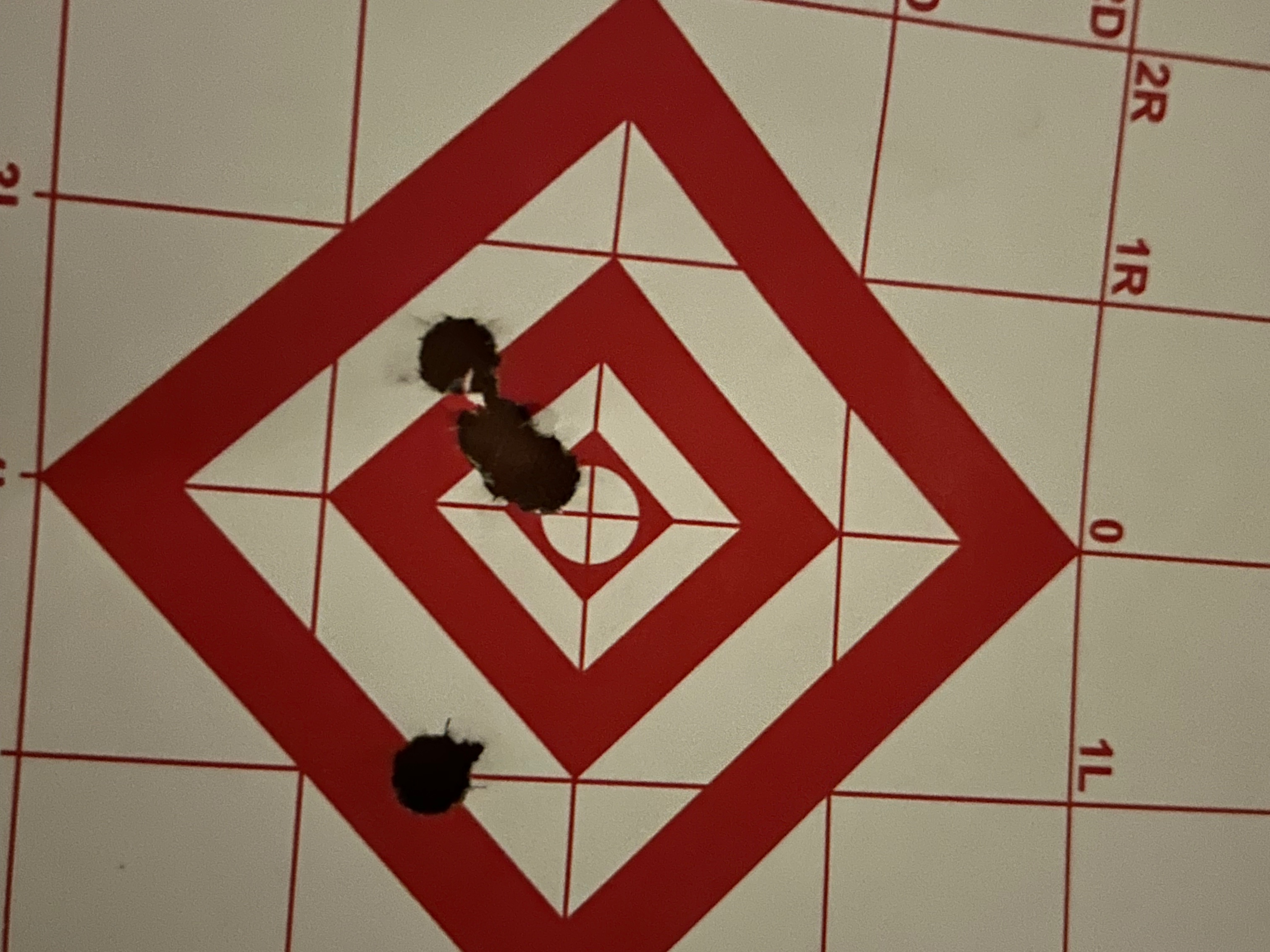

First range trip was quite enlightening if not a bit anticlimactic. Scope doesn’t adjust well (Redfield Revolution) but I finally herded those wandering crosshairs to a useful location. First five shot group was pretty good until the loose nut behind the butt had his way. I think I need to work on that before doing any more load development. This is what I call load #53, I assign all unique component combinations a load number, any variation in powder charge or seating depth is denoted by a letter suffix. Since this is a new bullet for me it’s a new load. Seems I SWAG’d pretty close, will need to work a little harder on my trigger control and follow through!
(errant shot is actually to the right of the group.)

Nice group! Cool

Thanks, Bert. Sierra manual listed 54.5gr of IMR 4350 for 2700fps and the Hodgdon site listed 54.0 IMR 4350 for 2720 so after perusing my other manuals and load records I figured 54.5grs would be a good place to start. Gonna need to up my game to do any load development!
With a group like that, I would call it a day on the “load development” efforts.  I have never been able to get my old Winchester Model 54 to shoot better than 1 MOA, and most times it is 1.5 MOA.
I must admit I was looking forward to a load development adventure, it seems I’ll be better off focusing on shooter development. That was one of the goals of this project. I think I’ll order a couple hundred more of those bullets and follow your advice. Most days I’m not an MOA shooter, as far as the gun goes it seems my work here is done. I’ll load up some more of this load and have some fun!

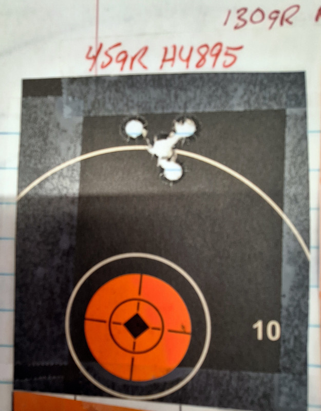

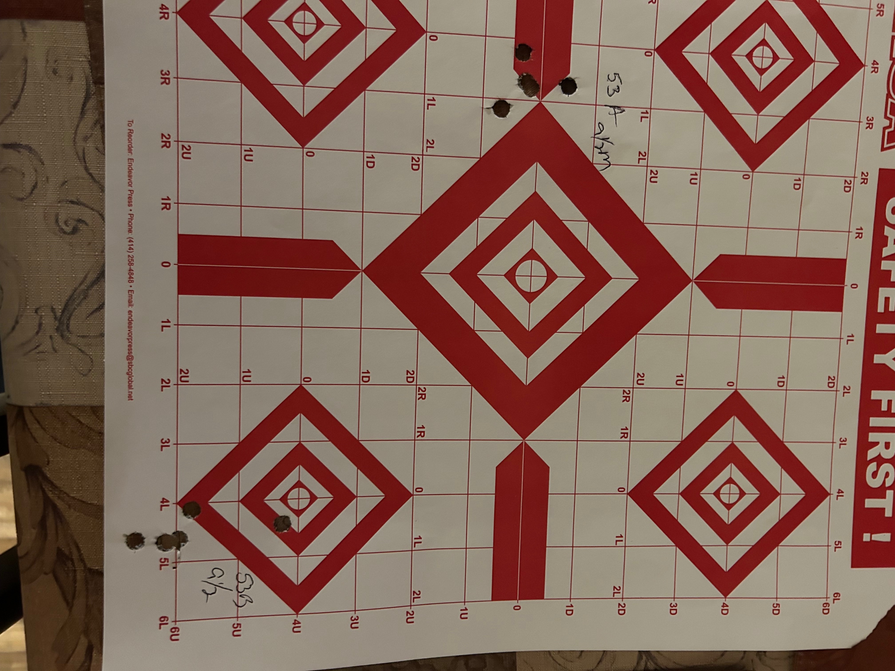

Did a bad thing today, made two changes to my load. Group on left I went up 2.5 grains on the powder charge from previous load AND went from standard 9 1/2 RP to 9 1/2M. Group on right I cranked the scope down 16 clicks and fired the same powder charge with standard primers. I’ve read IMR 4350 may require magnum primers in this cartridge and I’m inclined to agree. Ran out of time before firing additional groups. Back to the loading manuals!
(  of course pic got rotated 90 degrees!)
Ah, sounds like something I just did.  Never make multiple changes when doing load development.  I tried it yesterday and now I have to re shoot some to identify what caused what.  I’m good at going backwards.  I am playing with a different way to set my neck tension, using different powder charges and different bullet seating depths.  Shot five, five shot groups.  Three were terrible and the other two not really great.

Looks like you’re getting there, that one group isn’t too bad!  I’m thinking that with a bit more tinkering you should be able to get it sub-MOA, especially since the action is bedded…..  is the barrel free floated as well?
My .308 version of your rifle shoots just under MOA, it is pillar bedded. The .270 shoots just as well and it is as received….  I did not take it out of its stock so I don’t know if it has been fooled with, but since it shoots under 1 MOA I’m inclined to leave it as-is. 150gr Sierra GameKing, and 130gr Nosler Ballistic Tip, respectively.  As you can see, I favor H4895 because I have over 16 pounds of the stuff. Laugh

Thanks, John. I think 4895 would probably be a better powder for me but I have almost as much IMR4350 as you do H4895. Yes, I floated the barrel channel on the new stock and epoxy bedded the recoil lug and around the front pillar. I think this rifle actually likes my hunting load better than any of the loads I’ve been tinkering with but it’s the result of decades of tweaking after years of development. I need to fire two more five-shot groups with those latest loads before I make any more changes but I’m thinking my load benefitted from both changes, Chuck. I know better but sometimes I get lucky. I’m thinking RP 9 1/2 standard primers may not be achieving good ignition in this load. I hope I’m wrong because I have a few thousand of them and only 80 9 1/2 Magnum primers and no Federal 210 primers. Good thing my levergun loads don’t seem to require magnum primers!
