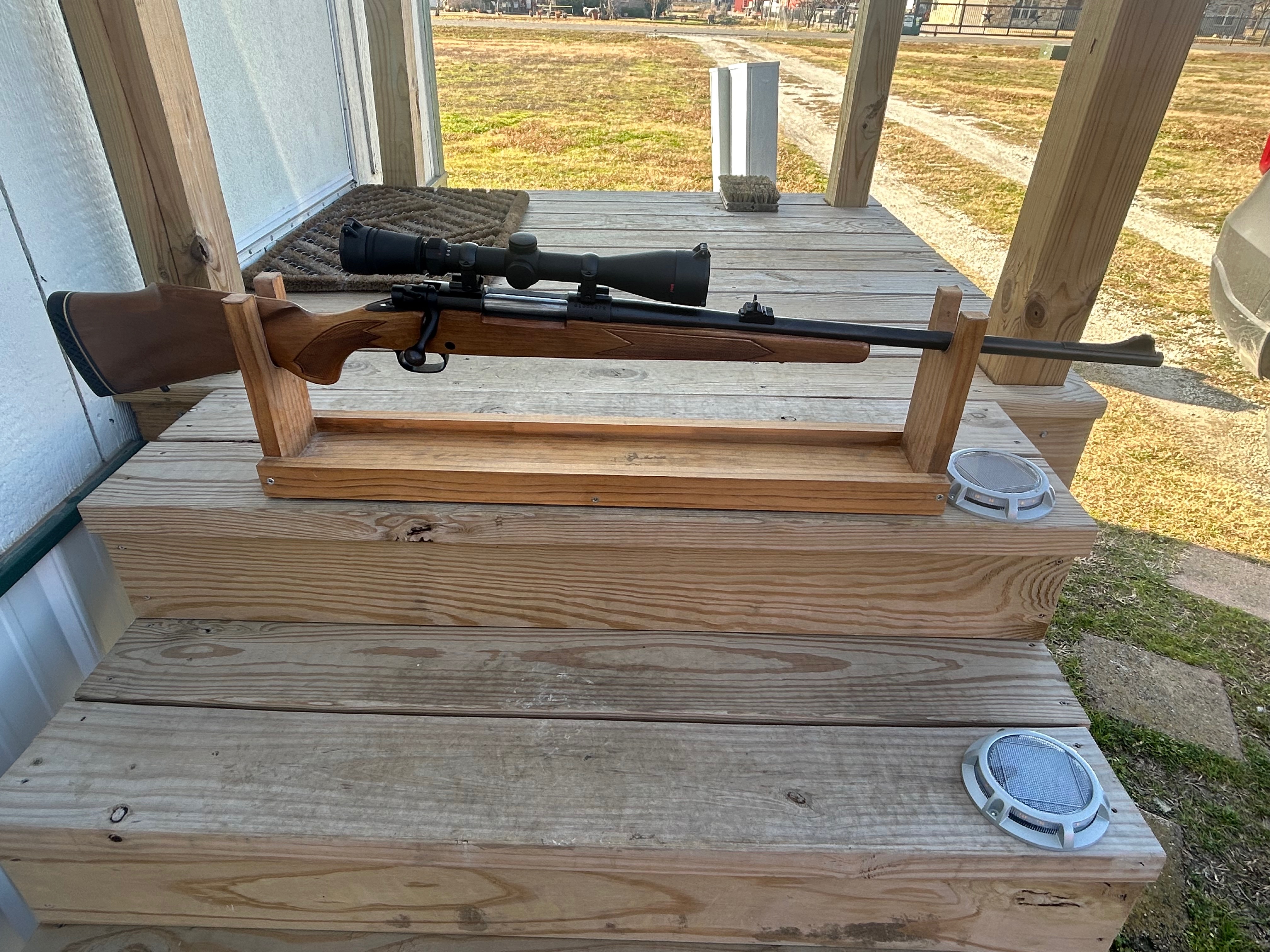

For those of you who don’t know the Winchester Model 670 was a budget version if the Model 70 built in the late 1960’s thru sometime in the late 1970’s. They feature the maligned push-feed action, a birch stock and a blind magazine. The rifle also had a 22″ barrel that has a reputation of delivering excellent accuracy for a sporting rifle. My first hunting rifle was a 670 and after years of learning to shoot and reload I discovered it would consistently deliver groups in the neighborhood of .67″, often less. My pre-hunt sight-in target was a business card at 100 yards. Sadly, after hundreds, likely thousands, of rounds later a bit of the rifling let go and it is now a 35 Whelen residing in a nice Boyd Walnut stock.
Fast forward about 20 years, I was perusing the offerings at my local orphanage and found a bit later 670 (SN G1350279) with a butchered stock but otherwise decent shape. I put it in the older 670’s stock and put a decent Redfield scope on it with bases and rings from my parts box. Goal was to make a loaner/backup rifle for my brother’s South Texas deer lease. It wasn’t pretty but it shot very well, at least one youngster shot his first deer with it. A few years ago I realized it wasn’t getting used any more as a deer camp rifle so it came home a few weeks ago. I remembered it shot very well and decided to see just how well it would shoot. I took it to the range and was reminded it had an excellent 2.5# trigger and shot a very respectable group with my standard hunting load. I ordered a Boyd Pro Varmint laminated stock with optional pillar bedding and a big brown truck brought it today. I’ll glass bed the recoil lug after Mr. Potterfield’s order gets here.
It’s been a train wreck around here today so I’m not going to do any disassembly or fitting. I’m sorry if this offends any of the pre-64 purists but I thought I’d have a little fun with a solid Winchester design without hurting a collectible Winchester. By necessity it’s also a low-budget project but that just adds to the challenge.

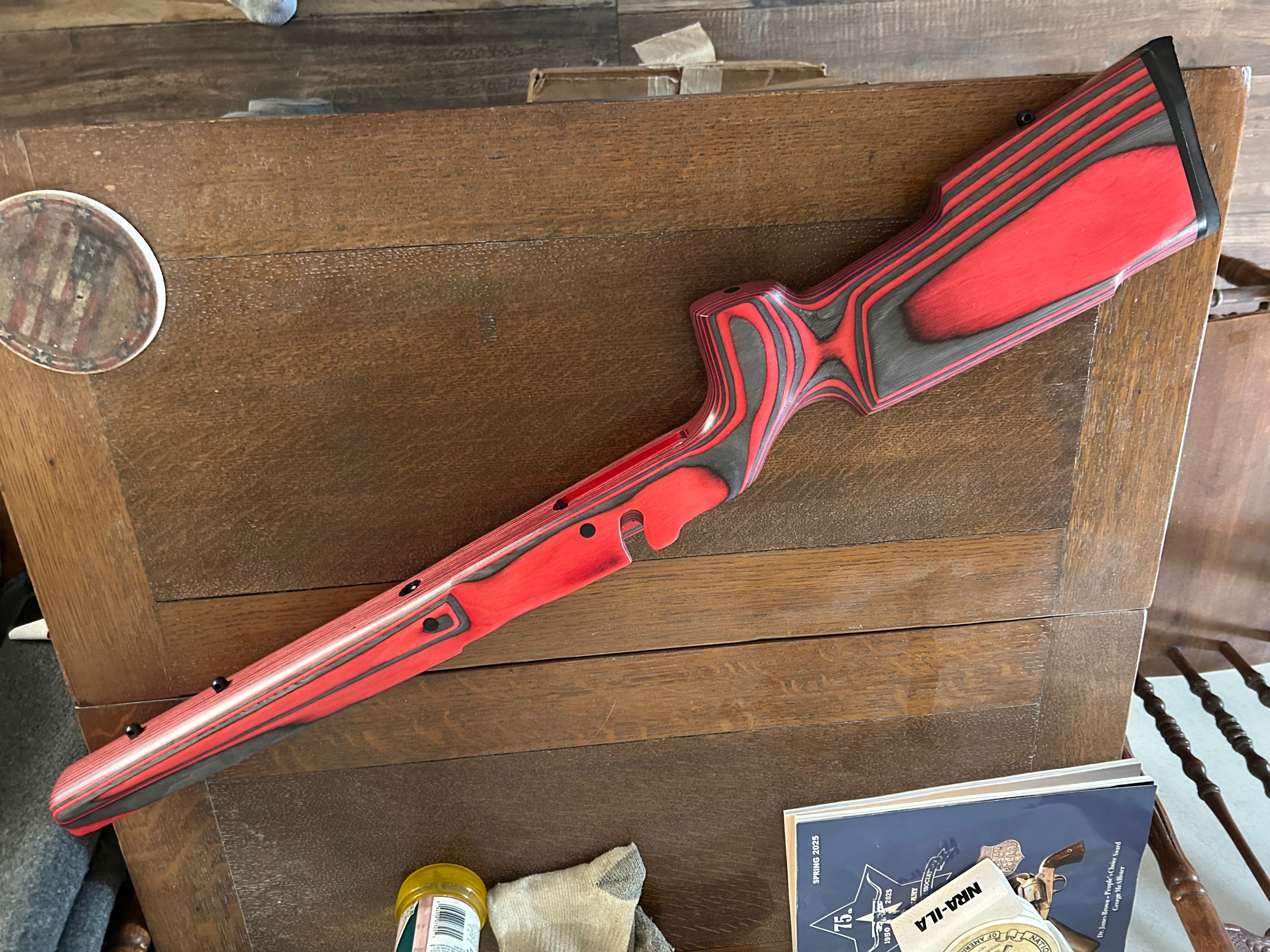

When you showing everyone the stock you got? -Jeremy P
I may have gotten a little carried away there but since colors are a no-cost option I had a little fun. It was a bit more colorful than I was expecting but I like it better every time I see it.
Against my better judgement (now there’s a new twist on oxymorons!) I’ll post a pic but I’m concerned some of our more conservative and sensitive members won’t be able to unsee it. I’ll have to change devices to post the pic but this post, when edited, may require a warning label.

I think it looks amazing! Congrats

Oh!! The humanity!!!YellLaugh

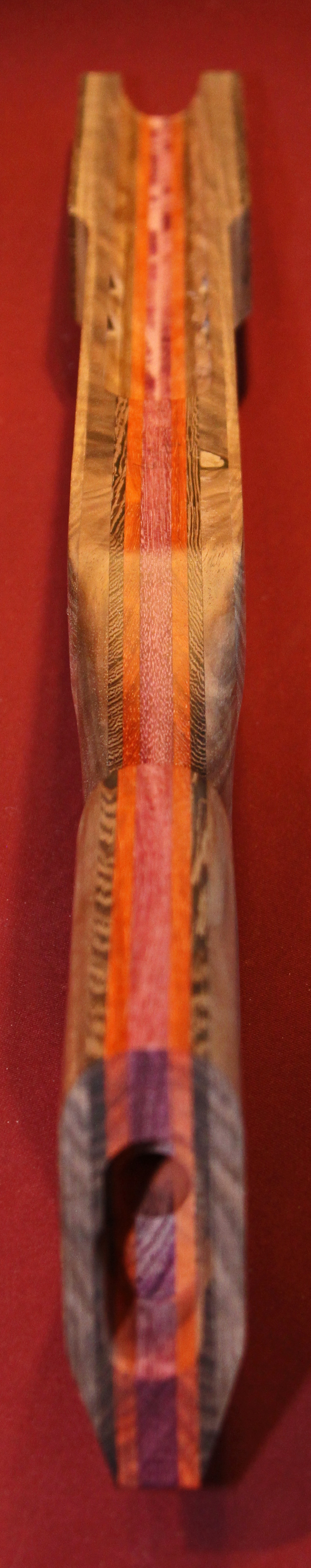

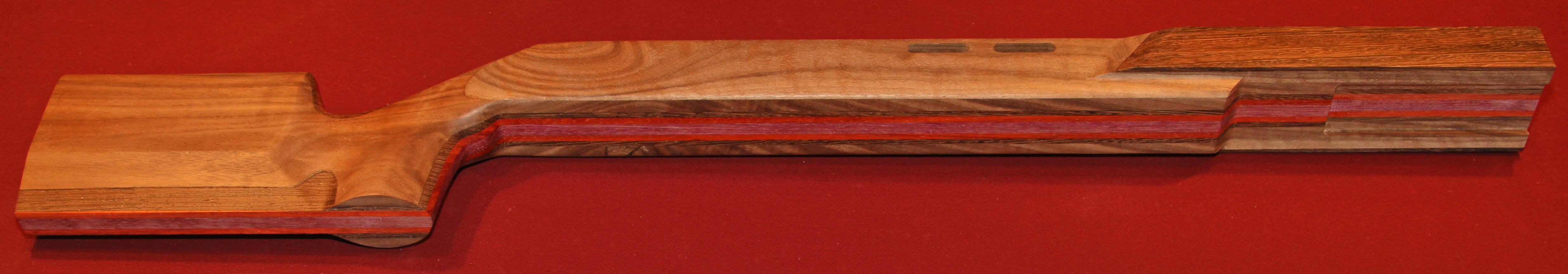

I collect guns from about the 1850’s to the 1890’s.  Recently I have bought some early Post 1898 Winchester bolt actions.  But I love to shoot and I do shoot most my collectable guns but, they can’t be shot every week.  So I have some shooters too.  Laminated wood stocks are excellent stocks. Here is a picture of the F Class Open stock I’m using.  It will be a 284 Shehane which is a modified 284 Winchester.  If shooting a very large caliber carbon fiber layers can be added.

I think you’ve showed me that stock, looks mighty stout! Have you done Open Class before?
