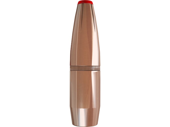

Is this the bullet?
Hornady SUB-X Bullets Polymer Tip
Forum Posts: 7196
December 30, 2025 - 9:59 pm
No, this looks like it.
A metallic bullet with a pointed tip, showcasing a smooth, shiny surface.

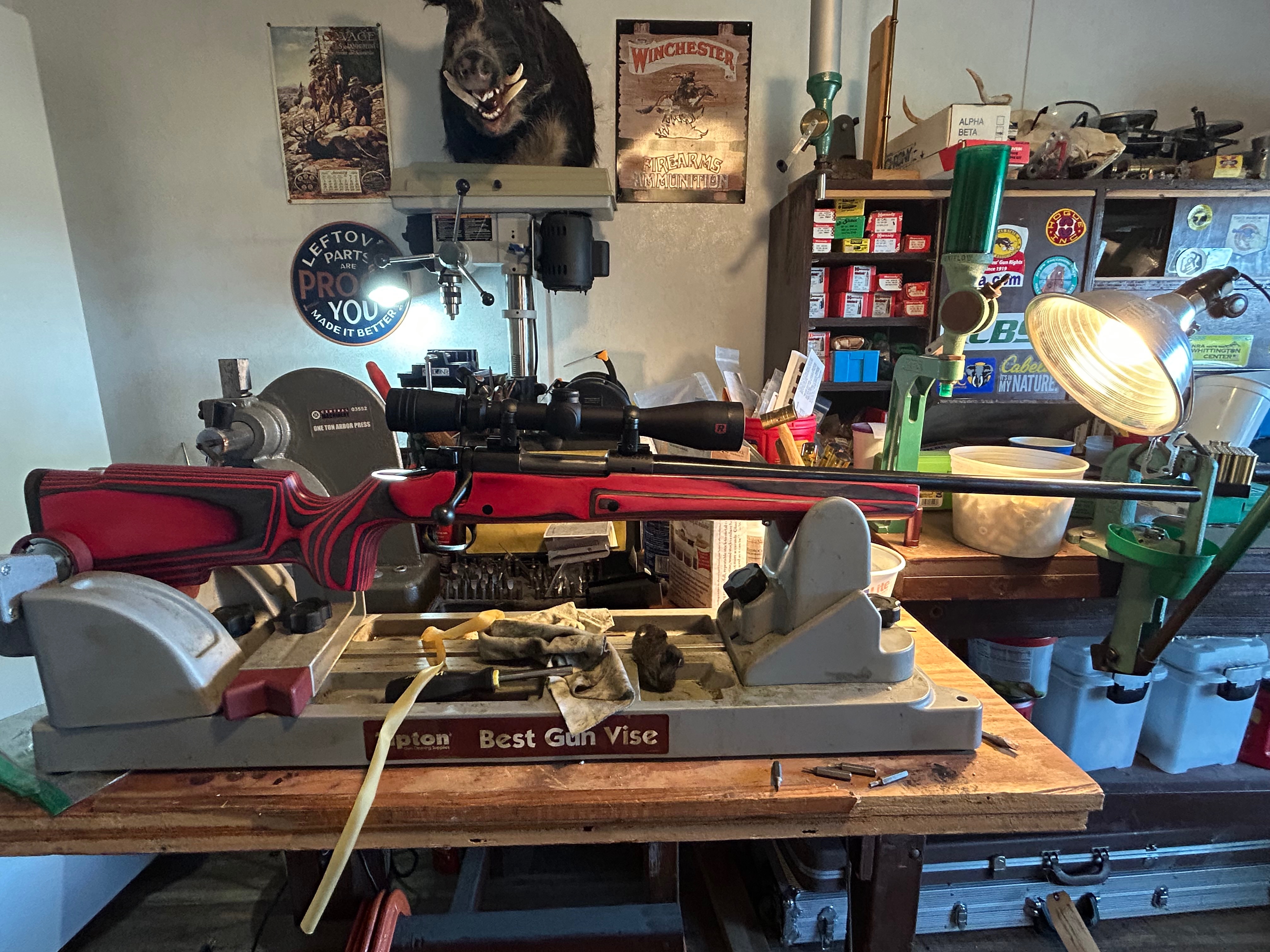

Finally got the stock prepped to my satisfaction and got the recoil lug and front action pillar area bedded. The room where the magic happens is a glorious mess with this project, two rifle and one pistol ammo project underway.
Why, shoot,  ain’t nothing good gone happen in a “clean for the magazine” shop. Can’t you see ole Hogzilla smilin?

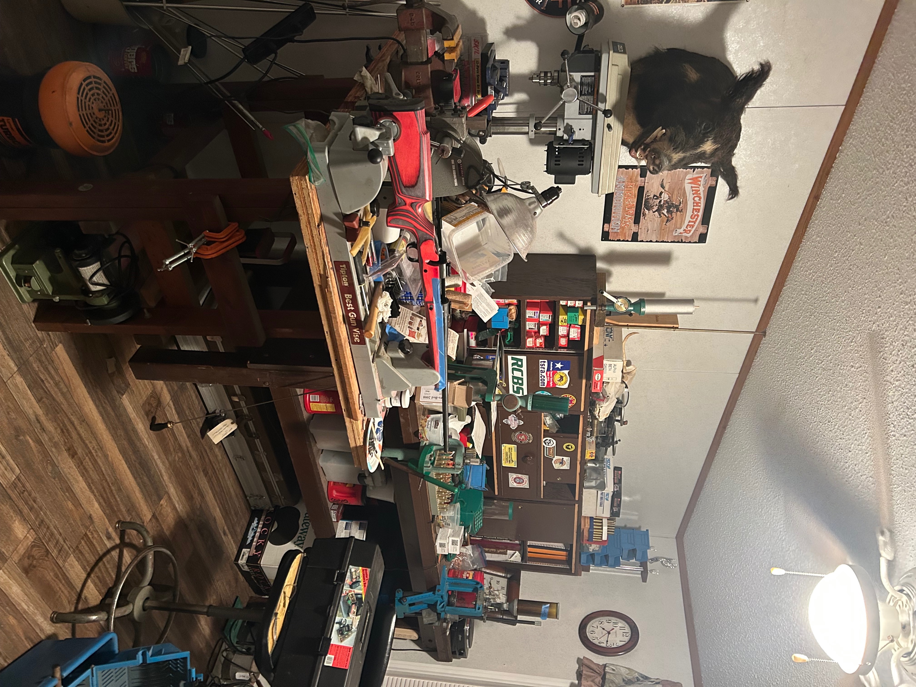

I’m surprised that everything stays in place, with the room tilted like that.  Laugh
My friends accuse me of having a “Better Homes and Gardens” reloading room……  I confess I like to keep it neat.  It’s not that I’m OCD, but rather I tend to misplace stuff.  If I didn’t keep it orderly, I’d always be looking for something and would never get things done!!
Zeb-
Yep, he always seems to enjoy watching over my projects in the room where the magic happens. Beats the heck out of an elf on the shelf! If you look closely in the jumble on top of the loading bench you’ll see his big brother’s skull. He was very close to the nearly mythical 500 pound boar. He was as big around as the 55 gallon drum feeder where I shot him and over a foot longer. Great story, remind me to tell you sometime. The mounted boar would have been over 300 pounds on a TV hunting show but in real life was probably under 200. I took him on the famous Nail Ranch near Albany, TX. Those are his real teeth, not plastic!
I should be able to separate the stock and barreled action and reassemble after my nap this afternoon.  We’re gonna need to shoot this thing!

It was a lot neater after I moved things back in following a renovation. I like it neater and will clean up after this messy project but the loading projects still under way will add to the clutter for the time being. There’s lots of stuff in that little room!
