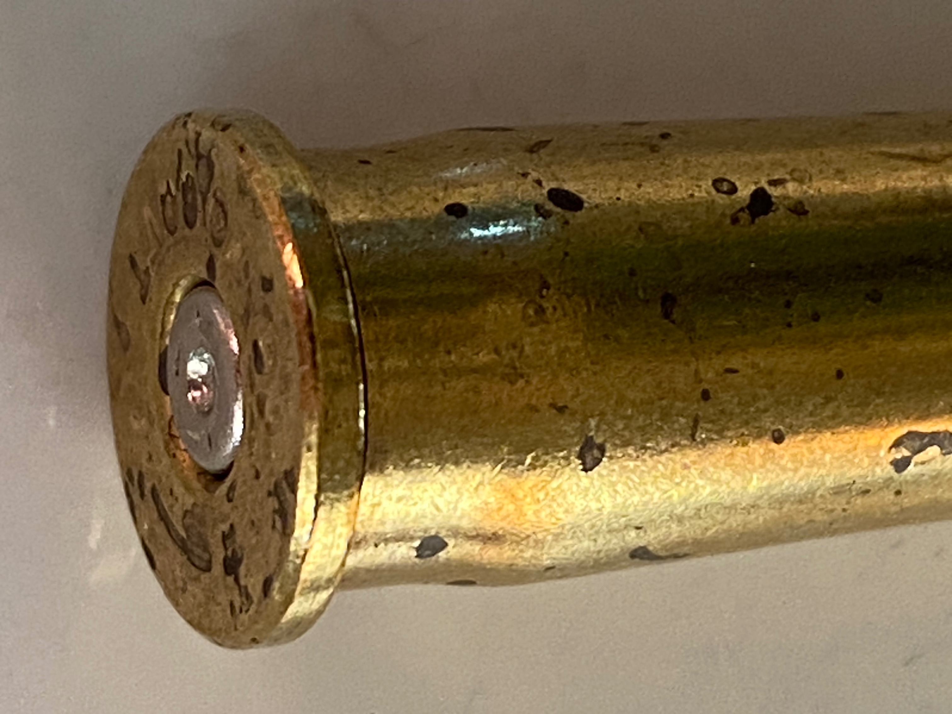

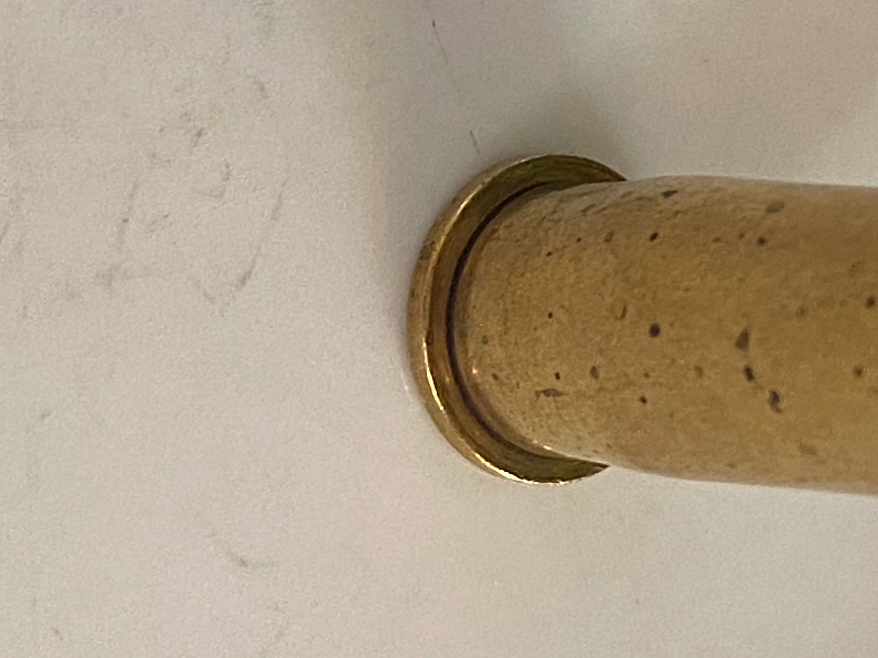

Bulge in case corresponding to ring in chamber?  Amazingly, the round at 17,000 psi has less of a bulge than the one at 15,900 psi.  I fired 20 rounds through it.  Having said that, is it safe to shoot?

I certainly would not shoot it again.  The steel inside the bulged area has been work hardened as a result of being stretched and stressed. Eventually it will crack, fracture, or shatter.

 I assume the cartridge was hard to eject.
 I had an antique 1886 with a similar problem, it was cracked between the chamber and the magazine hole in the receiver. I returned the gun to the owner for refund. I’ve seen 76s and 73s with the chambers blown down, crack in chamber to magazine hole. You have to remove the magazine tube to see it, bummer. T/R

I’m thinking chamber issues and would not shoot even low pressure loads until a chamber cast and/or careful case measurements can be obtained. Could be an undersize sizing die, may want to measure a sized case if the subject case was full length resized before loading. I have a 45-70:sizing die that is very much undersize. A careful measurement of the fired case may be useful as well. If the latter measurement is much over max I see an investment in Cerrosafe in your future. It’s quite possible you need to neck size cases for this rifle but you could also have a chamber one round away from going from together to apart. I wouldn’t want to be there when that happens.
Proceed with caution, my friend!

Actually, not difficult to remove at all.  I fired several rounds that bulged less than a second load that bulged more, and it was only after firing a few of these I noticed the bulge and observed it on the first ten rounds previously fired.
  Good advice. T/R

 I have heard of chambers being sleeved but with a 45/70 lightweight the barrel might not be thick enough. The gun is modern and who knows what load someone will put in it. If you part it out your still left with a bad barrel. Maybe a very good gunsmith can make what you need or repair it. T/R
