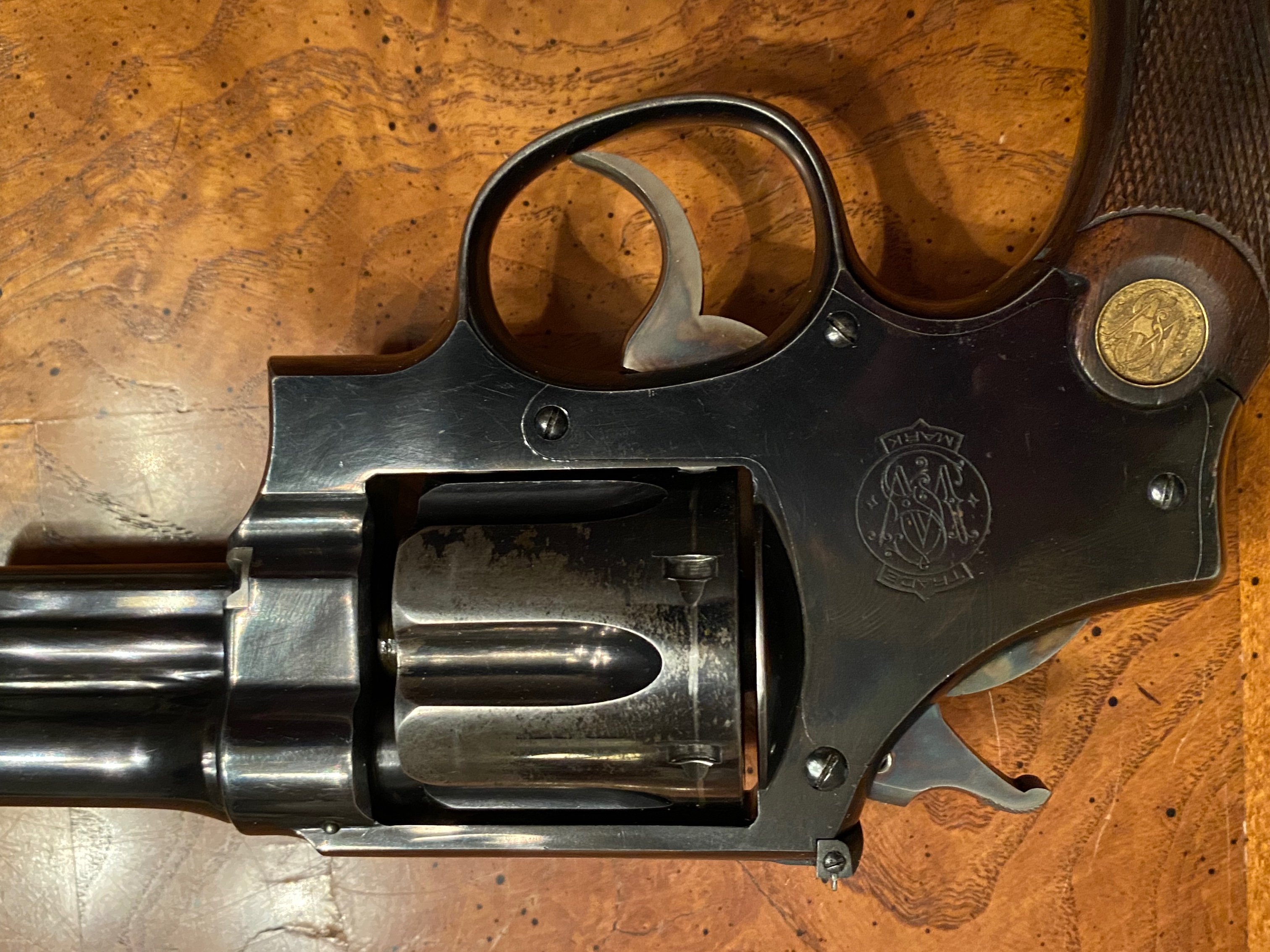

54
February 12, 2023 - 9:34 pm
9AB0AFA6-E73E-41A3-B117-FF6AB5CE8382.jpegsteve004 said 3AE40300-2BA4-4E29-925F-114BF75E4312.jpeg
Bryan Austin said
Which case is the 44 Magnum, the other two are 44-40
I can’t say I can tell – which I’m sure it what this photo is supposed to demonstrate.  It begs the question why did the world need a .44 magnum?  The predecessor to the .44 magnum was the .44 special.
Darn good question!
If you have a Smith & Wesson Target Model Triple Lock revolver chambered in .44 S & W Special, why ever would you need a firearm chambered in .44 Magnum?
Forum Posts: 2553

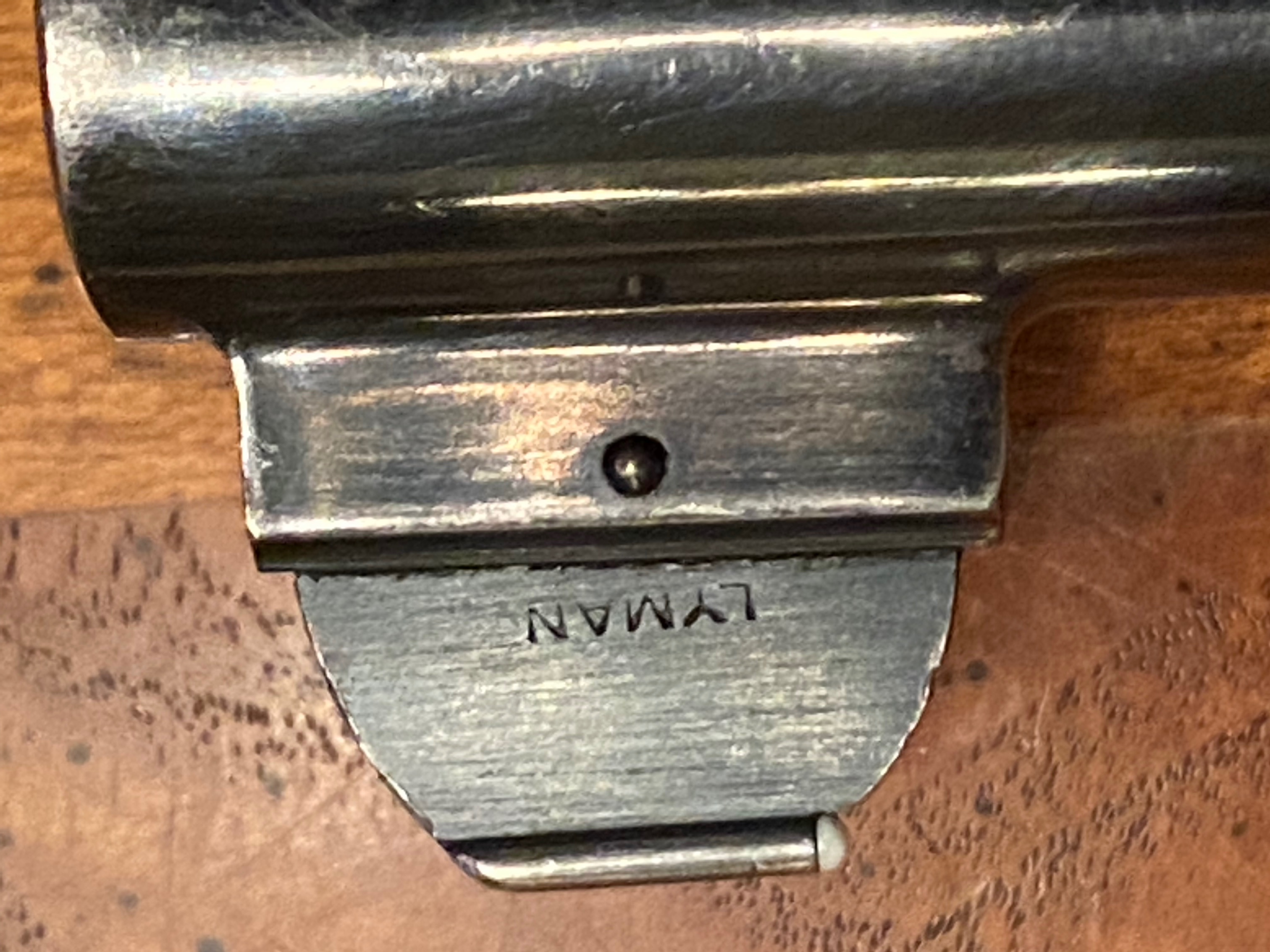

55
February 12, 2023 - 9:37 pm
B160F9D6-0B9D-4ADD-802B-13F7BB7FE59B.jpegB9FC3FB6-1F15-4690-9890-AD2FE11079D0.jpeg7FBADCD1-0181-4D32-8365-A6B81C27E206.jpegFB358058-653A-48CA-86FE-18D2F36823E0.jpegI’ll never figure out the photographs on this site and how to do it.  Here’s four of the six I wanted to post and some decided to flip upside down as well.

56
February 12, 2023 - 9:39 pm
1552FD1C-2A85-4605-ABDF-B461E42E61EF.jpegAnd one more…

Forum Posts: 2553
59
February 12, 2023 - 9:57 pm
Darn good question!
OK, I’ll bite on that question… Because you cannot shoot a 220-gr FMJ load @1900 fps out of that S&W without it blowing up in your hands! OTH, my Ruger Super Red Hawk .44 Mag loves it!!  When I used to regularly compete in IHMSA matches, I would usually shoot 500-rounds per month of that load in that gun, and I shot it in competition for nearly 6-years before I stopped competition shooting.  These days on the rare occasion that I shoot that gun, I run 180-gr Sierra JHP loads @1975 fps through it (I now have a Leupold M8-2X scope on it).  It will cleanly take deer sized animals out to 100-yards.
Bert, now that makes total sense.  But my Triple Lock revolver is CLASSIC!
