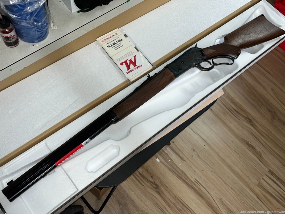

pix950369800.jpgpix352511806.jpgpix224003725.jpgpix713293776.jpgGood Morning, Chuck.  Yes, that’s really the best we can do, short of black powder itself, which I’ve never fooled with, although friend Mike would willingly serve as my mentor.
As you already know, my humble collection includes a couple of Miroku-built Winchesters and once featured a beautiful little Browning Model 53 in .32/20 I should never have sold. Because it was made of modern Chrome Molybdenum alloy,  I didn’t hesitate to replicate the old 60 grain jacketed soft point high velocity load, for which there were several safe recipes. Not a deer rifle but raiding raccoons feared it.
That’s one appeal of the Winchester “reissues.” I would never consider firewalling my 1949 Deer Rifle. That would be irresponsible, even immoral.  However, if it weren’t for the steel crescent “rifle” buttplate on my rice-powered .45-90 with its inauthentic but helpful 1-in-20 twist barrel,  I might get a little more adventurous.
If I can ever get back in the field,  what I have in mind for that 86 is bacon.  Traditionalists brace yourselves because I have had a minty Lyman 56A in my parts box for a couple of decades and the receiver is d/t’d for one. Of course, the tang is unavailable but, anyway, tang sights on hard-kicking rifles make me nervous. They can do a lot more damage than a scope’s ocular bell.
