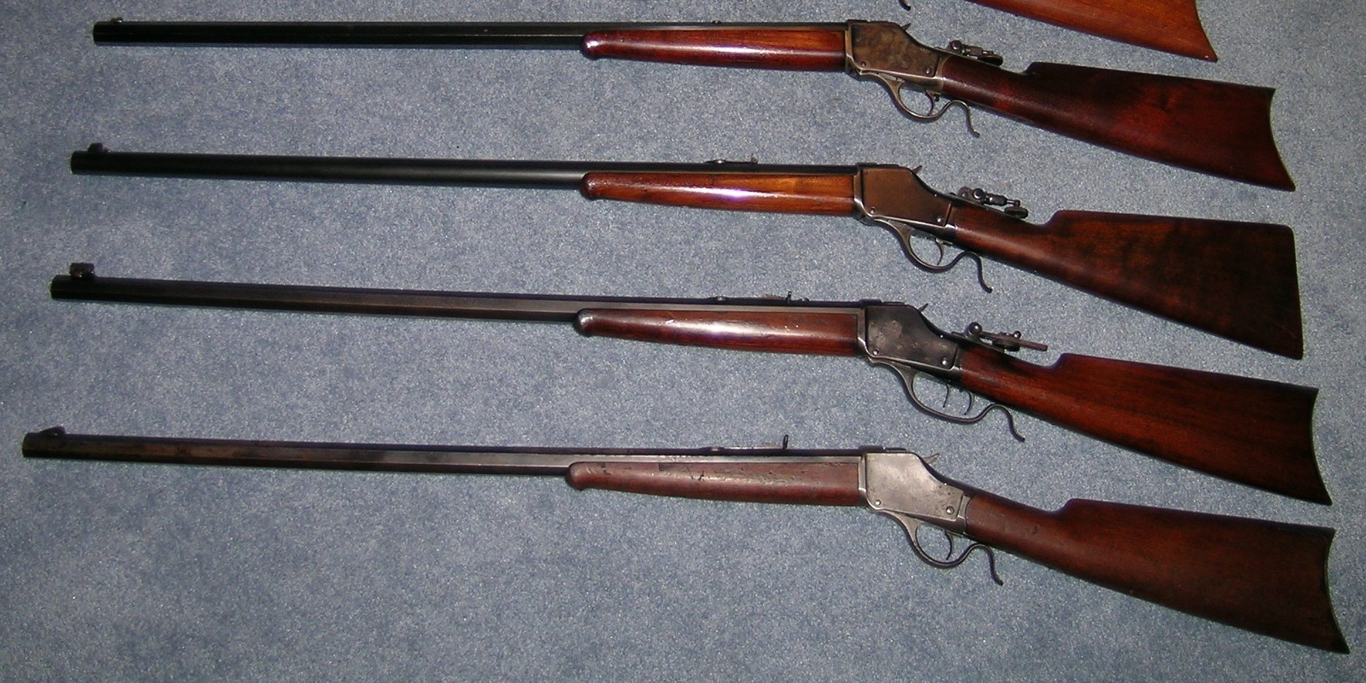

As some of you may know, I have a late production (1917) Single Shot (high-wall) rifle that was factory special ordered with a 30-inch No. 3 full octagon barrel, Schuetzen double-set triggers, a Mid-range vernier tang and a Winchester Globe front sight, and it is chambered for the 38 WCF cartridge.  I have owned the rifle for almost 30-years, and shortly after I purchased it, I bought (2) boxes of factory 180-gr JSP ammo for it (which it shot wonderfully).
I just recently acquired an original reloading tool for it, and I want to load up all of the empties that I saved for it.  In reviewing all of the reloading data I have, it is all strictly low-pressure (less than 12K) and for the Colt SAA and Winchester 1873 (black powder guns).  What I am looking for (and have not been able to find) is the equivalent Winchester High Velocity (WHV) load data.  I purchased a box of Hornady 10 MM XTP 180 grain JHP bullets that I intend to load in the 38 WCF cases, but need powder type & charge weight information.  The original WHV load was published to be in the 1,750 fps range, and that is what I am looking to duplicate.  If anyone has a data source for the 38 WCF (38-40) WHV loading, I would really appreciate a scanned copy of it.
The rifle in question is the second one from the bottom.

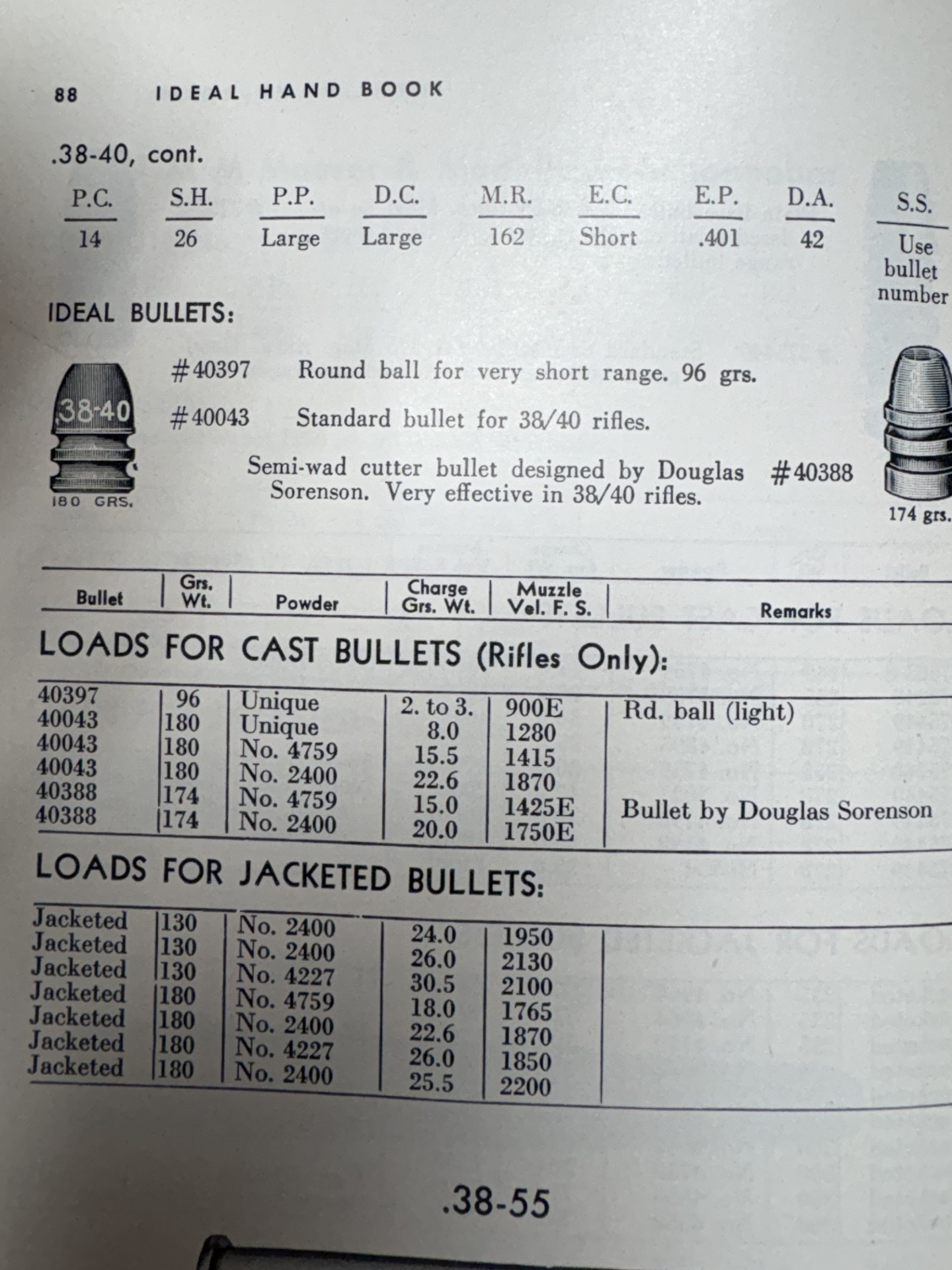

Check your e-mail. Santa Claus needs to bring you a Waters book. He even lists loads for 2400 and 4227.

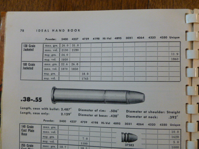

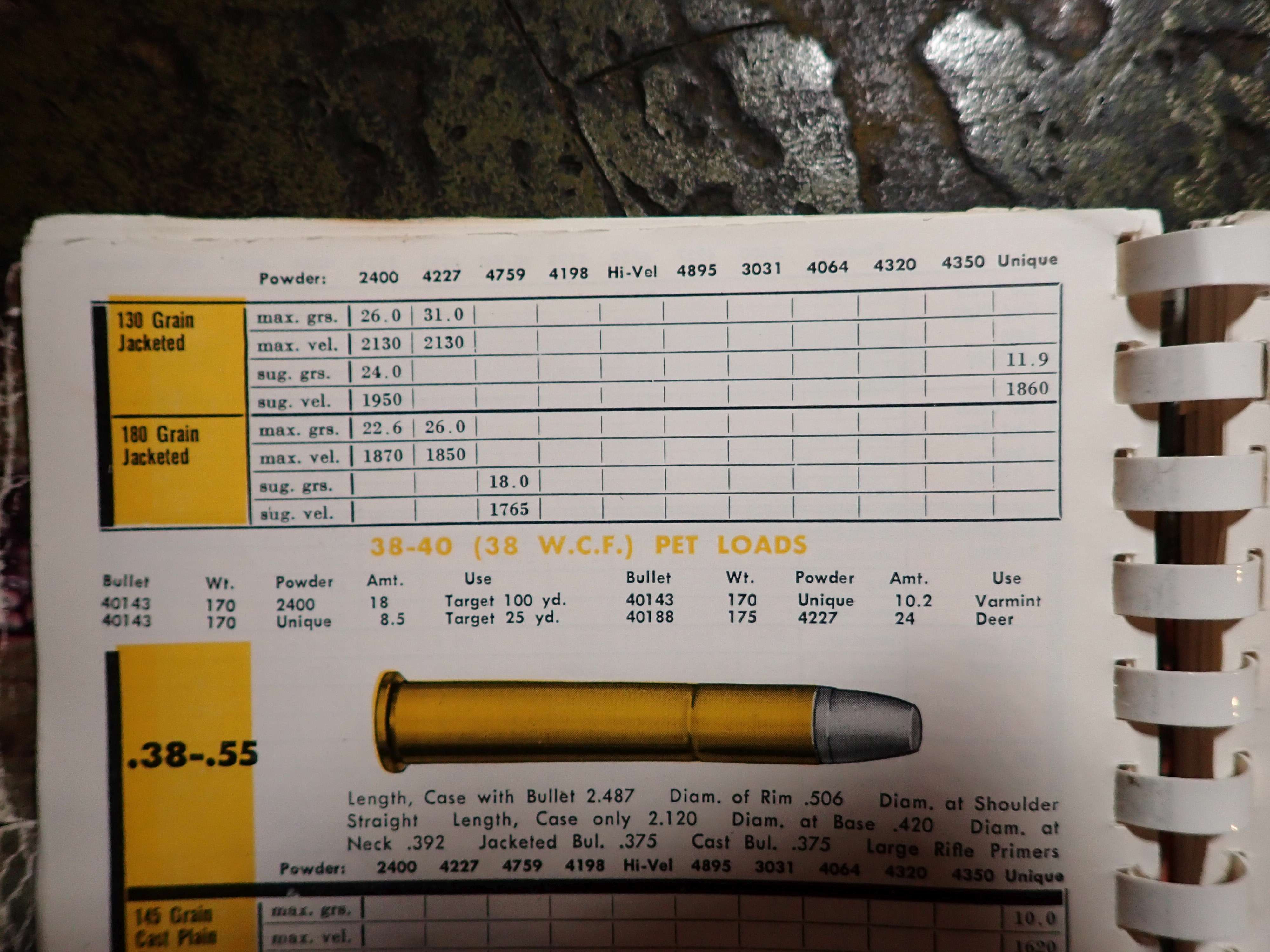

I was quite surprised by the load data in the old Ideal Handbook!  I plan to load with A2400, but not quite as stout as the listed 25.5 grain load.  I had no idea that the 38-40 cartridge was capable of pushing a 180-gr JSP to 2,200 fps !!  That puts it in the same fpe range as the original 30 WCF with a 170-gr bullet load.
I believe that I am going to start with 21.0 grains and work it up slowly to find the accuracy load for my old high-wall.

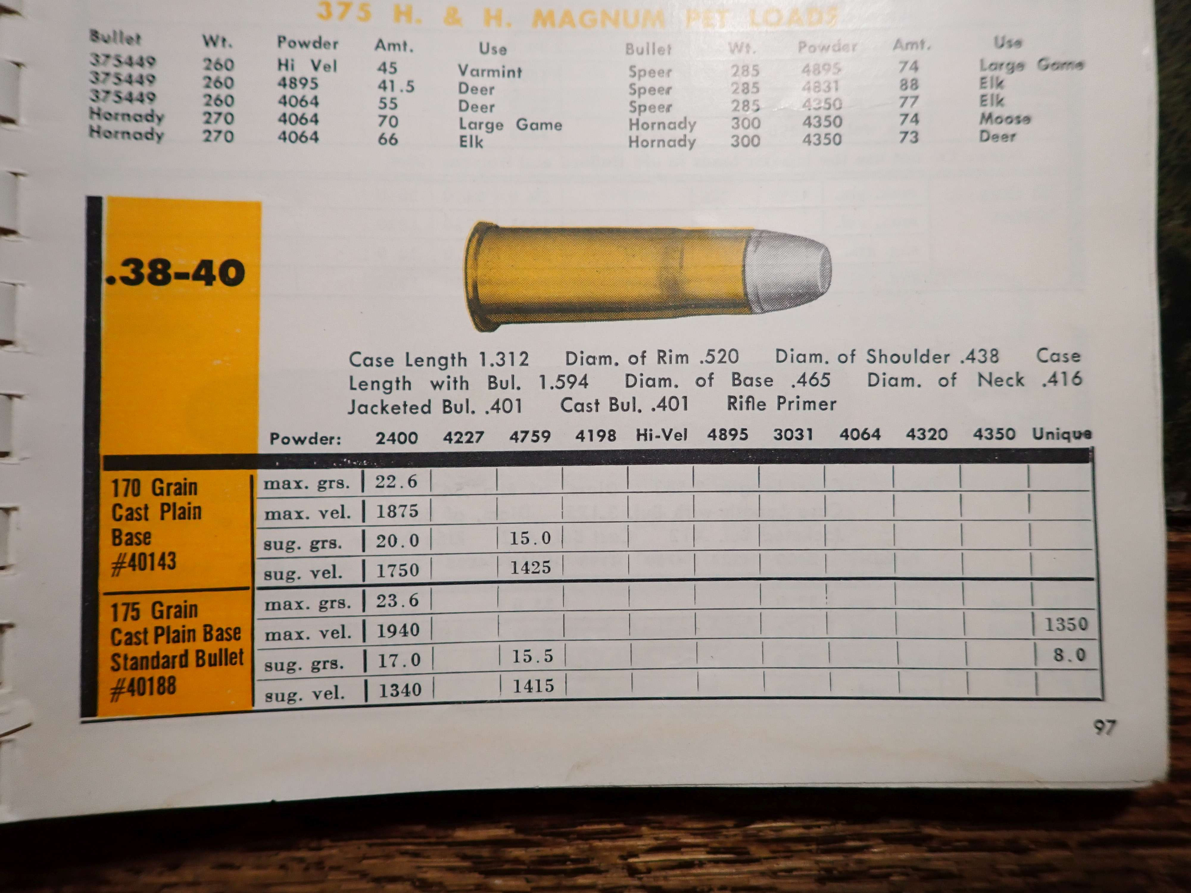

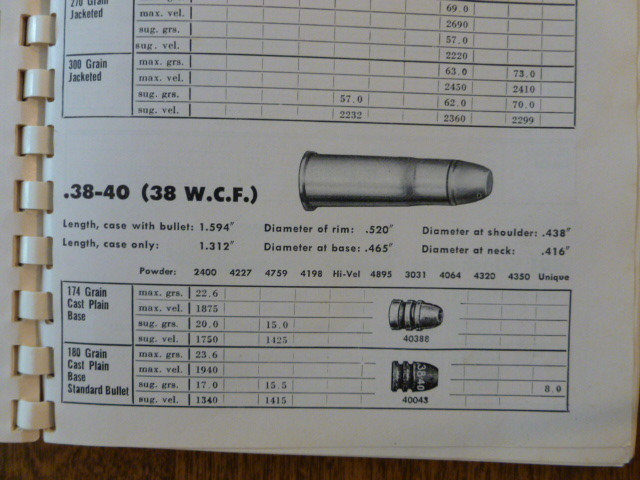

Ive shot a lot of 38-40 rounds through my shooter 1892 rifle using 18.3grn of IMR 4227 (180 grn lead bullet made by Meister), which chronographed at 1365 fps.  Working on casting my own currently.
My Lyman #41 manual has listed 175 grn plain base cast bullet at suggested 17 grn of 2400 for 1340 FPS, Max 23.6 grn at 1940 fps. However Ive shot 17 grns of 2400 and it chronographed in the 1650 fps range (200 fps faster than stated in the manual), with 68 fps range (5 shots).
Have attached the load data from Lyman 41 Edition Manual with options for IMR 4227, 2400, Unique, & SR4759.

Thanks Chris,
I will be shooting modern 180-gr Hornady XTP (10 MM) bullets with the A2400, and I expect it will perform better in the 1,700 – 1,900 fps range.  It should be relatively easy to achieve that velocity range out of the 30-inch barrel on my old high-wall.  I have to imagine that the listed 2,200 fps load (25.5 grains) would be quite the handful in a Model 92 Carbine !Surprised

Sounds like an interesting project. Waters had some interesting and hopefully helpful data. I have a nice enough 1892 rifle in 38-40 WCF but it liked Mike Venturino’s of 8grs Unique under my cast 180 bullet so it’s the only load I’ve ever tried. I don’t shoot it very well with the standard 22A rear sights so it’s just a fun gun.
A 180gr bullet at 1800fps is pretty impressive for a pistol cartridge from the BP era. Waters had some case issues at the velocities you desire but I suspect those issues may have been attributable to the test rifle as his data is a bit more conservative than the Ideal data. I’ll need to review the article to see if he has any helpful hints.

Bert, some loading info from my Lyman #40 handbook. Also at your advanced years you should not even consider 117 MPH. I got my little car upto 110 and was scared silly. DonP1040642.JPGP1040641.JPG

As promised, I’ve reviewed Waters’ January 1975 article. A few points that may be useful are his recommendation for high quality dies to ensure getting the bullets centered in the case (and in the bore). He also reported that Whelen found the WHV loads less accurate than standard velocity. In most cases Waters’s results were consistent with Whelen’s. With his 1892 Waters reported best velocity under 1560fps with 2400 loads in particular decreasing in accuracy as velocity increased. For some reason the 4227 loads were the exception with good accuracy at 1827fps. He also recommended magnum primers for 2400 and 4227. Waters refers to Mattern a couple of times but he had little to offer unless you happen to have some Sharpshooter or No. 80 powder lying around. Bryan Austin has some insight into No. 80 powder in his site. Right now you’re probably giving some thought to Lil’ Gun.

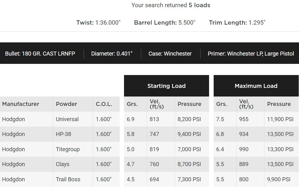

I spent about 45-minutes searching for load data on the Hodgdon website… the only load data they have for the 38-40 are a few very anemic pistol loads.
