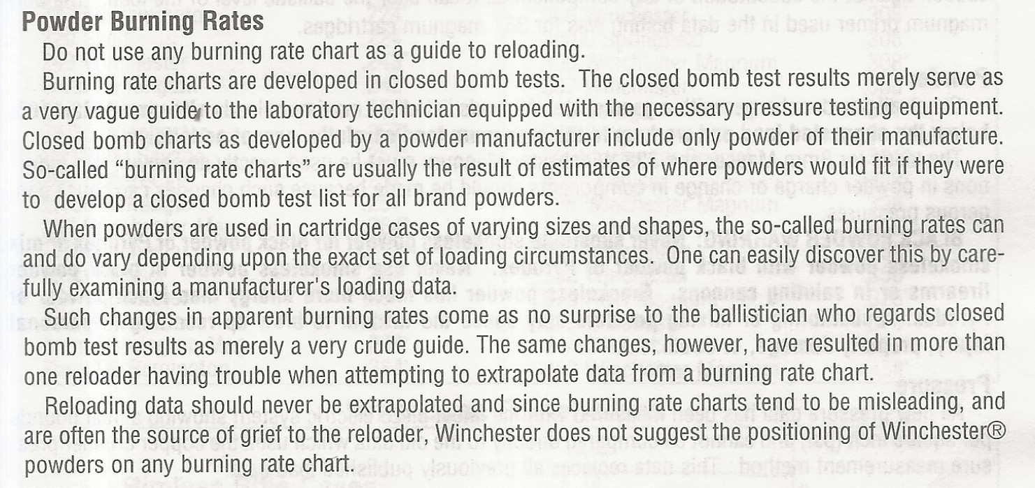

The IMR and Hodgdon 4198 are not the same.  In Bert’s example they are close.  But here is what Winchester says about using the Burn Rate Chart as a loading guide.

I like burn rate charts but I will always start out with a published load for that powder. All a burn rate chart tells me is if I should try to find a published load for a given powder when it is close in burn rate to another powder that is working well for me. Now that Winchester is under the Hodgdon umbrella I suspect their ranking of Winchester powders has merit. IMR4198 is working well for me, it’s a few bucks cheaper than H4198 around here if I need any more. I have the H198 sitting on the shelf so I’ll use it for something. I saw some 4227 on the shelf at Cabela’s this evening.

Bert, I like this website because it shows the pressures too.  I wish it had more of our older calibers.  Although the burn rate chart for the 4198 powders works out close for this caliber don’t rely on it for all powders and calibers.  I have another loading manual that talks about this but I can’t remember which one?Frown
Mike, I think IMR 4198 is one of the most versatile powders for our old rifles.  Like I said before, buy Frank Barnes book, Cartridges of the World, and you will have at least one powder charge for all of the Winchester calibers.  Often it will be using 4198.

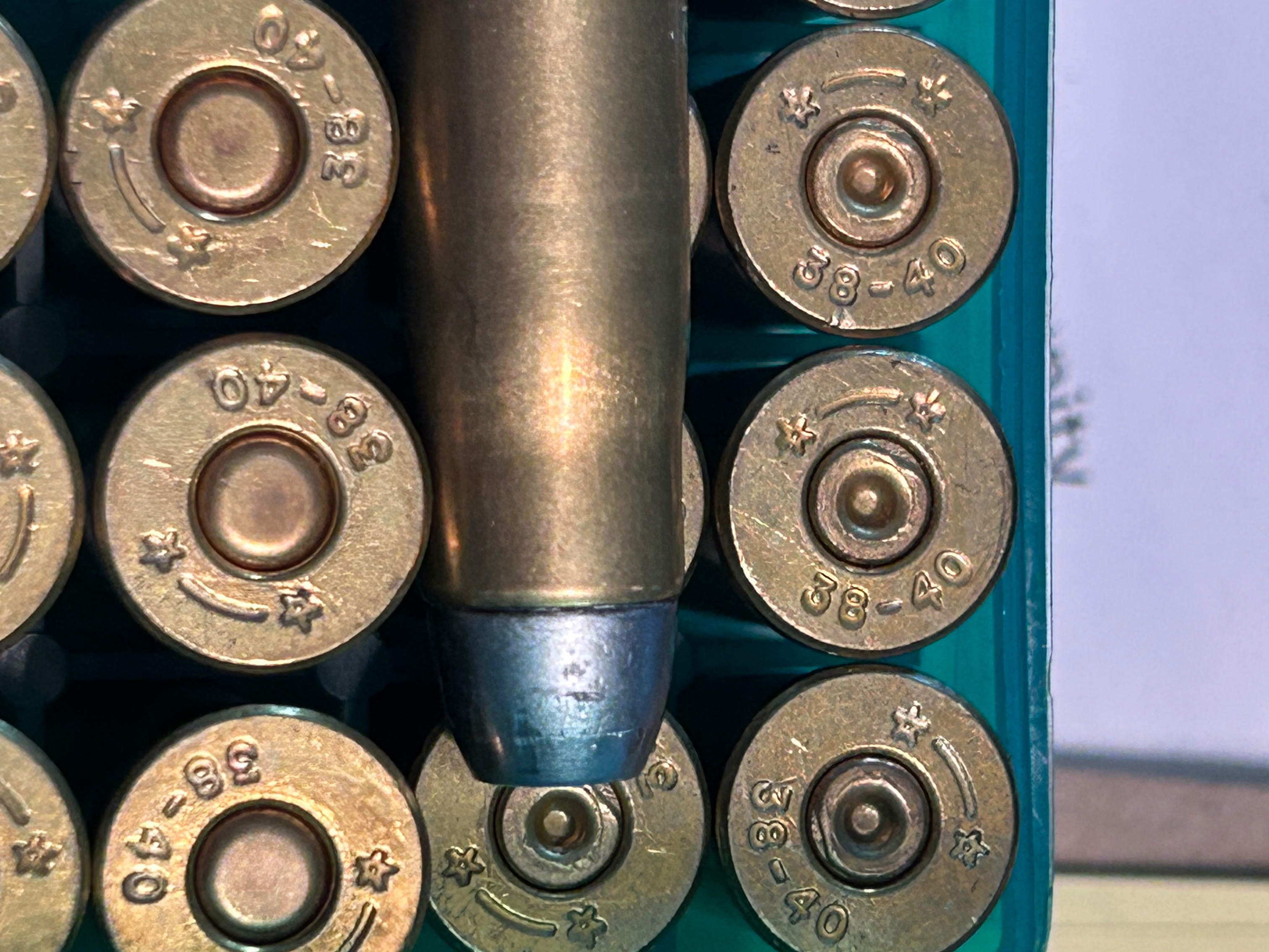

Working on some 38-40 for my 1892.  In the past I had purchased bullets (hard cast) but have since cast my own using Accurate Mold I ordered a long time ago.  Using 20:1 Lead with RCBS dies.  In seating these bullets I am getting a ring/groove in the top of the bullet because the seating stem is conical shape and the bullet ogive is a bit wider where it bears against the outer perimeter of the seating cone.  No doubt it is likely due to the softer lead.
I havent found an alternative with regards to the seating stem at present.  Was unsure how this will affect performance at up to 150 yards or if it would make a difference.  Any suggestions or solutions?

I sincerely doubt that the slight ring you are getting on the bullet is going to have any effect on the down-range accuracy.
I am reloading my 38-40 cartridges with an Ideal 310 tool & dies.  The 310 seating die has two different seating stems, one for jacketed (conical) bullets, and one for cast lead flat-nose bullets.
p.s.  What load (powder & charge) are you using?

Seating stem can be modified using bedding compound or another epoxy, just use a bullet nose to shape the bedding compound or epoxy.

Thanks Bert for the comments, was thinking the same thing regarding the performance.  Im using IMR 4227.  Since these are new bullets, Im going to see what charge works best in the next day or so.
Mike, Ive been reading similar online regarding using bedding compound or epoxy or something similar.  Thanks for the comments.

As you may have noticed I have not used that modification on my RCBS Cowboy dies used for these cartridges. The stem used for sizing is usually aluminum and things generally work themselves out after a few rounds. These bullets are wheelweight alloy cast in Accurate’s 40-180C mould sized to .401”

Im using the same mold (Accurate 40-180C).  I figured since I was using the softer lead that was part of the issue with the ring.  The difference may also be that you have the “Cowboy dies”, and I have the standard steel dies (RCBS #35605).
