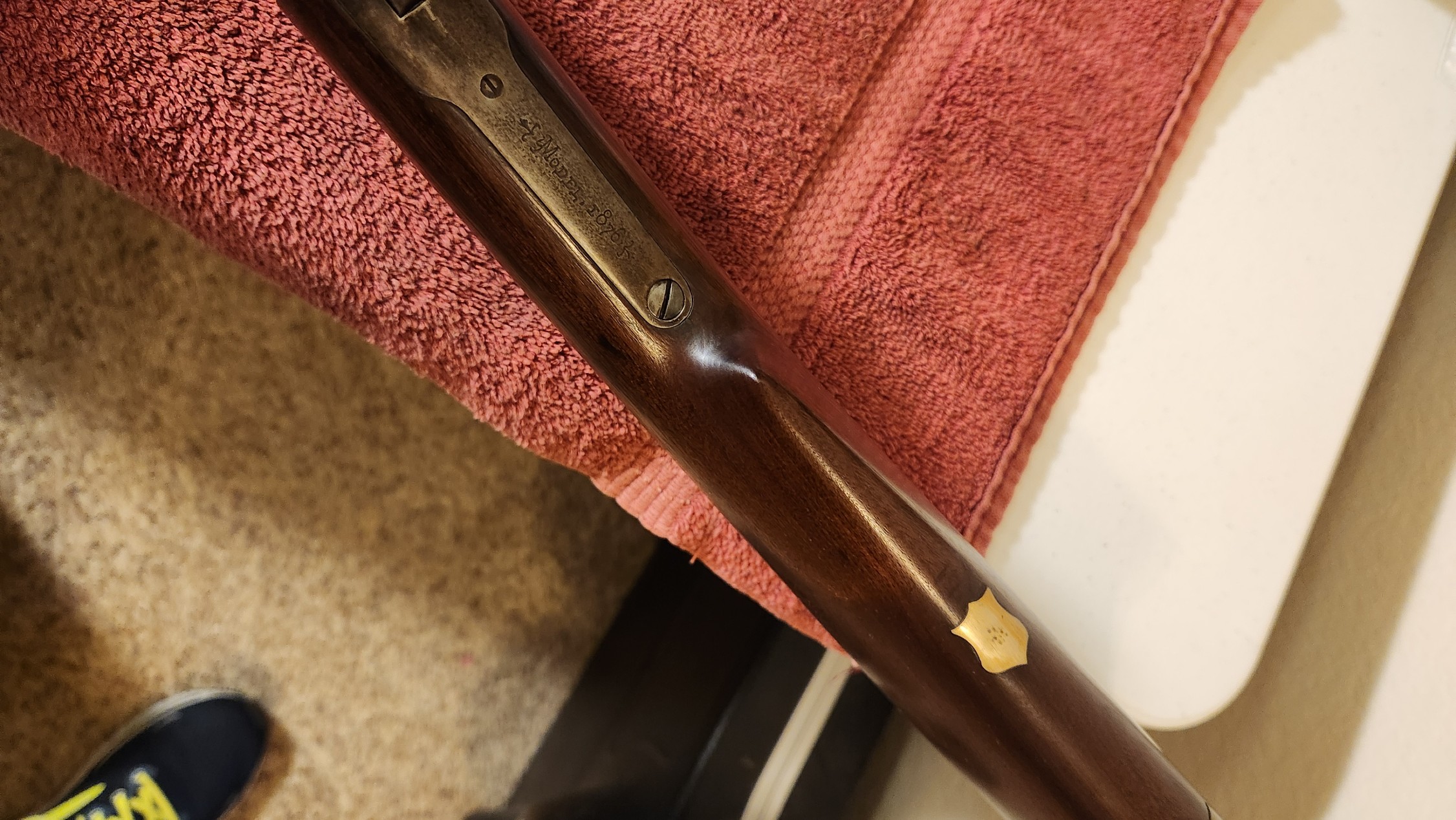

Since so many of you randomly share a gun with pictures, I figured here is as good a place as any, since this 1876 isn’t a cream puff and maybe doesn’t deserve its own thread…
Picked this one up because of its “possible” lineage, the inlet disc on the forend VERY Faintly reads “ST JOSEPH MO POLICE” and there’s a nice little badge inlet into the stock. Someone aggressively cleaned the hell out of the receiver at some point, but the gun itself is in very nice physical condition. I’m assuming it spent a lot of its life on a rack in an armory. Not a single chewed up screw. I tried the historical society in that area and the police departments looking for a gun history guy to no avail….for now at least.
20250413_093342.jpg20250413_093401.jpg20250413_093412.jpg20250413_093419.jpg20250413_093445.jpg20250413_093516.jpg20250413_093621.jpg

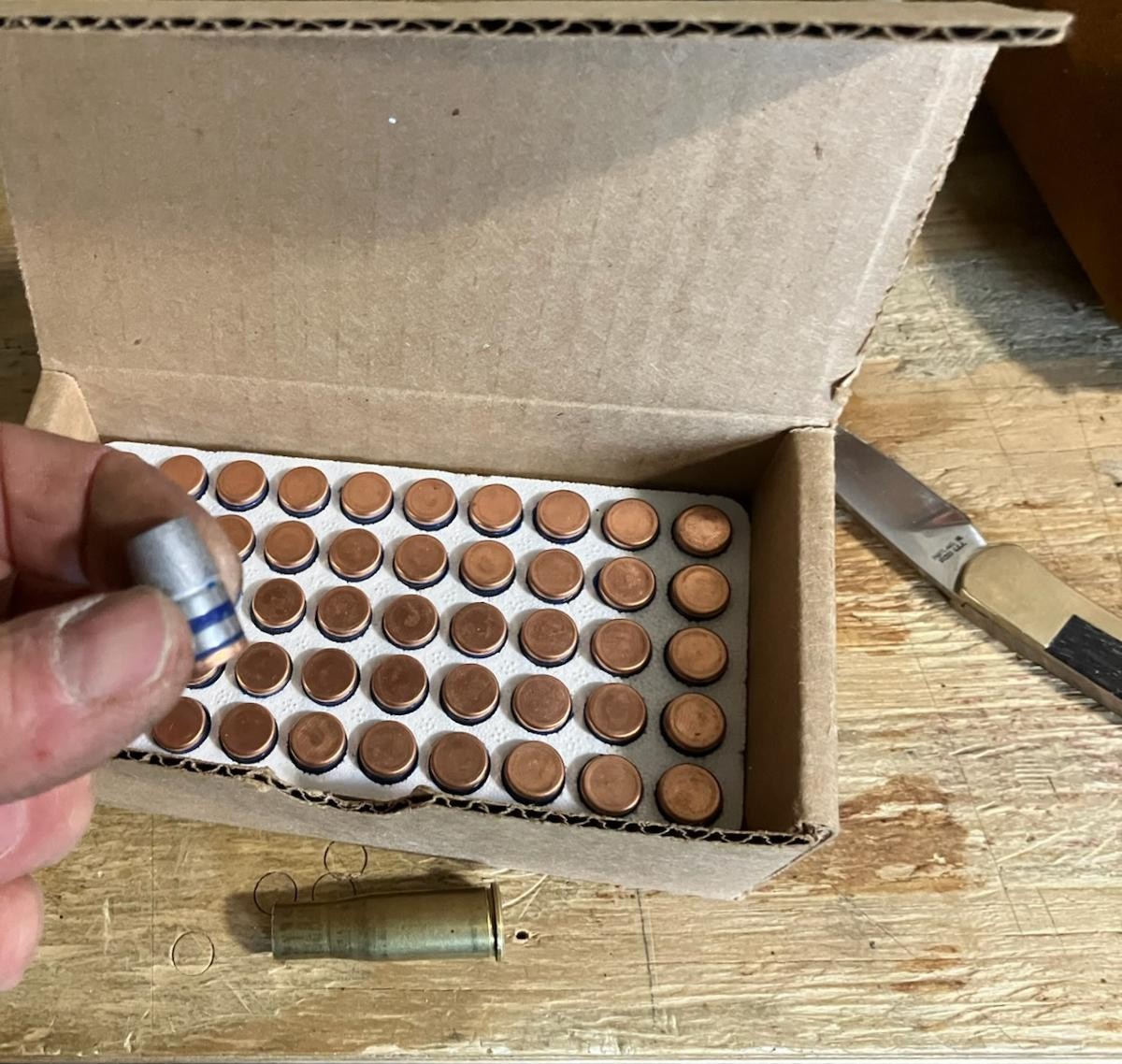

Have any of you loaded for your old 1876’s with oversized bullets. My early 45-75 not only spreads the group but has occasional keyholing with .458″ standard bullets. I recently slugged the bore and came up with .4595″. I now have some Montana Bullet Works .460″, 340 gr bullets I will be loading soon. I will start with 22gr of Accurate 5744 under these bullets seated to 2.245 oal.
Am I on the right track?
suggestions warranted.
