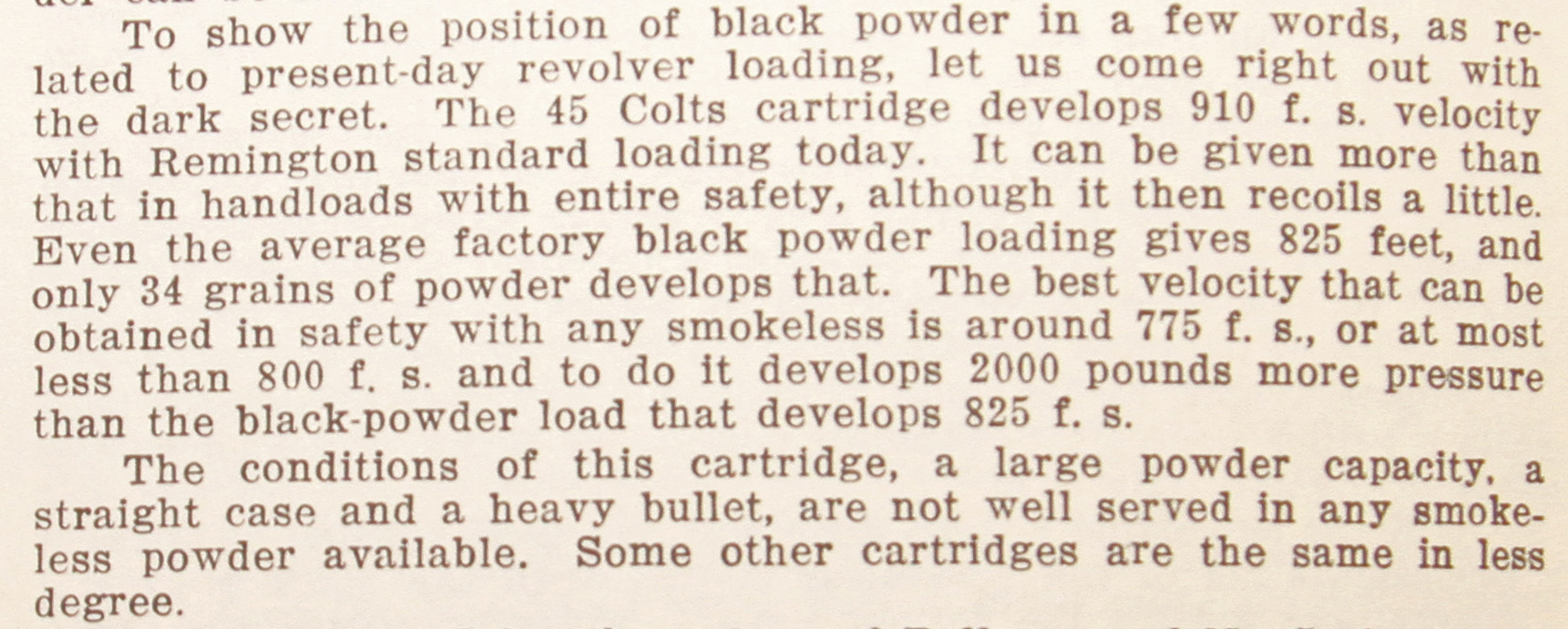

Many, including myself, have been using FPS as an indicator of possible pressure.  No one that I know of produces information on the actual pressures.  There are programs for the modern cartridges that will calculate the pressure of a given load for you before you shoot it.  These programs might work for something like the 45-70 or the 30 WCF.  I don’t have one of these programs so I am just guesstimating what cartridges are available.
If you read the early loading manuals like Complete Guide to Handloading by Philip Sharpe or the new one I just got by Mattern they talk a lot about the pressure problems but this is the first time I saw something that actually calculated the pressure. Be safe.
