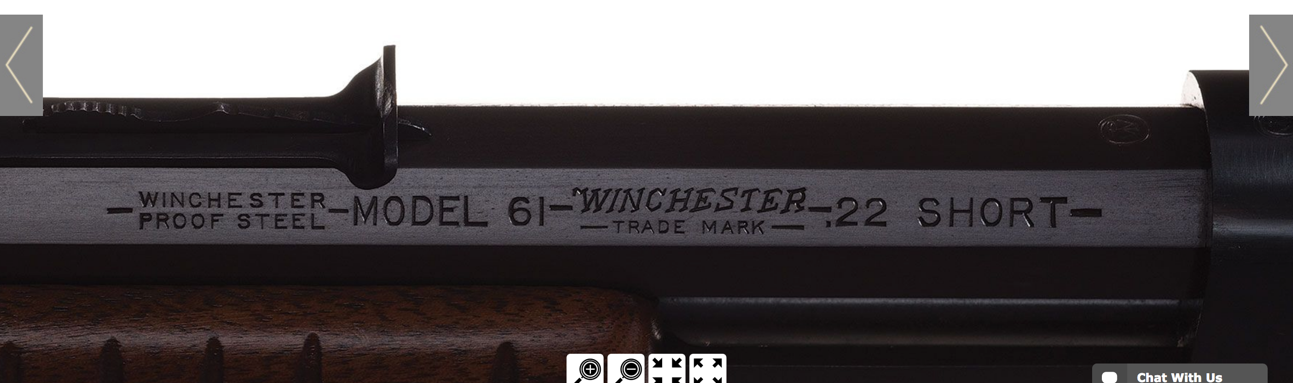

None of the polish or bluing is factory original on this rifle. The barrel markings and the receiver roll die logo are not factory original either. The proof marks are also re-struck. The wood is refinished. This entire gun is fabricated.

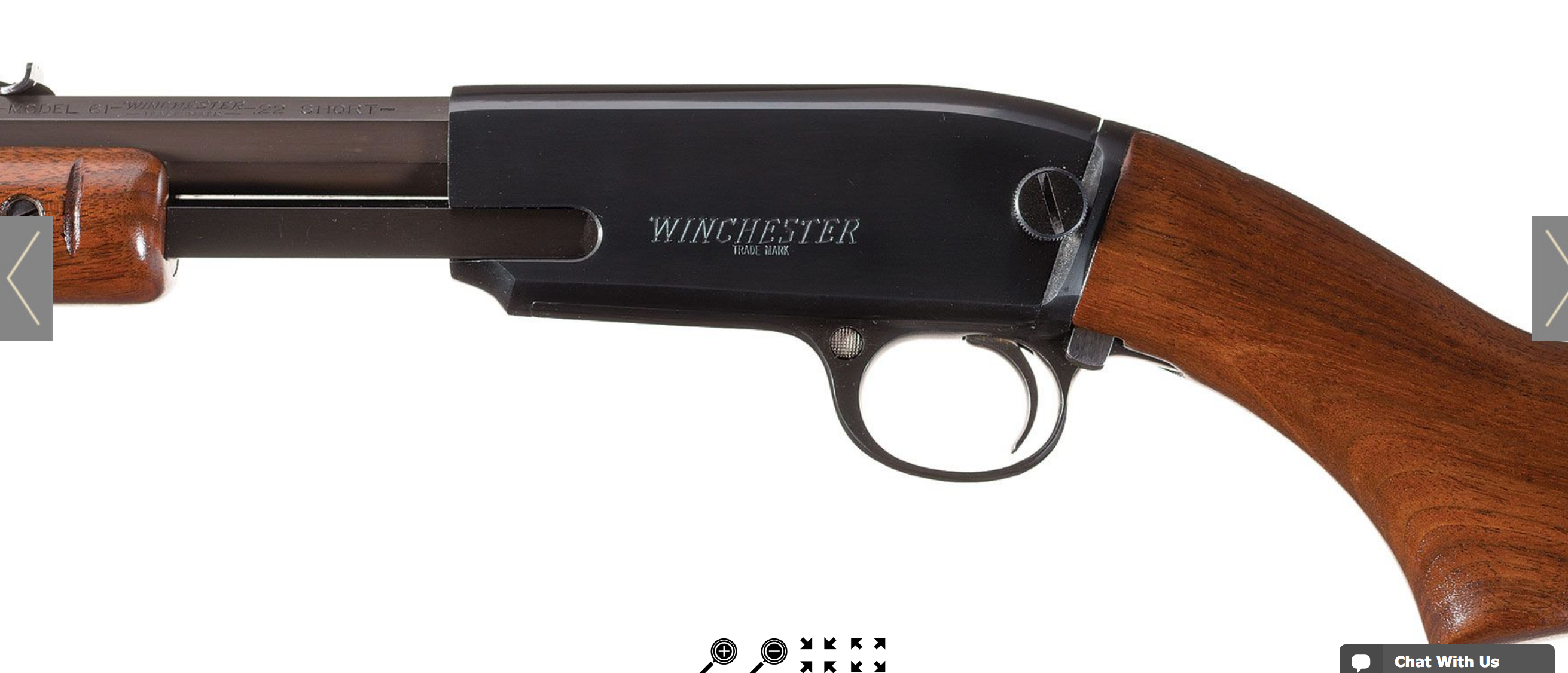

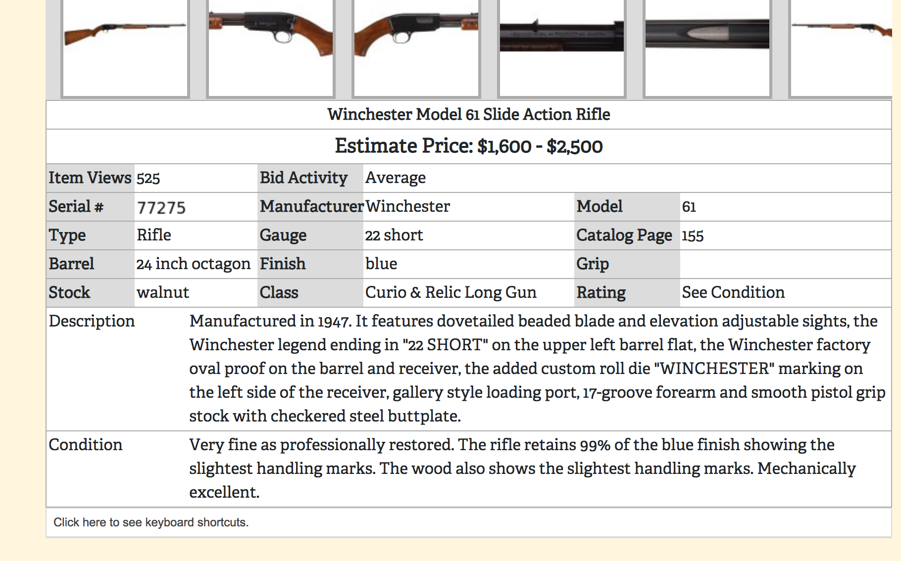

I added this rifle to my list of fakes but it also fits in nicely into this thread.  This rifle sold at RIA in December of last year for $2070 (!) and was listed as “restored” but also read the description carefully about the “added custom roll die WINCHESTER” stamped on the left side of the receiver.  The serial number is 77275 which puts it just 6000 rifles after the rifle in question in this thread.  So if anyone ever questioned if these marking “could possible” be after market applied here is a prime example where they are.  Only thing missing is a quarter once of red paint wiped into the stamp.

Was an octagon barrel even available in this time frame???
Len
Forum Posts: 2765
November 28, 2018 - 4:23 pm
Len,
There were many OB Model 61’s in Short only and LR only manufactured during 1946 and early 1947.  I am away from my catalogs to see when they were last offered there.  They may be pre-war manufactured barrel that were being used after production resumed after the war.
