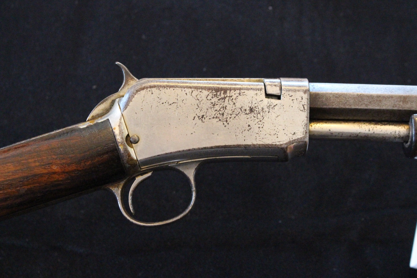

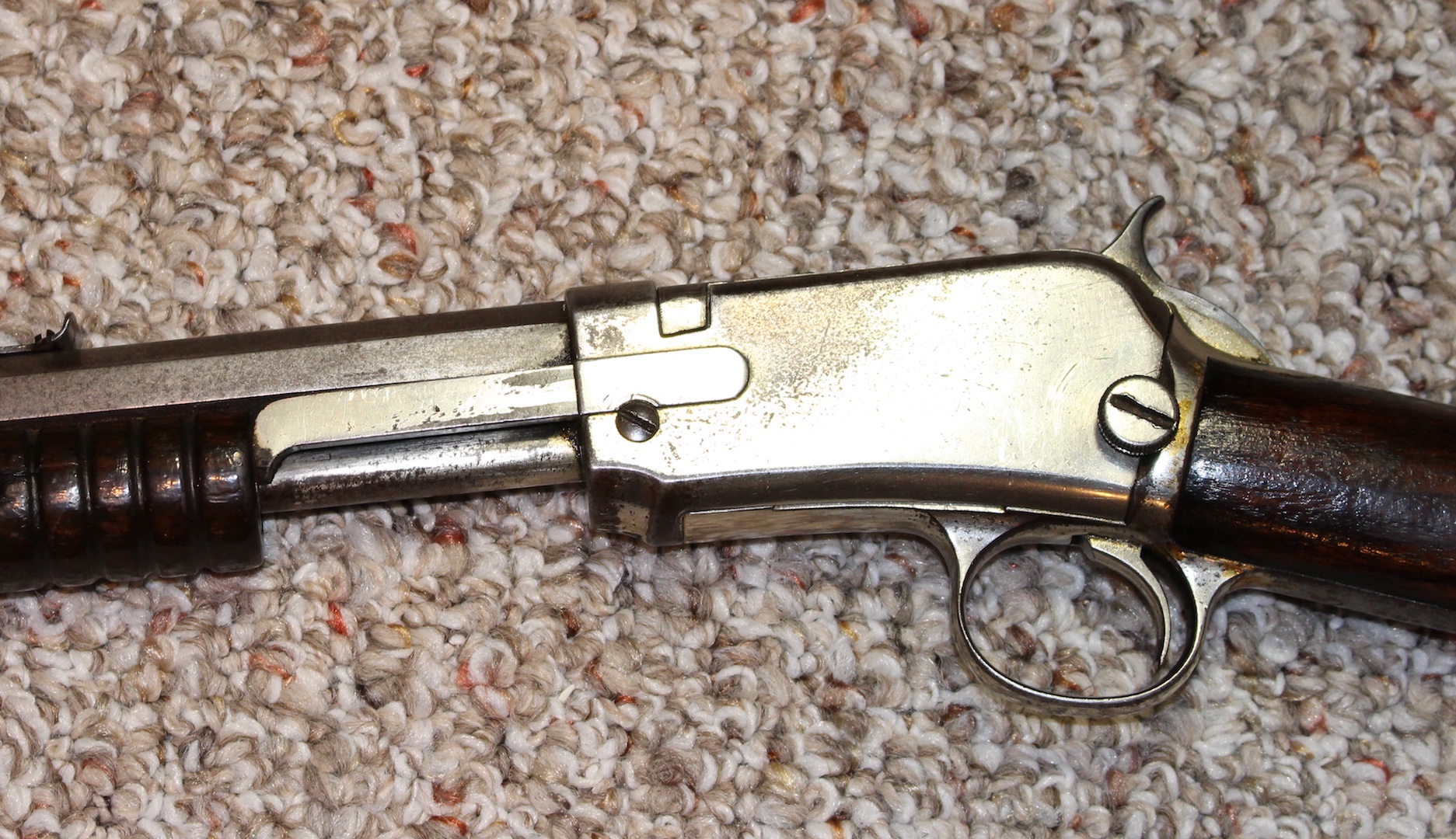

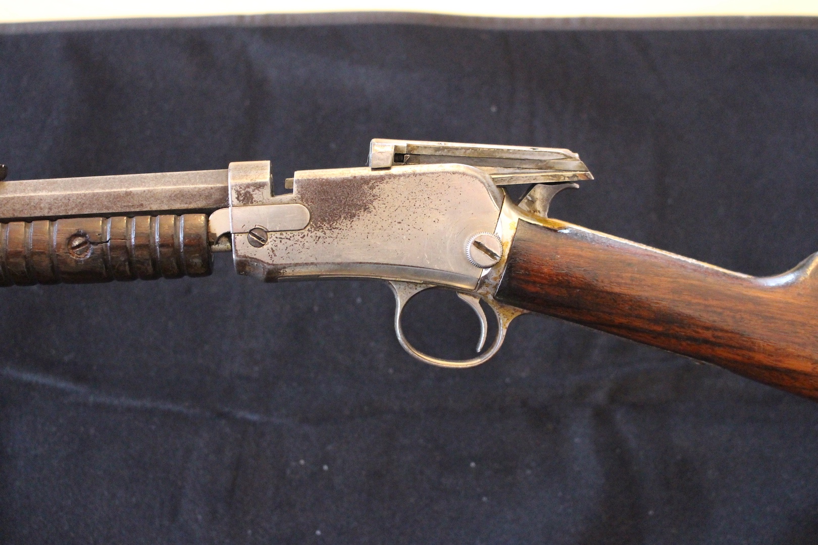

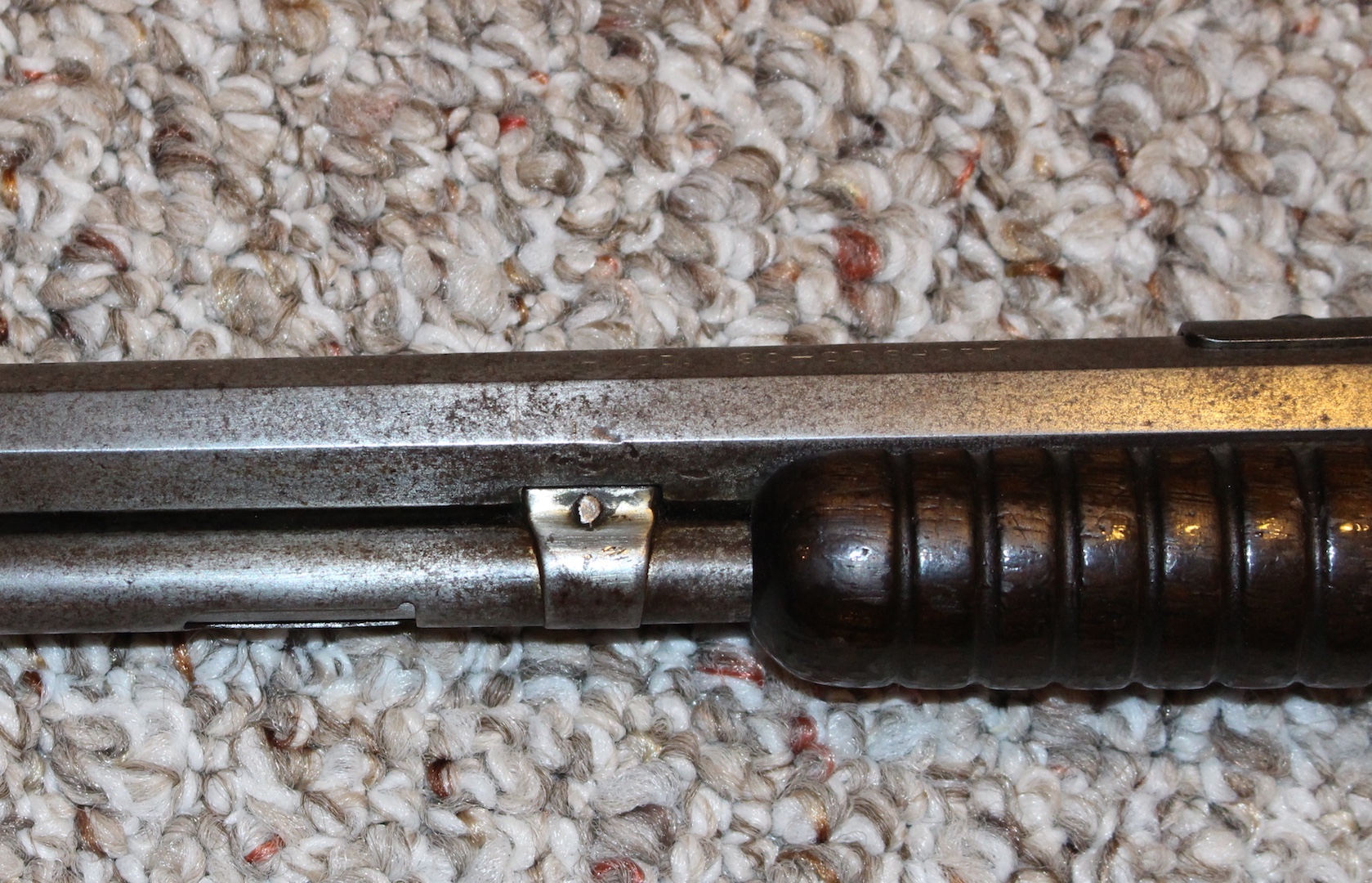

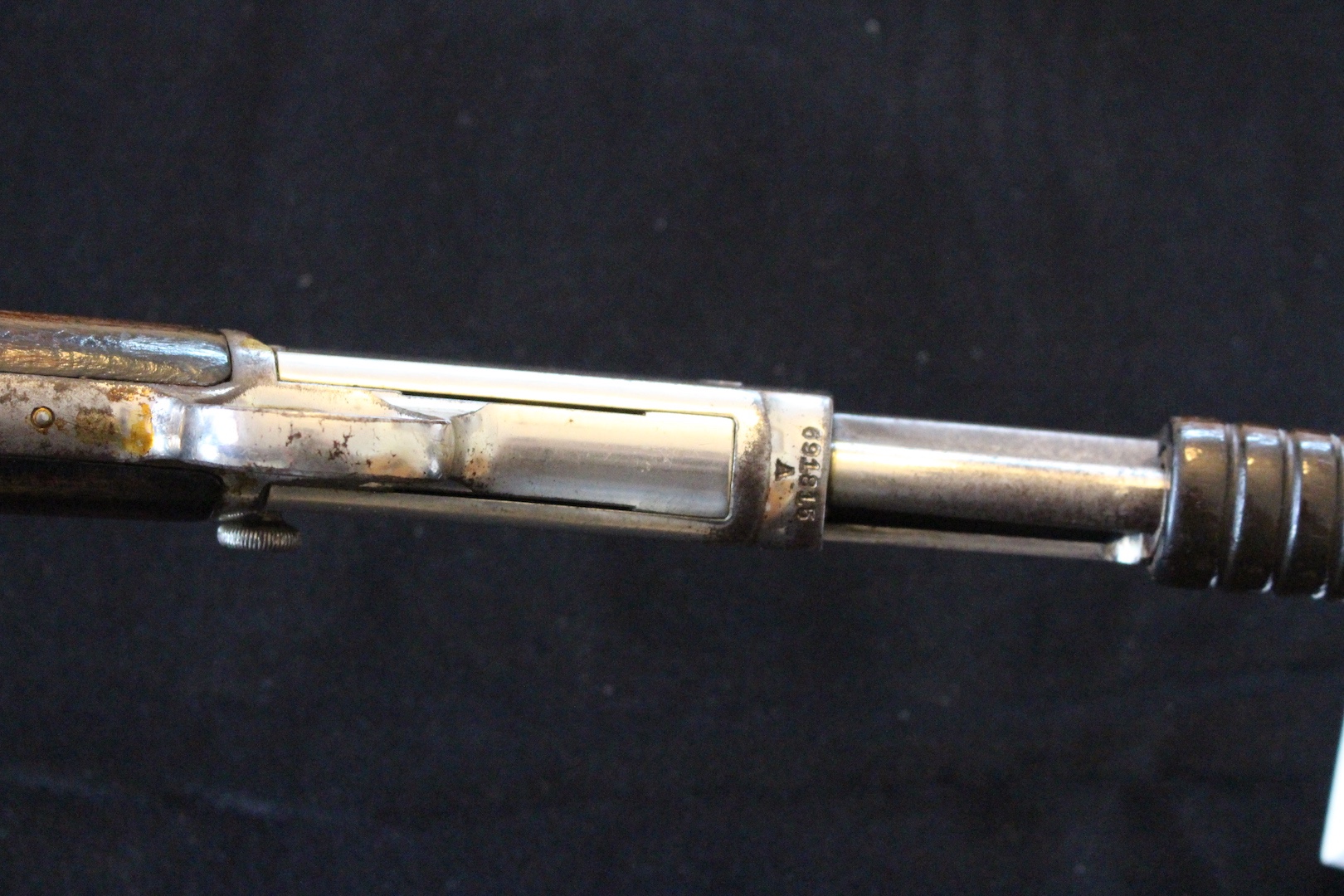

Gentlemen, I recently purchase a model 90 serial number 691815 (1923) from an auction with the intent on having it restored. The description “stated blueing completely gone”, which is true but it appears that at one point the receiver was plated. Having been advised from a Cody letter that information about its specific order configuration was not available. I would like suggestions as to how it could have come from the factory, i.e was only the receiver plated, and the barrel blued? The barrel has uniform rust blooms throughout and the patent dates are hard to read indicating heaving buffing, the edges of the barrel are not rounded over, the plating wear in certain areas could be from carry wear/neglect? The furniture is bad period. From my research it appears that nickel plating was not common, but there are lots of examples to look at. I plan on restoring this guy, just not sure which direction to take, in terms of aesthetics the nickel looks great, but if it was done after if the left the factory I would want a more original appearance. I don’t care about harming collector value as the gun is poor anyway, I just want something nice to look at. Thanks for all the much valued and appreciated advise.

Take it apart at the takedown and look inside and remove the butt plate. That will tell you what the finish was. To me it does look like a nickel finish and if it were mine, it looks great the way it is. I never did like fresh nickel guns, they look too gaudy and you can’t see the age. Guns could of been full nickel or nickel trim were the receiver and a few small parts were nickeled and the rest was blued. Post some pictures of the stampings.
Forum Posts: 14714
April 1, 2018 - 1:04 am
I agree with Bob… it looks like original factory nickel plating, and I would not restore it.

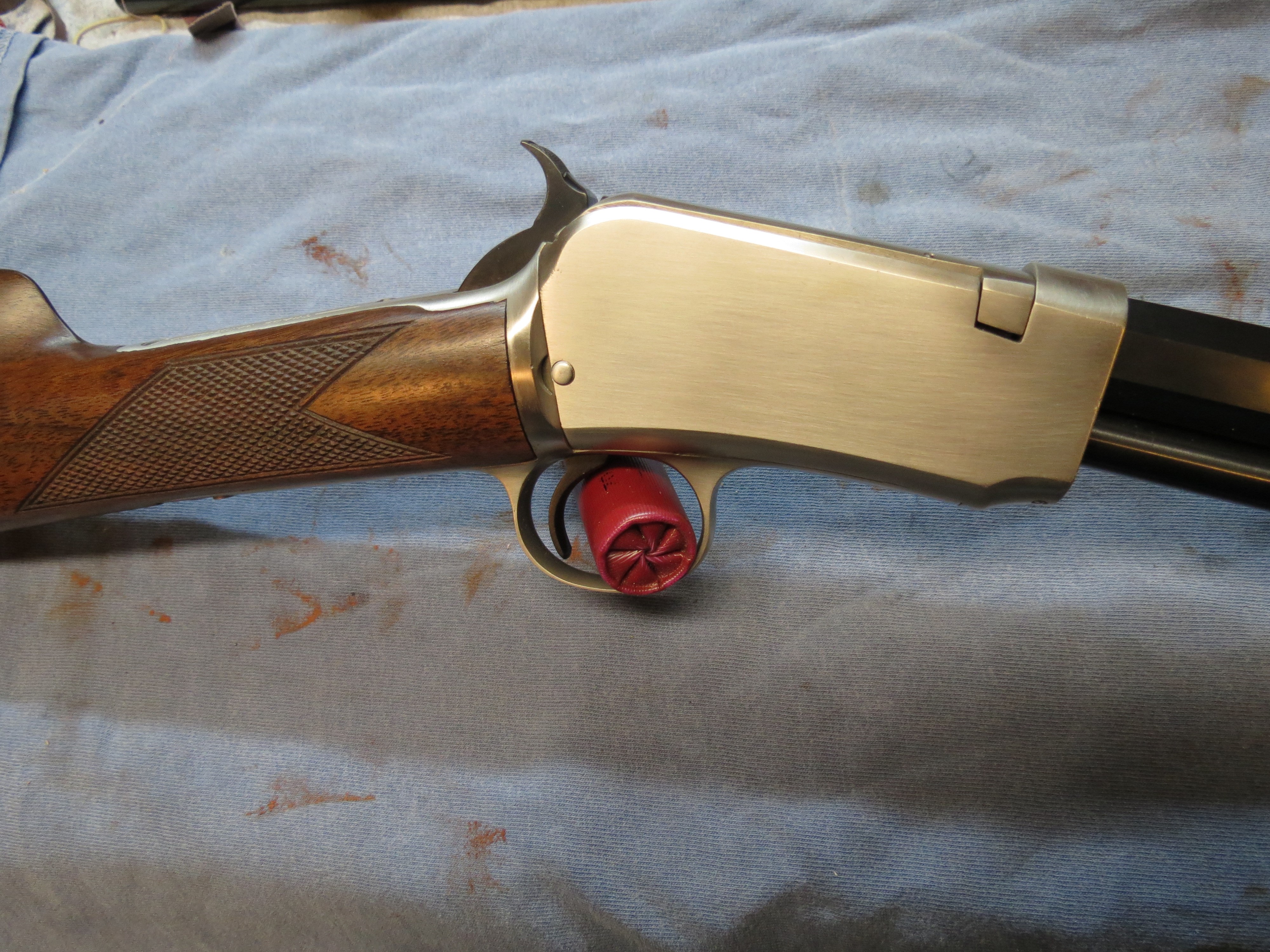

I’m with Bob in the aspect of fresh shiny nickel being to gaudy. Here is an option that I used to tame down the chrome look. It’s called brushed nickel. IMG_2797.JPG
My intent was not to duplicate what the factory did but to make it the way I wanted it to look.

Looking at the gun I believe it was nickel trim. The barrel was probably blued.

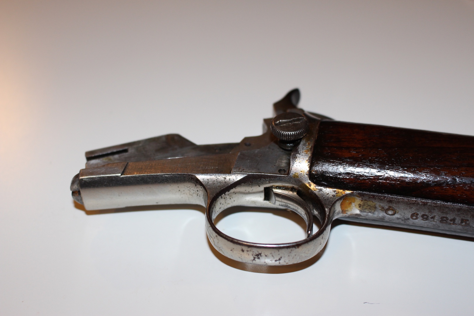

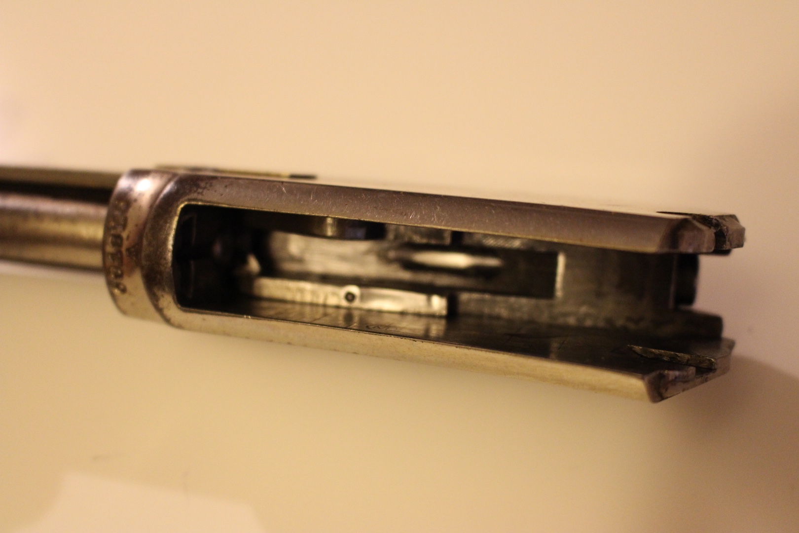

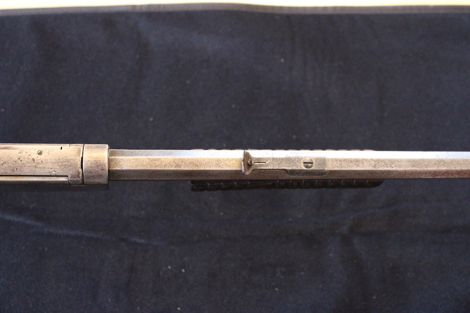

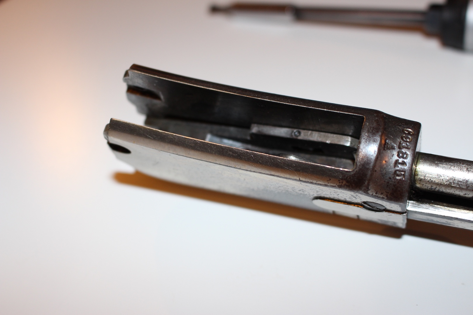

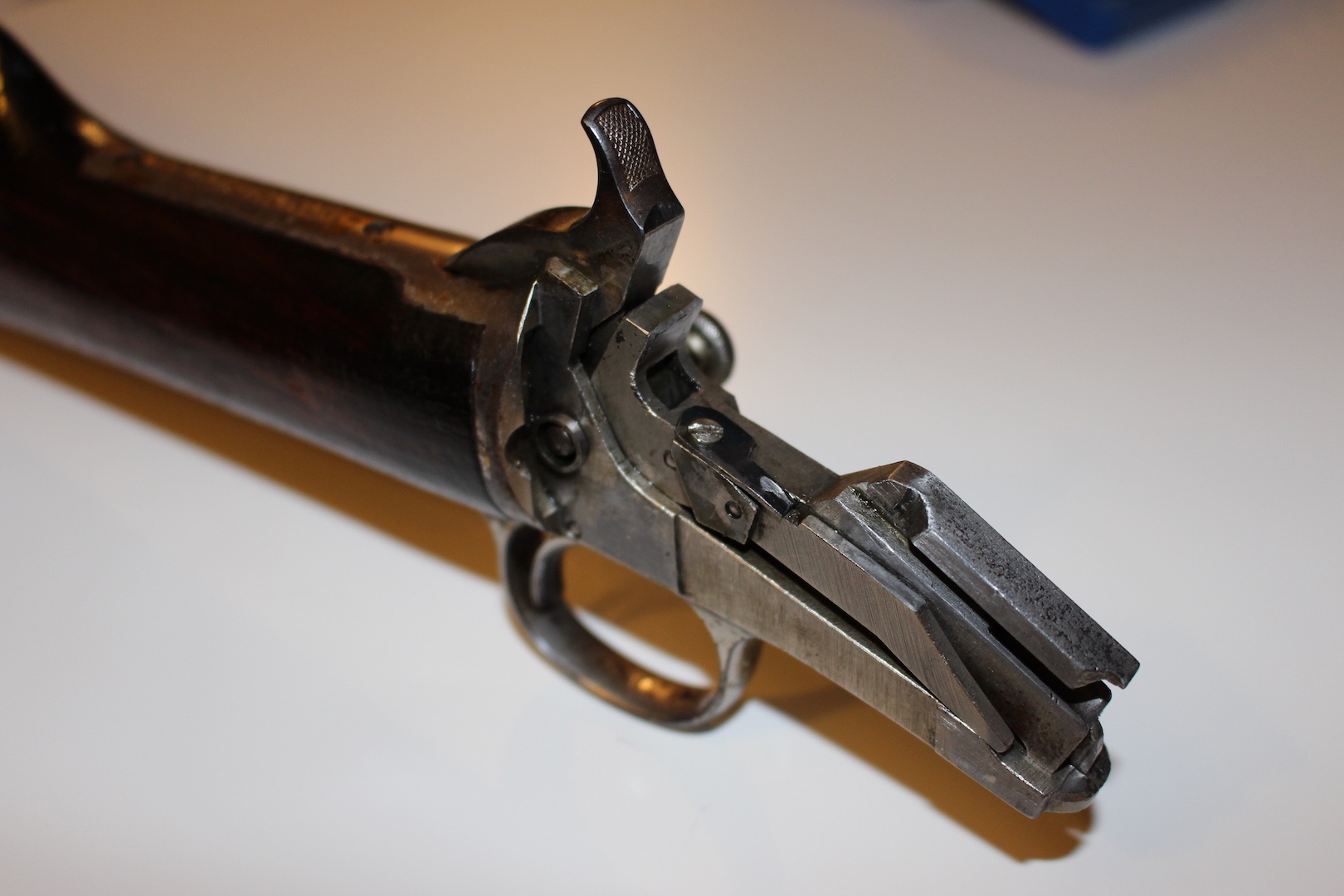

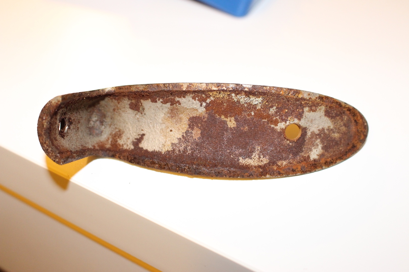

Good Afternoon Gentlemen, all of your suggestions and advice are appreciated very much. I took Bob’s advice and started taking it down to look for evidence of previous plating and original blueing. The results to my inexperienced eye are interesting, I removed the butt plate to see allot of rust and what looked like original plating on the casting. The butt plate had never been removed as the screws were perfect and covered with old shellac . The two halves of the rifle show evidence of original machining tool marks but that’s about all from what I can see. What I found interesting shown in the last pic. was when I removed the rear sight, there was zero evidence of bluing or re-finishoing marks, (please correct me if I’m wrong) which leads me to believe the barrel was not plated or blued because the rust growth on the barrel is just too uniform. Were these rifles offered with a nickel barrel un-plated or blued? These are my findings please advise if I’m out to lunch on my assumptions. Thanks to all for their advice.

Winchester did finish guns with a browned rust finish but I don’t think that is the case here. I believe it was blued and was rusted bad where the nickle provided better protection. The barrel shows signs the rust was removed with the gun disassembled.

I can see part of the barrel mark which is  “Mod 90 22 Short”

the nickle finish looks to be original very same look as my 1894 which was full nickle plated from factory

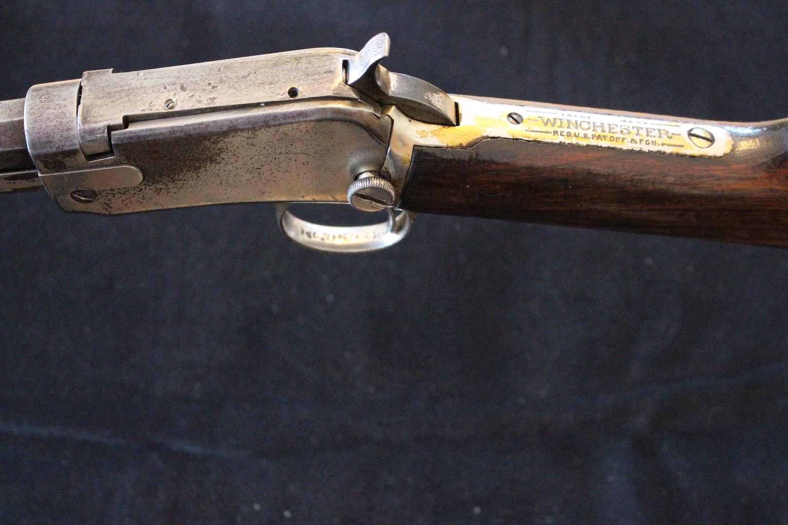

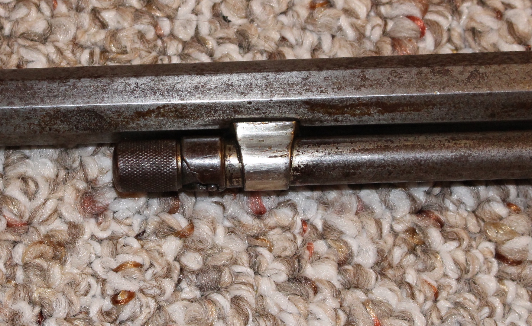

Gentlemen, one more question or point of discussion. From an aesthetics point of view, if the gun was only half-nickel why would Winchester plate the slide action-bar and the bands that hold the mag. tube to the barrel? Specific customer order?, not likely, wouldn’t that look out of place to have three small areas of nickel under a fairly dark blued barrel?
Still listening to Bob’s advice, but it’s just odd. Could one order these extra pieces in nickel plate as a custom spec., but why on a fairly plane rifle without the deluxe stock. More questions than answers! In any event the gun looks way better in pics than reality and it will be going to Turnbull for some sort of metal re-finishing, because I don’t like looking at worn out finishes and they made a million of these.

Cardinal rule of Winchester collecting; “never say never”. It’s hard to imagine today but there was a time when Winchester would build it as you wanted it.

In my humble opinion, I’d leave the finish alone, but that is just me. I can’t tell much about the barrel finish from your photos, but that picture of the rear sight dovetail makes me wonder if the barrel wasn’t also nickeled. But honestly can’t decide either way due the photos. Have you tried taking any photos outside in natural daylight?

If you send it Turnbull they will be able to tell you what it originally was finished with and happened to it then you can decide which way to go.

These “to restore or not to restore” situations can be agonizing. On a collectible piece like yours, I would just gently clean it and leave it alone. On a more common rifle thats in questionable condition, I usually restore them and  shoot the devil out of them. Your 90 actually retains quite a bit of its original nickle plating for its age. Its a beautiful gun!
