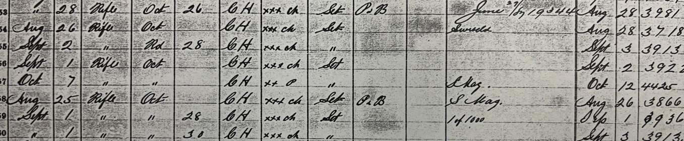

Here are two examples as recorded in the Single Shot ledger records.
S/N 70194
S/N 70298

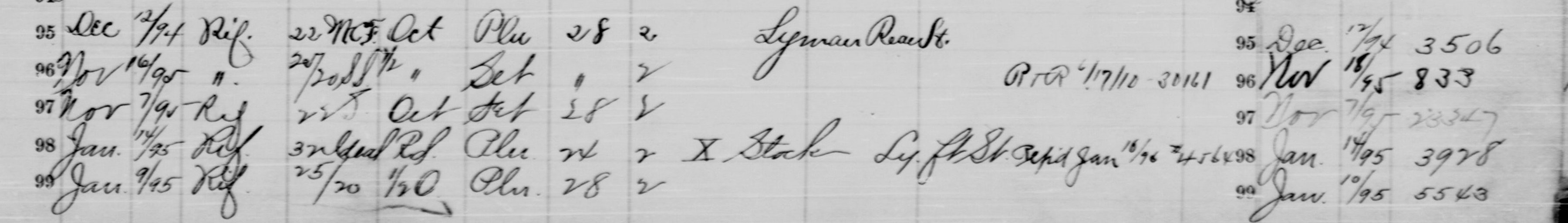

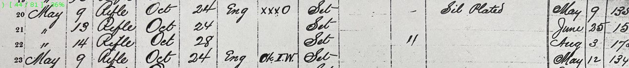

Forum Posts: 5011
December 29, 2023 - 10:51 pm
Here are some with XXX wood from the early first model 73 ledgers.
Forum Posts: 14976
December 30, 2023 - 3:17 am
Very interesting, thanks for posting it!
It is quite odd that there has not been even a single instance of an “XX” or “XXX” entry in the Single Shot rifle ledgers (I am currently up to serial number 73700 in my survey of the records).  Conversely, I have found several dozen with “Fancy” or “X Stock” notations.
