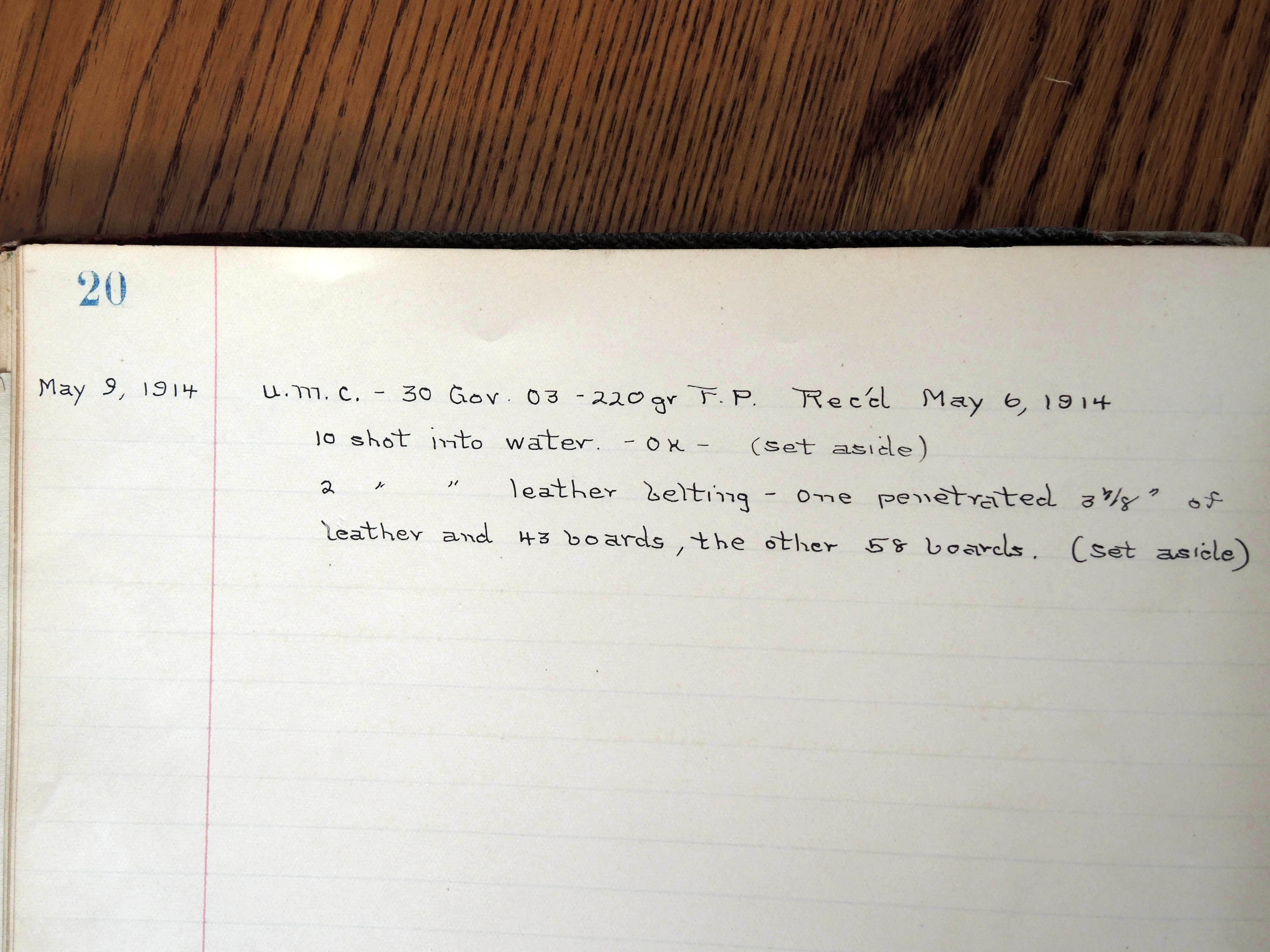

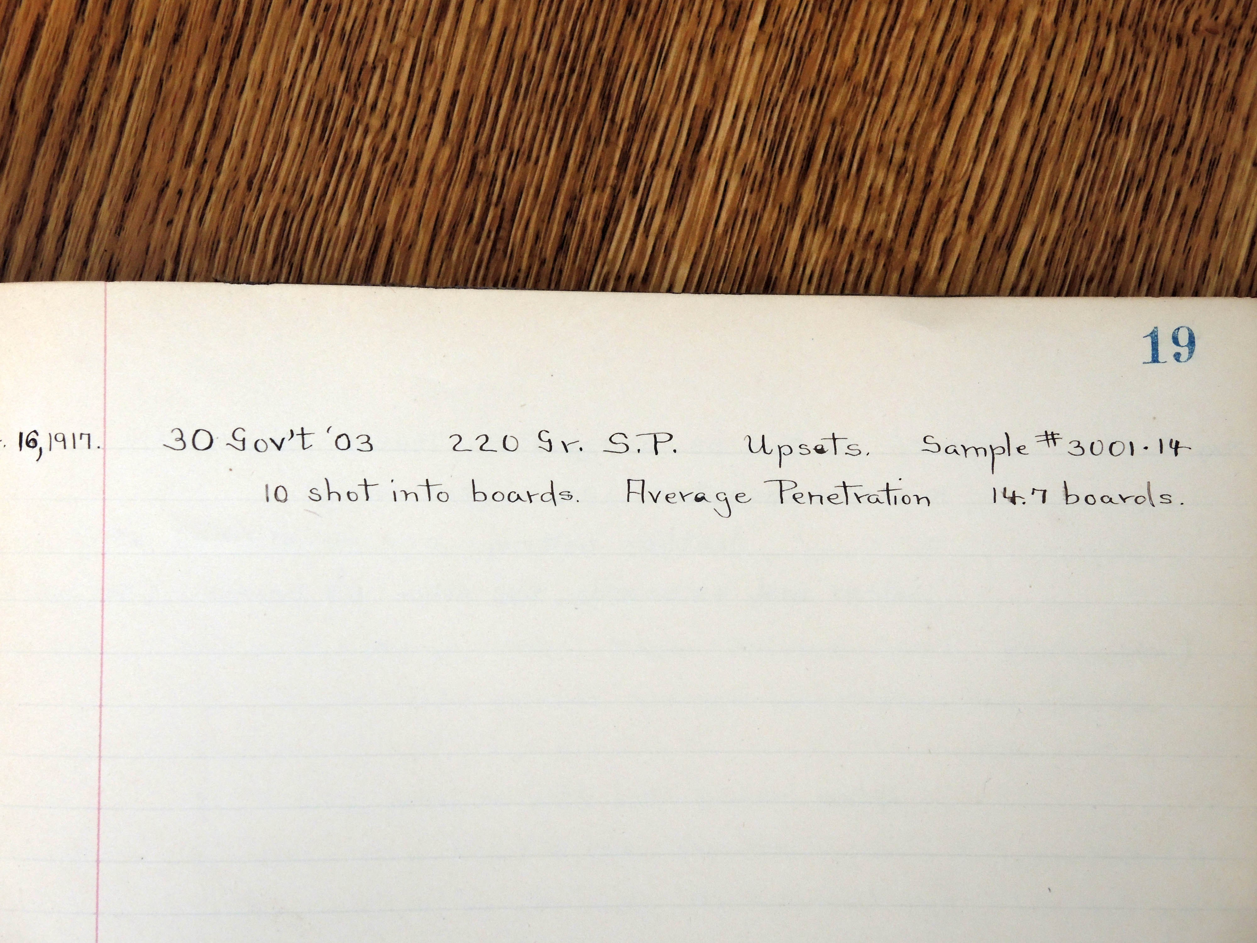

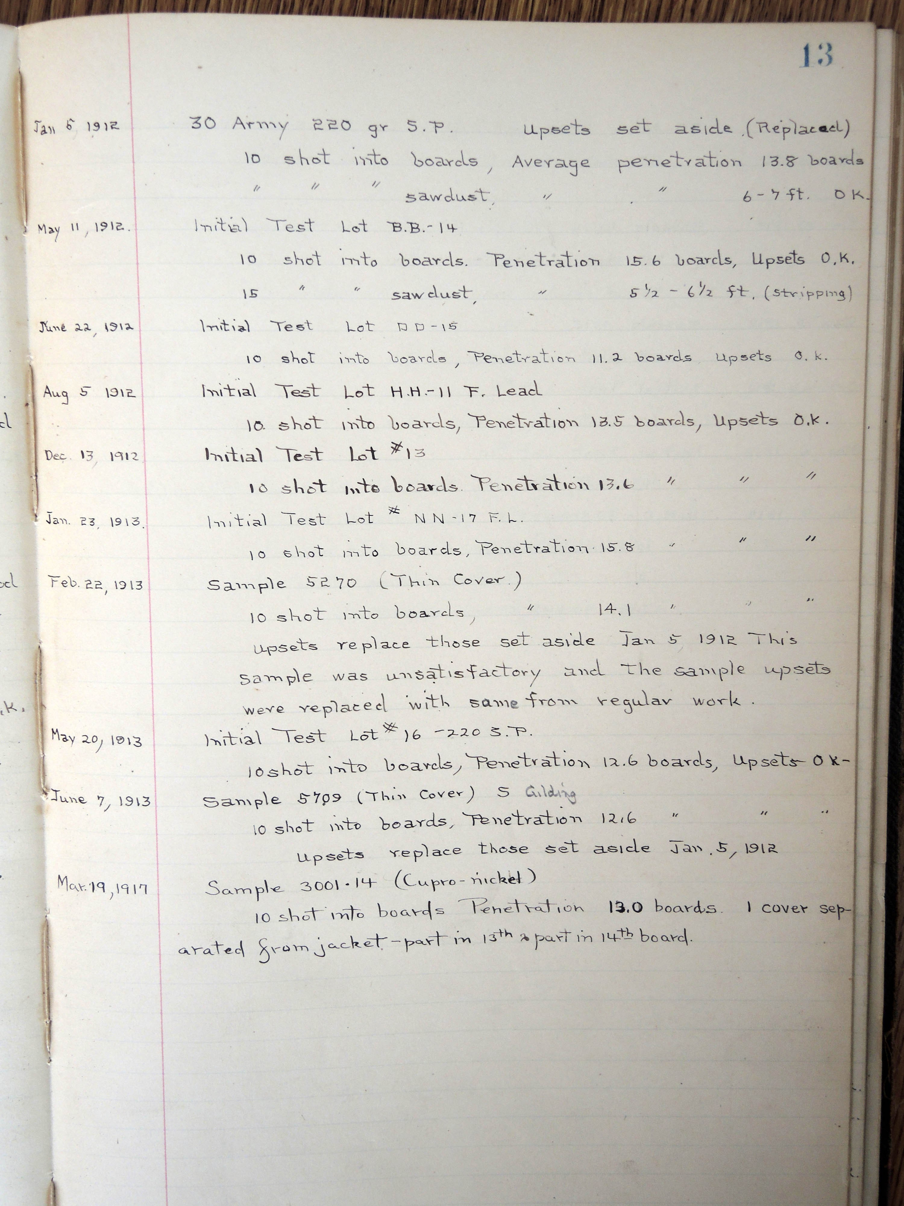

The Winchester testing proved this not to be true.  The 30/40 with a 220 grain bullet at 1960 fps penetrated 58 pine boards.  The .30 U.S. Govt. 06 with a 220 grain bullet at 2250 fps penetrated 72 boards.  It penetrated more boards than any other cartridge on their list.

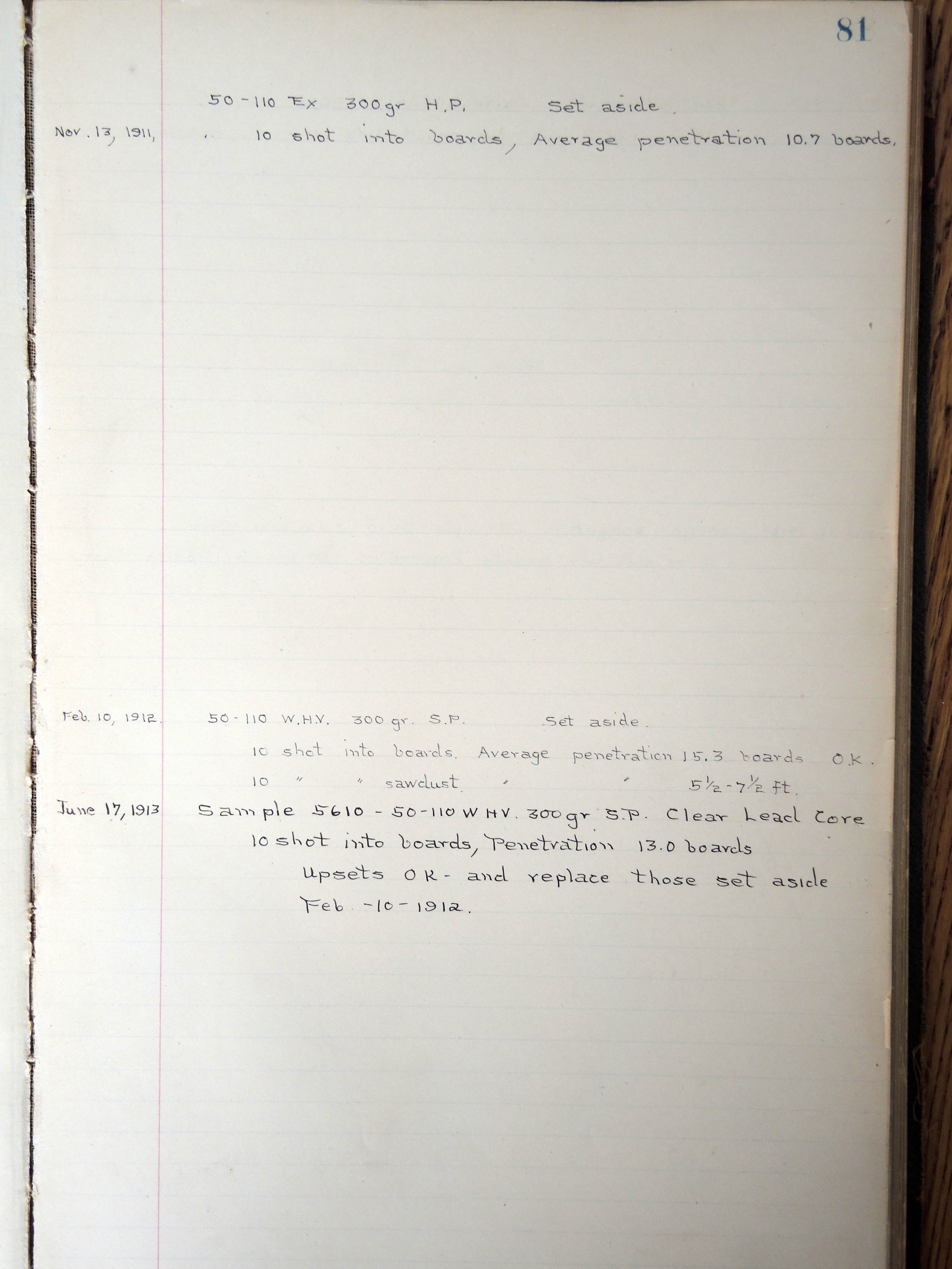

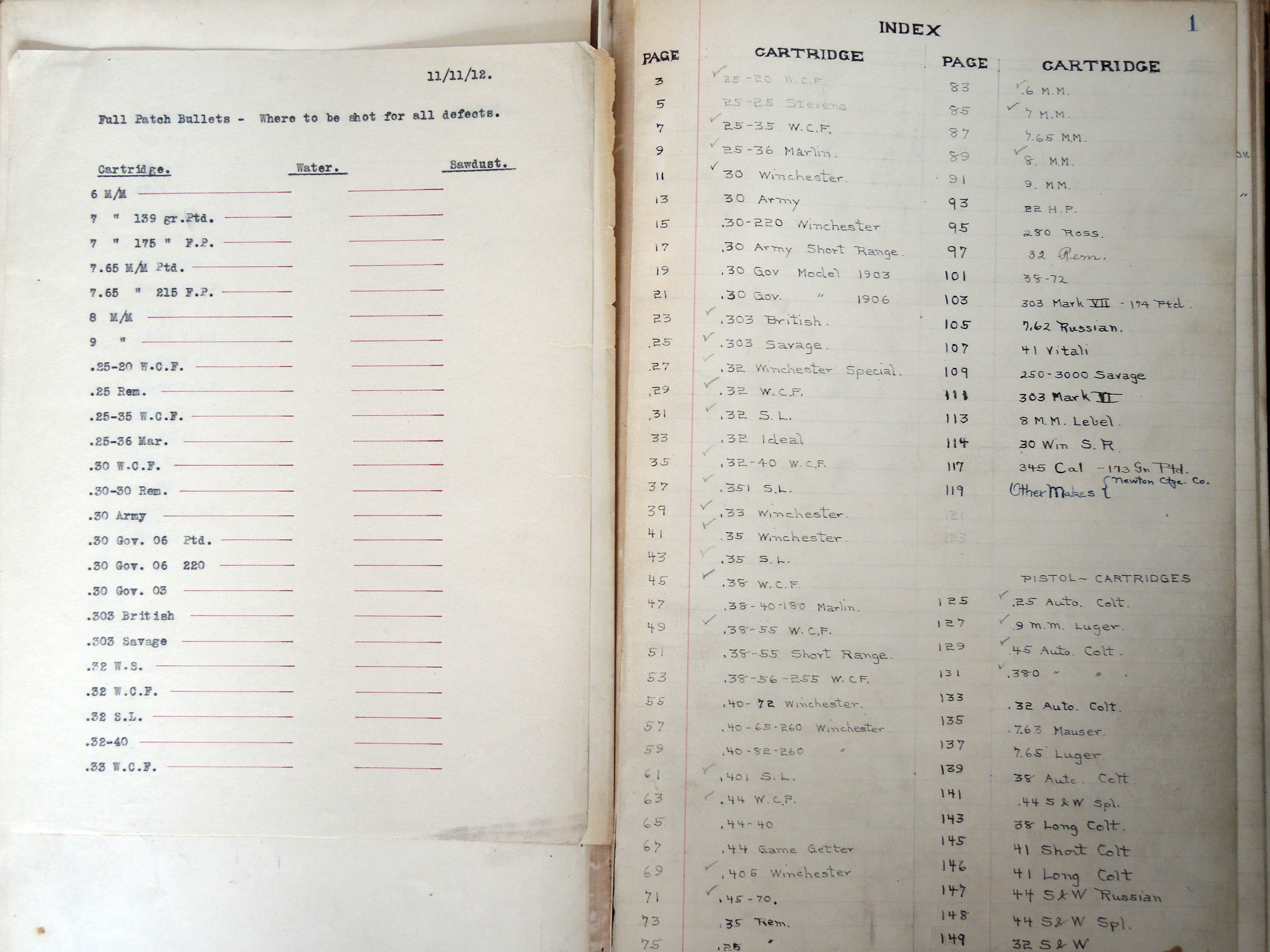

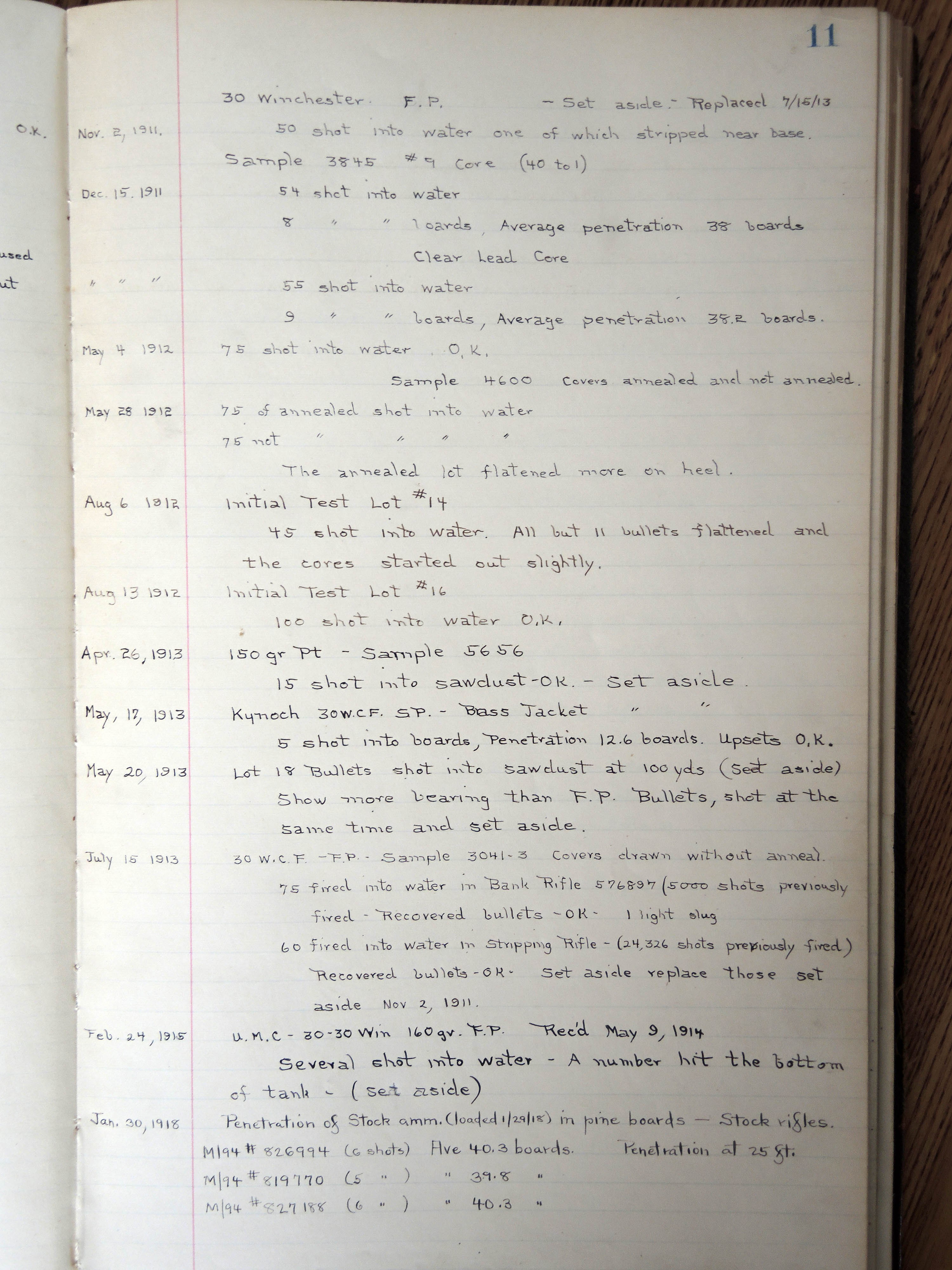

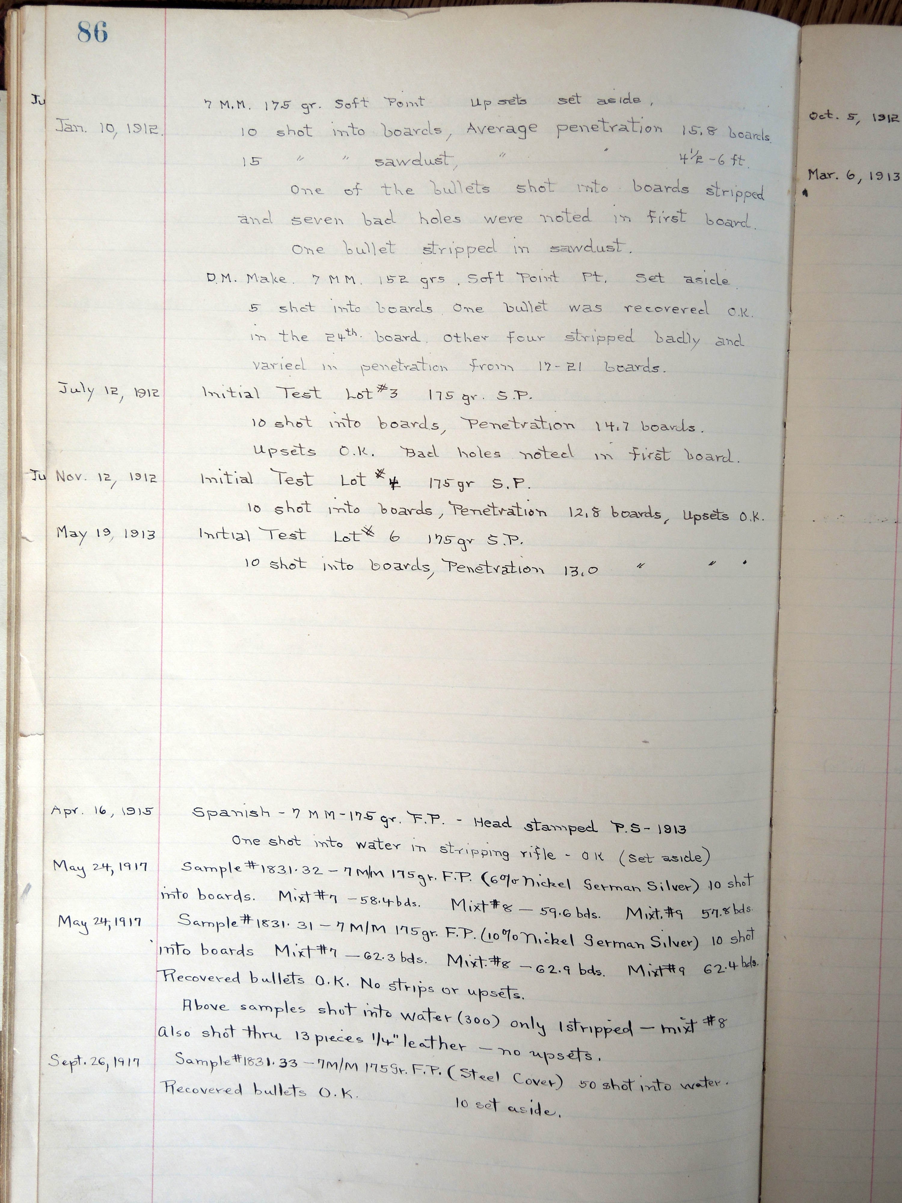

Here are some test results for you to ponder, if interested:
Regards
Brad Dunbar
http://1895book.com/

You are mistakenly comparing FP bullets, not soft points. With soft point bullets the 06 penetrated just one more board, and undoubtedly expanded considerably more because of the increased velocity. On large game, a little more penetration and more expansion could only benefit the 30-06.

Interesting Brad, thanks! ? Kynoch, thats a Brand of Ammunition? 30 Win im sure 30 wcf? And the 7mm probably 7×57?
I believe the 30-40 Krag & 303 Brit with similar bullets would be very comparable, anyone with an opinion?
