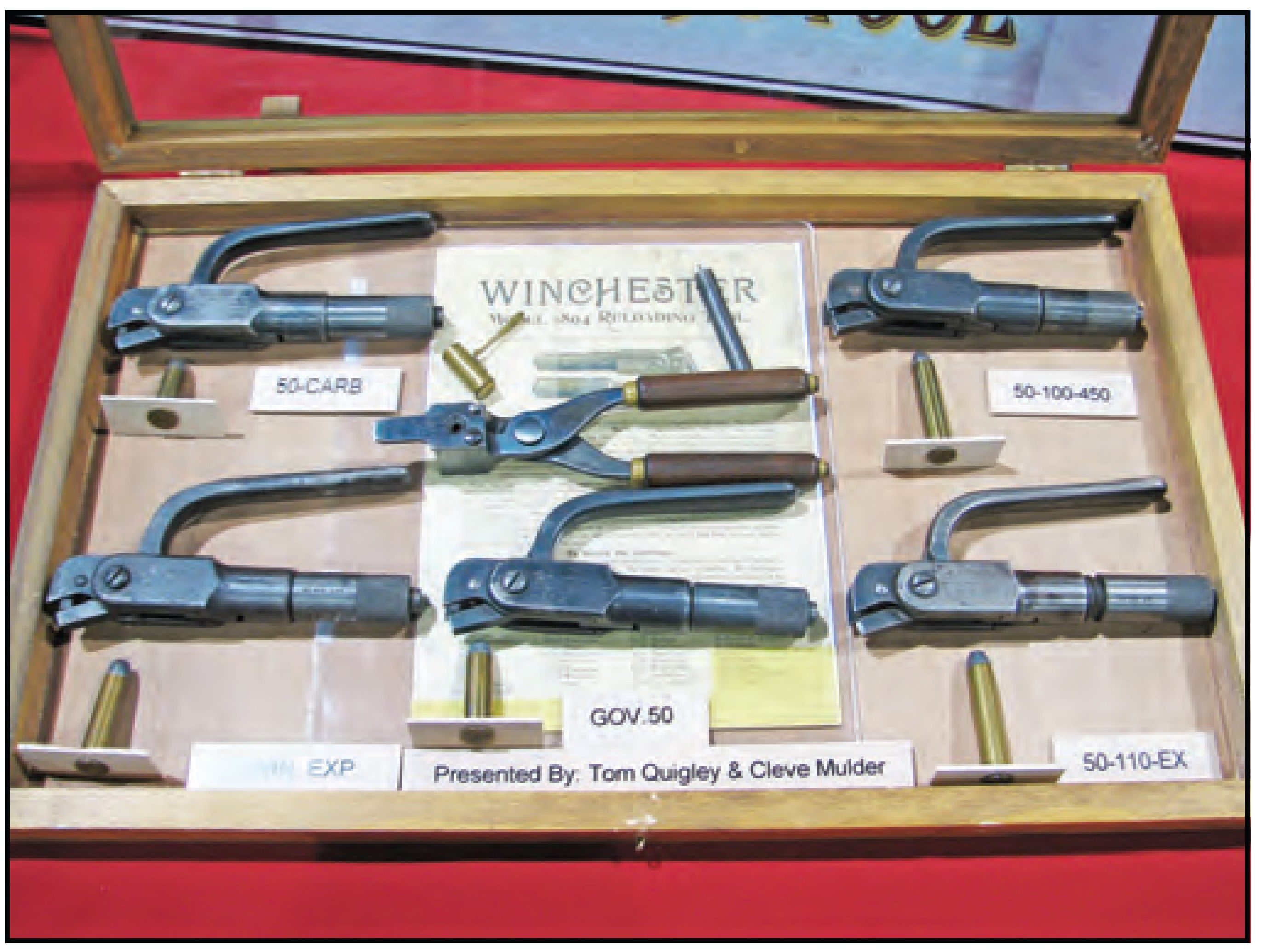

They made several different .50 caliber reloading tools and here a display that Tom Quigley put together some years back. Anything .50 caliber goes for a premium.  50cal94Tools.jpgBelieve or not it would probably take you over a thousand dollars or more and several years to assemble such a display of tools.
